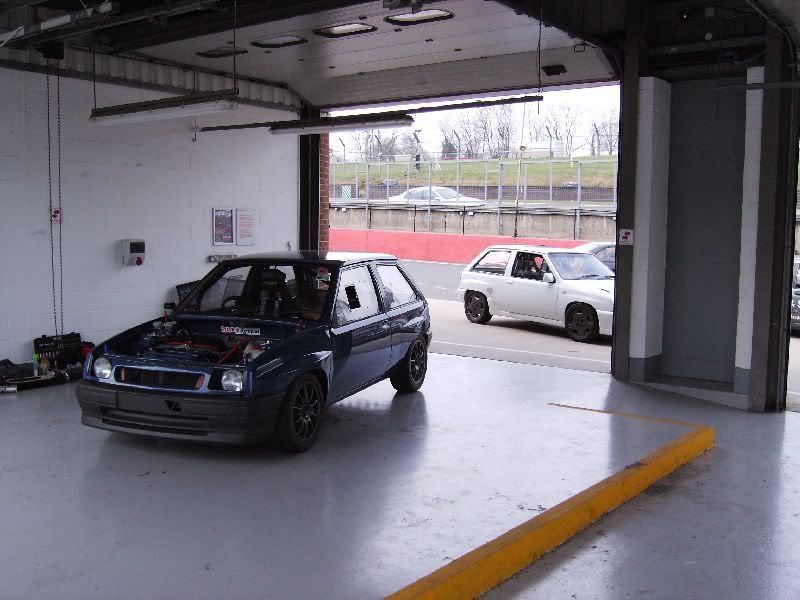

It made it to Brands Hatch (and bk!)
Here's some evidence ;)
http://i9.photobucket.com/albums/a91...e002smal-2.jpg
http://i9.photobucket.com/albums/a91...ge019small.jpg
http://i9.photobucket.com/albums/a91...ge013small.jpg
http://i9.photobucket.com/albums/a91...009small-1.jpg
