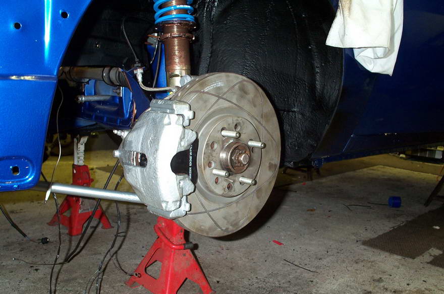

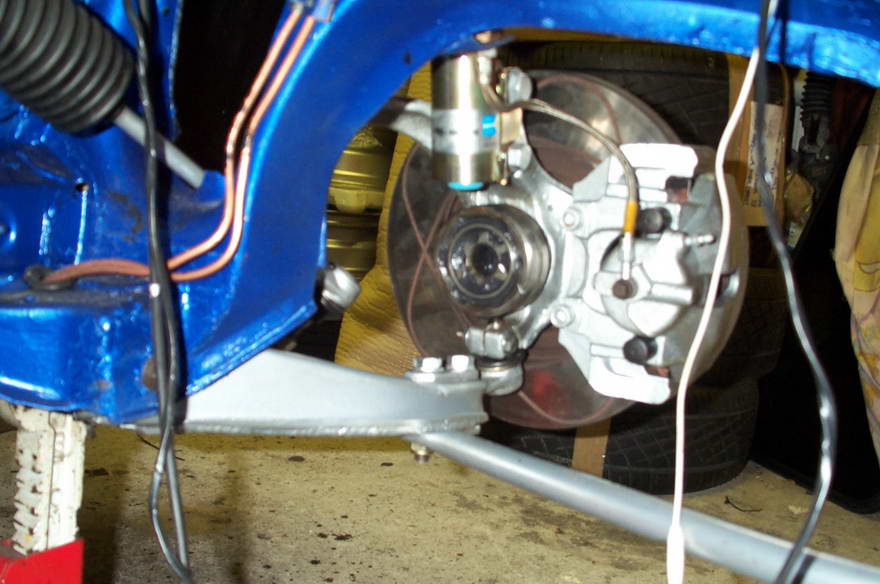

Also now finished rebuilding the front hubs replacing the bearings and using new CV joints.
The discs have been redrilled 4 stud and the Vectra GSI calipers have now been fitted with the M1144 pads.
http://www.elsamak.karoo.net/brake1a.jpg
Also sorted the tiebar out so it sits under the bottom arm in order to give extra clearance around the
end of the F28 six speeder.
http://www.elsamak.karoo.net/tie3a.jpg

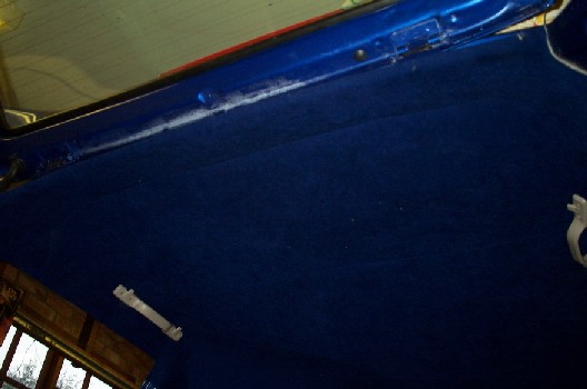

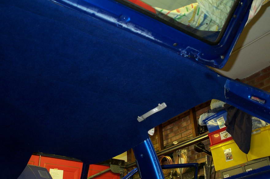

I have also started fitting the new headlining. I have had this made up in the same way an OE headlining
is made so it has the gussets for the support bars. The material has been matched to the colour of the seats.
It needs stretching and trimming to fit around the apertures. I have started at the tailgate and have
completed both side windows fitting the grab handles along the way.
http://www.elsamak.karoo.net/head1a.jpg
http://www.elsamak.karoo.net/head2a.jpg
Just need to finish off fitting the headlining over the weekend and I can then fit the side and front windows.

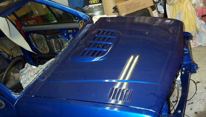

Is that a new bonnet I spy????
Lovely colour :thumb:
Rick,
The actual metal bonnet is new and has been provided by Cool Louvres as they have stamped 6 vents reversed to pull air in and placed directly over the air filter for that nice supply of cool air for the engine.
The other scoop is a hang over from the red version, a Sunny GTi-R direct replica with functional venting underneath.
The bonnet is currently absolutley filthy with a layer of dust and cutting paste so doesn't look its best!
http://www.elsamak.karoo.net/bonnet1a.jpg
The bonnet is due a respray as the base colour has cracked under the lacquer around the pressed in vents.
Joff

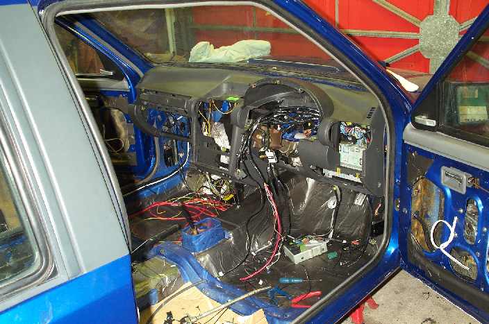

I have trial fitted the corsa dash and have found that the EPAS motor sits extremely close to the back of the
fuse box so will need to spend some time re-routing some of the loom so things fit OK.

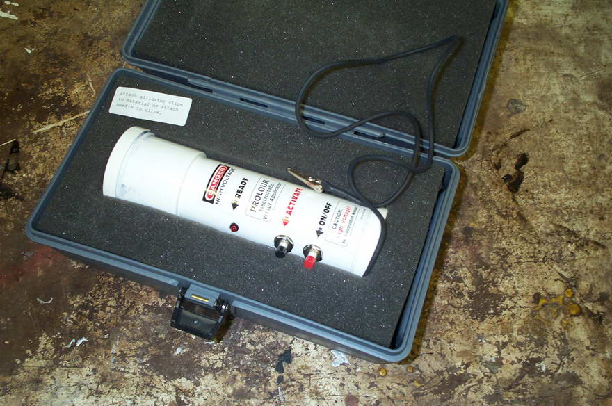

Also got my hands on a electrostatic flocking applicator and have given it a test as the dash is not ready yet.
I stumbled across a site in the US getting rid of some of their stock, and an Electrostatic Flocking Applicator
was amongst their stuff. Paypal payment later and 2 weeks shipping and my applicator arrived today in its own case :-
http://www.elsamak.karoo.net/app1.jpg

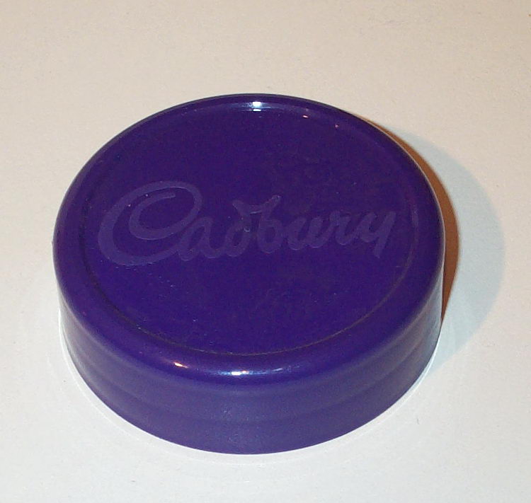

I am not quite ready to flock the dash yet but I needed to try it out on something - roll up the cadburys
highlights lid !!!! -
http://www.elsamak.karoo.net/app2.jpg

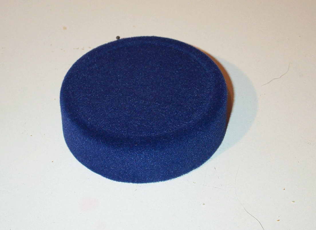

I then put the kettle on (you need some humidity for the applicator to work best) and then loaded up the
applicator and zapped the lid ......
http://www.elsamak.karoo.net/app3.jpg
The photo doesn't show the flock off to its best - the great thing is its a uniform layering with no clumps
and all the fibres are pointing 90 degrees to the surface which is how it should be. I'm really chuffed
with the results and it means I can do dashes, centre consoles, pillar covers .... well anything really!!!

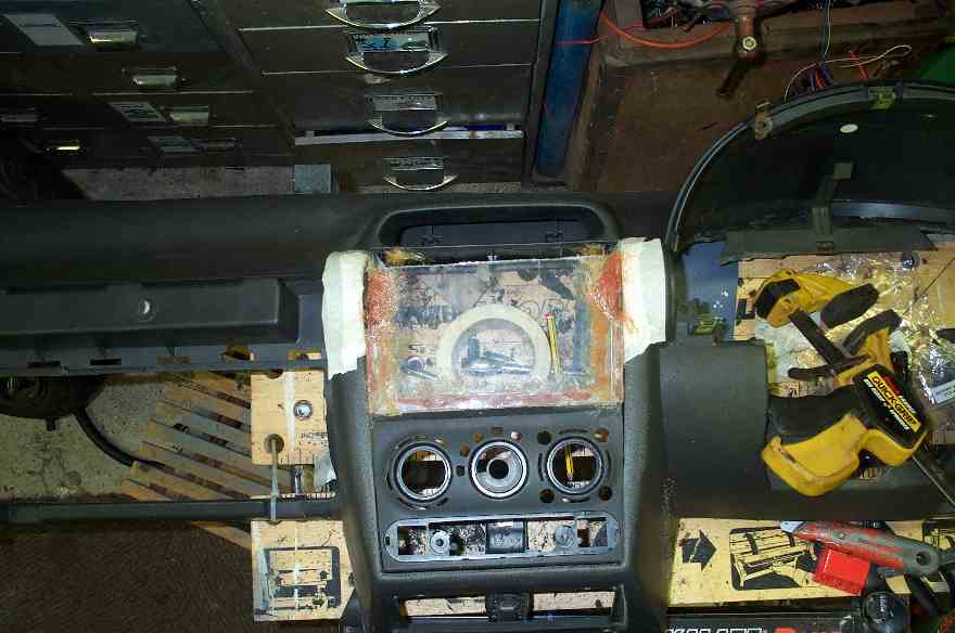

Been on with the corsa dash today, trial fitted it again after rerouting some wires that fouled on the
EPAS motor - after some cable ties and soldering the problem was sorted! The dash fits fine now!
http://www.elsamak.karoo.net/cordash1a.jpg
Next I have been working on the centre dash to get the satnav concept sorted out. As I don't need
a DIN hole for the stereo (as the faceplate lives in the sunvisor) I have done away with this :-
http://www.elsamak.karoo.net/centre1a.jpg
It looks a bit rough and ready at the moment as its only just getting its basic shape. I am going to recess
the PDA behind the cente of the dash - which will flip forward for easy of access for security purposes.
I am going to mold out the semi-circle shape where the vents normally live and you need to remember
this centre bit will be flocked blue.
A lot more fibreglassing and filling required before I'm going to be happy me thinks!
Joff
