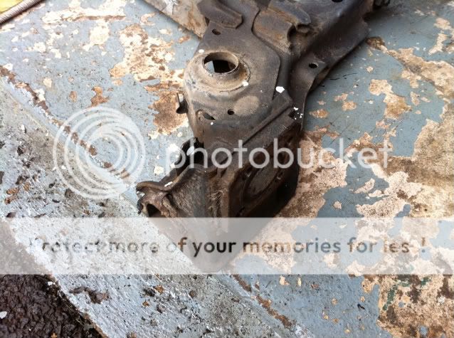

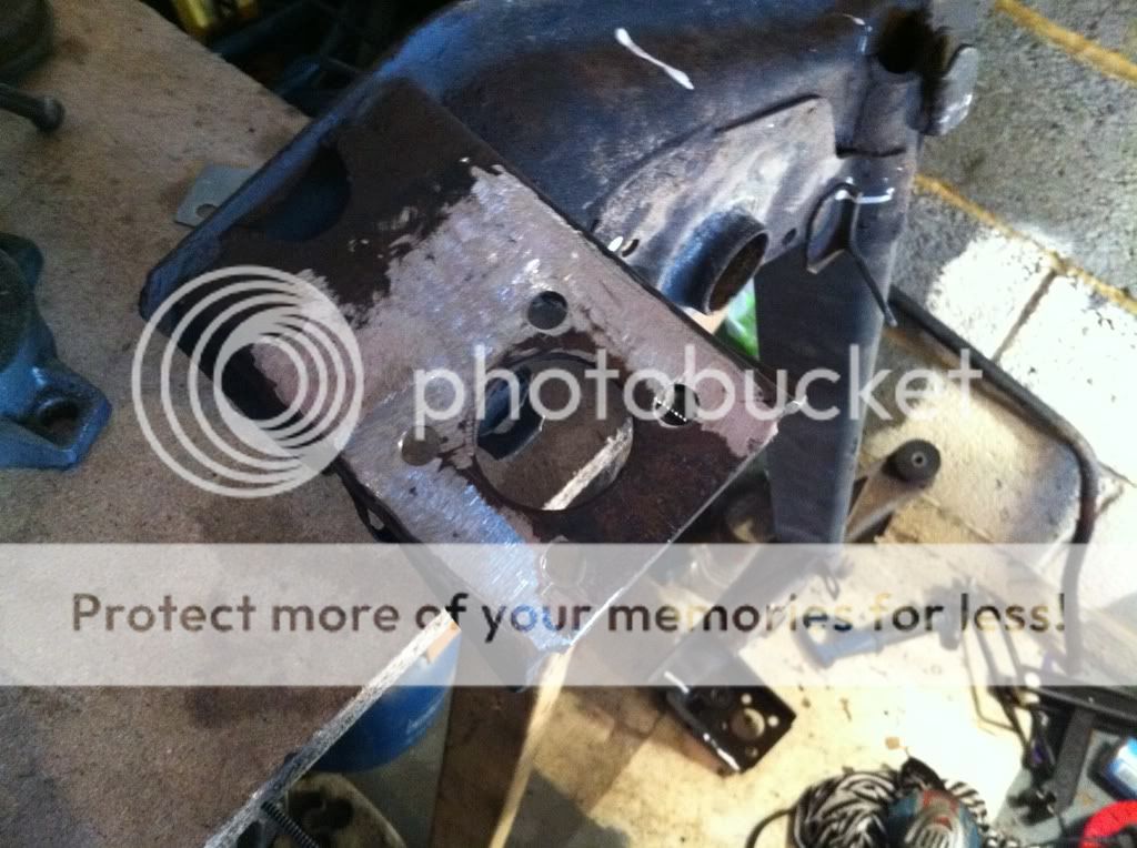

I've managed to get my et33's on
This is how I've done the rears; pics were meant for my update but meh lol
Cut this plate off;
http://i499.photobucket.com/albums/r...S/4c2dea54.jpg
Leaving this;
http://i499.photobucket.com/albums/r...S/ca12a87f.jpg
Then re weld the plate on the other side, and rebuild it, pulls the wheel in by 8mm
I'll save the rest of the pics for my thread lol
