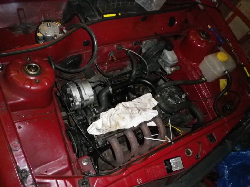

Bay, pretty much done, just have to mount the coilpack and run the coilpack and tps wiring in - oh and the starter/alternator to battery cable:
http://i71.photobucket.com/albums/i1...a/IMGP0133.jpg

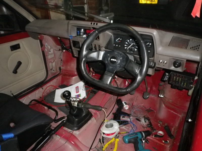

Dash, again just the megajolt stuff to do:
http://i71.photobucket.com/albums/i1...a/IMGP0136.jpg

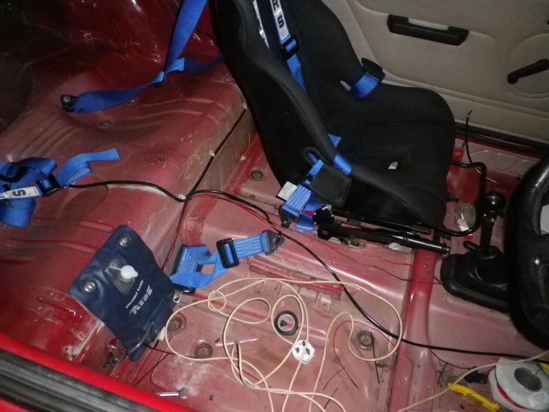

Back, just the battery to fit and wire up and tidying the wiring run:
http://i71.photobucket.com/albums/i1...a/IMGP0137.jpg
