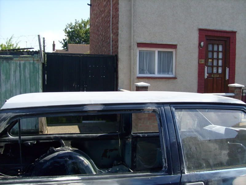

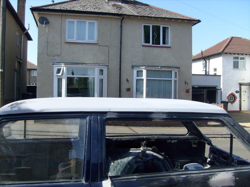

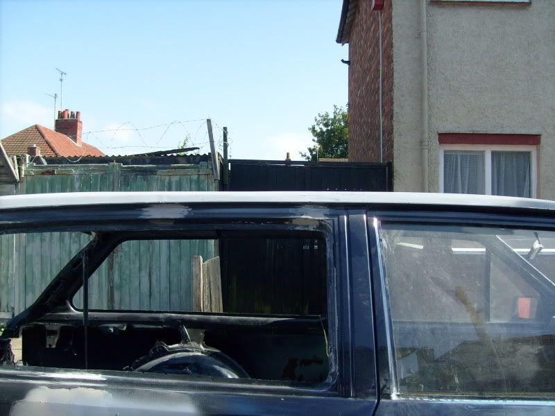

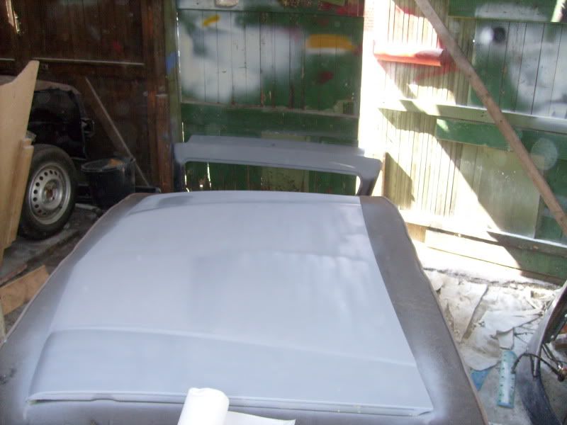

another pic of how the roof is looking
http://i12.photobucket.com/albums/a2...n/S7302945.jpg

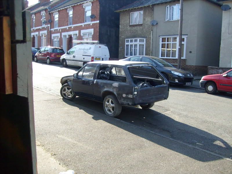

put her outside to do some of the panel work
http://i12.photobucket.com/albums/a2...n/S7302946.jpg

then started on the boot. one full skim
http://i12.photobucket.com/albums/a2...n/S7302951.jpg
then a second
http://i12.photobucket.com/albums/a2...n/S7302952.jpg
and third. gonna need a tiny bit more but its basically done :D
http://i12.photobucket.com/albums/a2...n/S7302953.jpg

a pic of some of the filler dust lmfao. my garage is officially bogging
http://i12.photobucket.com/albums/a2...n/S7302955.jpg
i have one of thoses sanding blocks they are ace and top job your doing too.
Spot on dude thats really coming along well, i bet you were glad to finish sanding back all of the fibreglass on the roof werent ya lol
Keep it up though bud its looking impressive:thumb:

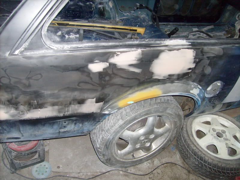

then as with the roof i decided best course of action was rip the fibreglass off, didnt get a pic but this is with the first skim of filler
http://i12.photobucket.com/albums/a2...n/S7302956.jpg
http://i12.photobucket.com/albums/a2...n/S7302957.jpg

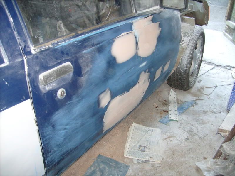

then basically rubbing down and more layers
http://i12.photobucket.com/albums/a2...n/S7302959.jpg
http://i12.photobucket.com/albums/a2...n/S7302961.jpg

not the best pics but they are basically there. need a little skim here and there but im happy with how they are going. its patchy because its a guide coat
http://i12.photobucket.com/albums/a2...n/S7302963.jpg
http://i12.photobucket.com/albums/a2...n/S7302964.jpg

A tip for filling. When you do a 2nd or 3rd skim, allways do the whole thing, dont do it in lil bits.
It makes for more rubbing down but the fill will be better and leveler/smoother.
