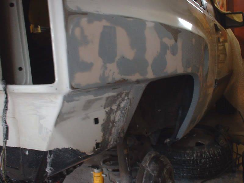

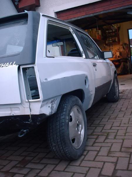

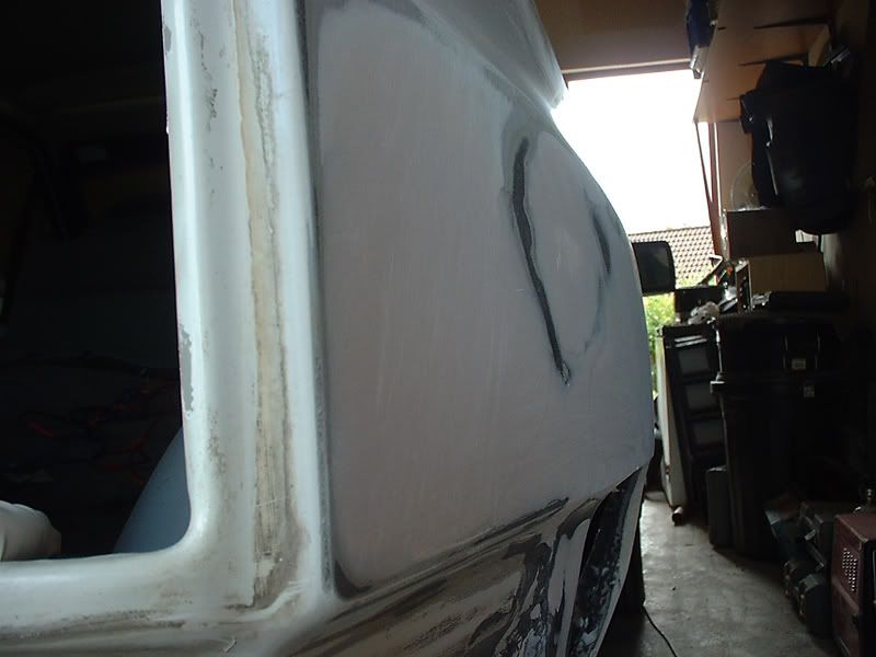

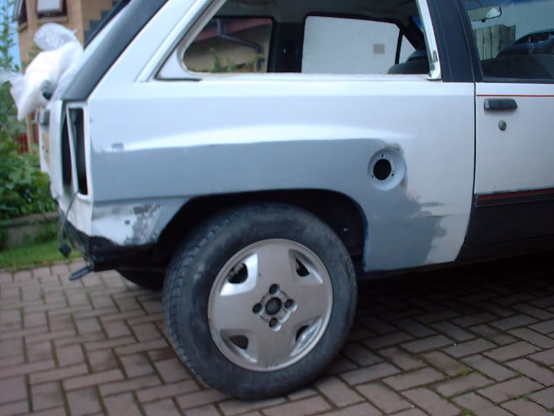

Started by sanding back arch.
http://img.photobucket.com/albums/v1...a/DSCF0083.jpg
http://img.photobucket.com/albums/v1...a/DSCF0082.jpg

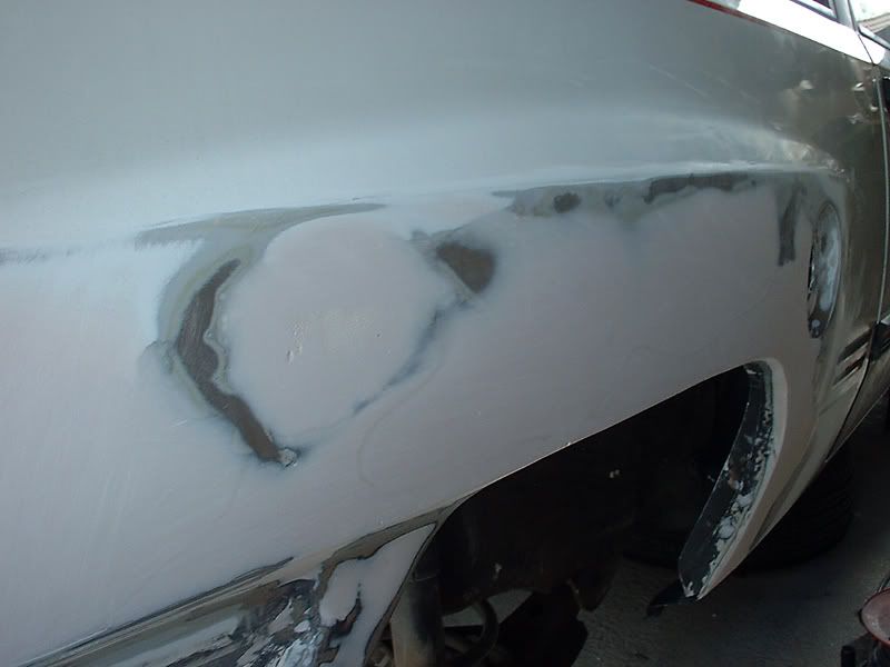

Initially came out well but there were some high spots so I applied another skim of filler and sanding back. I then applied a layer of "stopper". This is basically cellulose putty which is like very fine filler (like very thick paint). you spread it on and it seals the filler (which is pourous and has pin holes of air bubbles in it which can cause problems with paint).
http://img.photobucket.com/albums/v1...a/DSCF0099.jpg
http://img.photobucket.com/albums/v1...a/DSCF0100.jpg

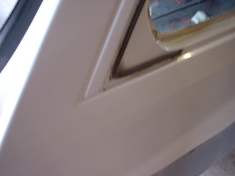

Whilst this cured I removed the rear 1.4 panel window. i notices a rust spot where the 1.4 frame had rubbed the paint.
http://img.photobucket.com/albums/v1...a/DSCF0092.jpg
This would also make spraying the rear easier. the rust spot was treated.

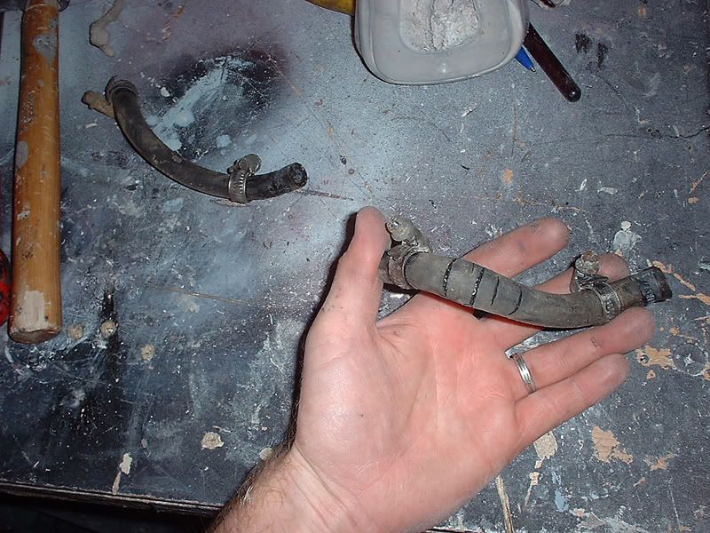

Whilst the stopper cured I also changed the fuel return and sender pipes.
My old ones were badly perished -
http://img.photobucket.com/albums/v1...a/DSCF0094.jpg
For reference the full sender is bigger then the fuel return (I think 6mm and 4mm diameter).

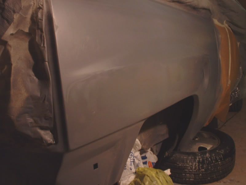

I then sanded the stopper back using fine wet and dry paper.
http://img.photobucket.com/albums/v1...a/DSCF0103.jpg

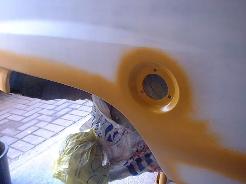

The whole panel was then sprayed with zinc primer.
http://img.photobucket.com/albums/v1...a/DSCF0107.jpg
http://img.photobucket.com/albums/v1...a/DSCF0106.jpg

I masked off the rest of the car leaving the rear 1/4 exposes and gave it several coats of white primer.
http://img.photobucket.com/albums/v1...a/DSCF0108.jpg

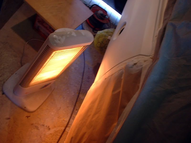

To speed up the drying process I used a heat lamp
http://img.photobucket.com/albums/v1...a/DSCF0118.jpg

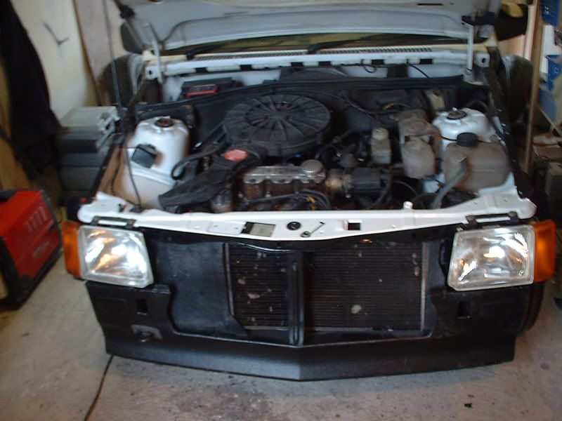

Whilst this was curing i reassembled the engine bay area. i needed to refit the radiator, refill the coolant, reattach the lights as well as weld up the hole under the drivers strut mount...
http://img.photobucket.com/albums/v1...a/DSCF0089.jpg
I also applied a little paint to the strut tops to make the bay look a little tidier.

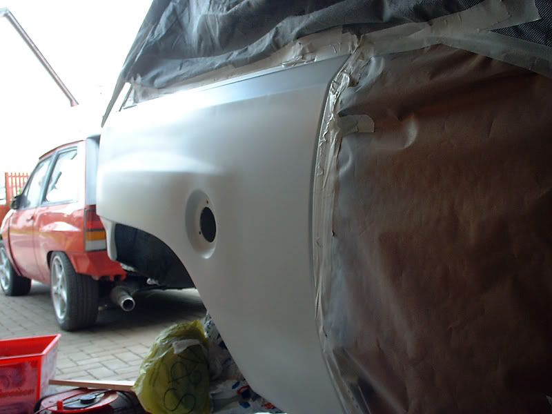

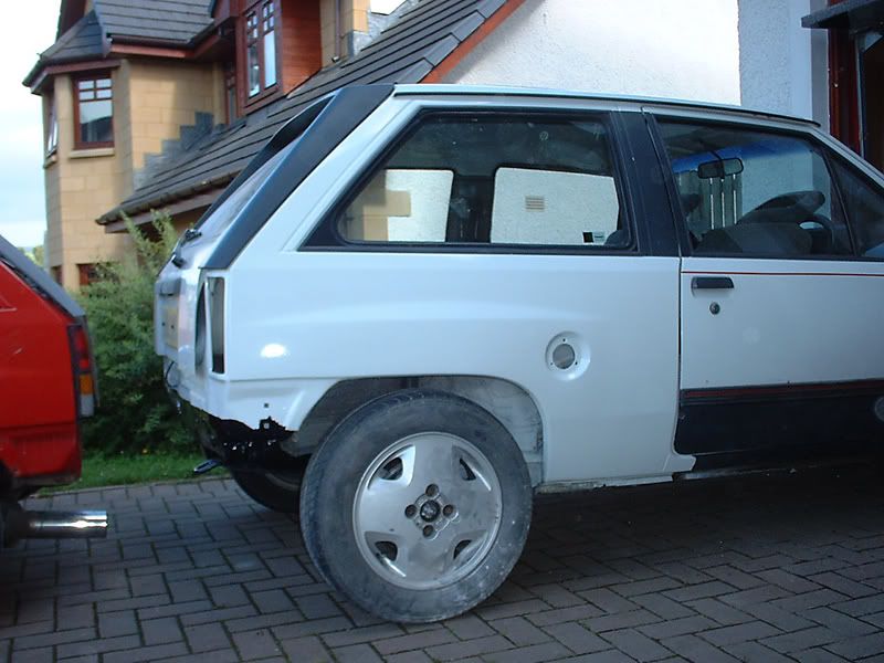

Once the primer was cured I flatted it back using 800 grit and then applied some high build primer in some areas I wasnt happy with.
http://img.photobucket.com/albums/v1...a/DSCF0110.jpg
This was cured further using the heat lamp and then a final coat of primer was applied.

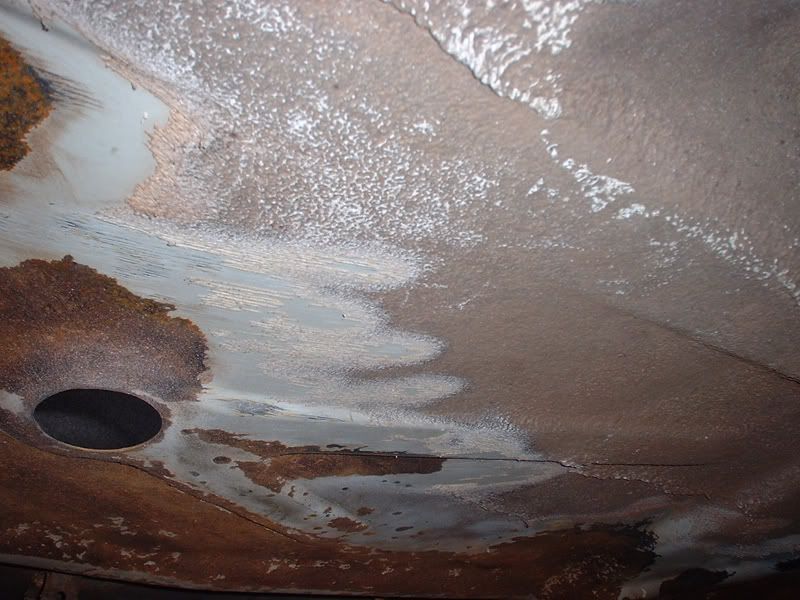

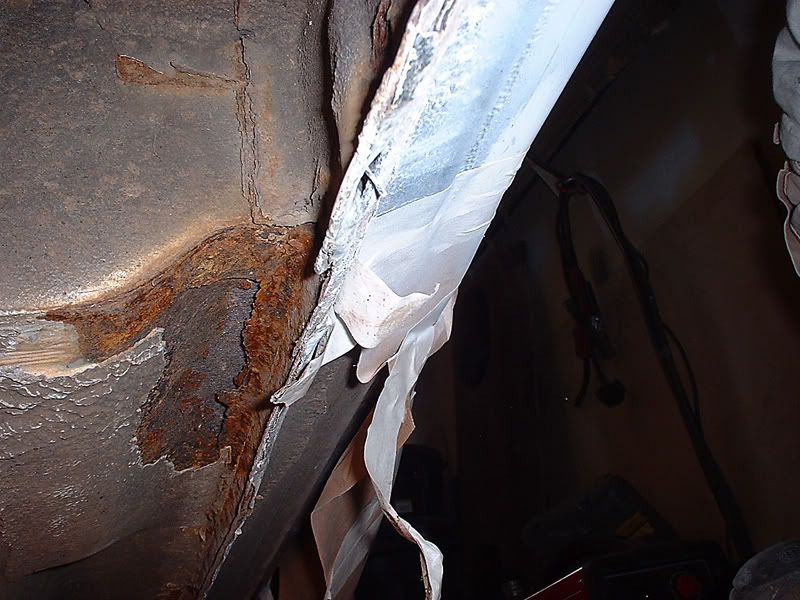

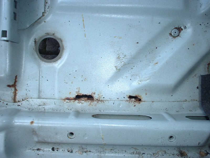

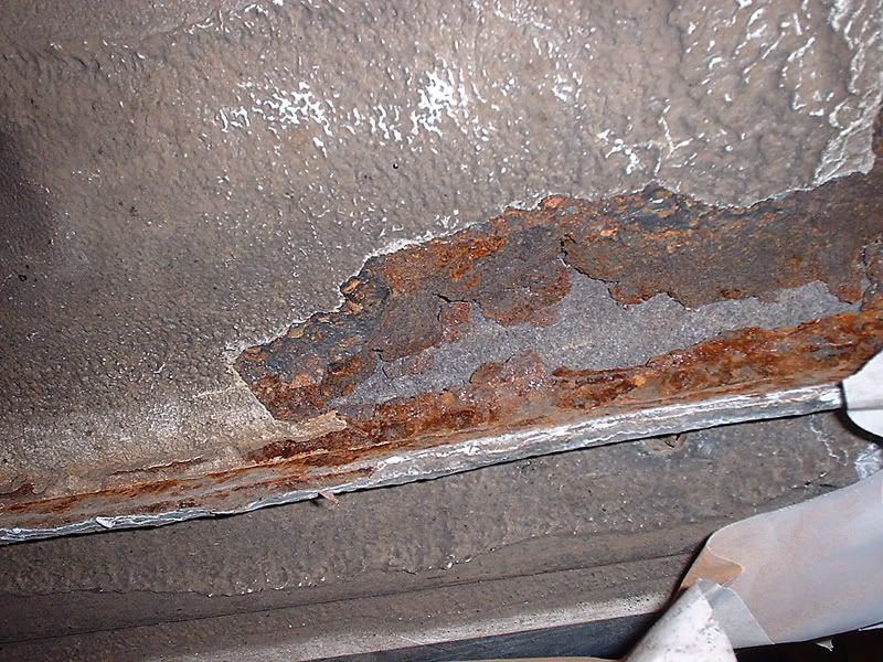

Whilst that was curing I poked about uinderneath. I noticed whilst replacing the fuel sender/return hoses that there was a fair amount of rust hidden behind old underseal. I started to pick away...I wish I hadnt...
http://img.photobucket.com/albums/v1...a/DSCF0120.jpg
there were holes!

went back to sanding the final layer of primer back uwing 800 grit. I did these last couple of stages using the paper soaked in a dilyuted mix of hot water and washing up liquid. this helps keep the panel greese free and the paper clog free.
http://img.photobucket.com/albums/v1...a/DSCF0115.jpg
http://img.photobucket.com/albums/v1...a/DSCF0117.jpg

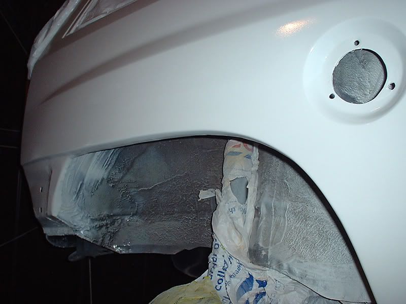

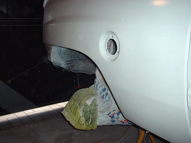

The panel was then thoroughly dried and the area masked off for the final time.

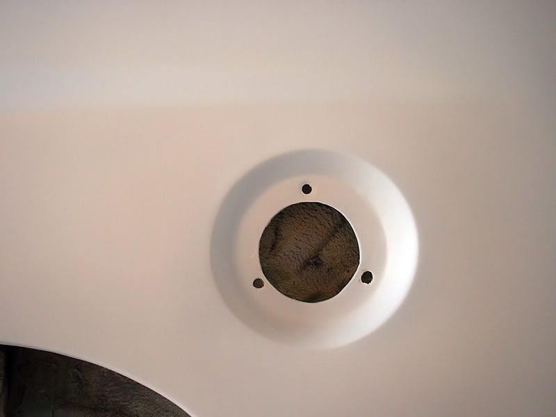

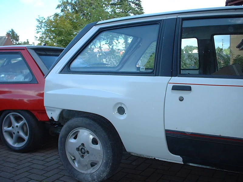

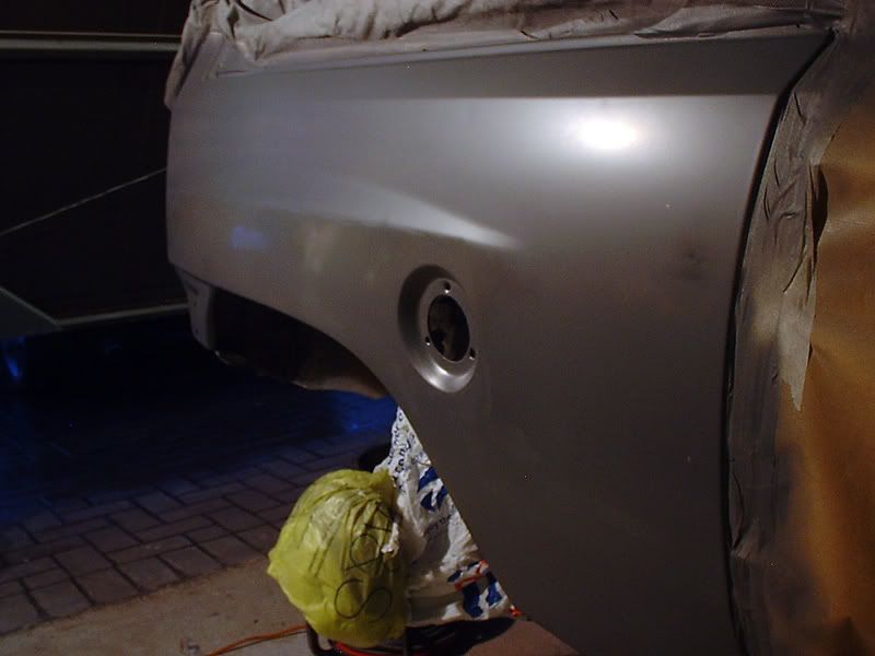

I then sprayed the rear 1/4 panel using 3 full cans of glazier white.
http://img.photobucket.com/albums/v1...a/DSCF0124.jpg
http://img.photobucket.com/albums/v1...a/DSCF0123.jpg
After a couple of hours and some seady application with the heat lamp the outcome was really good. It needs flatting back but I'm happy with the results...
http://img.photobucket.com/albums/v1...a/DSCF0125.jpg
http://img.photobucket.com/albums/v1...a/DSCF0126.jpg

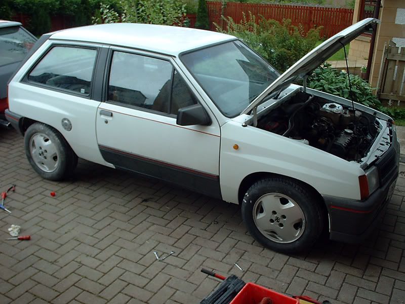

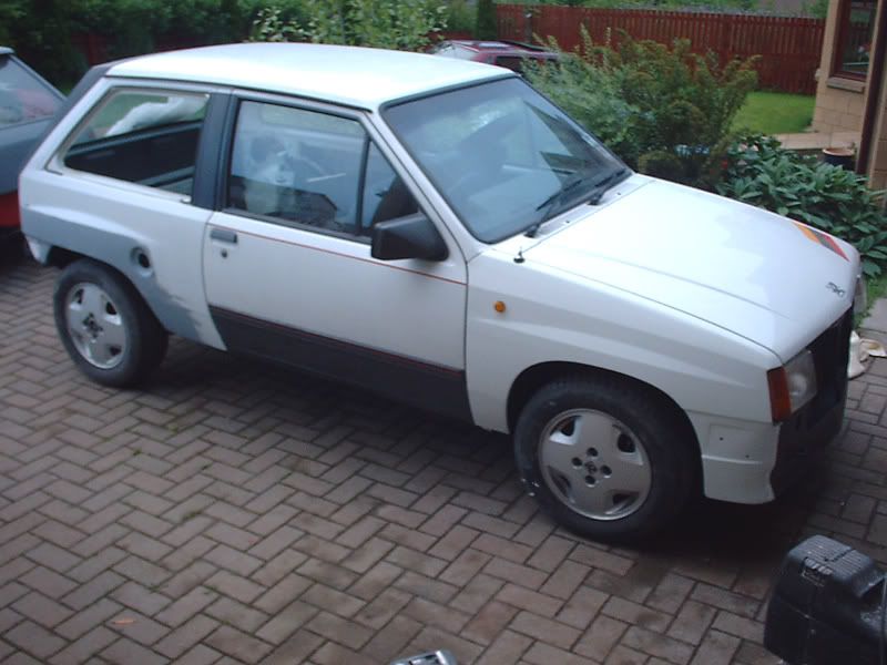

I then had to reassemble the front of the car.
I carefully fitted the wings -
passenger
http://img.photobucket.com/albums/v1...a/DSCF0097.jpg
driver
http://img.photobucket.com/albums/v1...a/DSCF0098.jpg
making sure the front edges were sealed with the slam panel.
I then refitted the bumper
http://img.photobucket.com/albums/v1...a/DSCF0128.jpg
I need to redo this because for some reason it wont sit flush the the ends of the wings (both sides) - the side clips are slipping for some reason...
I then sealed the gap between the inner and outer arches and applied a healthy amount of seam sealer all along the inside of the arch and down the join by the filler neck...
The next task is to sort out the rust underneath the car...those holes were right on the sill...

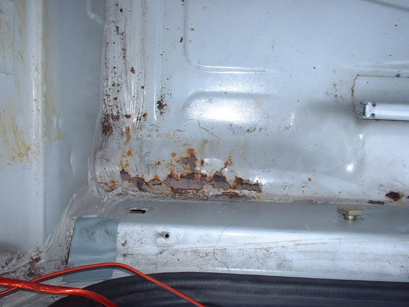

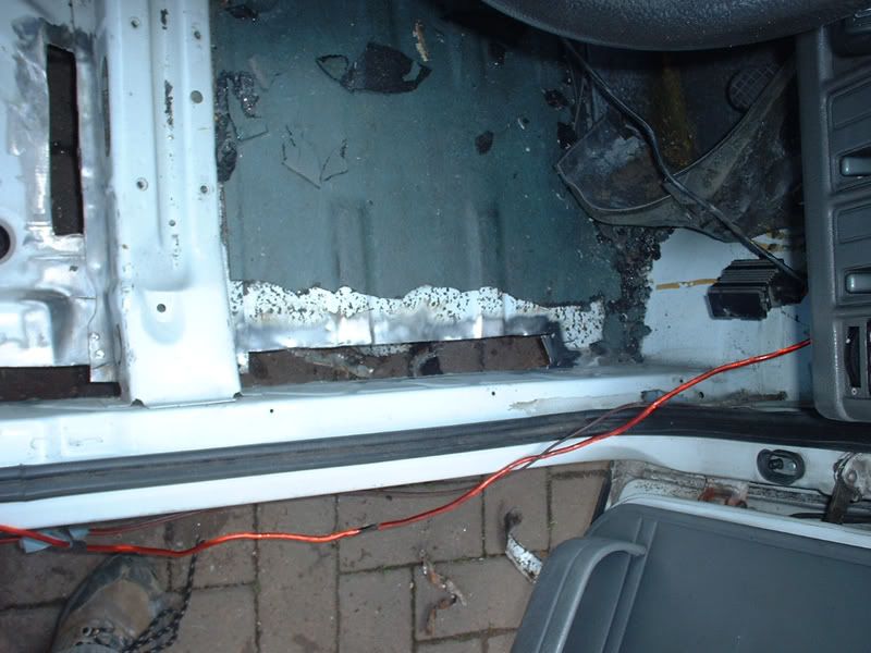

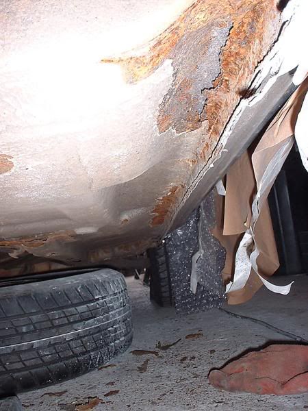

This weekend I planned to cut out the rust and holes I discovered under the floor pan by the drivers sill.
http://img.photobucket.com/albums/v1...a/DSCF0119.jpg
http://img.photobucket.com/albums/v1...a/DSCF0121.jpg

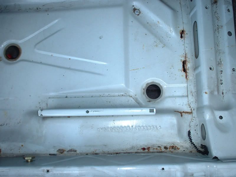

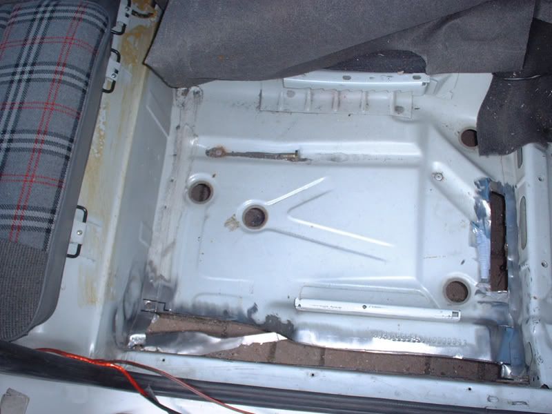

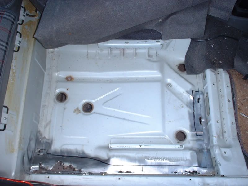

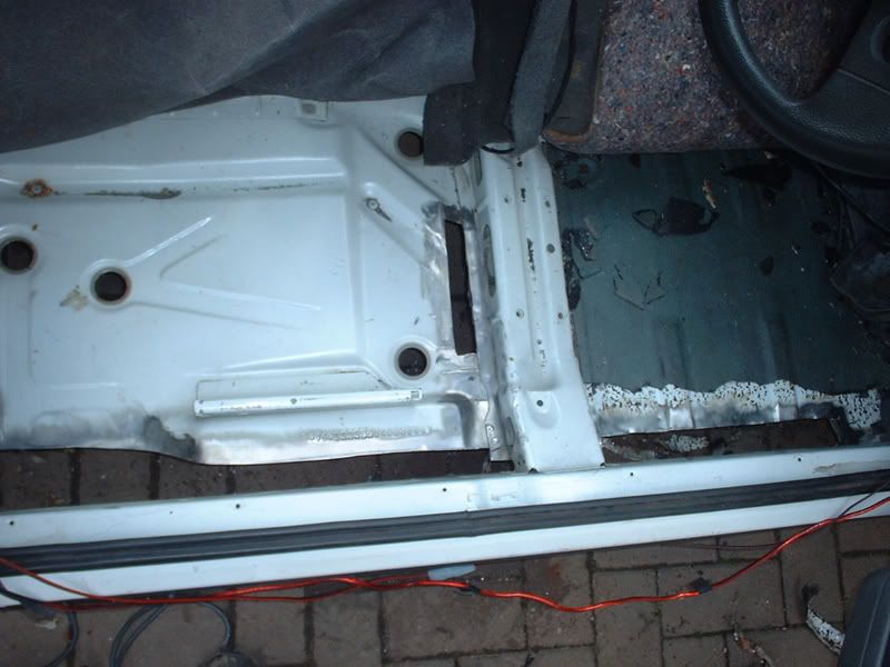

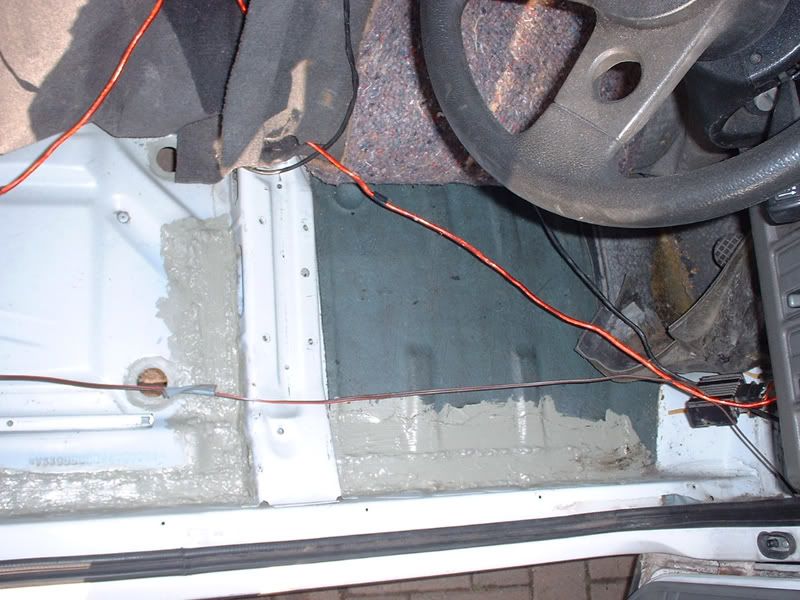

I removed the seat and carpet and it didnt look too bad from inside but I knew it was paper thin-
http://img.photobucket.com/albums/v1...DSCF0001-1.jpg
http://img.photobucket.com/albums/v1...DSCF0002-2.jpg
http://img.photobucket.com/albums/v1...DSCF0003-2.jpg

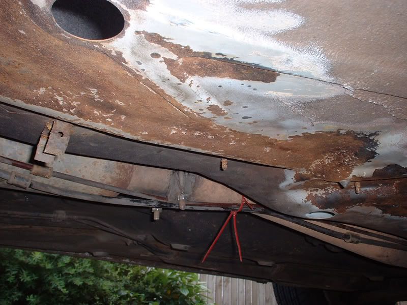

In addition it looks like Vauxhall in their wisdom thought it'd be okay to shrimp on the rust proofing underneath...
http://img.photobucket.com/albums/v1...DSCF0007-2.jpg
http://img.photobucket.com/albums/v1...DSCF0006-2.jpg
After cleaning off wehat was left of the rust proofing underneath to find good meetal and then cleaning up the inside to do the same I marked out the area to be removed -
http://img.photobucket.com/albums/v1...DSCF0005-3.jpg

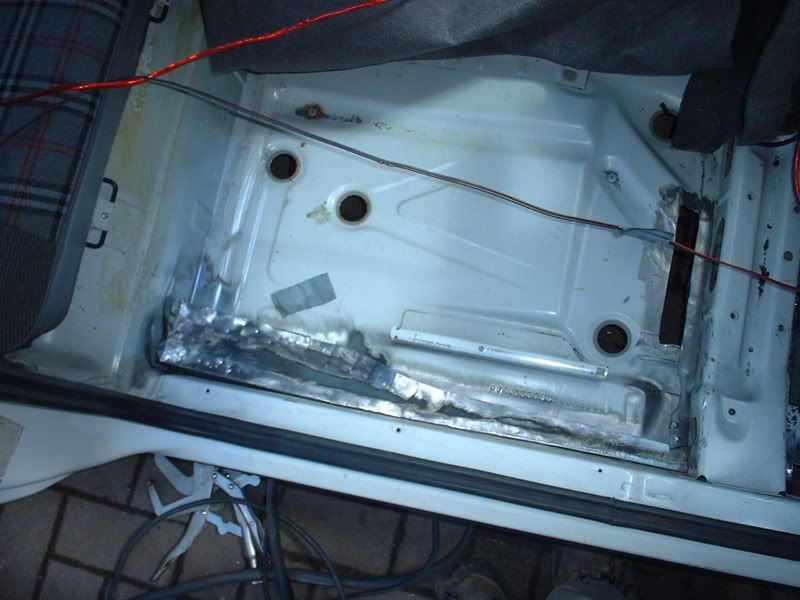

I ensured the fuel lines were tied well out of the way (see above pics and red tie backs) and brought the grinder out to play
http://img.photobucket.com/albums/v1...DSCF0011-2.jpg
http://img.photobucket.com/albums/v1...DSCF0010-1.jpg
http://img.photobucket.com/albums/v1...DSCF0008-2.jpg
I then made a card template and cut the new sections out of an old wing -
http://img.photobucket.com/albums/v1...DSCF0009-1.jpg

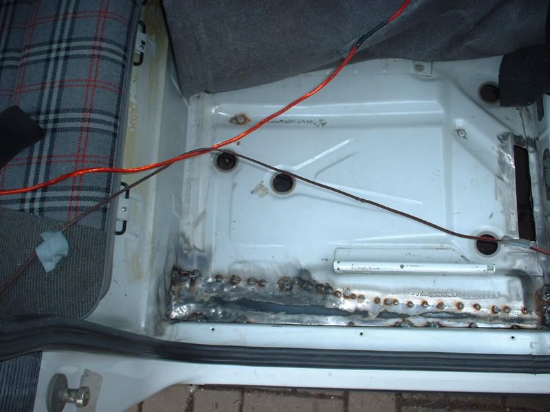

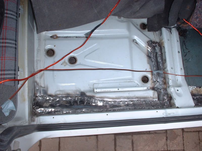

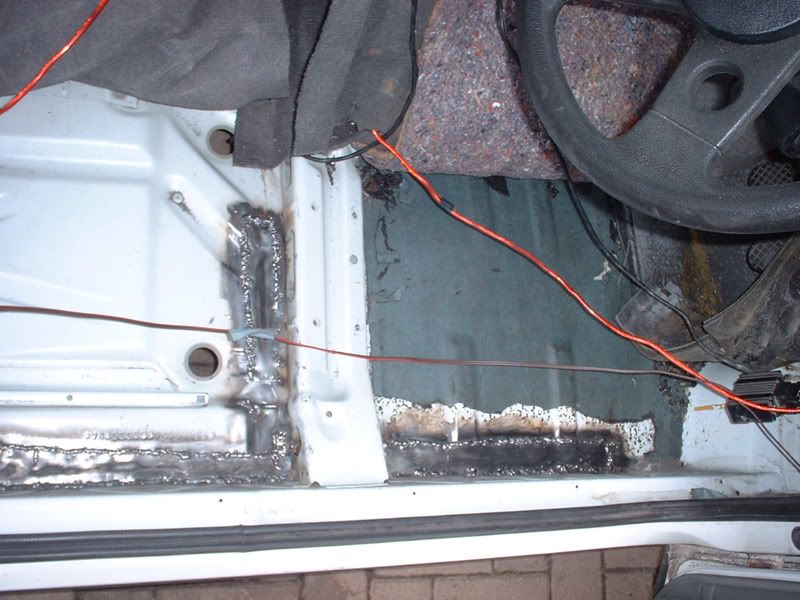

After cleaning up and removing the paint I fettled it so it was a good fit. The new panel will be an l shape with the L section bonded to the sill, and the rest filling the gap - it will be seam welded to the top edge of the sill and around the existing hole then seam sealed flush from underneath after getting a good dose of etch primer.
One of the new panels fettled in place
http://img.photobucket.com/albums/v1...DSCF0012-3.jpg
And then tack welded it in, fellting as I went to ensure a solid fit -
http://img.photobucket.com/albums/v1...DSCF0013-2.jpg
By this time it was 6pm and time for Tea!
Sunday 20th July 2008
More welding today - much to the disgust of the missus who made the comment - "I thought this car was rust free and was your daily runabout that you werent ever ging to mess with!"
I promised I'd be finished by 12pm so I could do stuff with her for the rest of the day - which would have been the case if I hadnt run out of wire mid way through!
:mad:lol
Anyway - managed to wangle more wire and finished the welding up -
http://img.photobucket.com/albums/v1...DSCF0015-4.jpg
http://img.photobucket.com/albums/v1...DSCF0016-2.jpg
http://img.photobucket.com/albums/v1...DSCF0017-2.jpg

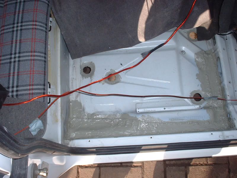

This was cleaned up, etch primed (inside and out) and seam sealed...

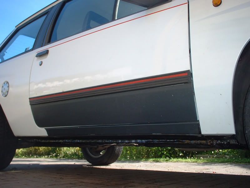

Once this had cured ther outside and underside were painted with chassis black. prior to this the underside had been doused with rust remover
http://img.photobucket.com/albums/v1...DSCF0021-3.jpg
All I need now is to shutz the underside and then check the passenger side - but thst can wait a week or three...
