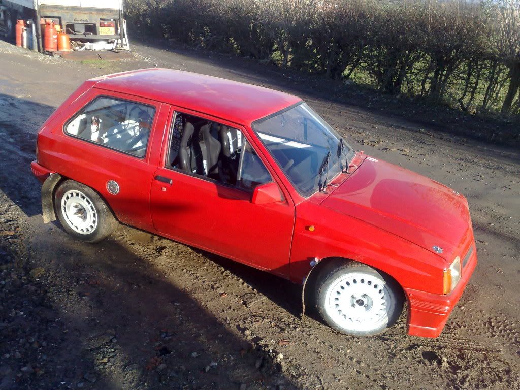

Mines still in the same state, haven't got the money to repair it ATM. Liking the wheels, wouldn't mind some myself.

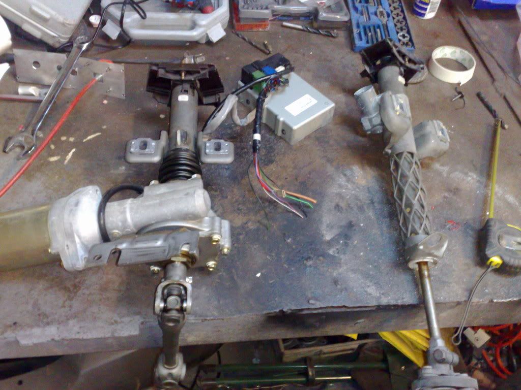

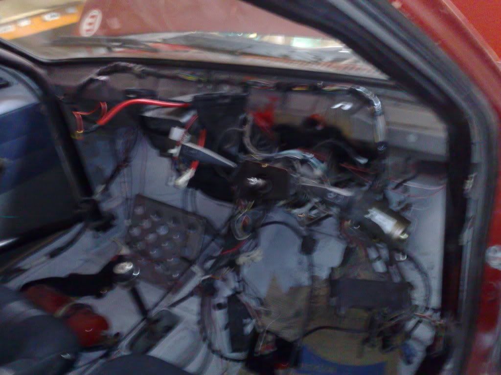

Been ages since i updated this, i managed to drive it the other day, and no matter what i messed about with the steering it was undriveable was just so heavy!! so a trip to the scrap yard and i eneded up with corsa b EPAS
http://i46.photobucket.com/albums/f1...2102008098.jpg

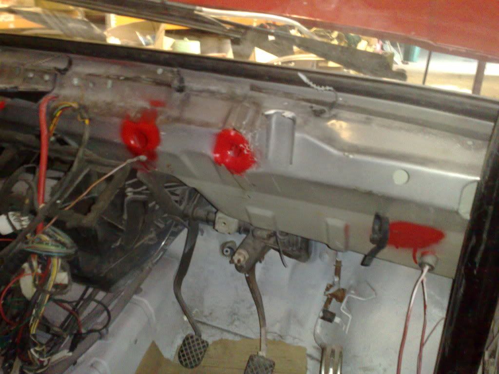

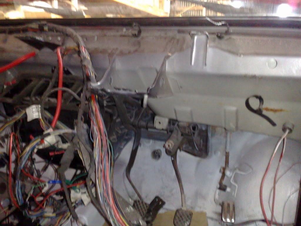

ripped dash out and got all wiring out of the way
http://i46.photobucket.com/albums/f1...3102008101.jpg

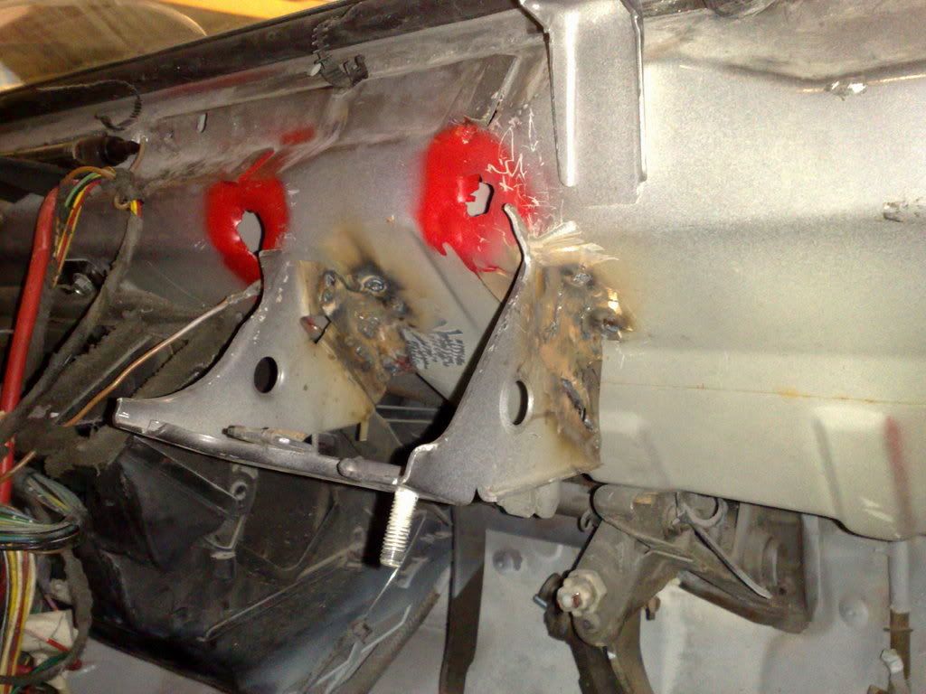

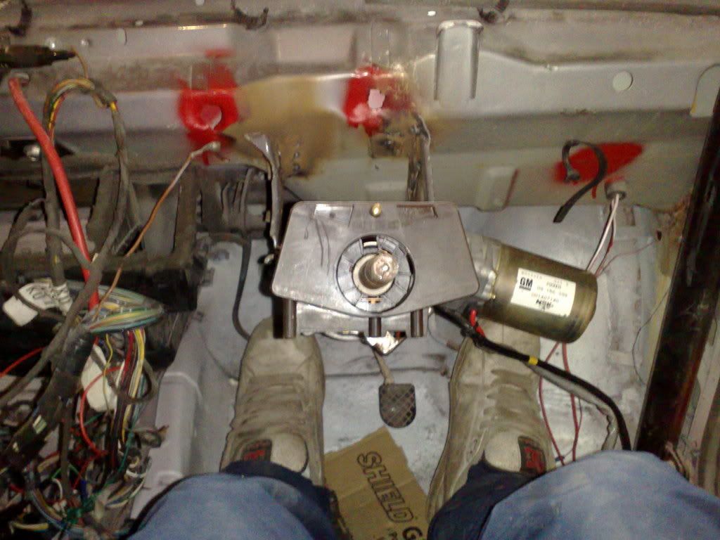

and set about bashing steering colum upper mount off the car
http://i46.photobucket.com/albums/f1...3102008102.jpg
note breifly i wasnt feeling in the mood to do a clean job of it so took a big hammer to it!!
After a big of boding to the bracket i tacked it back in place roughly where should be
http://i46.photobucket.com/albums/f1...7102008115.jpg
which was spot on
http://i46.photobucket.com/albums/f1...7102008116.jpg
http://i46.photobucket.com/albums/f1...7102008117.jpg
Not gonna lie, after id taken colum mount off and seen wiring all there in a big mess i thought id gone in a bit deep but wasnt to bad!

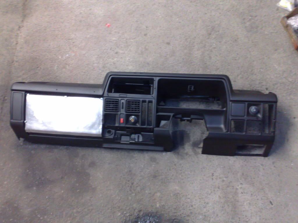

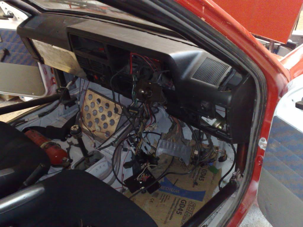

Sprayed dash board black while it was out
http://i46.photobucket.com/albums/f1...4102008105.jpg

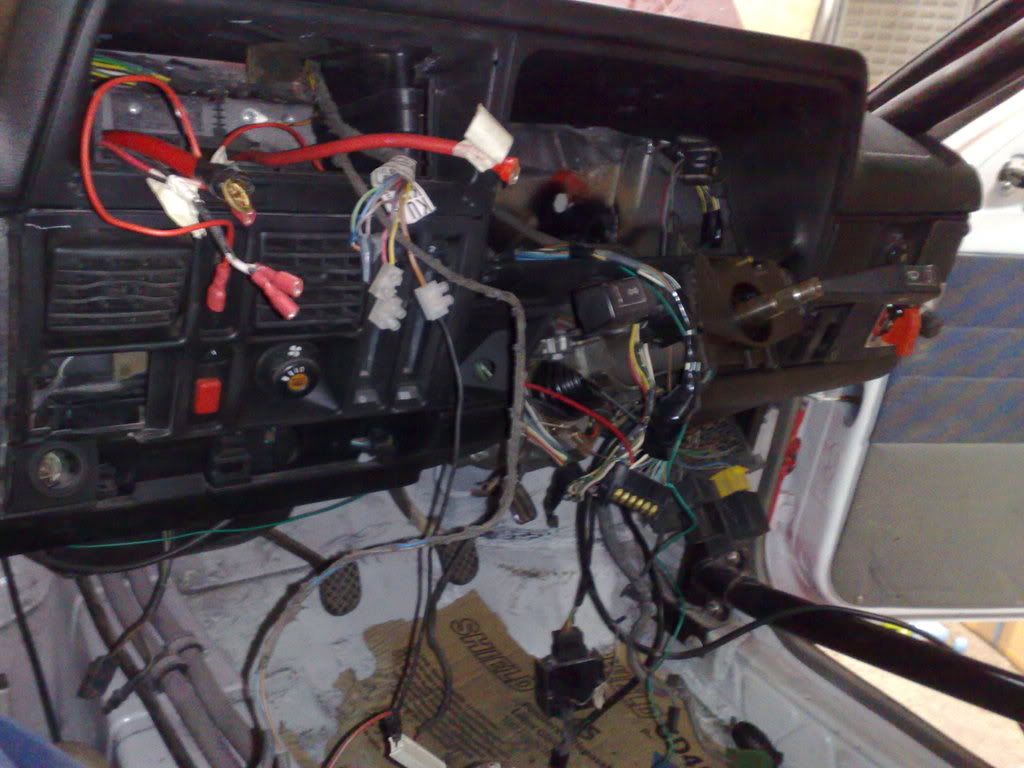

and then back in the car with power steering in ready to be wired up
http://i46.photobucket.com/albums/f1...9102008130.jpg
http://i46.photobucket.com/albums/f1...9102008132.jpg

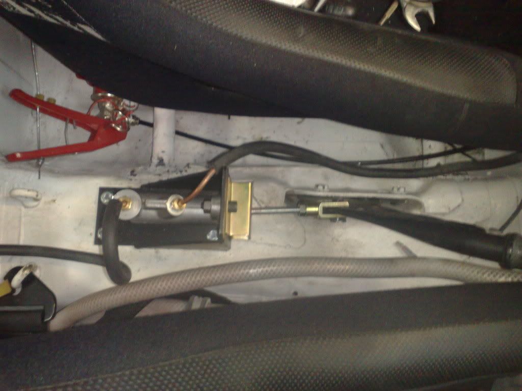

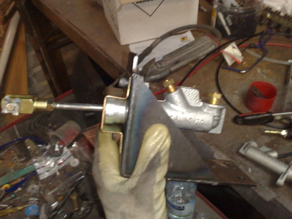

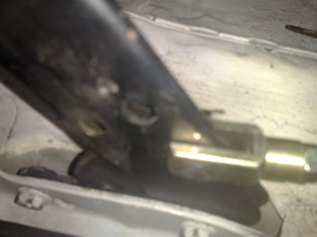

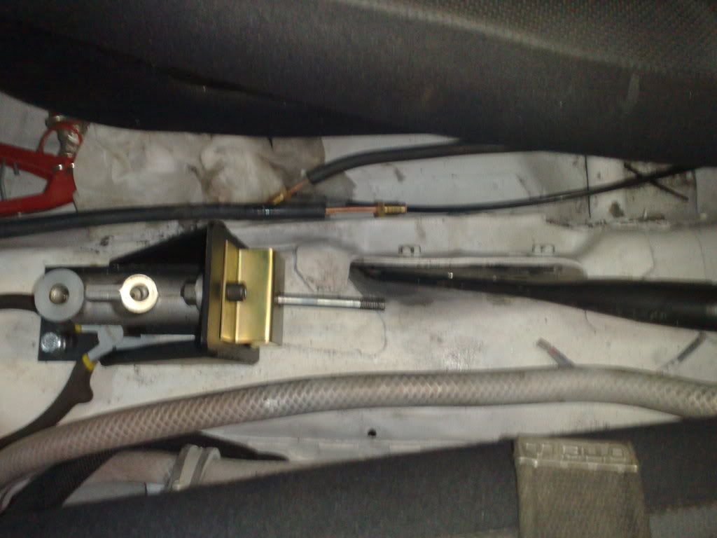

also while trying to sort brakes out i changed one of the master cylinders on the bias pedal box, so i was left with a master cylinder, so i decided to try and bodge a hydraulic handbrake, got the master cylinder mounting bracket
http://i46.photobucket.com/albums/f1...0092008071.jpg
and bolted into the car
http://i46.photobucket.com/albums/f1...3092008072.jpg
i drilled the lil catch that locks the handbrake up when you pull it up so will need to make a stay to hold handbrake on but then i was able to have handbrake up at a higher angle
http://i46.photobucket.com/albums/f1...5092008075.jpg
http://i46.photobucket.com/albums/f1...5092008074.jpg
and note breifly dont know who is eagle eyed enough but as it is in that picture is wrong, brake lines should be other way round which is all changed now!

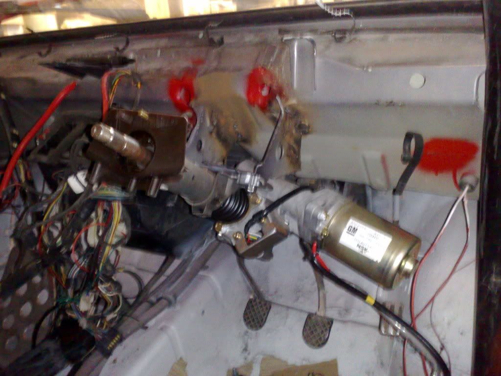

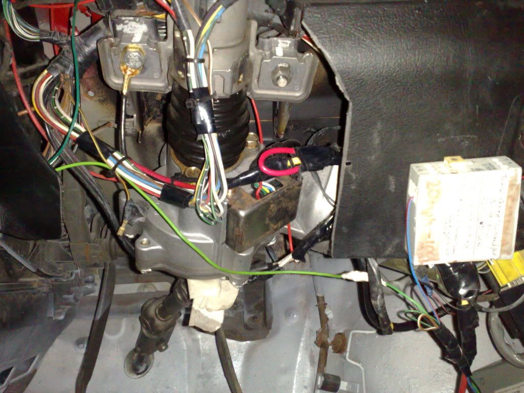

You might wanna rig some kind of support bracket up for the epas motor there bud as there will be a lot of force trying to twist that thing so bracing would probably be a good idea as you wouldnt want it to part from the bulkhead at speed!
There is a bracket a bit lower down which i forgot to take a pic of which bolts it to the bulkhead, its in there solid, but one round the motor wouldnt hurt, better safe then sorry!

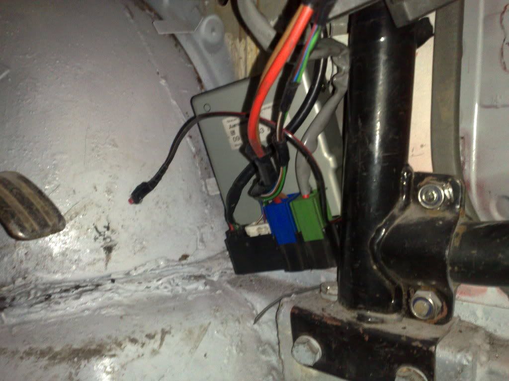

Epas is all in and working
http://i46.photobucket.com/albums/f1...4122008330.jpg
bit of wiring needed to be hiden away and the box on the right is the simulator (thanks Iain)
where the brains of the pump will be tucked away http://i46.photobucket.com/albums/f1...4122008331.jpg
http://i46.photobucket.com/albums/f1...5122008343.jpg

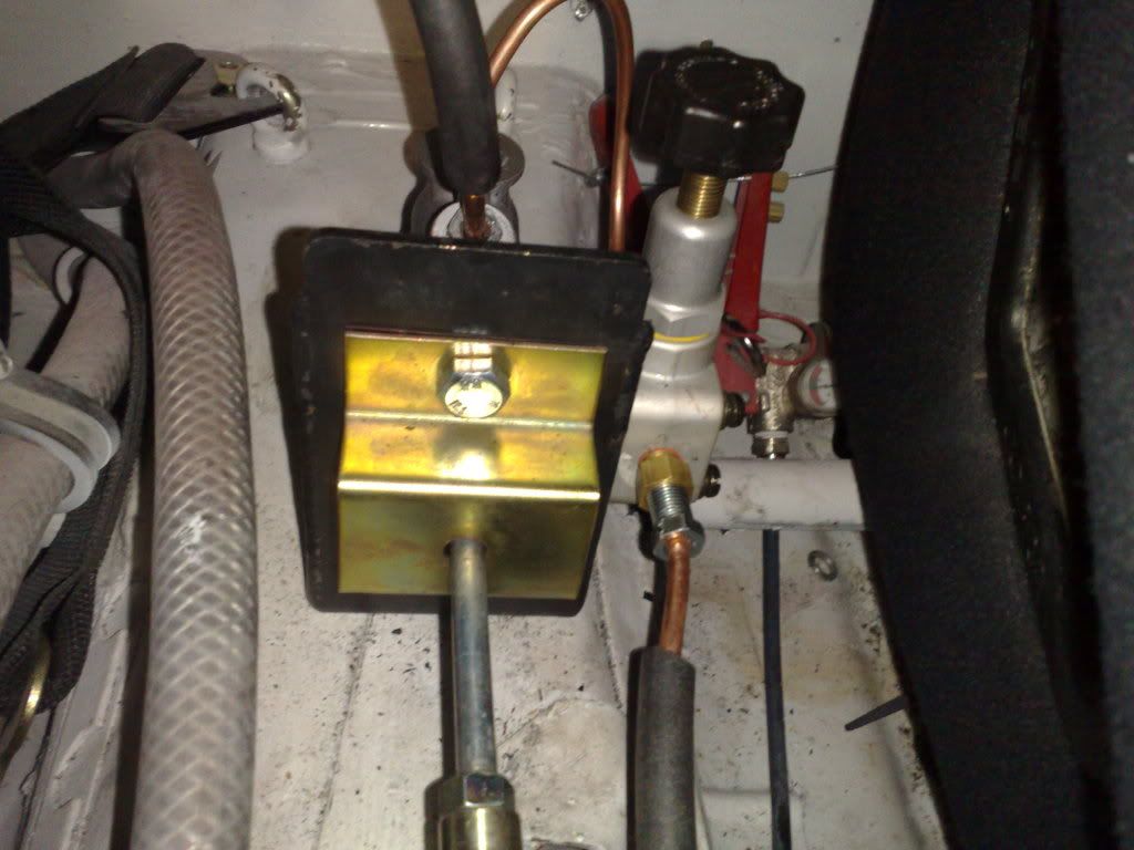

Willwood proportioning valve to try and stop rear brakes locking up before the fronts!!

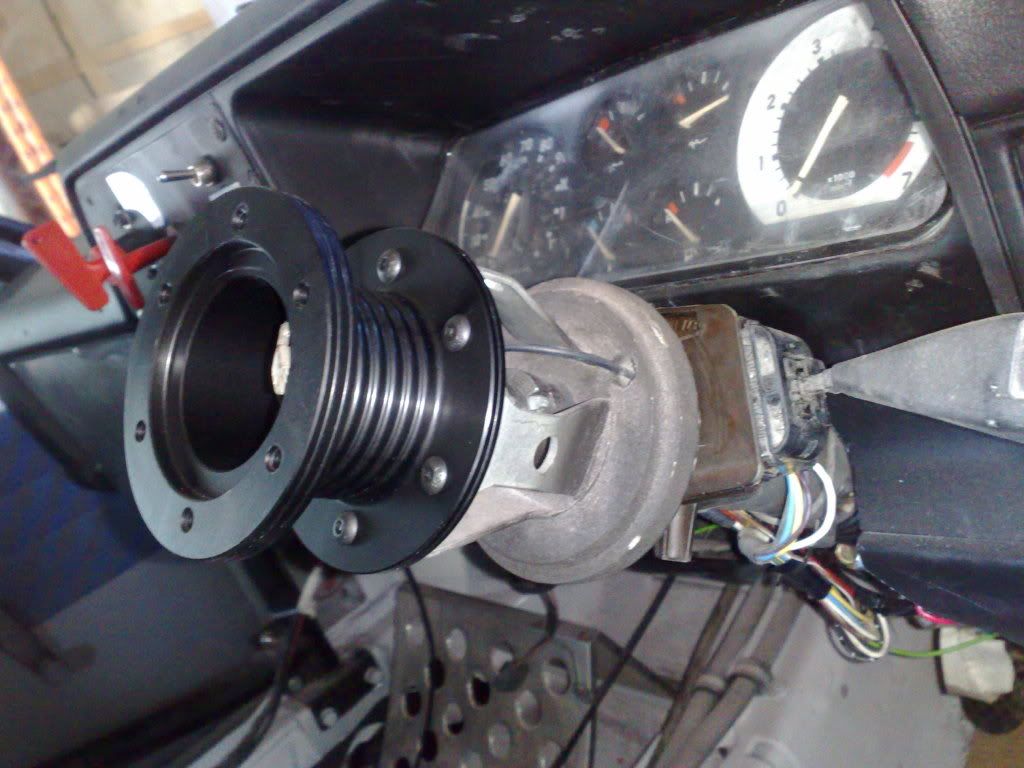

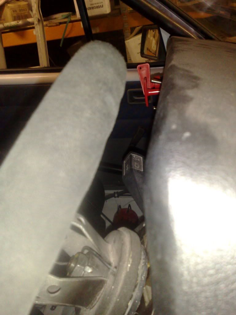

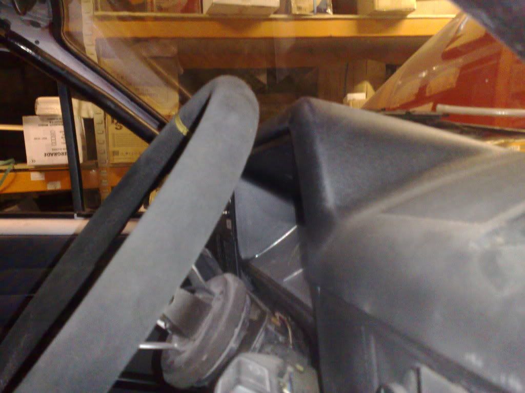

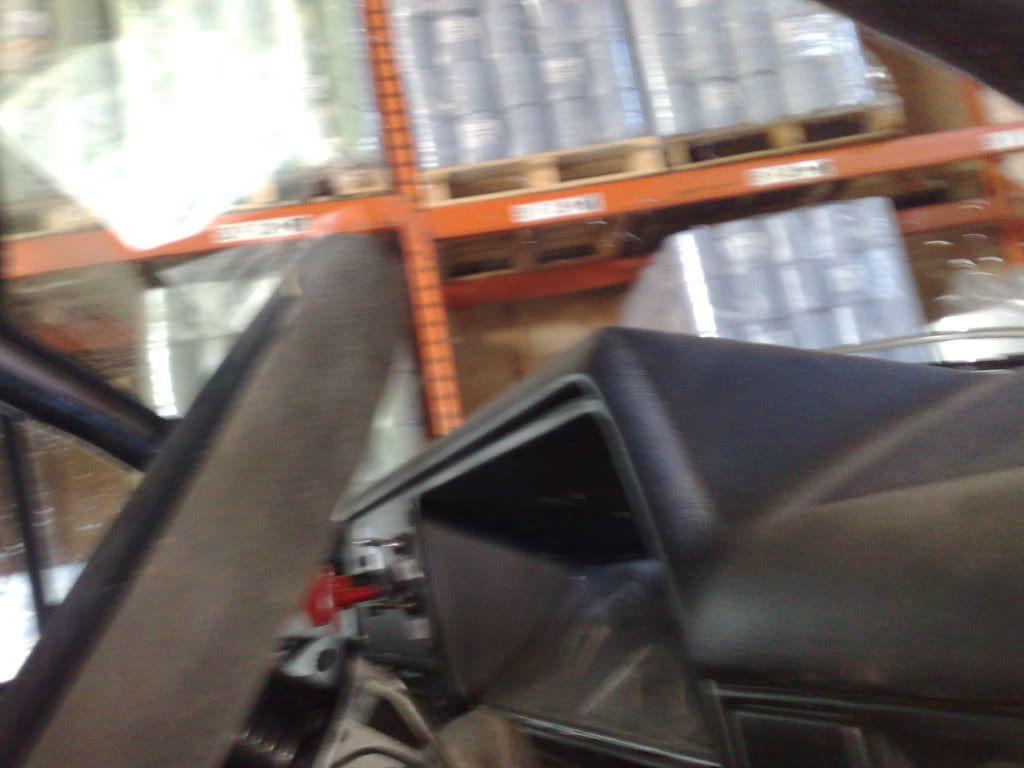

And a slight problem with steering wheel.
http://i46.photobucket.com/albums/f1...5122008349.jpg
http://i46.photobucket.com/albums/f1...5122008348.jpg

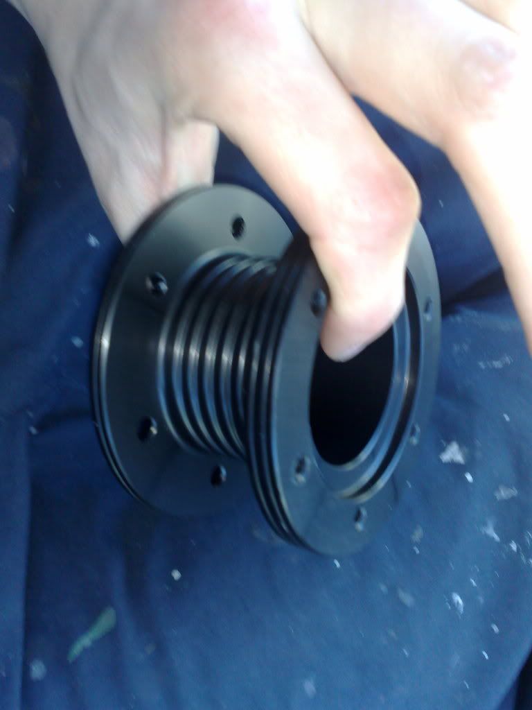

Bit tight, hand keeps catching dash, so have got a spacer on its way to make life easier!

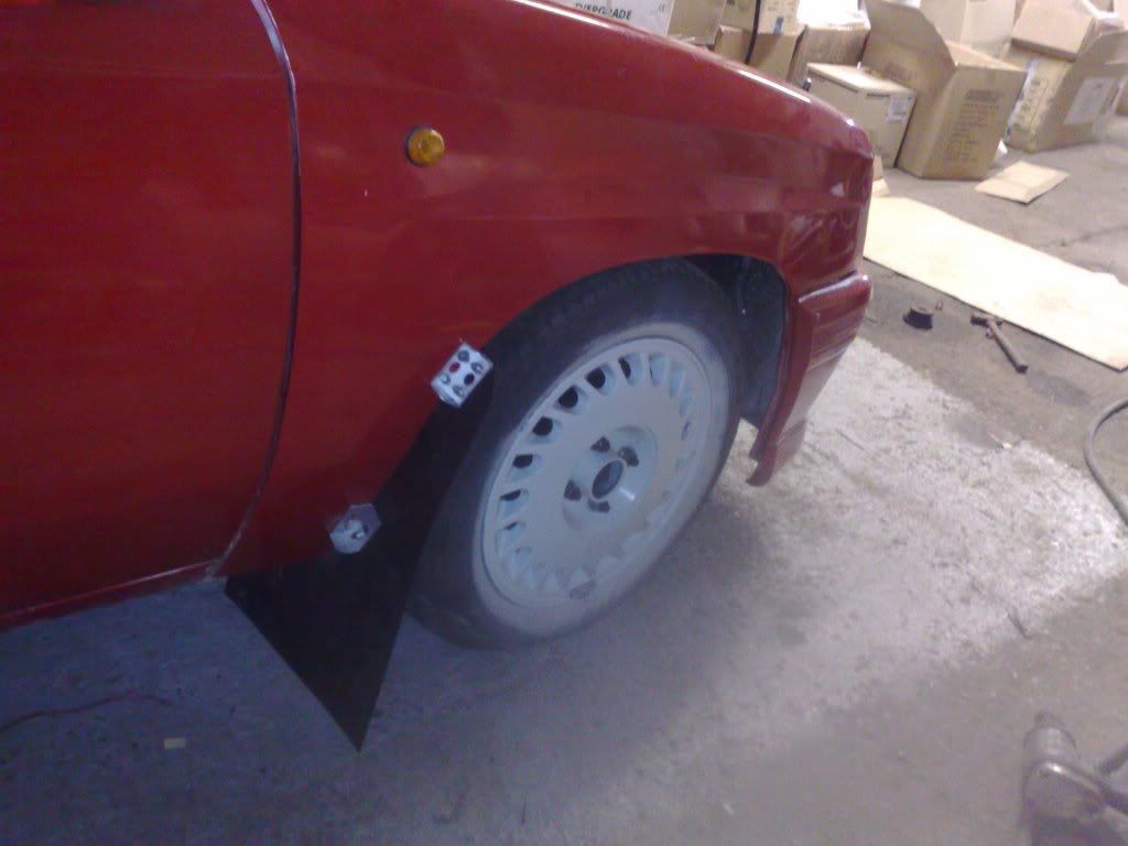

Mudflaps.....

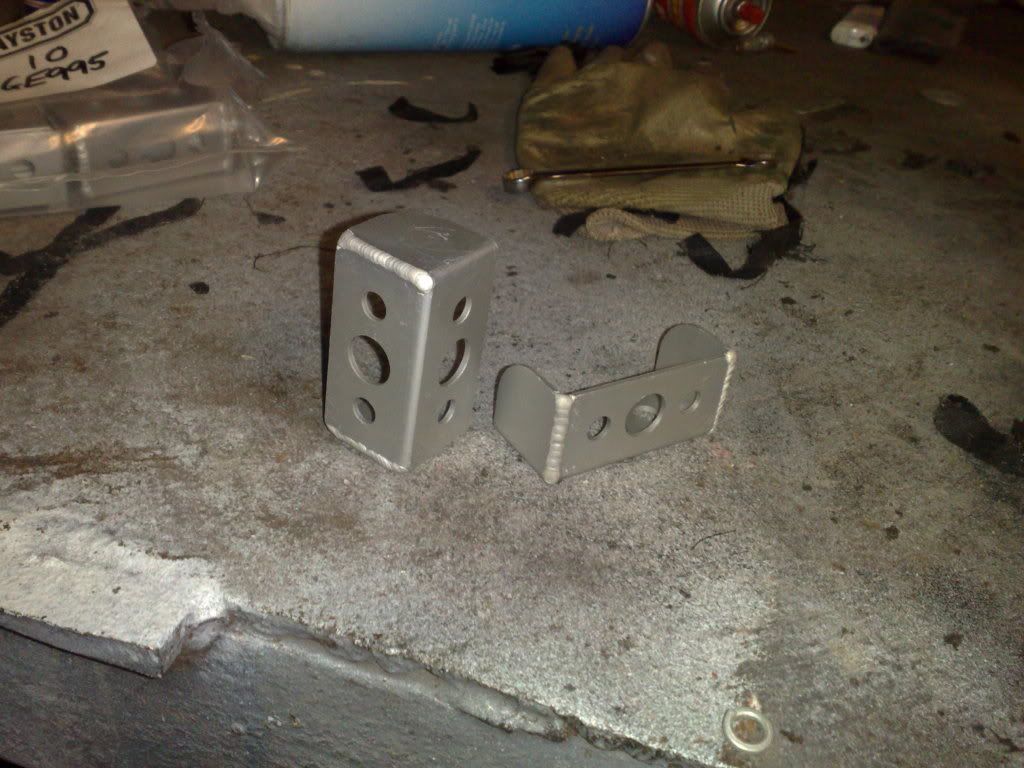

Alloy brackets
http://i46.photobucket.com/albums/f1...4122008332.jpg

Steering wheel extension thingy came in local supplier today so went picked it out and stuck it straight on.
http://i46.photobucket.com/albums/f1...6122008366.jpg
http://i46.photobucket.com/albums/f1...6122008367.jpg
anmd there is now plenty of room, steering wheel is in quite a nice position actually, maybe a lil to high but will get used to it.

and thought id actually let her see some daylight and get a couple pics (car is dusty as hell)
http://i46.photobucket.com/albums/f1...6122008361.jpg
http://i46.photobucket.com/albums/f1...6122008362.jpg
http://i46.photobucket.com/albums/f1...6122008360.jpg

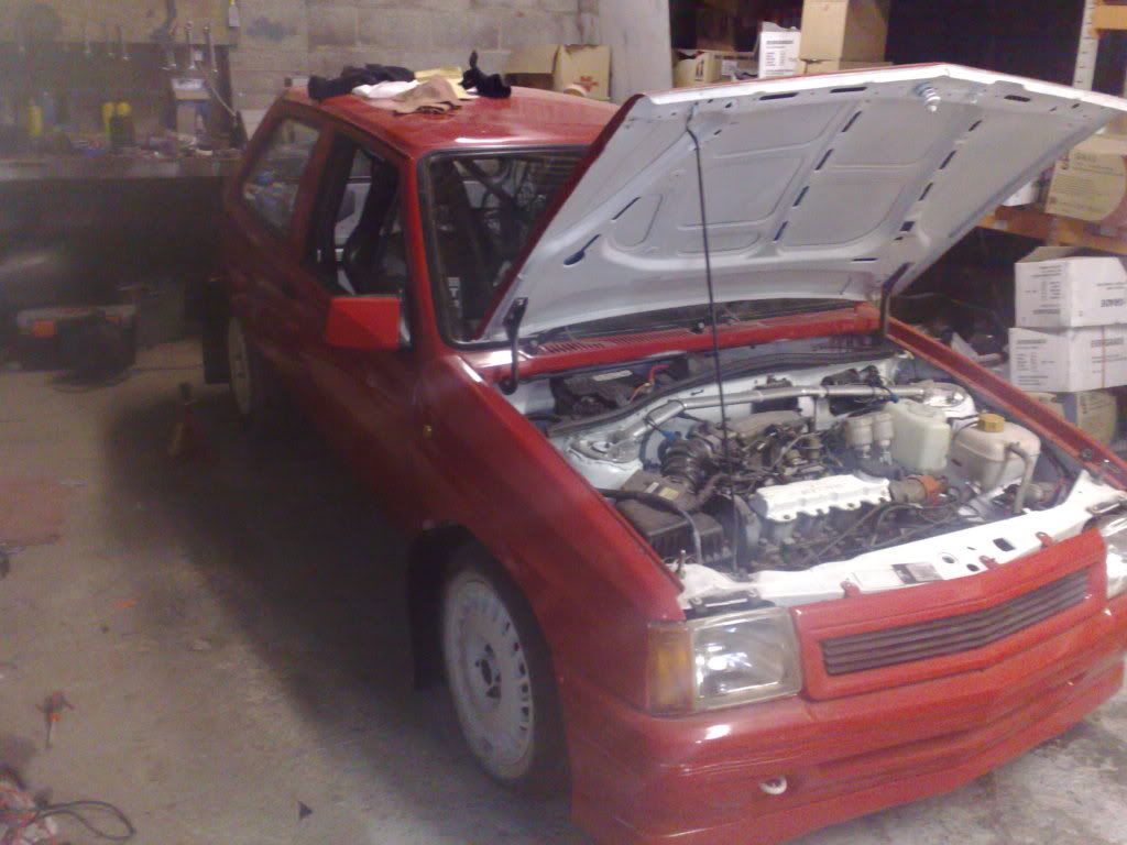

Blasted it with the jet wash, then stuck it straight back inside to dry and will give a good clean and polish inside and out, just the rear breaks to sort out....still
http://i46.photobucket.com/albums/f1...6122008369.jpg
