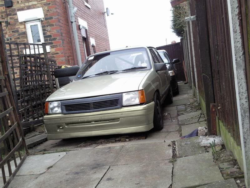

I did say i was 50/50, theres something about it that i dont like. Maybe a body coloured grill would look better...
bumper looks well imo ad!

Side strips would need to go IMO for it to "work" though?
Yeah i know what you mean mate. Only issue is there clip on, meaning im going be left with clips/holes down the side of the car. Was thinking of just removing them, painting them bumper colour and refitting.....
I think the bumpers would go well with the mouldings ad i like the bumpers in the colour they are already what colour was you thinking of doing them?
Similar colour tbh, actually probably the same colour as the front is now lol
I think it would go then mate IMO if you removed the mouldings the side would look too bold they kind of break up the colour if you know what i mean lol.Quote:
Originally Posted by Adam
5 hours later ive read the whole thread! serious amount of work on both cars, love it :D
Bumper looks loads better. How about painting below the side rub strips as well SR style, that would work.
Yea agreed ^^^^ that would tie everything in IMO too.Quote:
Originally Posted by Lee H
Looks good with the later SR front end :)

I prefer it as it is now tbh
Cheers for the 'shops Southie. Still preferring the all dark front end.
Vinyl down the sides is a good plan although ive never really been a fan of it, no vinyl/sidestrips looks better IMO, but my strips are staying so i'll have to think about what do.

Sorry to here about the go tech issues dude, as for the front end, i like the look of it...BUT it makes your car look less street sleeper, and i liked the early sleeper look yours was/is pulling off with the normal bumper on.
Just my opinion.
Disco-Ive got a few more things to try before writing it off, cheers to Mark B @ Jamsport for his advice.
Scott-Yeah i get exactly what you mean mate, but im a bit bored of the look atm, so need do something change it.... :)
IF you want something different, try the early style grill the count had on his saloon, the square checked one, and the GTE bumper but not painted, just looks gash to me! lol
Maybe it needs a pin strip through the bumper, trims & rear bumper?
I prefer the bumper. I wouldn't paint it.
I have a red pinstripe all round...
If i fitted the gte front that would be getting a red stripe too :)
keep the gte/sr front, look's much better, and get the GTE rear bumper flick too :)
