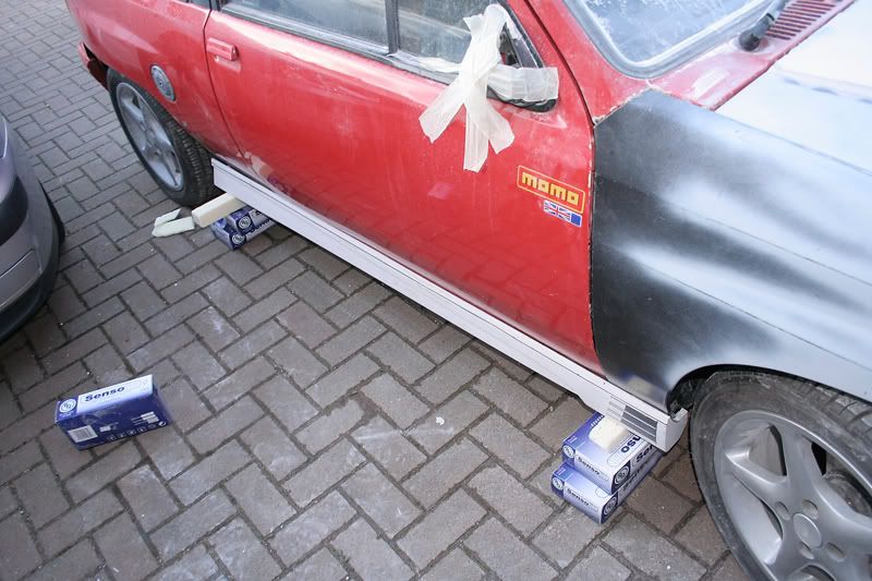

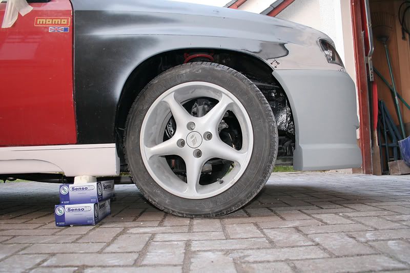

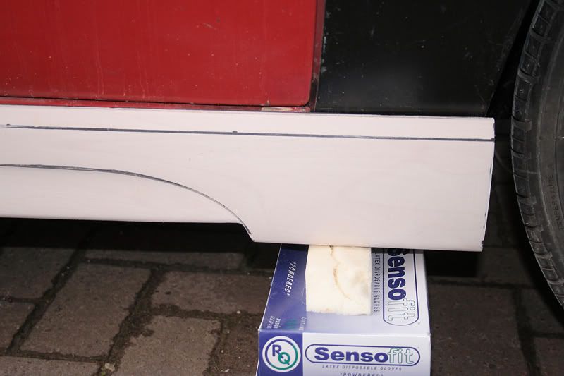

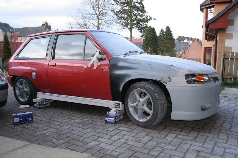

As promised, heres some pics of one of the side skirts.
I've spent the last week working on both sides and this one is almost finished. Some tinkering to do but it's been separated from its wooden board and apart from the vent detailing it's pretty much ready for priming and final finishing ready for the mould.
Based on feedback and if the mold comes out okay I may flog these (and the rear bumper if it comes out okay)....

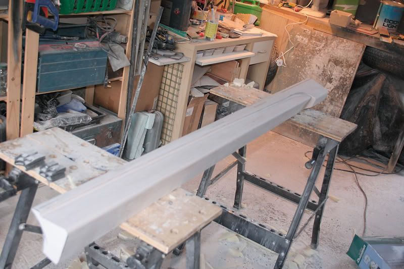

basic skirt
http://img.photobucket.com/albums/v1...rtsfil0010.jpg

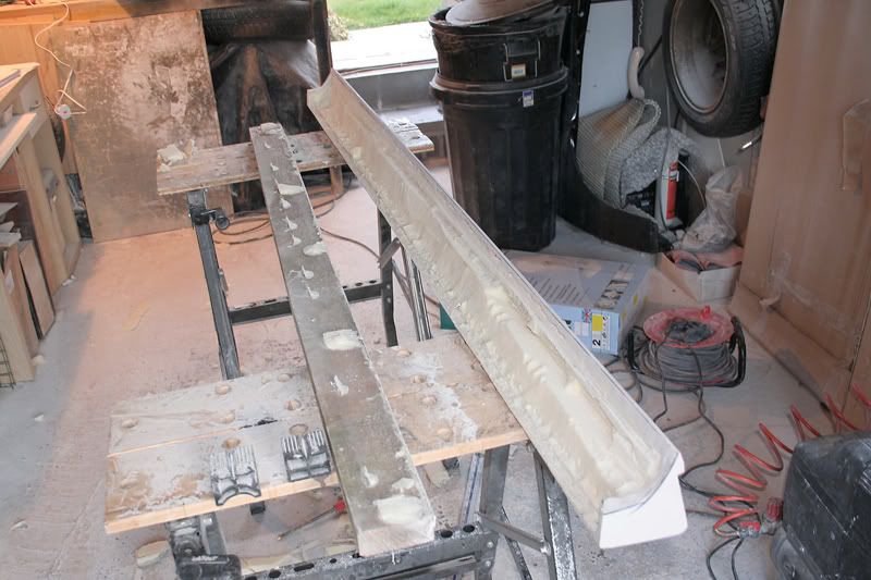

inside (foam core - some of it removed)
http://img.photobucket.com/albums/v1...rtsfil0011.jpg

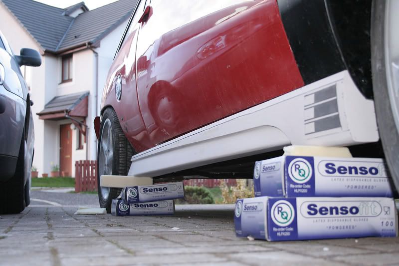

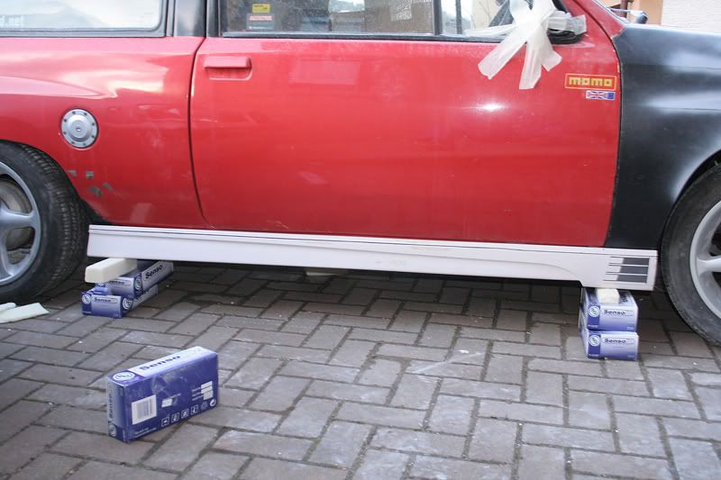

test mounted to the car
http://img.photobucket.com/albums/v1...rtsfil0012.jpg
http://img.photobucket.com/albums/v1...rtsfil0021.jpg
http://img.photobucket.com/albums/v1...rtsfil0019.jpg
http://img.photobucket.com/albums/v1...rtsfil0022.jpg

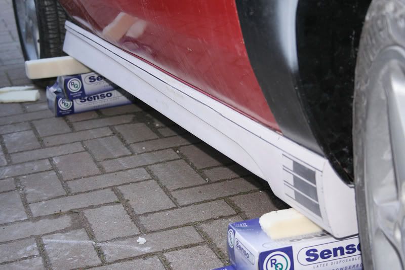

aligned with front bumper height
http://img.photobucket.com/albums/v1...rtsfil0015.jpg
http://img.photobucket.com/albums/v1...rtsfil0006.jpg

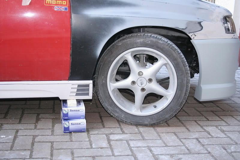

side on
http://img.photobucket.com/albums/v1...rtsfil0014.jpg
close up (less detailing)
http://img.photobucket.com/albums/v1...rtsfil0005.jpg
The penned in detailing will be routed out to form 3 indentations - the rear parts of these will rise to form a curve similar to the monaro ones and will be tapered to follow the slight curve of the wing/door gap...
looking at the pics I may actually make the top line a little deeper...perhaps add another 15mm along the top length...
