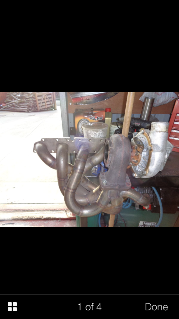

Just bought this so my side exit one will be up for sale if anyone is interested.
A space frame sounds a much much better way.
Do you still have the below?
http://i660.photobucket.com/albums/u...psdz3ozafg.jpg
Yeah I think the rear will be space framed now, nah we cut it up for the rear chassis legs how come?
Baz - Will that turbo not stick out of the bonnet / front panel / grille?
I got a txt from Rob saying the same thing lol I'd rather cut a hole in my bonnet than my new inner wings tho, I'll maybe modify it so it's not sitting so high though.
