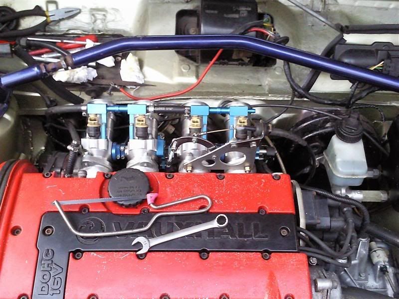

Bodies on for good, XE creams fitted, throttle linkage and cable fitted. All is good
http://img.photobucket.com/albums/v8...P/6cb2646a.jpg
http://img.photobucket.com/albums/v8...P/65418cdf.jpg
Just need to mount the pressure regulator somewhere, dont fancy drilling holes so may just cable tie its mount plate around the strut brace or something for now..... :)
