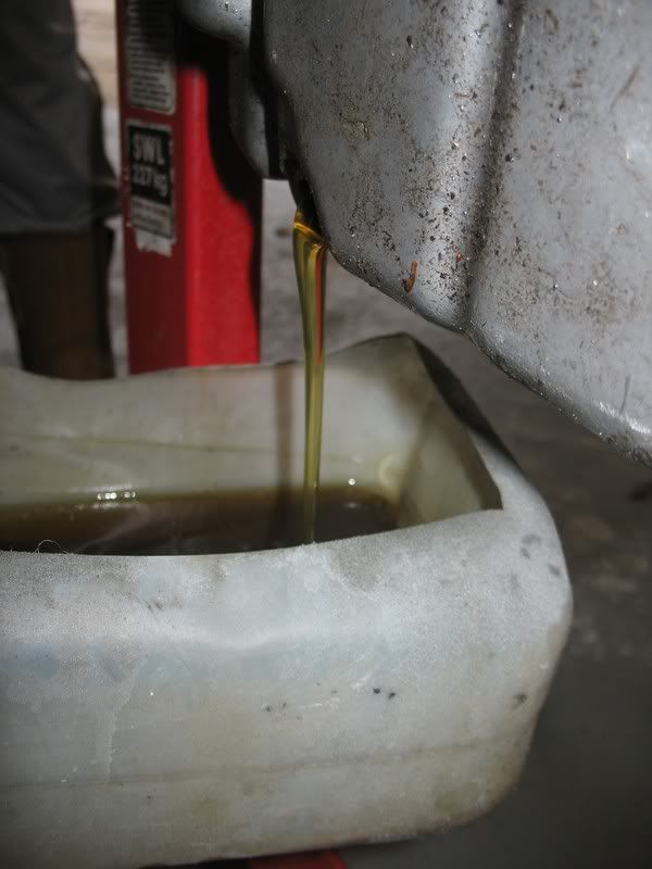

I drained the oil out which was like new, which was a good thing.
