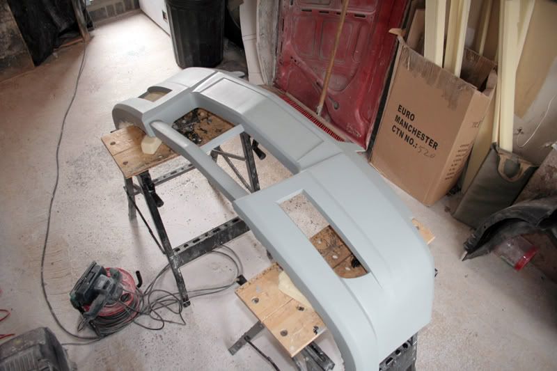

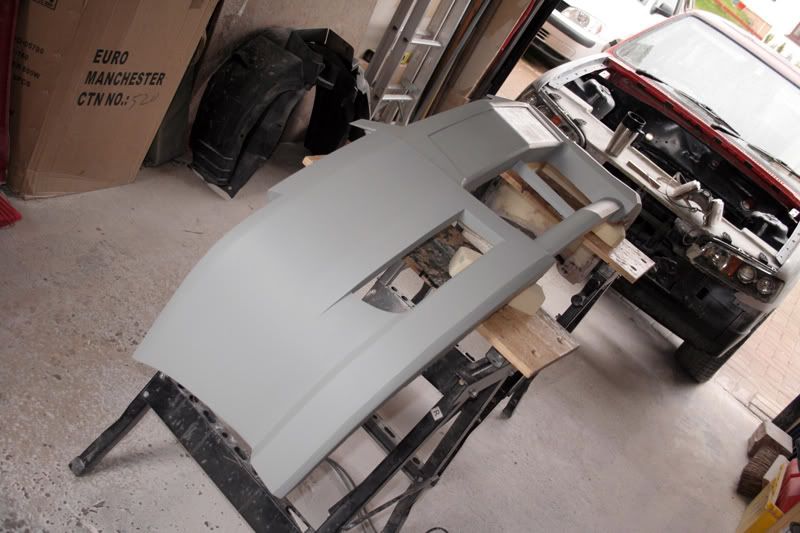

Been busy sanding and filling over the last few days and have pretty much completed the master for the front bumper.
It's been primed and from this I can see where the finer details need touching up (more to do with getting the lines right etc). I've even made the ends that go under the wings.
here's some pics...
http://img.photobucket.com/albums/v1...rprime0001.jpg
http://img.photobucket.com/albums/v1...rprime0002.jpg
http://img.photobucket.com/albums/v1...rprime0003.jpg
http://img.photobucket.com/albums/v1...rprime0004.jpg

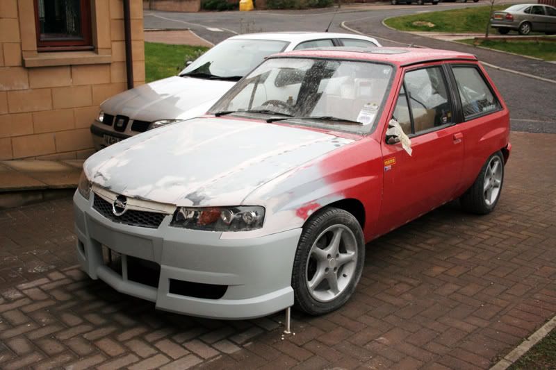

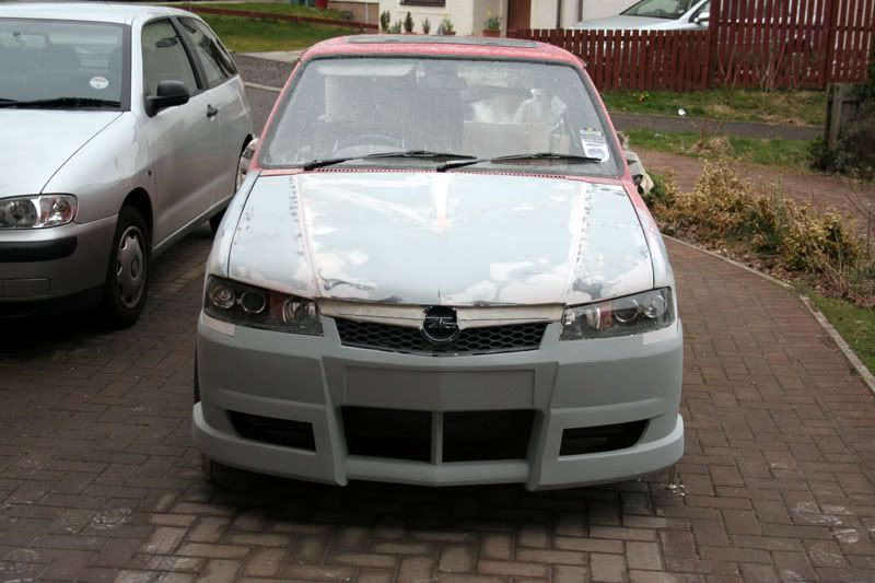

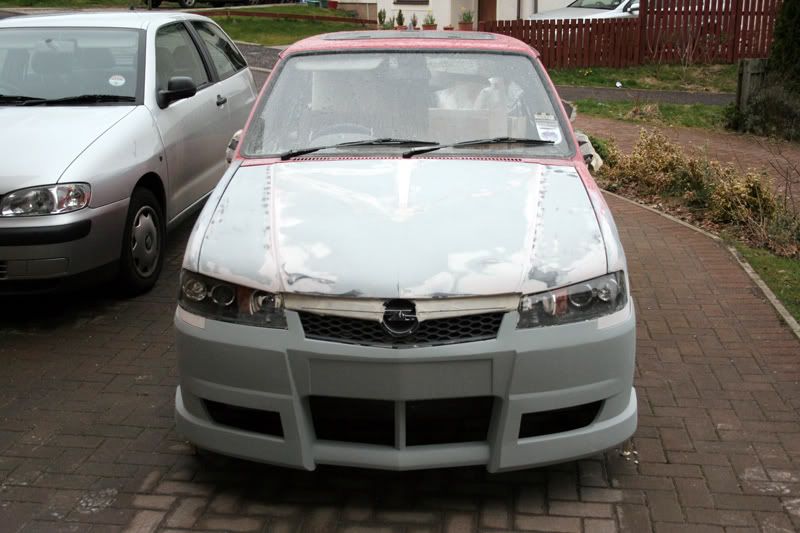

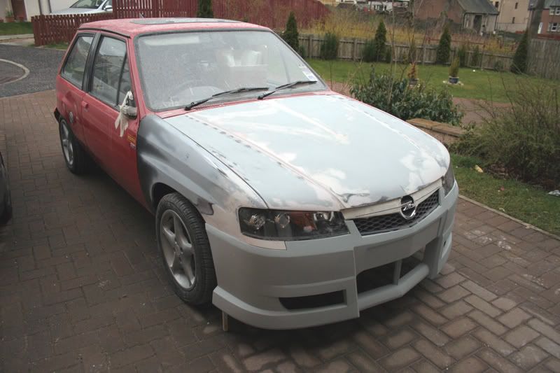

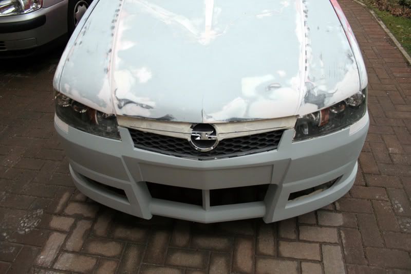

And with it on the car - its only held in place by 2 screws behind the grill - no bumper brackets or owt (apart from the 2 little wooden sticks in each corner!) -
http://img.photobucket.com/albums/v1...rprime0007.jpg
http://img.photobucket.com/albums/v1...rprime0008.jpg
http://img.photobucket.com/albums/v1...rprime0009.jpg
http://img.photobucket.com/albums/v1...rprime0017.jpg
http://img.photobucket.com/albums/v1...rprime0018.jpg
http://img.photobucket.com/albums/v1...rprime0016.jpg
It looks great ade :thumb:.
schweeeeeet... your craftsmanship is unreal :)

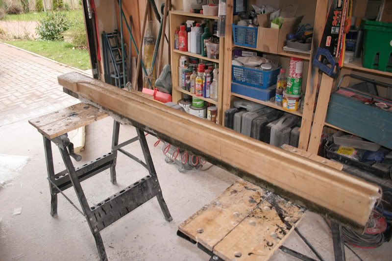

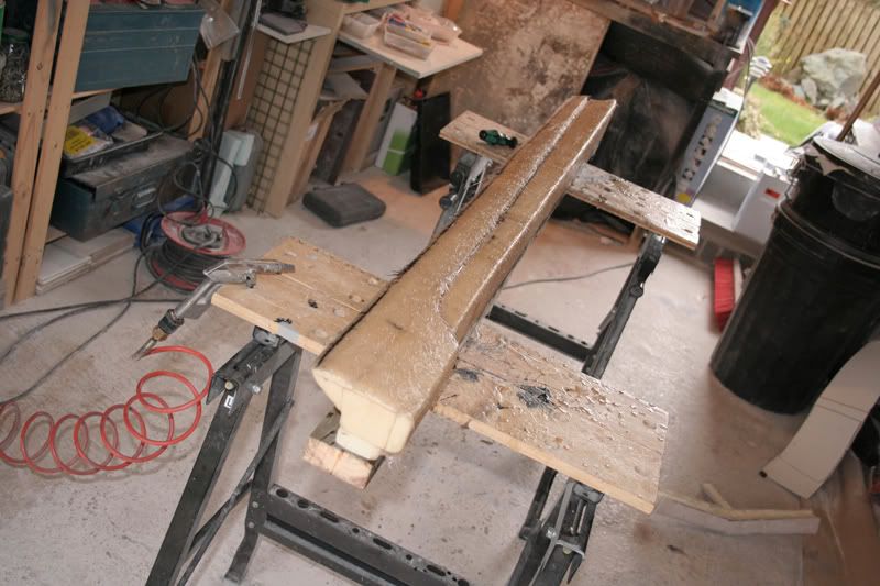

Now the front bumper master is pretty much complete the last coupld of days I've been working on my side skirts.

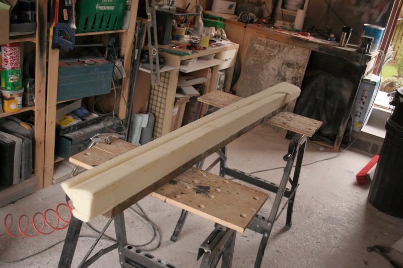

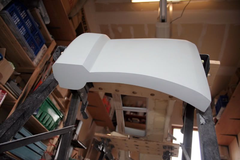

I carved these from foam a while ago to get the basic shape -
http://img.photobucket.com/albums/v1...rprime0020.jpg
Theyre similar to the monaro ones (see prev posts).
Started by hot glueing the foam core to a length of wood to keep it straight. I then layed up a layer of fibreglass -
http://img.photobucket.com/albums/v1...rprime0023.jpg
http://img.photobucket.com/albums/v1...rprime0024.jpg
Since then (last Tuesday) I've covered both in filler and have been sanding like a nutter and both skirts are pretty much complete in terms of the basic outline shape. I'll post pics when I get chance...
