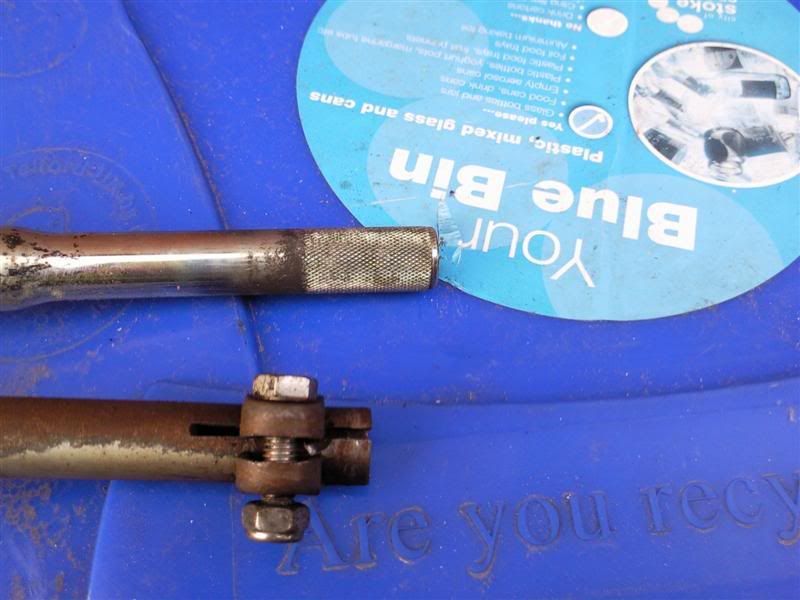

Remove nova shifter and compare to the now cut-down astra one, as you can see with the kink removed, the astra shifter rod is too short!!!!
Which means im going have to weld the astra end piece back on, and then weld the end of the nova one onto that :roll: Lesson of the day is not use a astra shifter tbh, cally one seems to be more suitable.

I think im going weld that 3rd piece back onto the astra shifter(the bit with the small diameter end), and then weld the end of the nova one onto that.......

Now, the reason you cant use a mk3 astra shifter lol
The end piece slides into the linkage, whereas a nova end piece slides OVER the linkage...
http://img.photobucket.com/albums/v8...P/69165982.jpg

Why do you need the Nova end? Isn't the whole point of this ia to bin the linkage no?

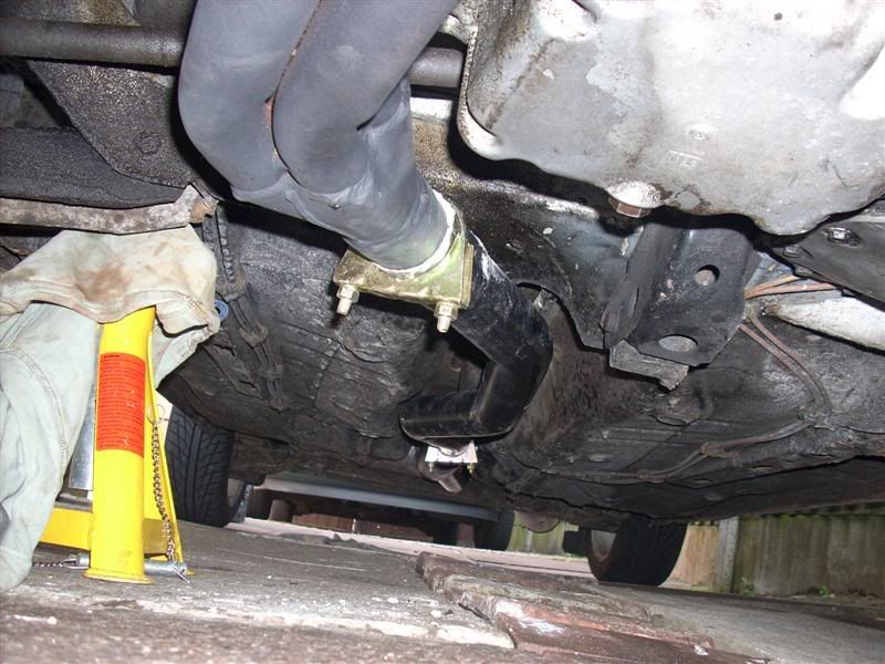

it moves the linkage above the floor so you can use the exhaust tunnel for an exhaust, the shifter still connects to the normal nova linkage via that slip coupling.Quote:
Sounds point less to be. All the ones i've seen connect to the box direct. To be that's the point, it removes all the slop from the linkage.

You still keep the original nova linkage/S, just that now a cav/astra shifter connects to it instead of the nova one....
Meaning i can rotate my exhaust up into the tunnel to stop it bottoming out (remember you said it looked broken? lol)
Thats the only real reason i did it, and its cost me nothing to do.
