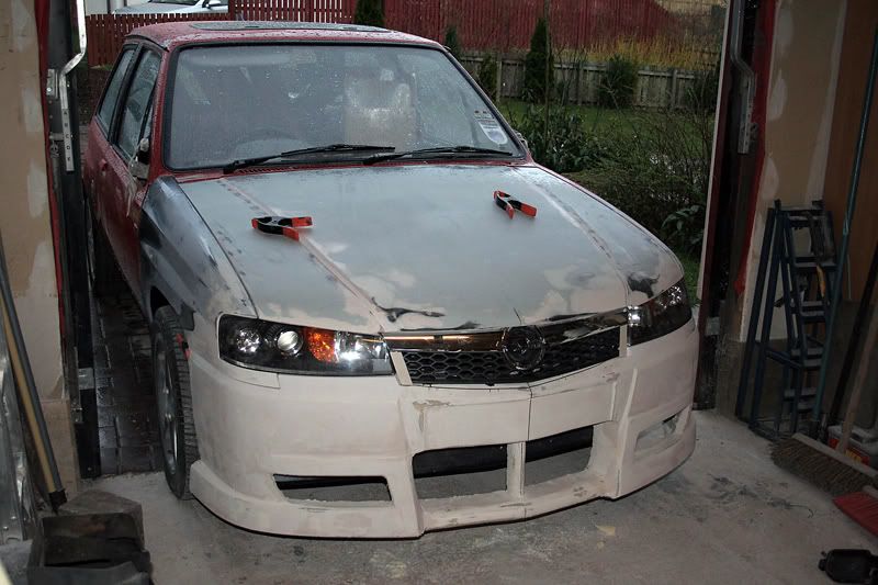

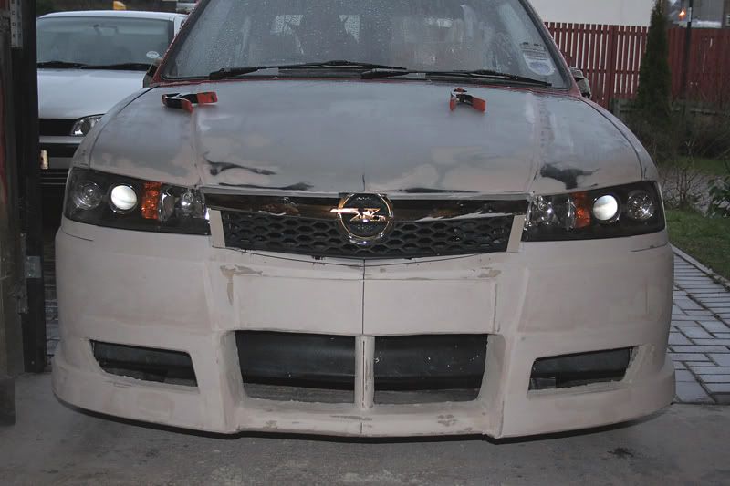

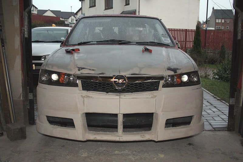

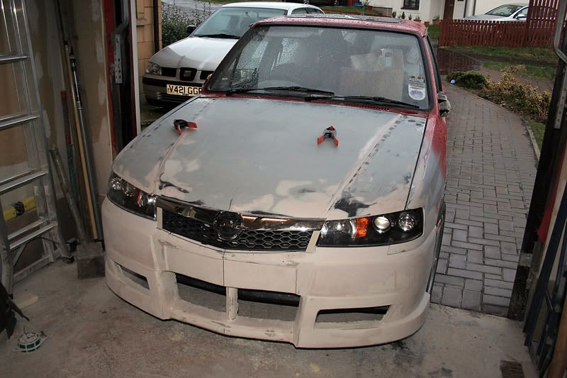

Fecking cold today - snowed in the morning and rained in the afternoon however I cracked on as usual and drank enough coffee to p1ss brown liquid!!!
I'd intended doing more work on the bumper today but decided before I can really do any more on this I need to install the new grill to ensure that it fits and matched the bottom par of the bumper.
Took me all day!
I'd purchased a brand new OPC Astra H grill (honeycombed version) and chromed Opel blitz panel. The task is to reduce this to fit snuggly between my Punto lights...
After bolting on my wings properly, reseating the bumper, adjusting the underside of the bonnet (the blitz badge mounting is HUGE) and several measurements, checking and rechecking distances and marking up the panels I got me dremmel circular saw attachment out and "customised" the grill sections.
Thankfully everything went smoothly (apart from a nice deep cut across the side of me left index finger) and the grill pretty much slotted in perfectly!
Theres a couple of adjustments thats needed on the bumper - the underside of the grill where it sits in the bumper need tidying up and the front needs raising slightly but thats a simple filler job which I expected - hence doing this job today...
I had to remove a fair amount of the grill back mounting and ends so I still need to fashion some mounting clips but it tucks in nicely under the bonnet and the chrome lines butt up to the edge of the lights. This leaves enough room for an edging peice (the card bits in the pics below) to run up from the bumper to the underside of the chrome.
Anyway - heres some pics...

Next task is to skim the gaps under the grill to raise the bumper middle, then clean up the bumper proper...
Working this weekend though so may tinker over the next few days...
