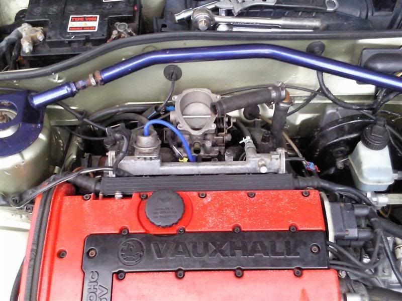

Bit of an update, was sunny today so i cracked on!!!
Got laptop wired up to the GoTech, all is well and its working fine.
Good bye standard inlet.
Powercap/afm removed
http://img.photobucket.com/albums/v8...P/776d399b.jpg
http://img.photobucket.com/albums/v8...P/88570249.jpg
Inlet removed(bastid of a job with the engine in the car!!!)
http://img.photobucket.com/albums/v8...P/59eb5336.jpg
http://img.photobucket.com/albums/v8...P/75c8e9b9.jpg
Also noticed that the clutch cable had nearly rubbed THROUGH the inlet!! Its worn a few mm out the back of the inlet, so i'll be fitting a new cable too.
Bare head
http://img.photobucket.com/albums/v8...P/31eed55f.jpg
http://img.photobucket.com/albums/v8...P/a30bd9c7.jpg
I was going save these pics for the 18+ section :cool: lol
http://img.photobucket.com/albums/v8...P/9a9a09d1.jpg
http://img.photobucket.com/albums/v8...P/536d6cc3.jpg
http://img.photobucket.com/albums/v8...P/15fc1eea.jpg
They fit spot on! Not sure whether bothering removing the firewall because i think the trumpets sit lower than the level of the firewall, so even with it gone longer trumpets will hit it...
How much clearance ive got
http://img.photobucket.com/albums/v8...P/364cab3e.jpg
They are quite "blingy" so make the rest of the engine/bay look shonky! lol
I've got a new rocker cover etc to go on though to tidy it up.
More tomorrow, hoping to get the bodies properly bolted up, and do a bit of work on the ecu loom (got to fit new CTS plugs etc)
That is all for now :d

Does anyone know how low i can cut the firewall down? Theres like a seam with spot welds on, you can see in my pics, can i only go down to the top of the seam? Or can i grind down flush with the battery tray? If you get me :)

You can cut below the spot welds so it's flush with the tray. I think it's just the tray that flicks up that is spot welded to the firewall so it's not needed.
Cool, im binning the firewall then as that means i can run longer trumpets.

Firewall is now removed, was a bit of a difficult job because i couldnt remove the front strut brace, so had to saw some parts of the firewall and get the grinder on the rest. lol
Suprising how much bigger it makes the bay look.
Now i cant fit the watershield over the heater blower motor am i going need drill a few holes in the blower surround to stop water collecting in it?

Yes i've had to do this on mine. In the cup like bits drill them at the front.Quote:
Originally Posted by Adam
or leave it and when you're late for a trackday you can have a shower in the car! lol
Cool, i'll get some holes drilled tomorrow then.
