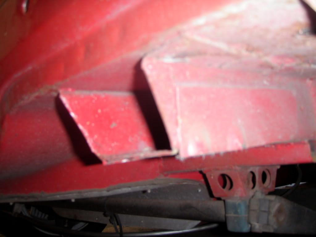

The floorpan of my Nova, showing the plate where the old floor mounted pedal box was located (this plate will get removed soon);

And some work on prepping the floorpan, where I removed the mounting plate from the old pedal box;
