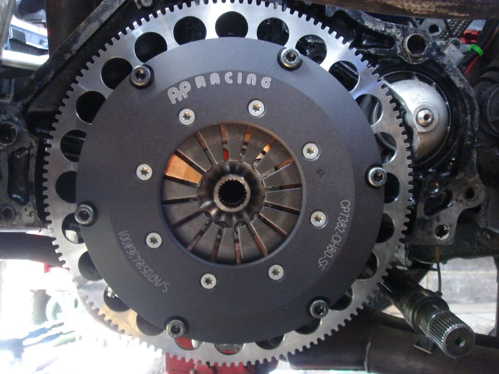

Well its update time. Me and wwmnw cracked on this morning to trial fit the clutch assembly to get the measurements to figure out which hydraulic bearing is needed.

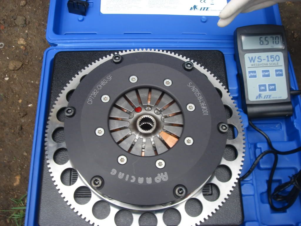

We started by weighting the old clutch and new clutch assembly. You might be suprised at the weight differences.
Old helix paddle clutch assembly and ttv flywheel
http://i761.photobucket.com/albums/x...0/DSC03833.jpg
new AP clutch and ttv flywheel
http://i761.photobucket.com/albums/x...0/DSC03834.jpg

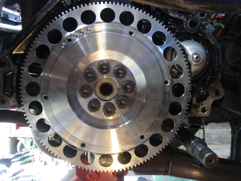

Flywheel as it sat on the engine
http://i761.photobucket.com/albums/x...0/DSC03835.jpg
clutch assembly as it sits on the crank
http://i761.photobucket.com/albums/x...0/DSC03836.jpg

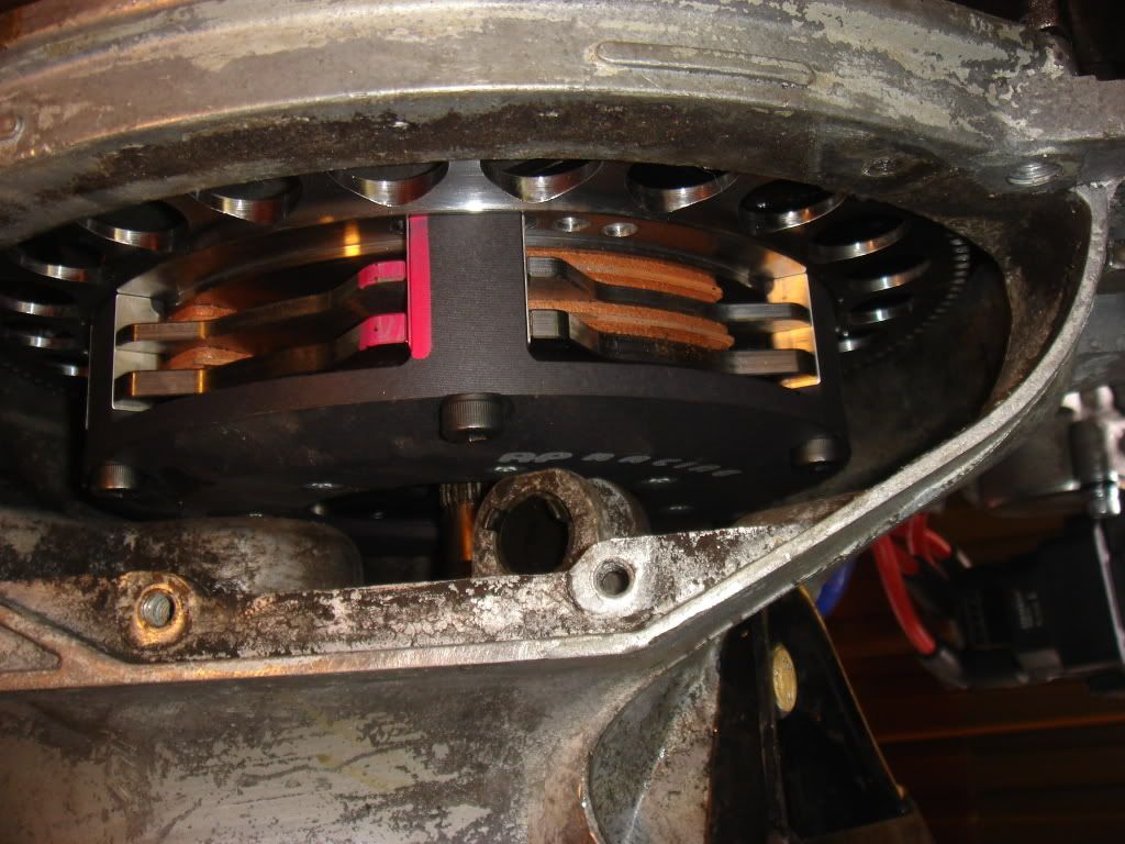

when we offered the box up and found when the gearbox bolts were nipped up the box fouled the clutch housing
http://i761.photobucket.com/albums/x...0/DSC03837.jpg

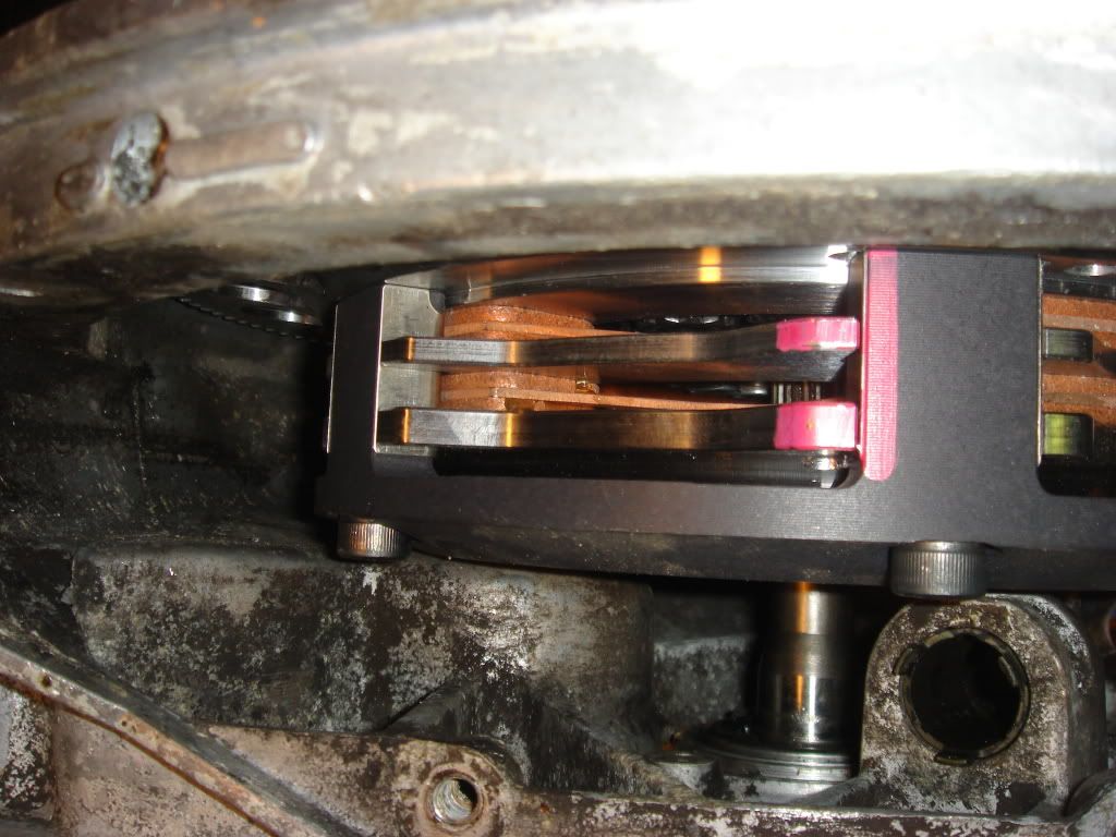

Another
http://i761.photobucket.com/albums/x...0/DSC03838.jpg
When speaking to steve we have come to the conclusion that running a alloy spacer between the box and block and power filing and touch of the case should do the trick. I have got loads more to update We just ran out of time to take the pics but ill try and do that while I make a template spacer tomorrow.

get the grinder out!!!
Quite a weight saving there, bet your glad you went for that now, good value for weight lost i think!
How much clearance do you need mate? as in how thick is the spacer going to be?
