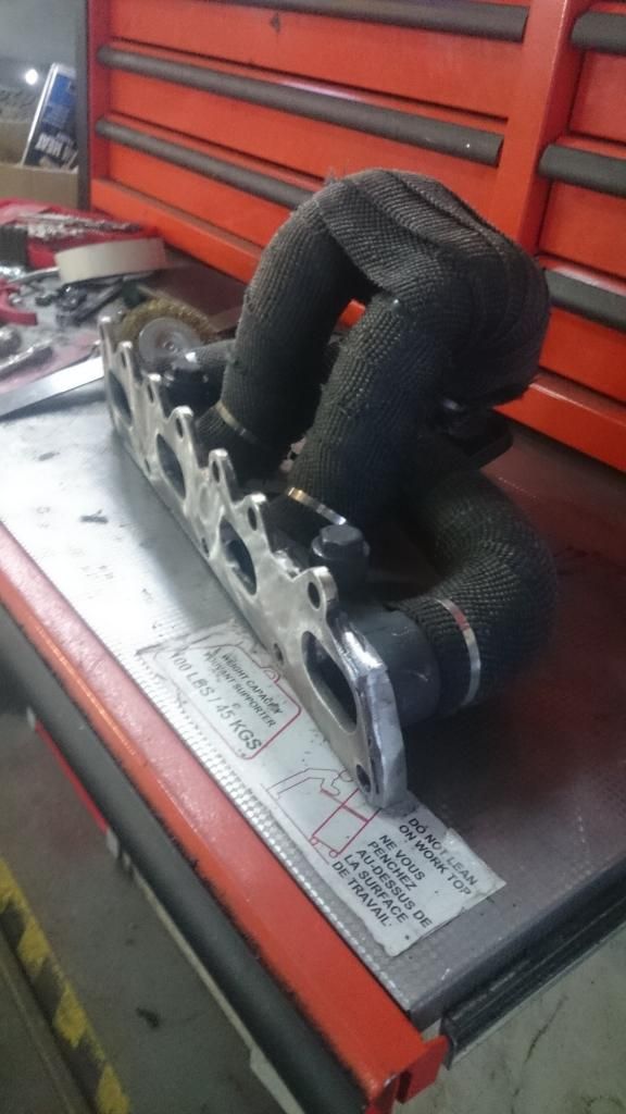

After getting my manifold and flange back from the engineer, I set about welding them together again. The manifold flange was taken down to 7mm and the head flange to 5mm. Gaining around 9mm in total
Both clamped together and welded together, all the ports had to be opened out to match head flange to give a smoother flow.

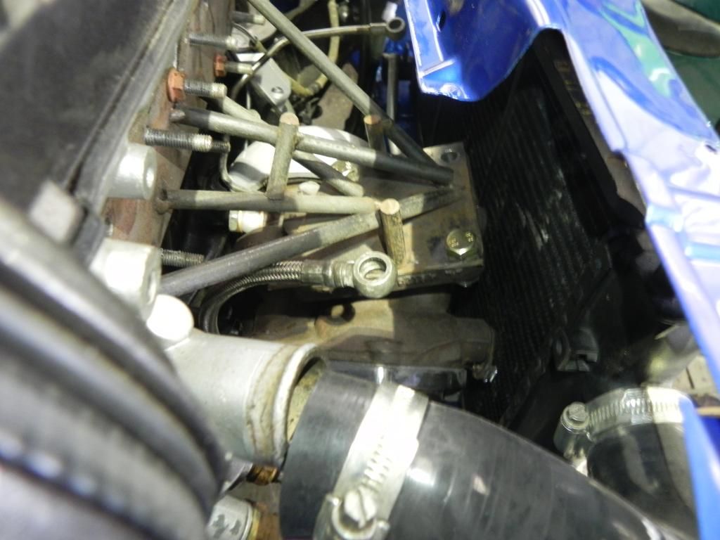

I offered the manifold up onto the engine again and although it gave me more room I wasn't happy with it. The compressor housing was now closer to the dipstick tube mount which would require alteration now. This along with having to cut more of the slam panel off than id like has now resulted in me binning this idea. Manifold is for sale if any body is interested. I have thought about changing turbo set up to something with a t3 mount.

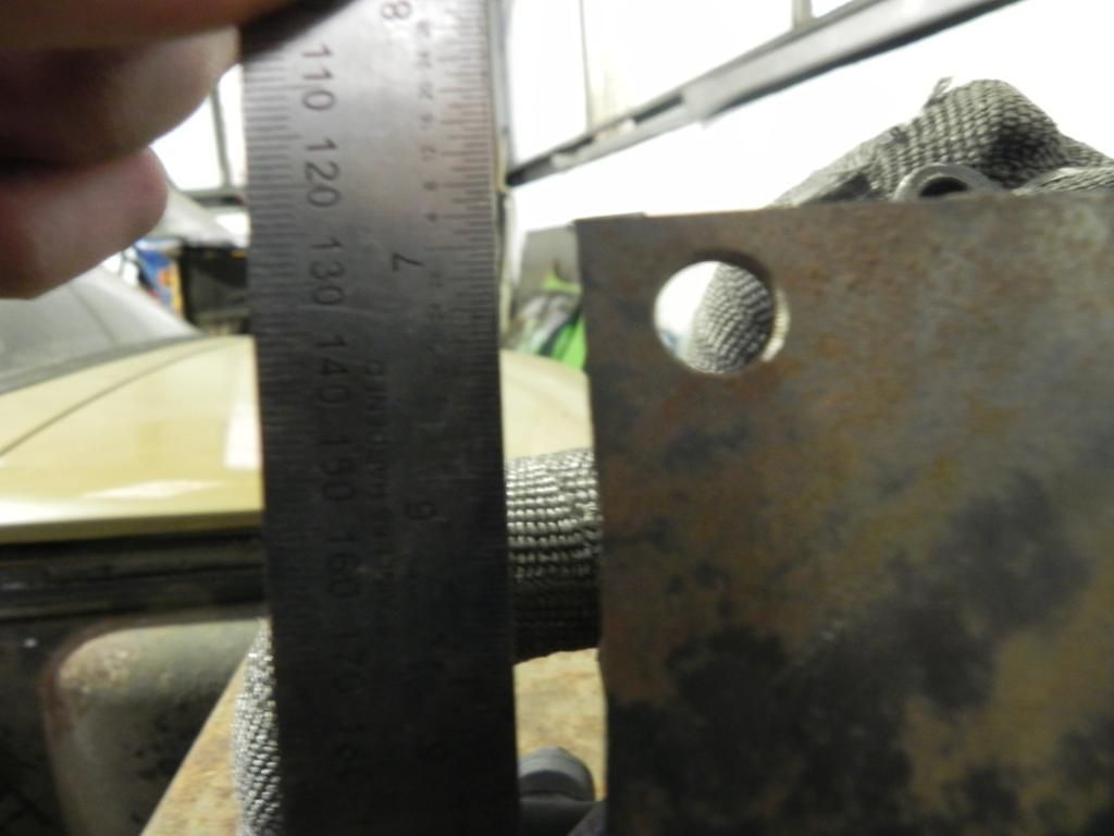

Speaking to james middleton (jonlem) about the evo manifold his company makes had led to me to stick with the evo turbo. He was kind enough to send me out a template jig of the aforementioned manifold to check for space.
Measuring the difference in depth shows roughly half an inch of improvement, along with it being in an inch or two over to the offside.

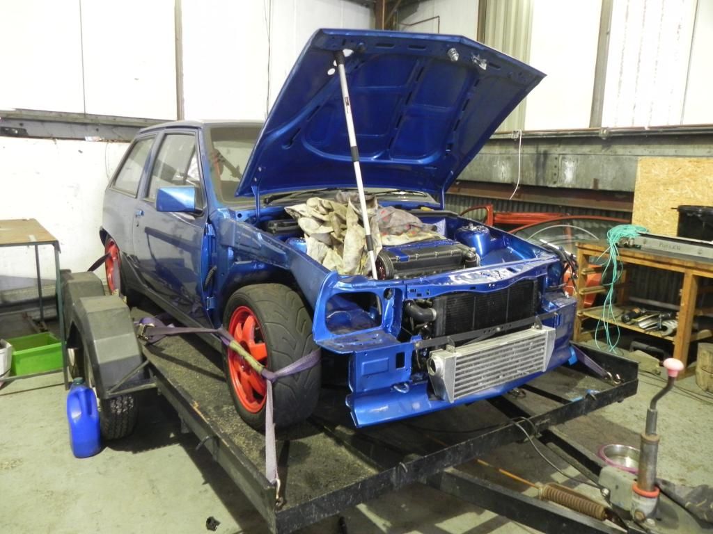

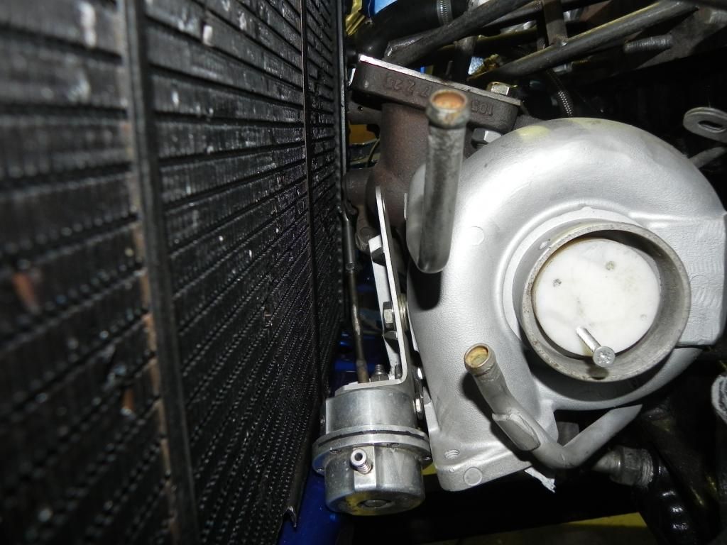

All bolted together with the radiator and intercooler fitted. The half inch difference in depth of the manifold has created the same amount of space between the rad and turbo wastegate arm. Im hoping the engine wont rock too much damaging the rad, I now have a solid rear mount fitted which should help. There is also 40mm of room behind the turbo compressor cover and block, which is ideal for when I go to a bigger turbo. Which im thinking of a td06sl2 20g or 25g.
