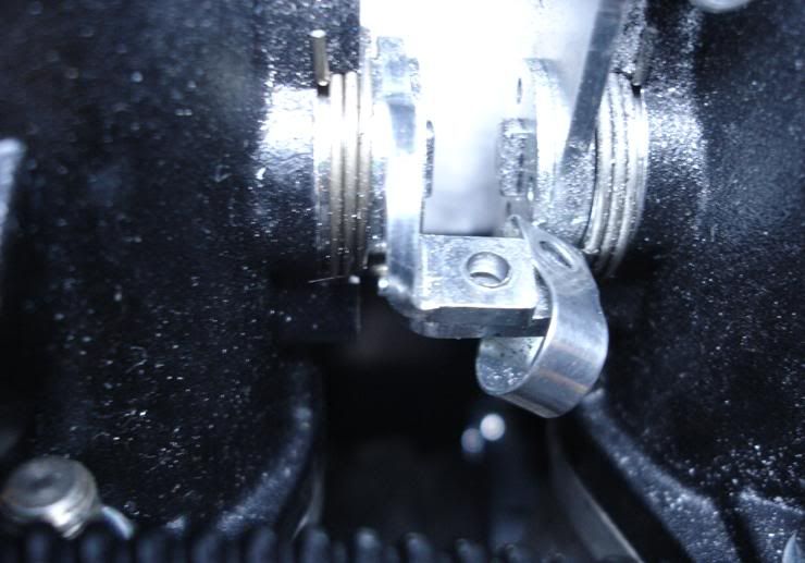

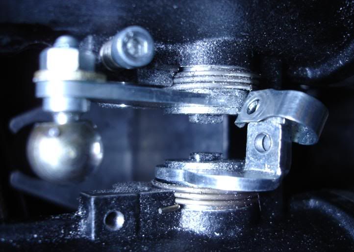

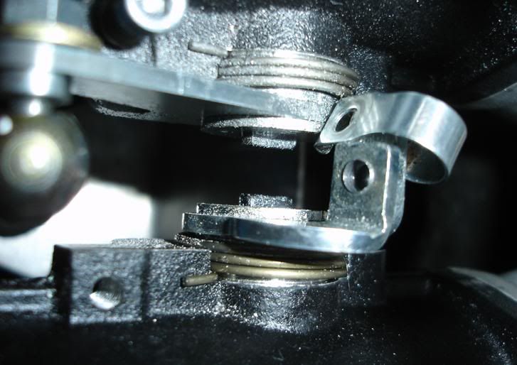

we have founda cause of the problem. The balance screw doesnt screw.. there is no thread on the t.b part for it to bite and move..
also we are struggling to get it to idle - with the screw fully in- it still needs a tad throttle , but i think once the balance has been sorted it'll idle ok.
So i have to photo the lacking thread area and email to jenvey as they dont believe me lol..
Once they believe me hopefully a new part will be winging its way out..
More at the weekend i feel.
Pics of said problem.. Grub screw completely removed and ive ecked the clip out the way for access/photo..
http://img.photobucket.com/albums/v1...linkclose1.jpg
http://img.photobucket.com/albums/v1...linkclose2.jpg
http://img.photobucket.com/albums/v1...linkclose3.jpg
The grub screw tries to go into the clip but lack of thread on arm/other bit stops it doing what i should do..

Depending on how far out of balance they are you might get away with a small bolt, and a nut on each side of that plate (to lock the bolt)
Or just tap a thread into it if youve got a tap/die set
option 1 i dont think will work..
option is best, but have no idea what the thread is and im ****e at D.T..
will see what jenvey say.
Looks about M6.
Or drill it bigger and M8.
Does that clip definently not have a thread in the underside??
lol pics must be misleading you its a tiney hole..
u see the hole doesnt go all the way through..?
so the clip (that ive moved on the piss in photo) is a thin C shaped think that just keeps them together..
its ok, i wont bodge about ,we'll see..
