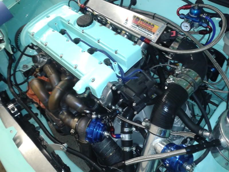

Such a clean car.... One of my favourites
nowt wrong with the z20 gasket-good choice
i found the zlet gasket restricts the water ways , took mine off on the advice of steve milton
Ready to refit then, that's good, be ready for the summer shows.
Looking more like a motor again

What double springs are you on as the Piper double springs foul the oe valve stem seal.
im on piper springs, I filed the top lip off the oe seals to make them flush and they fit perfect, a local guy who runs a big spec xe in his mk2 escort rally car has run them like this for years and advised me to do the same
Proper scrap heep challenge car this like
Update needed Matt :)
had it running last weekend and all seems ok, I need to have the map checked after its been apart though
