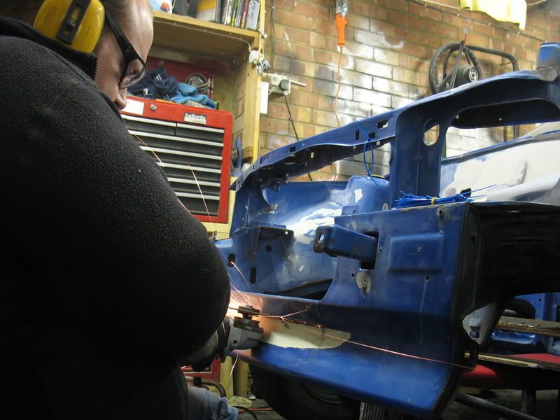

Right the bit i wasnt happy about doing..
Mark up whats what.
http://img.photobucket.com/albums/v3...ontpannel2.jpg
http://img.photobucket.com/albums/v3...rontpannel.jpg
Get cutting.

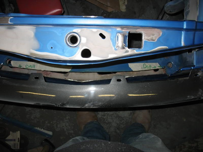

Gave me this.
http://img.photobucket.com/albums/v3...ntpannel10.jpg

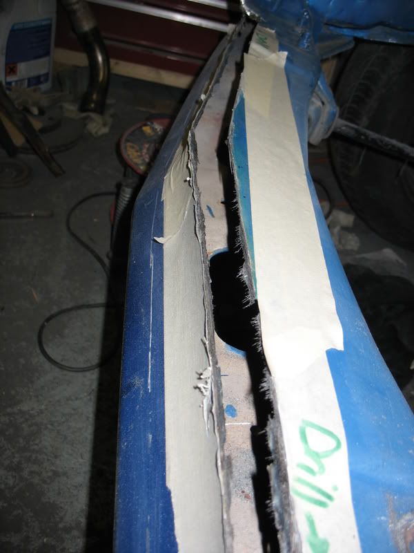

Then marked the top.
http://img.photobucket.com/albums/v3...ontpannel6.jpg
http://img.photobucket.com/albums/v3...ontpannel8.jpg
And again to make it stright from the triangle.
http://img.photobucket.com/albums/v3...ontpannel7.jpg
Leaves, this. Nice and clean on the insides bar where it was welded around the tie bar mounts.

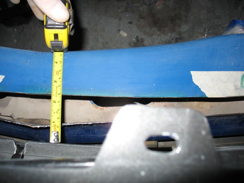

Now the tie bars are two skins thick, what do i do any strench here?

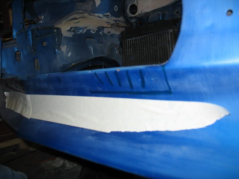

Fitted the front bumper to see what room i have.
http://img.photobucket.com/albums/v3...ntpannel13.jpg
http://img.photobucket.com/albums/v3...ntpannel14.jpg
As you can see still not alot.
http://img.photobucket.com/albums/v3...ntpannel11.jpg
But this should just be enough, might need to shave the back out the mouth a tiny bit tho.

Where you have cut looks abit close to where you have marked the holes for the rad reposition. Or have i mis read you pics?
Did the piece you cut out come in one piece? You could turn it and re weld it back in, if you see what i mean??!!
Fair play for cracking on with it.
Yes its close to the holes, will have to trim the rubber mounts down.
Yes it came out in one bit, but thinking a thicker bit for added strench.
