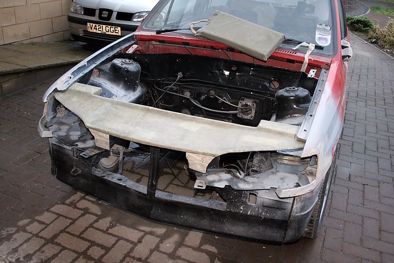

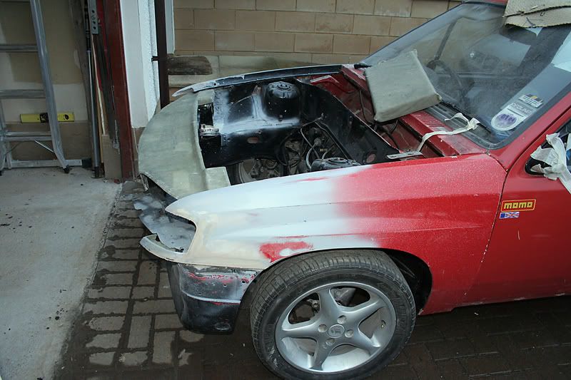

Decided to finish off my slam panel today - I'd plug welded the new skin to the underneath one the other week bit although its solid it doesnt look very nice - it's uneaven in places and no amount of dolly work was going to sort it - plus I wanted something that would channel the air coming from under the bonnet. So I made a fibreglass show cover.
The prinicple is very easy and would also allow me to practice my fibreglassing ready for when I start my bumper/skirts. I started by laying up plastecine modeling clay all over the slam panel to even it out. This was then shaped and skimmed to get it nice and flat. I used a spirit level at specific points to ensure it was even.
The slam panel looked like this beforehand -

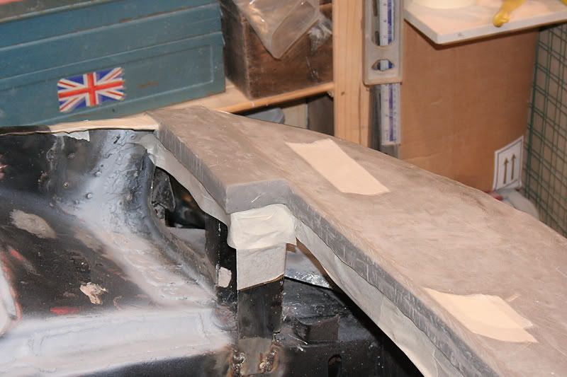

I made a card template to ensure both sides were even (they were pretty much spot on anyway but I wanted to be sure) - Heres the result after the plastecine cover was built -
http://img.photobucket.com/albums/v1...neltop0002.jpg
http://img.photobucket.com/albums/v1...neltop0004.jpg
http://img.photobucket.com/albums/v1...neltop0005.jpg
The masking tape covers bare metal areas. As you can see it is much more even and will protect the metal underneath.

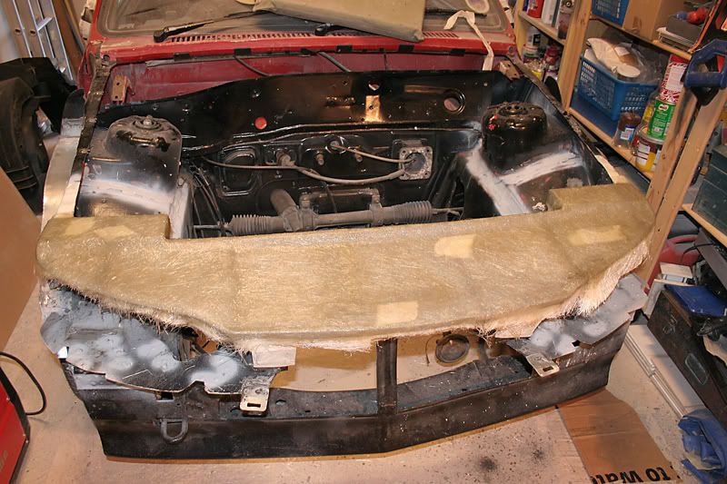

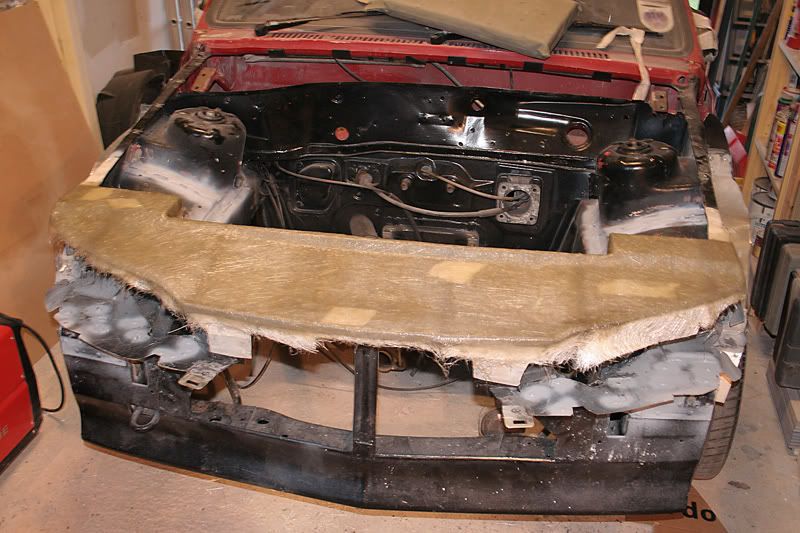

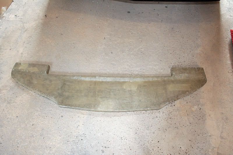

Anyway - started off by trimming off the excess matting and then removed all the plastecine (a pain in the bum) but it came out really well (its not attached yet) -
Will probably paint it black the same as the rest of the engine bay...

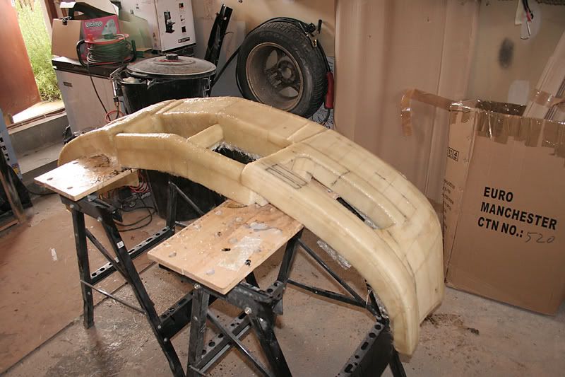

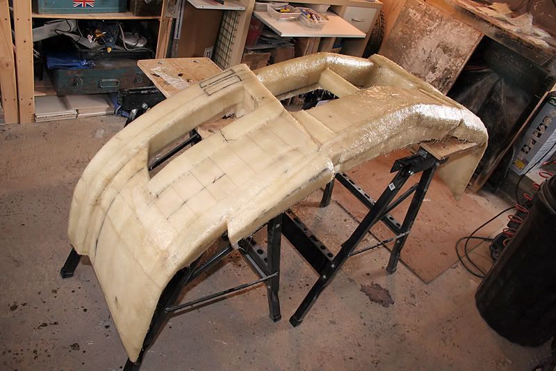

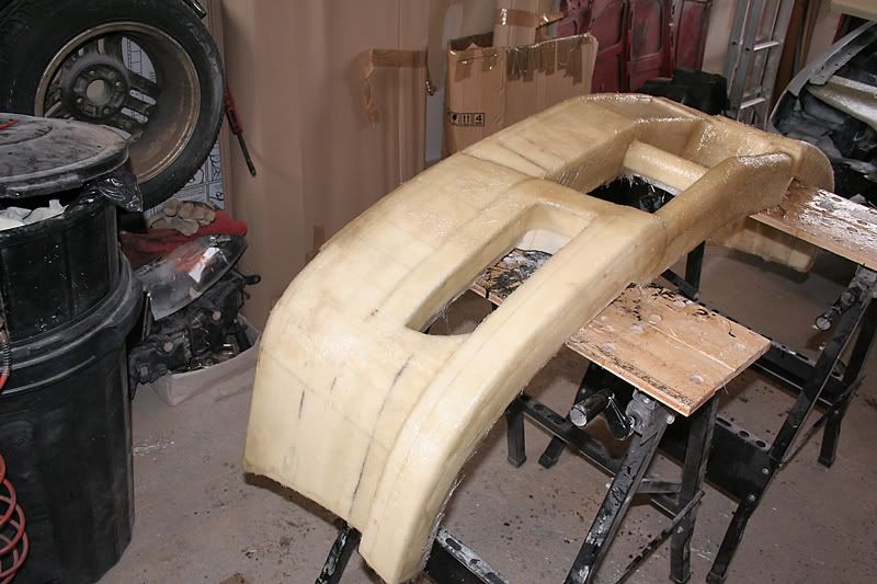

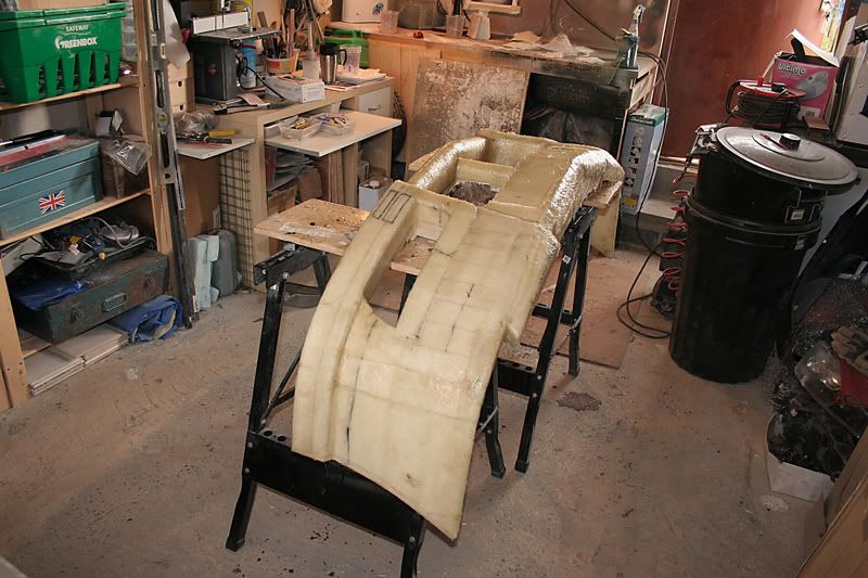

I then decided to lay up a couple of layers of fibreglass on my bumper. Even though I'm still waiting for my new grill I can still make a start on the rest of the bumper. This took pretty much all day. I started by cutting up a fair amount of fibreglass. The glass I was using is pretty thick (4 layers) so because this layer is simply to get the basic shape I needed to split it so it would bend and shape easier. All you do if find and edge and peel it apart. Doubles the amount you have
Heres the results after just one layer -
http://img.photobucket.com/albums/v1...bumper0003.jpg
http://img.photobucket.com/albums/v1...bumper0004.jpg
http://img.photobucket.com/albums/v1...bumper0006.jpg
http://img.photobucket.com/albums/v1...bumper0005.jpg
I removed the bar in the fog light area simply because it will be part of a seperate structure.
I then added a second layer and by this time the whole garage stank of resin. So with it being 6pm and the missus being home at 7pm and me having access to next doors garage I moved the whole bumper and work benches there instead. Opened oll doors and wildows and stuck all my clothes in the washing machine!
It worked - didnt get into trouble! (except now when I close my eyes all I can see are my hands in latex gloves covered in strands of fibreglass! - think the fumes have gone to my head!)

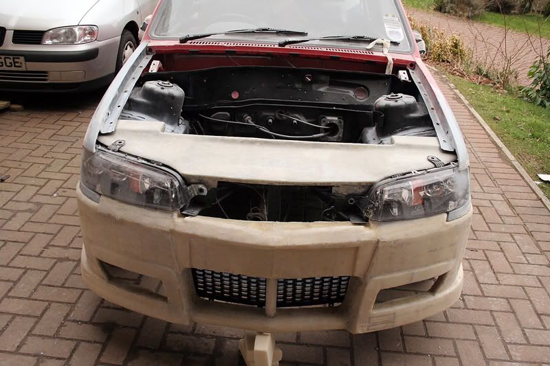

Saturday 15/03/2008

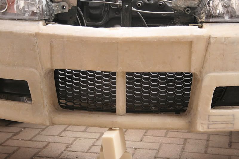

Took delivery of some parts today - my new OPC Grill (the Astra H one with the honeycombed vents and chromed strip) and 2 lower honeycombed panels as well as some bumper edge adjusters and suspension bolts. The grill is stunning and because it has the full surround will fit perfectly on the front of my Nova (once modified!)

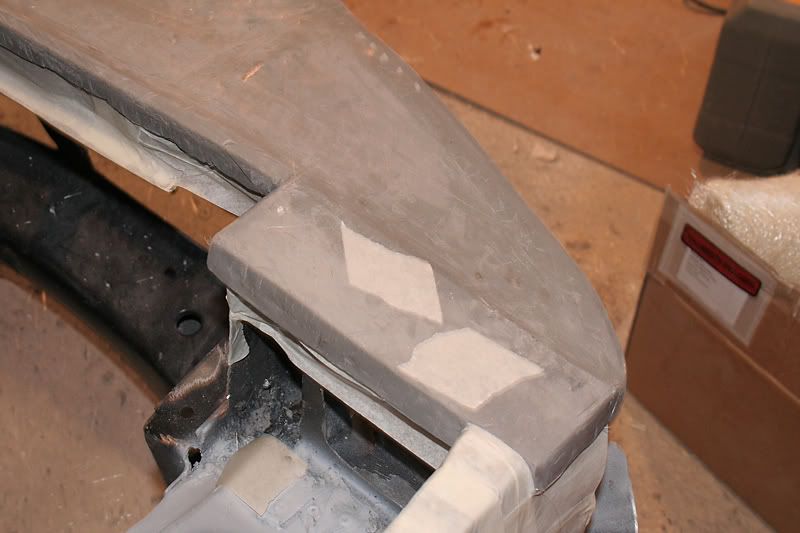

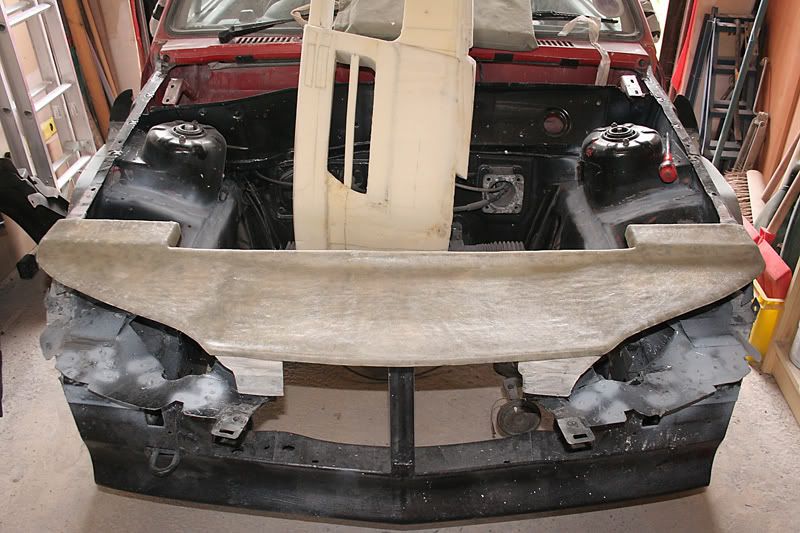

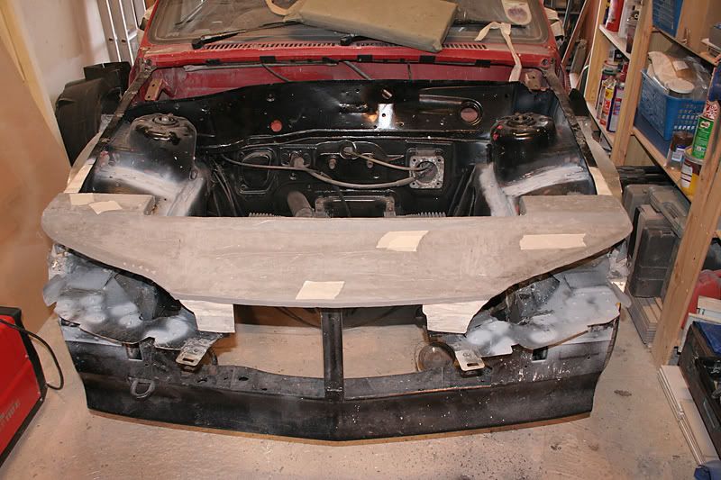

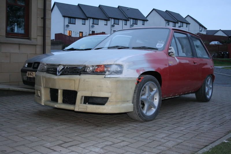

Spent most of today sanding back the 1st layer of fibreglass on the bumper to get a flat surface to work from. The foam base, although flat, did have some unever spots in it. Once sanded back (and after changinf my clothes necause fibreglass dust gets everywhere and it pretty nasty stuff in the scratchy itchy department!) I put the bumper in place to get an idea of the depth.
http://img.photobucket.com/albums/v1...mplam20002.jpg
It definately needed another layer (which I planned to add anyway).
here's one with the new honeycombed grill section -
http://img.photobucket.com/albums/v1...mplam20001.jpg
This will also form the back for the fog lamps.
The second layer was made out of 2 long pieces of fibreglass which will add strength across the face of the bumper. The next task is to sand this back lightly (to remove the evil burs and skelfs that are as sharp as needles) and skim the entire front with body filler. This will bring up the thickness to the correct levels and allow finer detail to be applied.

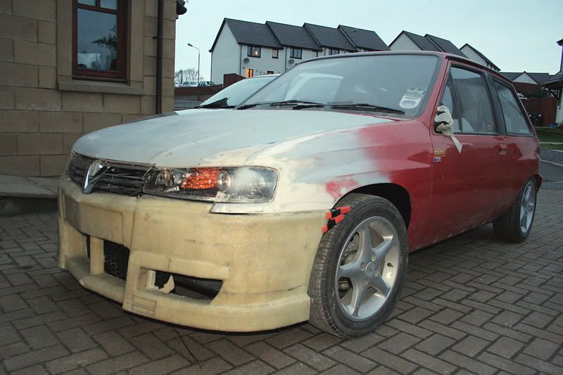

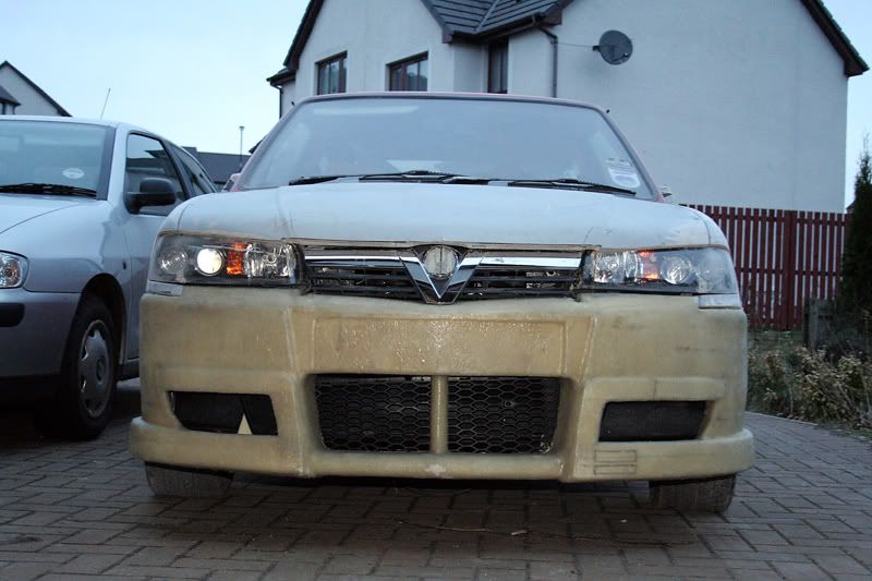

Here's a couple of pics with the bumper in place. It's bolted on at the corners of the lights and held in place with the big clamps at the side -
http://img.photobucket.com/albums/v1...mplam20005.jpg
http://img.photobucket.com/albums/v1...mplam20006.jpg
http://img.photobucket.com/albums/v1...mplam20004.jpg
http://img.photobucket.com/albums/v1...mplam20003.jpg
The old grill isnt sitting right on the pics but the new one will fill the whole grill section fully!
