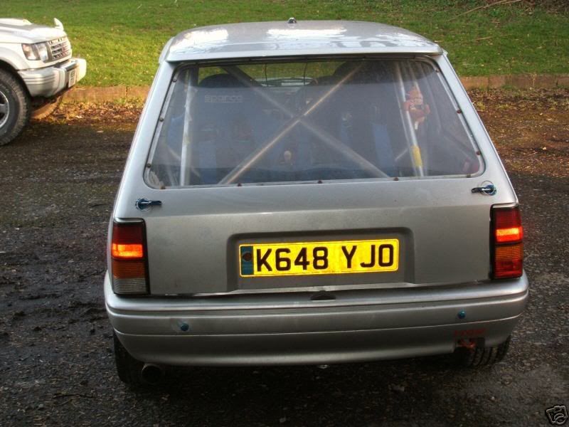

Gonna cut me a new rear screen out and rivet it in, seen a trackcar with self tappers holding the rear windows in and looked utter gash, lovely sharp screws facing every which way towards you inside the car lol
Get some rivet nuts, motorsport coolness:thumb:
Should look Ok if the window is fastened in with some form of nut/rivet etc

That seems excessive/unnecessary, why bother riveting a mount, just so that you can then use another type of fastener to mount the window :tard: Only worth doing if the window needs to be removable IMO.
I think the rear window on the silver nova looks perfect, coupled with a bead of sealant would be my choice, and may well actually be carried out on mine!
yeah I agree Oli, does seem a little over manufactuered. I wouldn't need the windows to be removable, so wouldn't want riv-nuts and bolted in, nor would I want pikey self tappers... so rivets are the way forward :thumb:
Bond it in. Windscreen bonder, job jobbed.
It has to run some sort of sealer or you will have water running in everywhere when it rains lol
