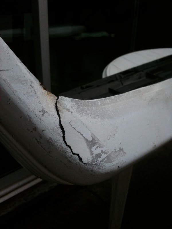

Bit more of an update. Decided to tackle the repair on my GTE rear bumper.
It was cracked in the corner as shown

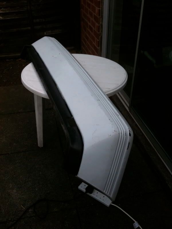

Started off by washing it down and getting it cleaned up, then cut some repair mesh to shape for underneath and fibre glassed it in place

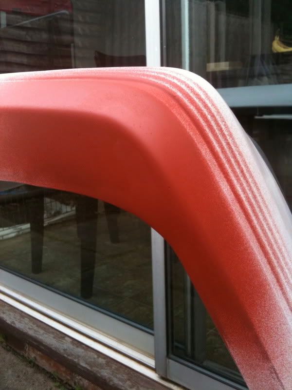

Happy with that I gave the whole bumper a coat of Upol Plastic Adhesion Promoter
http://img.photobucket.com/albums/v3...a/IMG_0333.jpg

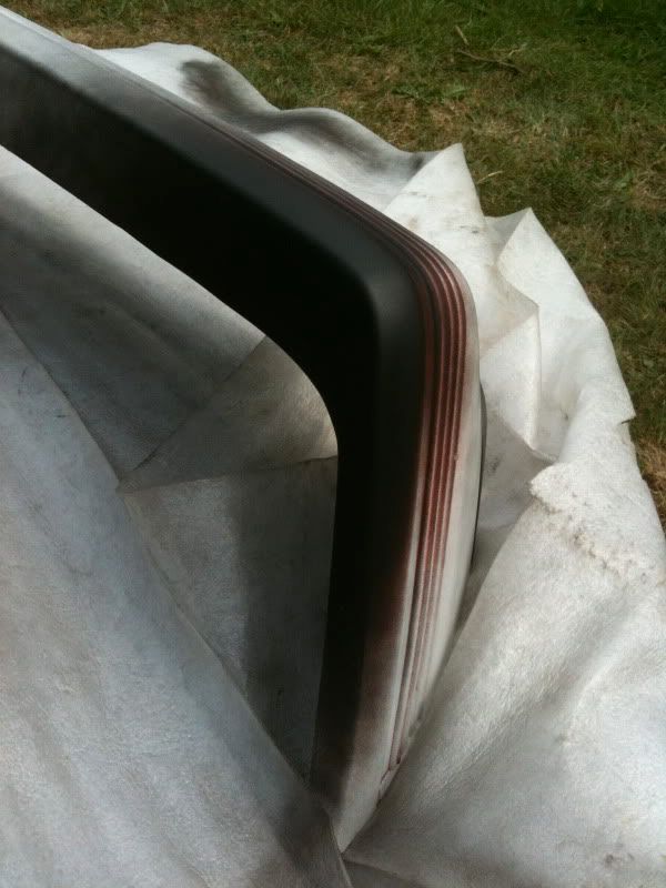

Then some perfection plastic texture on the repaired area
http://img.photobucket.com/albums/v3...a/IMG_0334.jpg
http://img.photobucket.com/albums/v3...a/IMG_0335.jpg
http://img.photobucket.com/albums/v3...a/IMG_0337.jpg

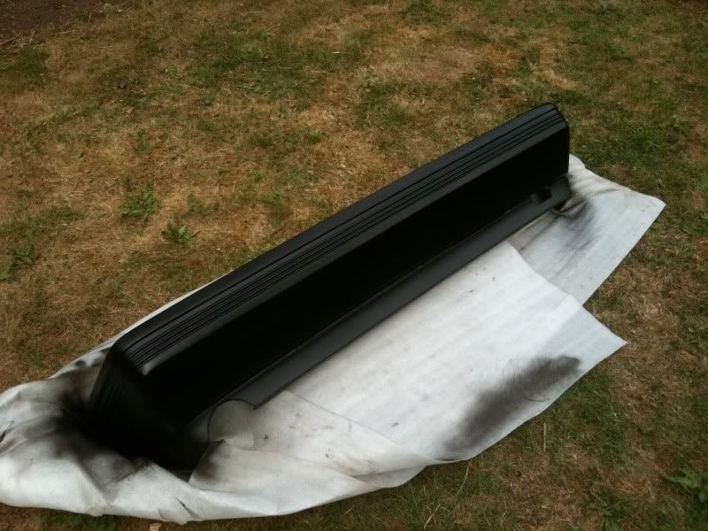

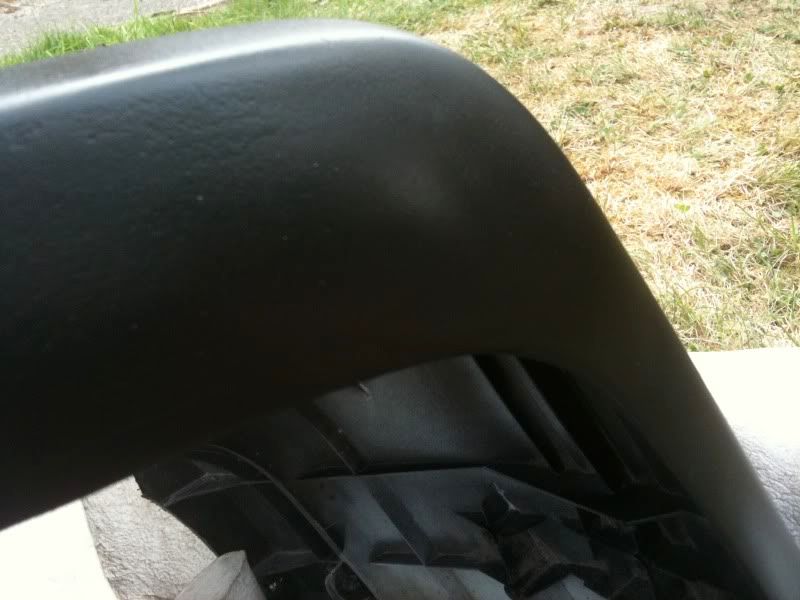

And finally a good coat of satin black
http://img.photobucket.com/albums/v3...a/IMG_0336.jpg
Well pleased with the final outcome
http://img.photobucket.com/albums/v3...a/IMG_0338.jpg

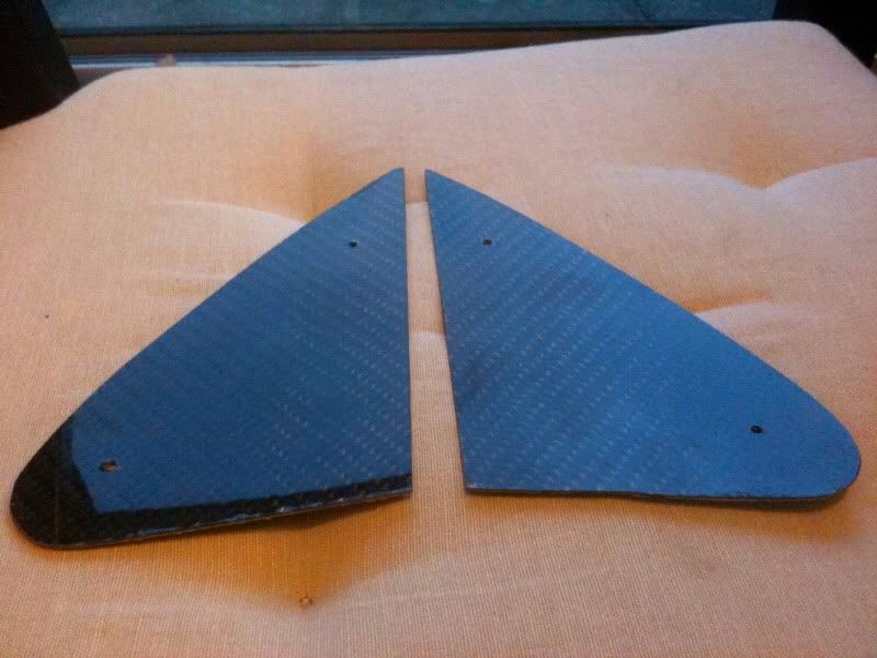

Also knocked up some carbon fibre mirror base plates
http://img.photobucket.com/albums/v3...a/IMG_0367.jpg
http://img.photobucket.com/albums/v3...a/IMG_0368.jpg

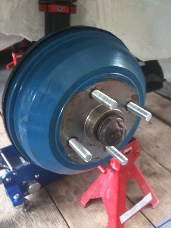

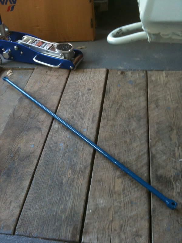

While the back end was up in the air I got my freshly painted rear anti roll bar in
http://img.photobucket.com/albums/v3...a/IMG_0377.jpg
http://img.photobucket.com/albums/v3...a/IMG_0379.jpg
http://img.photobucket.com/albums/v3...a/IMG_0380.jpg
And also Stud to Nut conversion on rear too

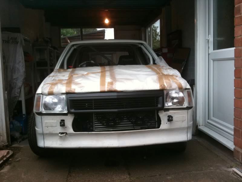

Fitted brand new headlights and clear indicators, and my grille
http://img.photobucket.com/albums/v3...a/IMG_0397.jpg

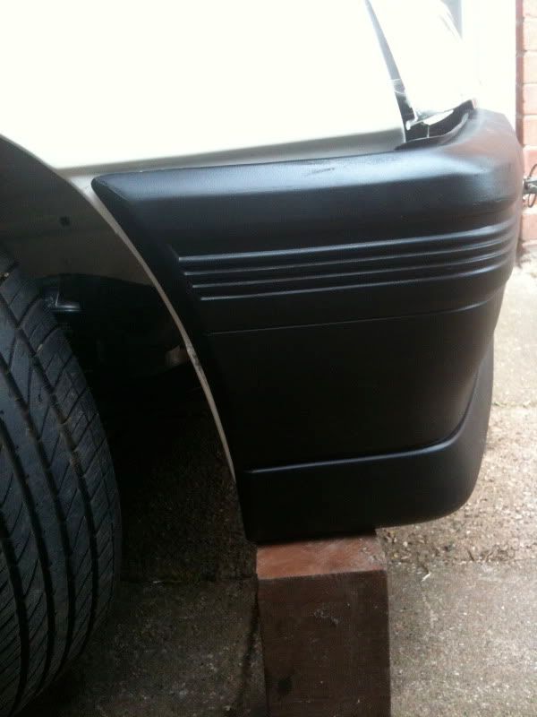

So took mr grinder to the wings!! then finished with some rubber edging
http://img.photobucket.com/albums/v3...a/IMG_0395.jpg

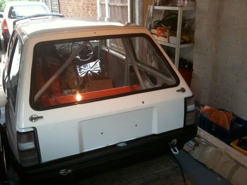

Next up I got the rear bumper fitted with quick release pins too
http://img.photobucket.com/albums/v3...a/IMG_0399.jpg
http://img.photobucket.com/albums/v3...a/IMG_0401.jpg
Final shot of the car with the bonnet on (all be it wrapped in bubble wrap!)
