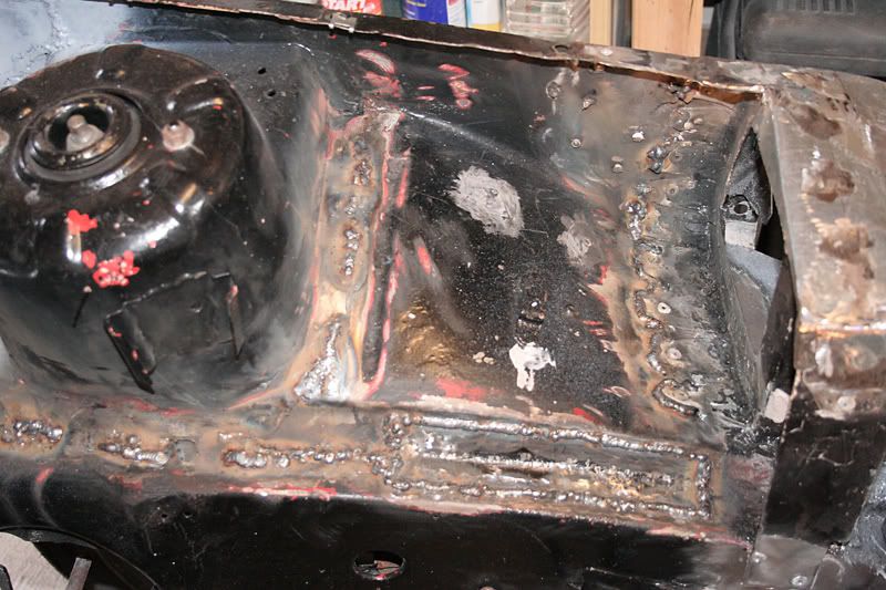

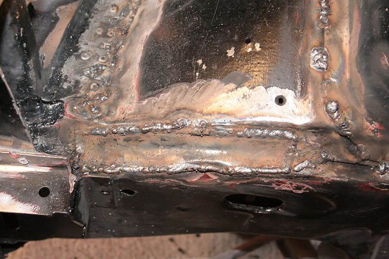

Anyway - decided today to "patch up" my engine bay. There were a couple of areas that needed some welding and I thought I'd also weld round my strut tops nowt like a little bit more metal. I also decided to weld up the backs of my light housings so theyre 100% solid!
As you know my welding is still developing so the welds are a tad rough looking however I'm pleased to say that after all the shutz from the inner arch caught fire and melted away I can confirm I got full penetration!
lol
The bloody stuff stinks too!
Heres some pics -
http://img.photobucket.com/albums/v1...engine0001.jpg
http://img.photobucket.com/albums/v1...engine0005.jpg

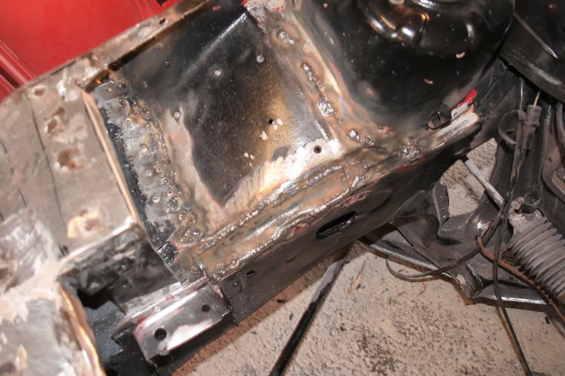

This one shows the plate I welded in (same place both sides) - the metal beneath is rust free but the join is really thin and gone in places so I decided to strengthen it.
http://img.photobucket.com/albums/v1...engine0008.jpg

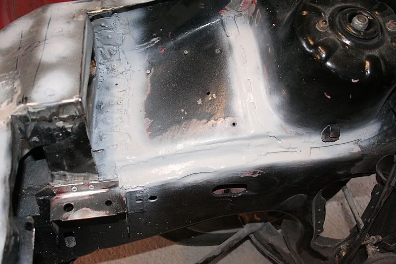

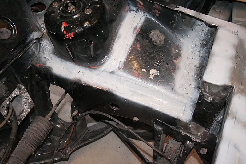

I then ground the tops off the welds to neaten them up and etch primed the lot -
http://img.photobucket.com/albums/v1...engine0011.jpg
http://img.photobucket.com/albums/v1...engine0012.jpg
All the new welds will the fully seam sealed so they wont be obvious once theyre painted up.

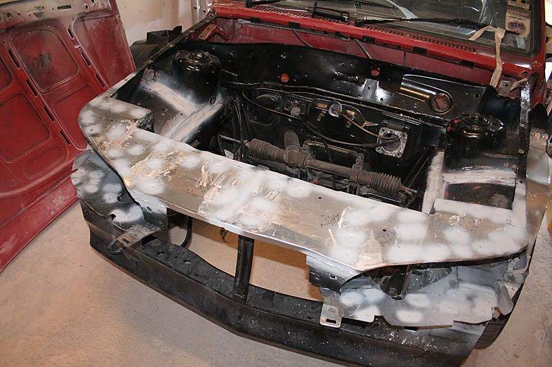

I also did the slam panel - drilled plug holes all over it (see prev posts) and plug welded them up. This just needs a skim of filler to remove any dimpled areas.
http://img.photobucket.com/albums/v1...engine0013.jpg
