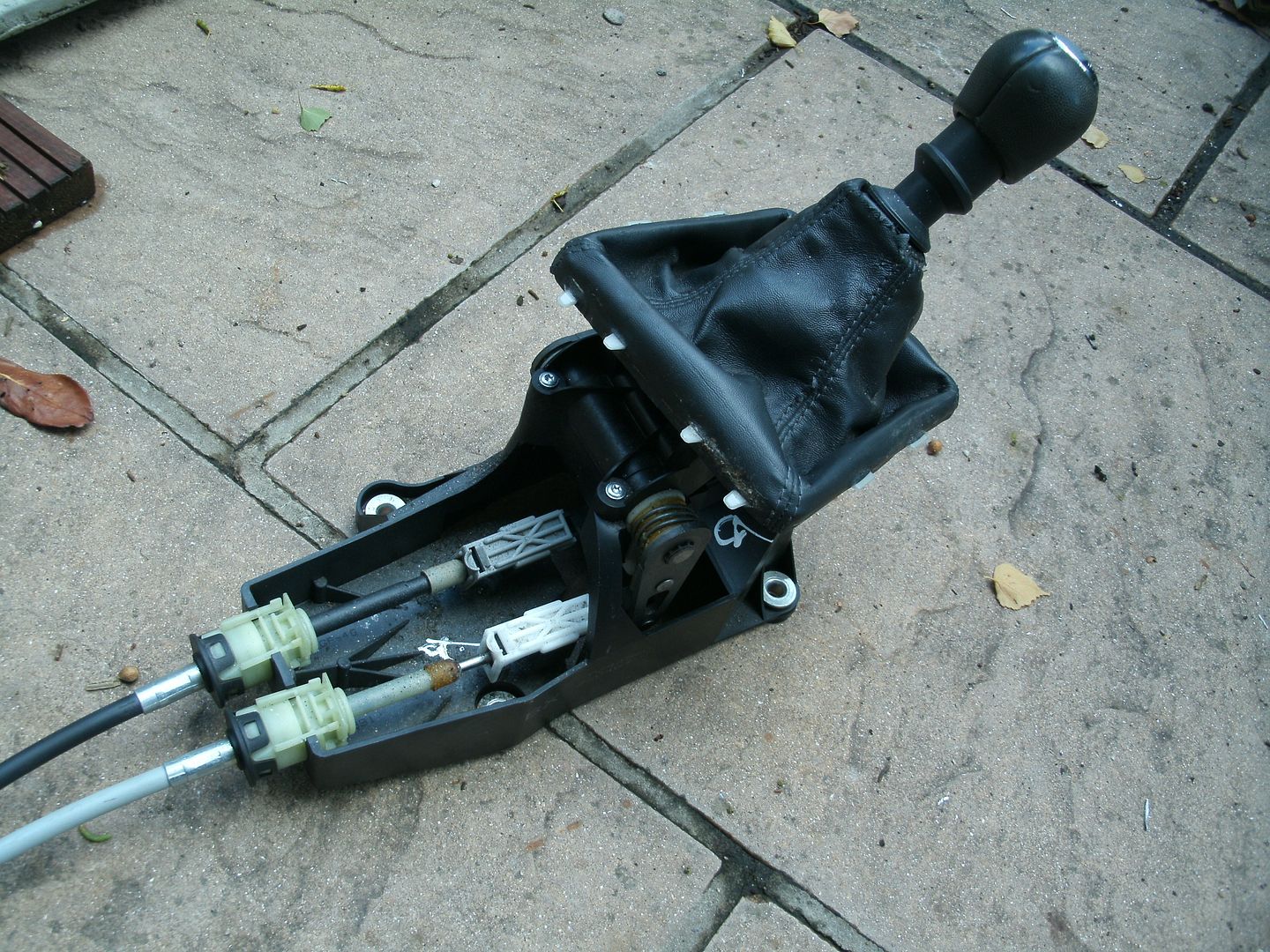

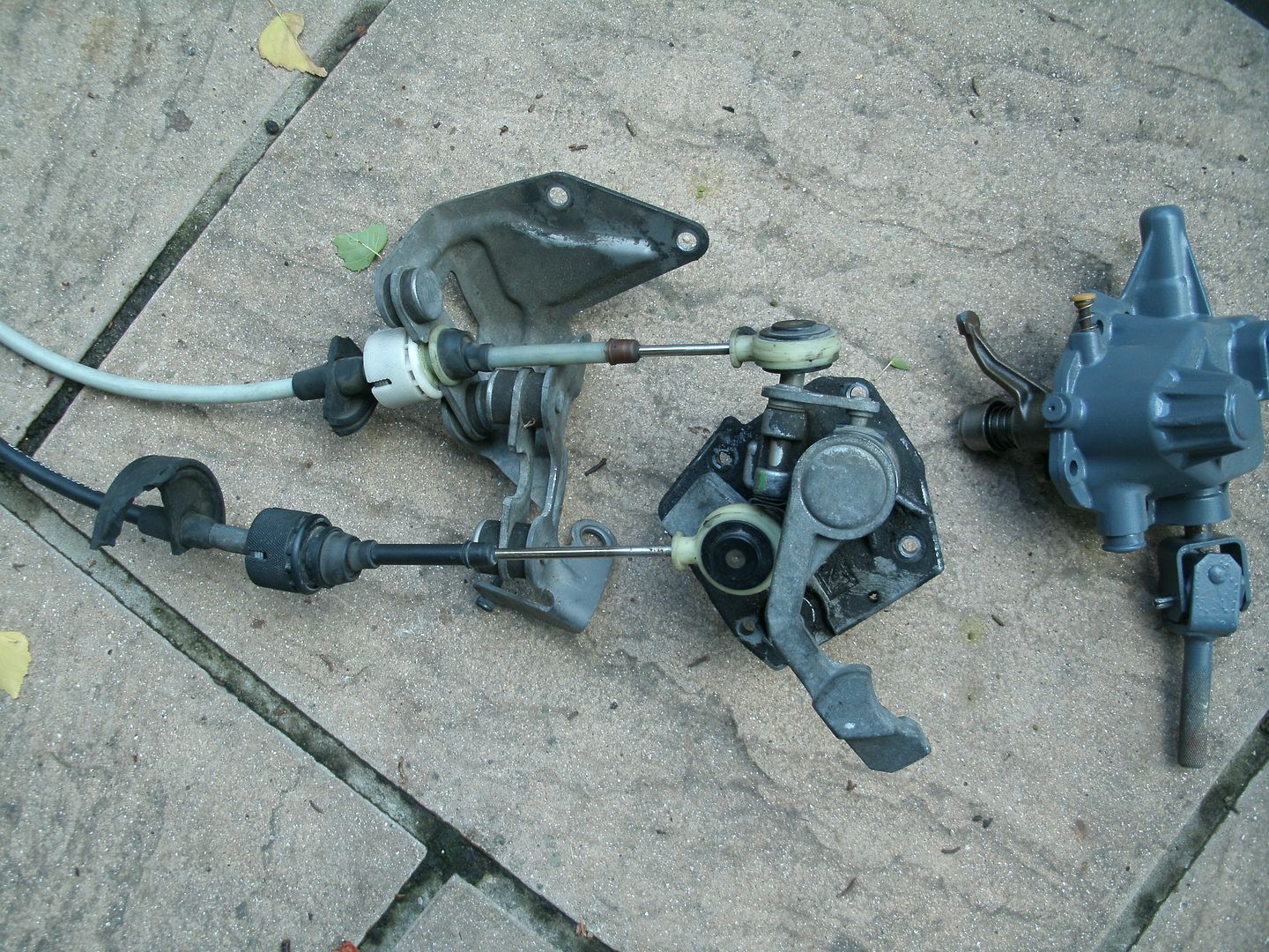

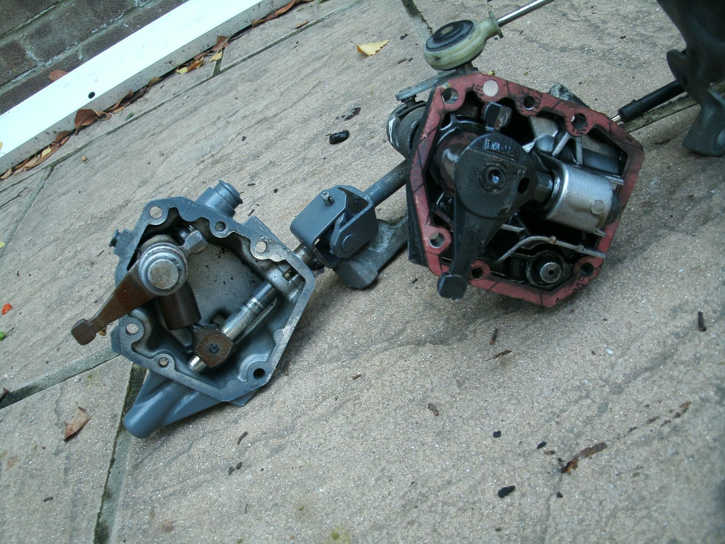

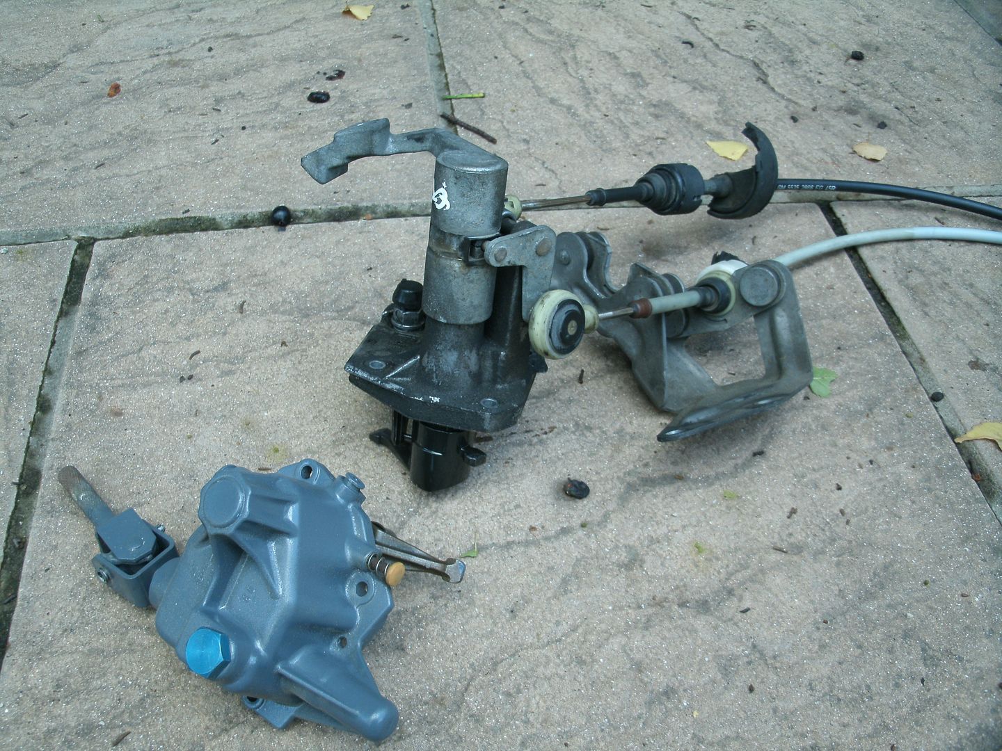

An hour in the local breakers yard at the weekend got me this for £24;
http://i285.photobucket.com/albums/l...ps2dd78546.jpg
http://i285.photobucket.com/albums/l...ps57b8367e.jpg
http://i285.photobucket.com/albums/l...ps5c569007.jpg
http://i285.photobucket.com/albums/l...ps85be50fb.jpg
http://i285.photobucket.com/albums/l...psc8d8f6f0.jpg
http://i285.photobucket.com/albums/l...ps58813467.jpg
It all bolts up to my F15 gearbox, apart from the cable support bracket which will need a bit of fabricating as there are no holes in my gearbox casing like there are in the Vectra F17.
And it selects gears!
The gearbox turret part is a little heavier than the rod-change unit I've removed, but overall I suspect it will be about the same.
Whether the cables are the right length remains to be seen.

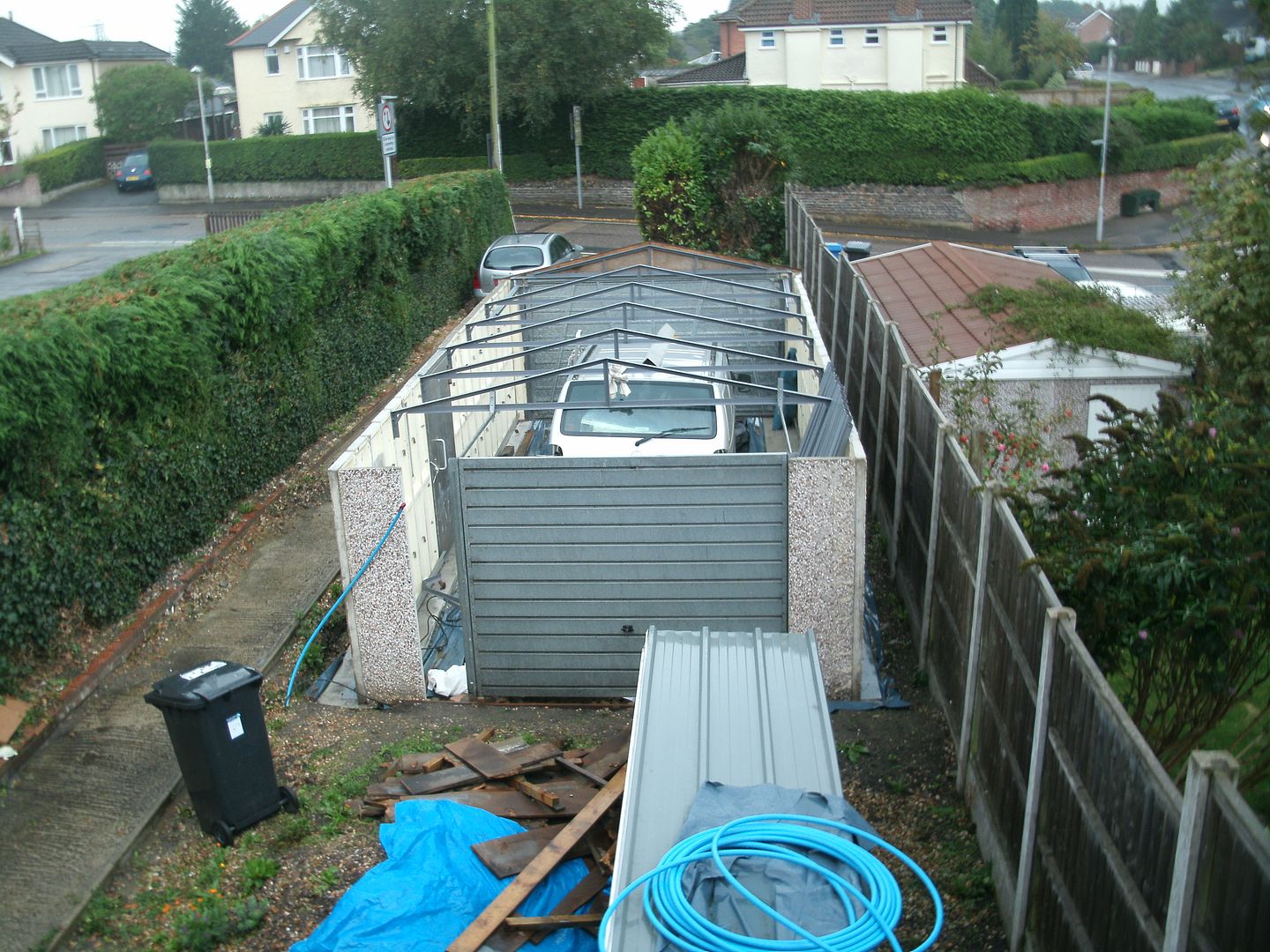

A little more progress on the build of my garage, the roof trusses are all painted, the side door is fully installed, and the rear door is partially fitted;
http://i285.photobucket.com/albums/l...psad042729.jpg
If it stops raining I will be out there today to fit the purlins, and then it will be ready for the roof panels.

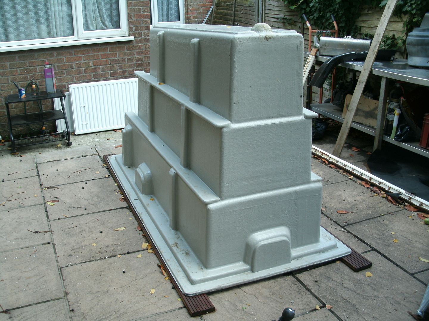

I also picked up the new inspection pit, so I have to dig the hole for that. But more concrete to pour and the roof to be fitted before the pit can be installed;

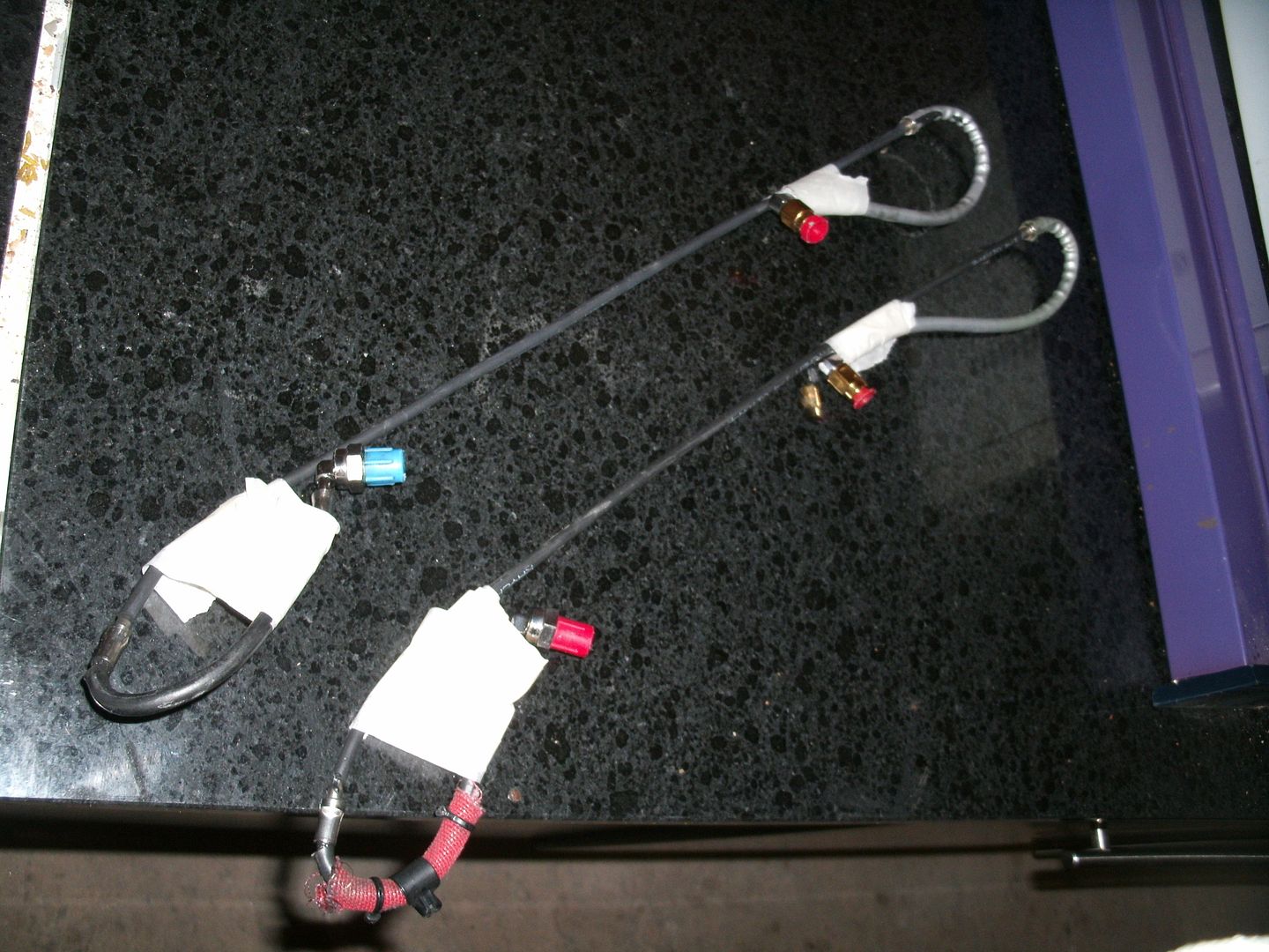

And a couple more goodies which may or may not get used. Ultra-trick brake pipes from an F1 car, with titanium fittings, which I hope can be used for my rear brakes;
http://i285.photobucket.com/albums/l...ps4decfb5c.jpg

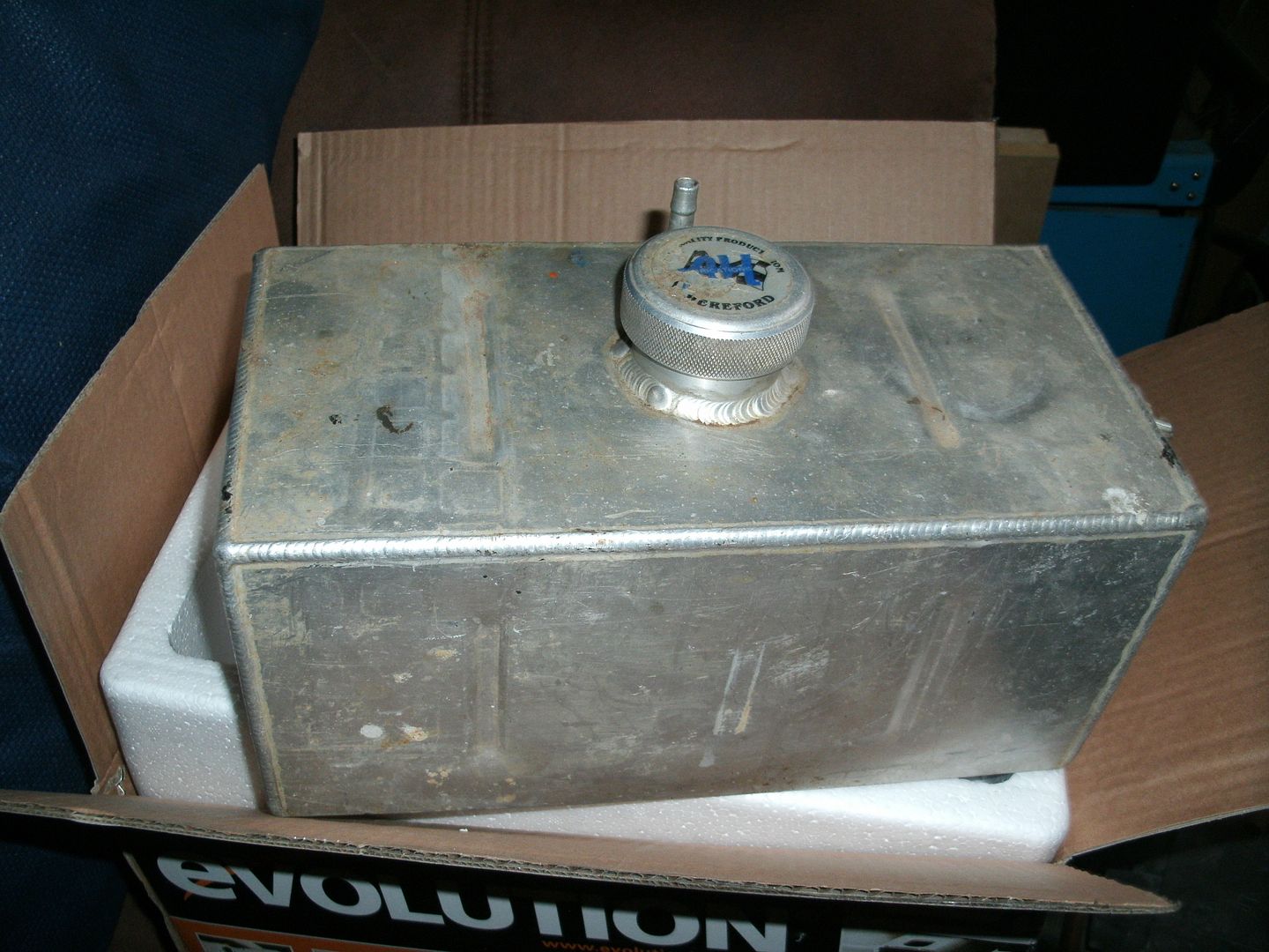

And a little AH Fabrications alloy fuel tank which I might install under the bonnet (not decided on this aspect yet);
http://i285.photobucket.com/albums/l...ps37f355dc.jpg
