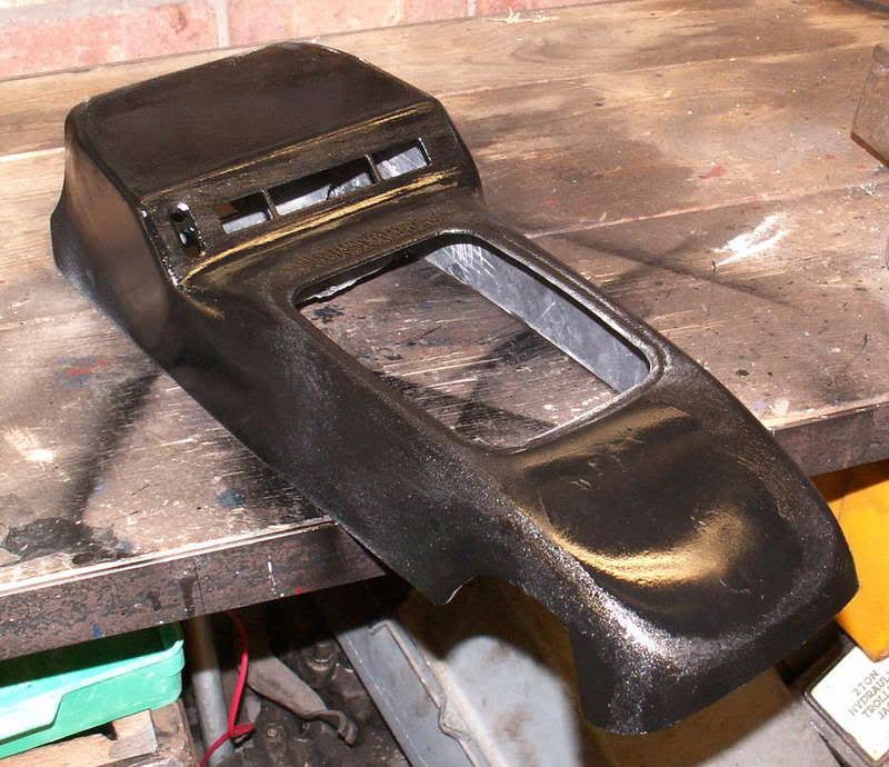

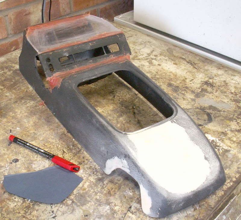

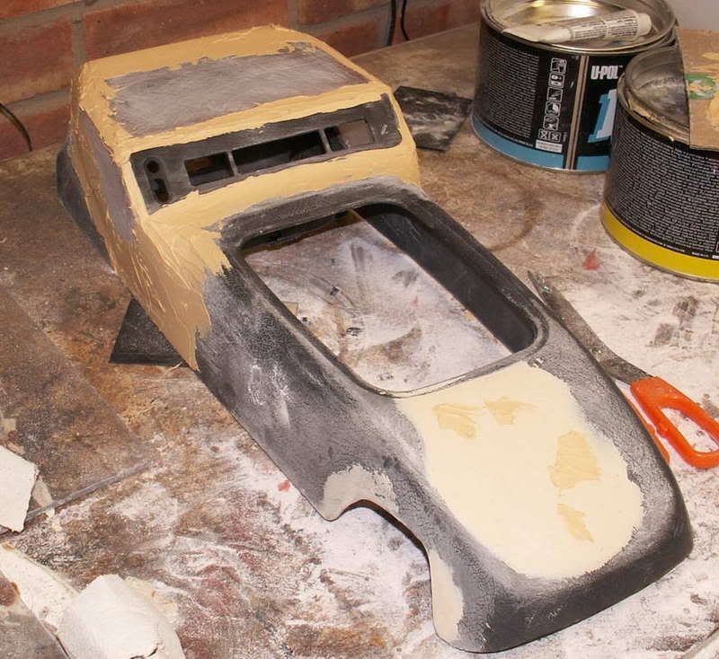

First job was to sort the centre console - I have decided to mount the intercooler inlet and outlet temp displays in the ashtray so needed a home for the corsa triple info display and came up with this (early stages) ....
http://i2.photobucket.com/albums/y15...a/Centre3a.jpg
It then needed a bit of blending and smoothing ....
http://i2.photobucket.com/albums/y15...a/Centre4a.jpg
And finally spraying matt black ready for the flocking ...
http://i2.photobucket.com/albums/y15...a/Centre5a.jpg

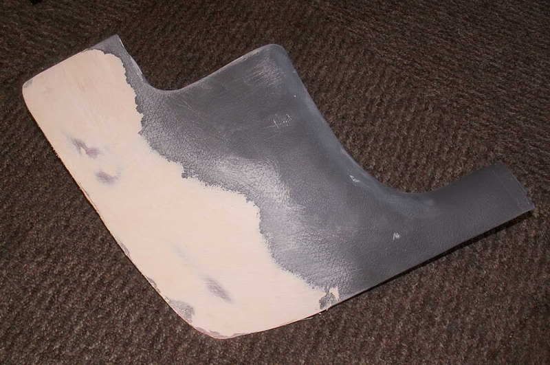

Also started on the kickwell - I have decided that as per the corsa application its easier to mount the ECU here than having keep dropping on my feet whilst driving (as the corsa dash does not have a drivers side shelf!
http://i2.photobucket.com/albums/y15...ova/Kick1a.jpg

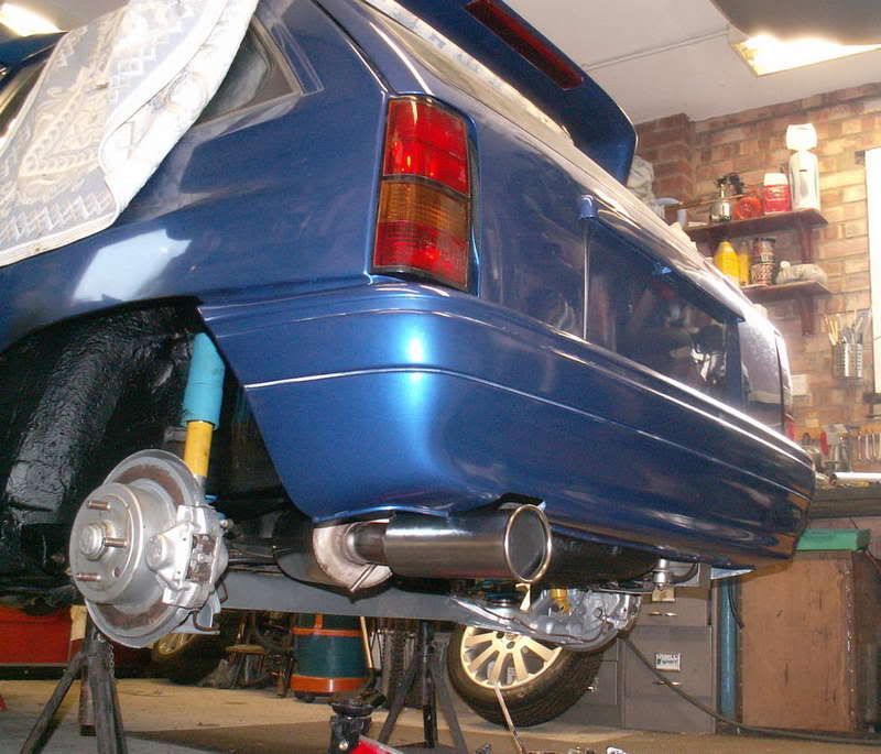

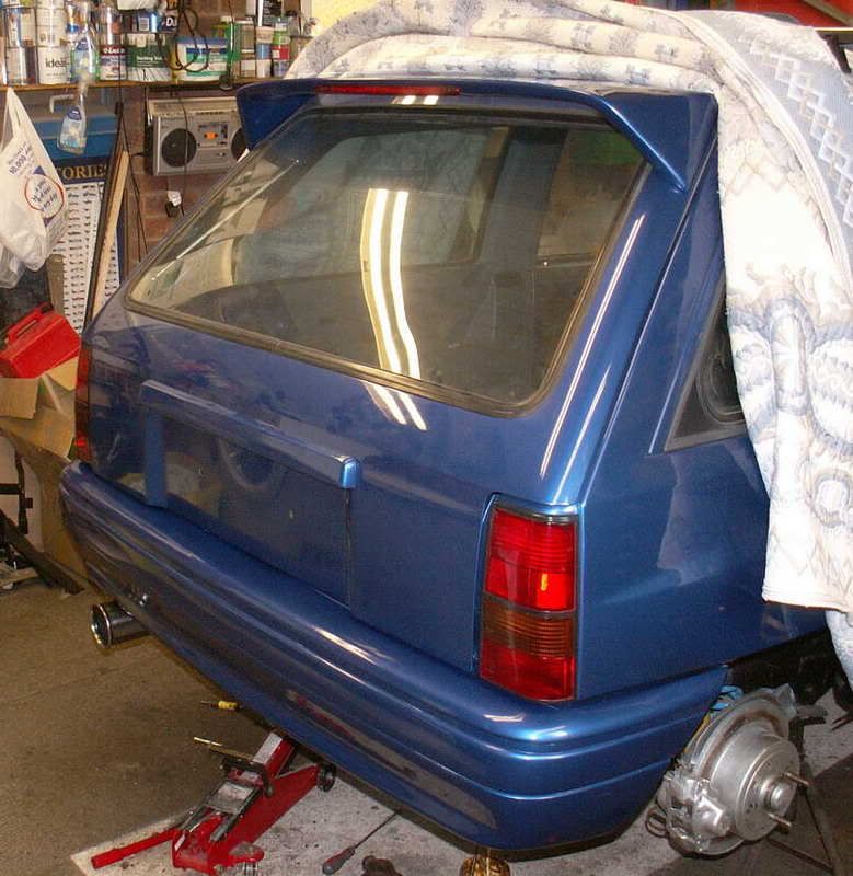

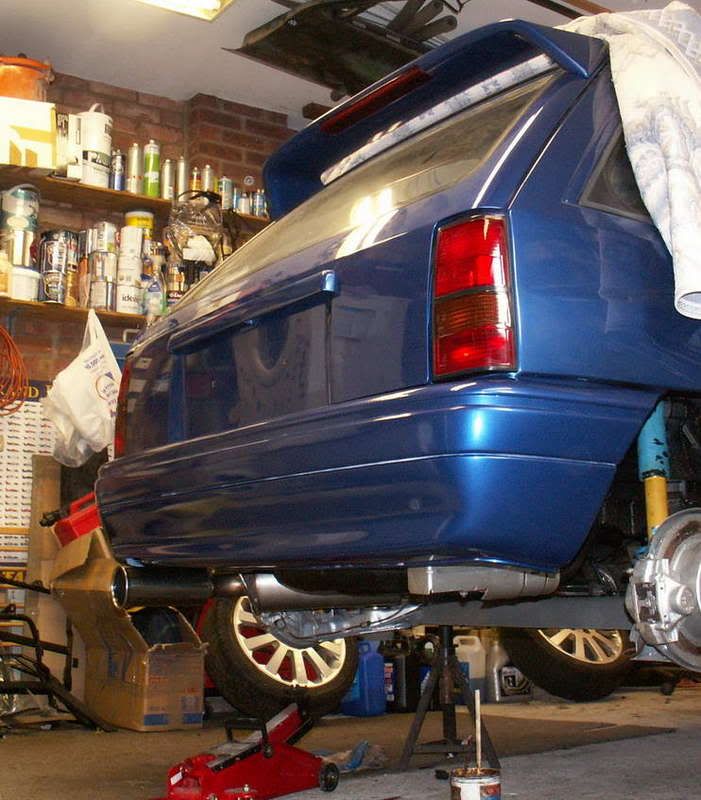

Also managed to get the rear bumper fitted - looks quite good without the number plate light and towing eye recess .....
http://i2.photobucket.com/albums/y15.../RBumper1a.jpg
http://i2.photobucket.com/albums/y15.../RBumper2a.jpg
I also sorted out the mounting holes on the nearside which needed lengthening as the bumper sat too low down the quarter panel as seen here.....
http://i2.photobucket.com/albums/y15.../RBumper3a.jpg

sorry to be picky joff but it looks like your n/s/r wheel hub has a stud out of it:confused:
Yeah man, it all the rage ! 3 stud conversion. Can get some mincy saxo wheels now. Nice :thumb:Quote:
