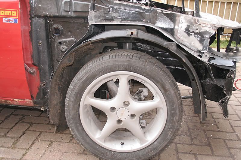

Took delivery of my Corsa B inner arch linings for the from arches in the morning -
http://img.photobucket.com/albums/v13/danga/bay0006.jpg
I'm really impressed at how snug they are -
http://img.photobucket.com/albums/v13/danga/bay0007.jpg
http://img.photobucket.com/albums/v13/danga/bay0008.jpg
They need modding just slightly (plastic panels around the turrets and some mounting areas) and I need to make some clips to secure them.

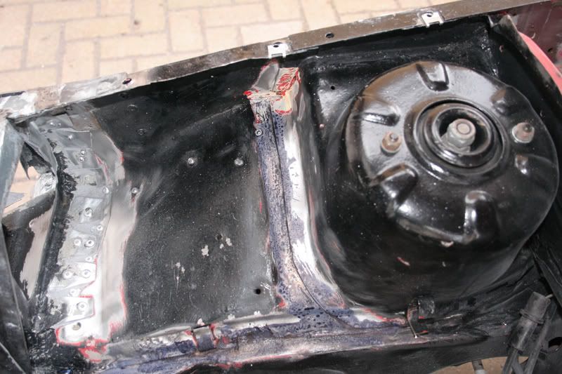

Anyway - I decided to weld some areas in my engine bay - felt it necessary to reinforce the light surrounds (may as well do it "properly" now I have a welder!). Also thought (after seeing several rebuilds to the same) to reinforce the strut tops and sides of the bay with additional beads of weld.
Started off by removing the paint and seam sealer -

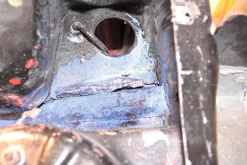

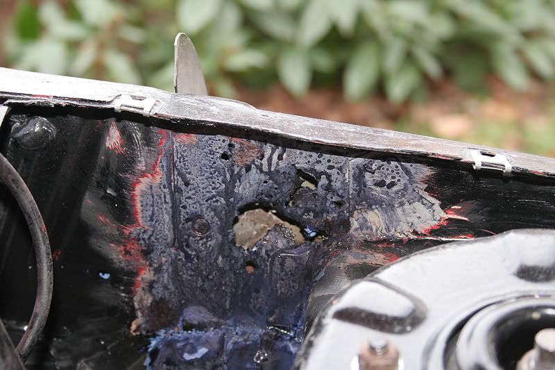

and in doing so came across this nice hole in me inner wing (feck knows how I missed it before!) -
http://img.photobucket.com/albums/v13/danga/bay0001.jpg
Also directly below it where the engine loom harness goes into the body notices the join was totally fecked!
http://img.photobucket.com/albums/v13/danga/bay0013.jpg
Thankfully this is more cosmetic as when the arches were replaced a couple of years ago the guys that did it welded up the hole directly beneath - however the big gap is a perfect water trap so may as well stick a sheet of metal over it.

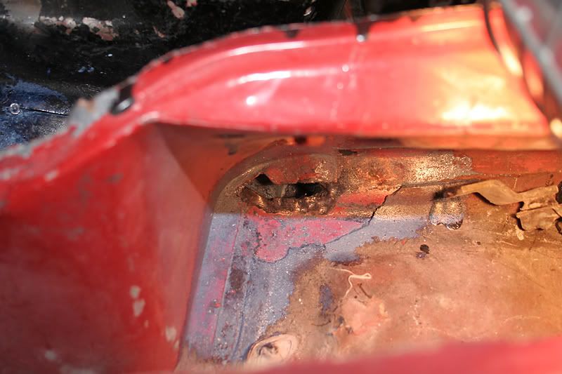

Also came across this wee bugger tucked in the corner of the skuttle panel (passenger side) -
http://img.photobucket.com/albums/v13/danga/bay0012.jpg
With all this cleaned up and krust'ed I called it a day...and went and got blootered!

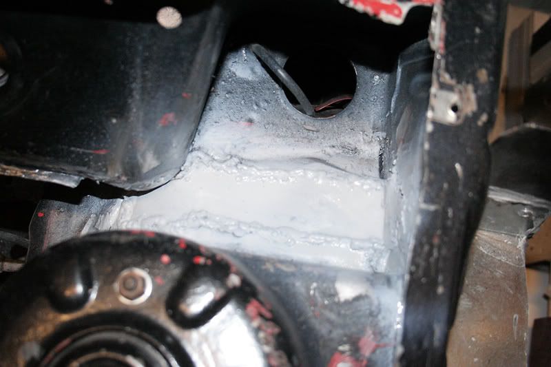

Started with the "cosmetic" gap behind my passenger side turret -
Before -
After -
http://img.photobucket.com/albums/v13/danga/bay0016.jpg

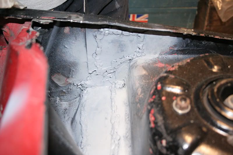

and with a healthy dose of etch primer -
http://img.photobucket.com/albums/v1...a/bay00017.jpg

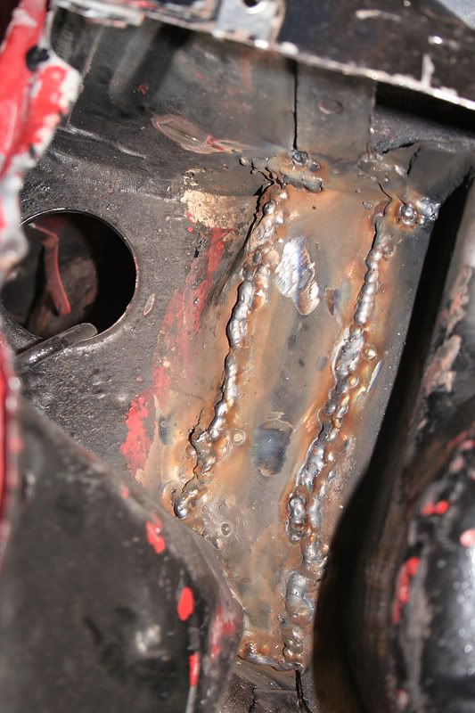

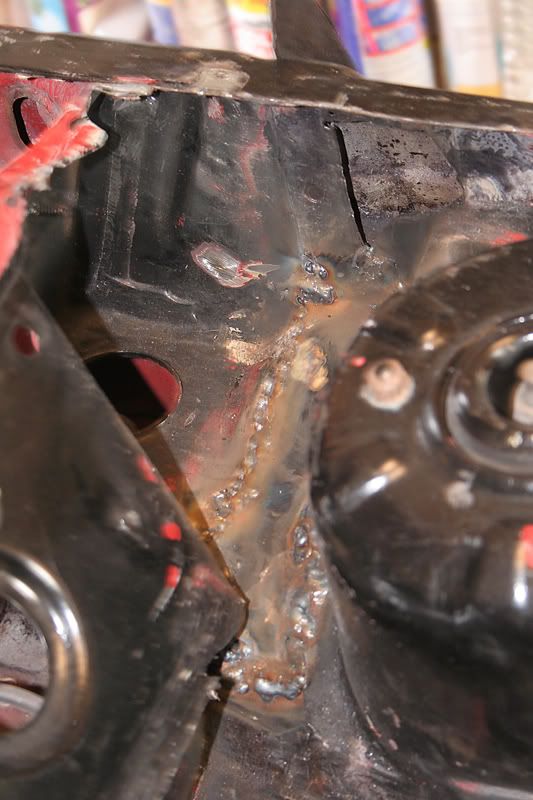

inner arch before (trimmed rust away) -
http://img.photobucket.com/albums/v13/danga/bay0017.jpg
After (with primer) -
http://img.photobucket.com/albums/v1...a/bay00022.jpg
Welds are a little messy but its a really tight area however I'm pretty confident I got full penetration.

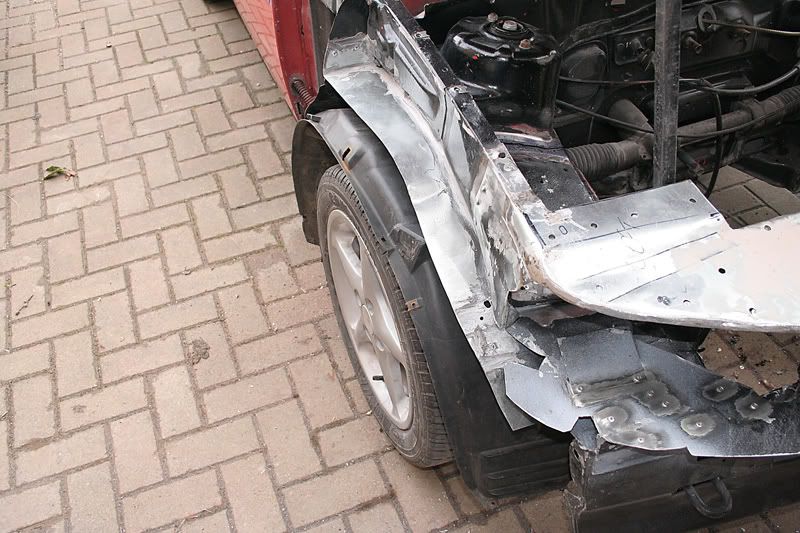

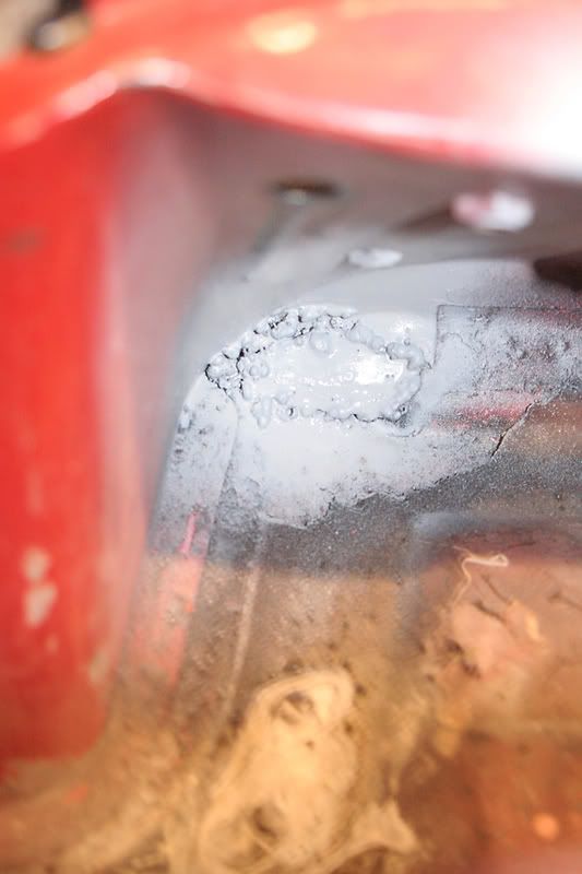

Little skuttle panel area before -
After -
http://img.photobucket.com/albums/v1...a/bay00023.jpg
This one was an absolute biatch to get to - it's messy but tbh I dont really care - theres no gaps (based on me shining a torch on it and looking underneath) and it'll get a big wad of sealer over it.
In fact they all will.

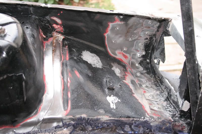

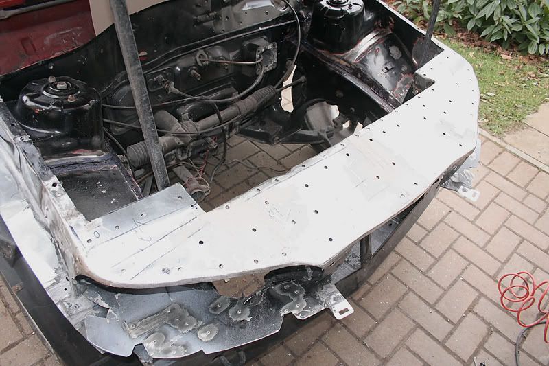

Next step is to do some beads around the turrets, sides and the light housings. I also used me new fangles spot weld drill bit to pre drill some holes in the slam panel section I welded the other week so I can puddle weld it to the undrside making it uber strong!
Looks like swiss cheese at the moment...
http://img.photobucket.com/albums/v13/danga/bay0009.jpg
Will weld it up tomorrow...
