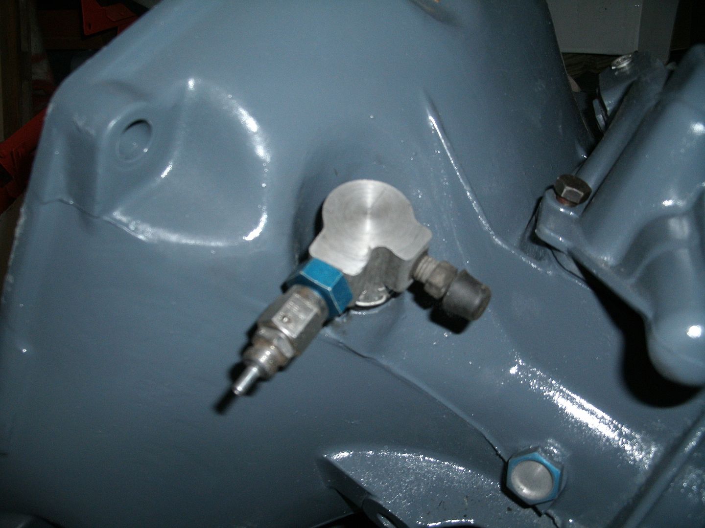

Colin I don't understand what you need when you say round-nose clutch release bearing, because what you've just fitted should be all that's needed to release the clutch once the box is fitted (excluding the bleed union shown below). Unless you're in the realms of that slave cylinder not being long enough to reach the plate?
http://sadpanda.us/images/1721147-73W7UNA.jpg
the style of clutch hes using requires a round nose bearing, as a flat one can damage the spring fingers in the cover.

Hi BRoadGhost.
That's an interesting picture you've posted.
I have a bleed valve and hose (from a Corsa C), which is a plastic construction, and there's no way of mating that to an Aeroquip hose.
Could you talk me through what you did to make yours? I guess it's from a Vectra?
Is yours a small block gearbox?
Yeah fairly sure it was from an early Vectra; the bleed union just attaches to the top of the hard line from the slave cylinder on a slide clip.
Then it's just a metric male to male union with a female on the end of the braided line; I ditched the rubber standard line.
It's from an F18 (Vectra) onto an F16 (shown).

Found a clutch bleed in the scrapyard today, and got that fitted up and ready for the Aeroquip hose to it;

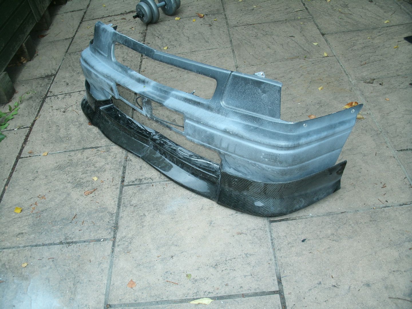

And did a bit more cutting and playing with the front splitter (not finished yet);
http://i285.photobucket.com/albums/l...ps2af3967c.jpg

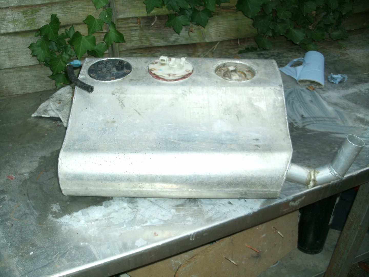

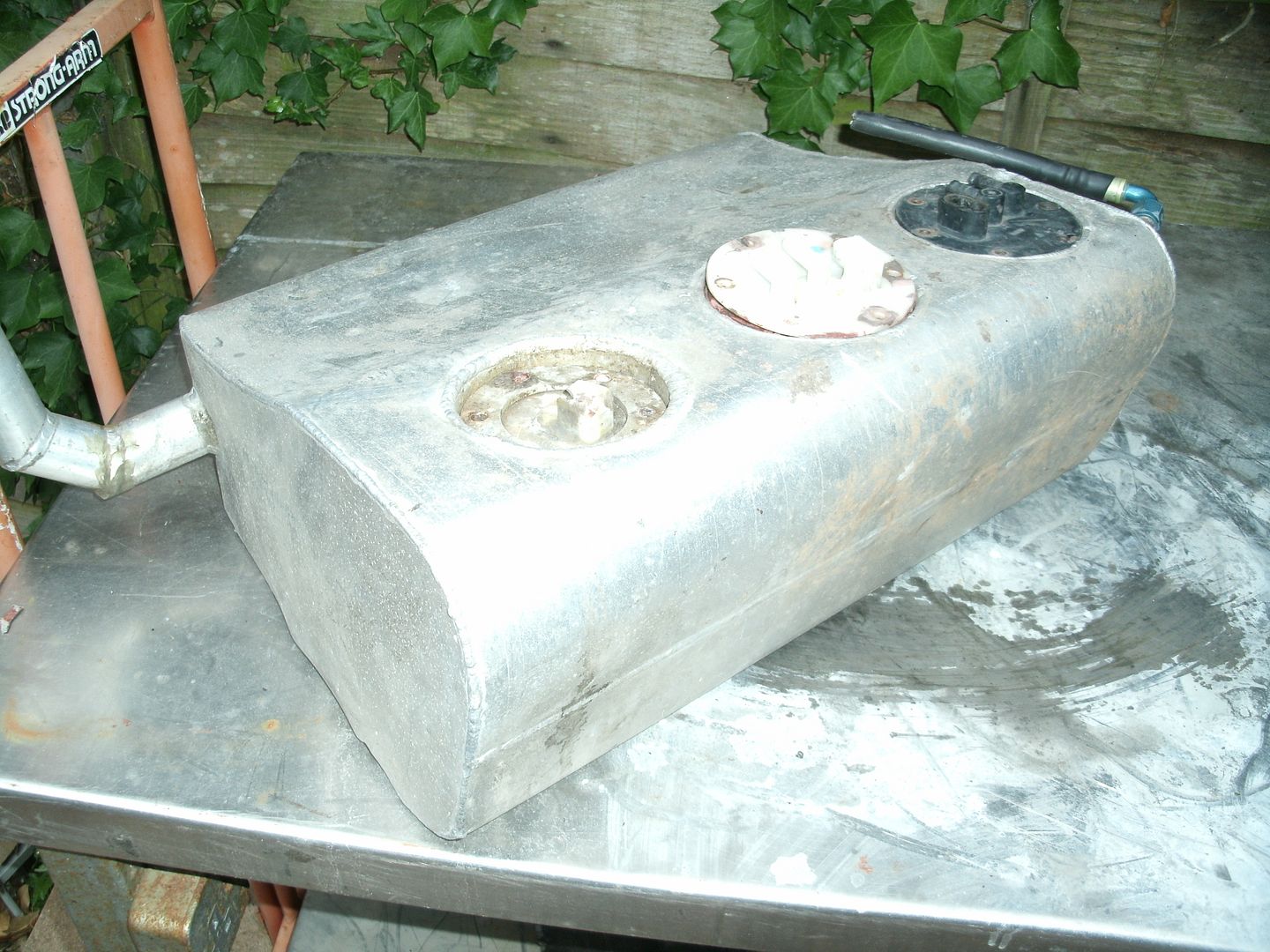

I've picked up this slightly bigger fuel tank, I'm not sure if I will use it though;
http://i285.photobucket.com/albums/l...psb13124b7.jpg
http://i285.photobucket.com/albums/l...ps40e08e10.jpg
It's got a built-in fuel pump, and a swirl pot, but is maybe a bit heavy for my needs. I did think it would be nice to have a slightly larger fuel tank for testing, as the current tank is absolutely tiny.
But now I'm thinking I will stick with a small tank and possibly relocate it to the engine bay.

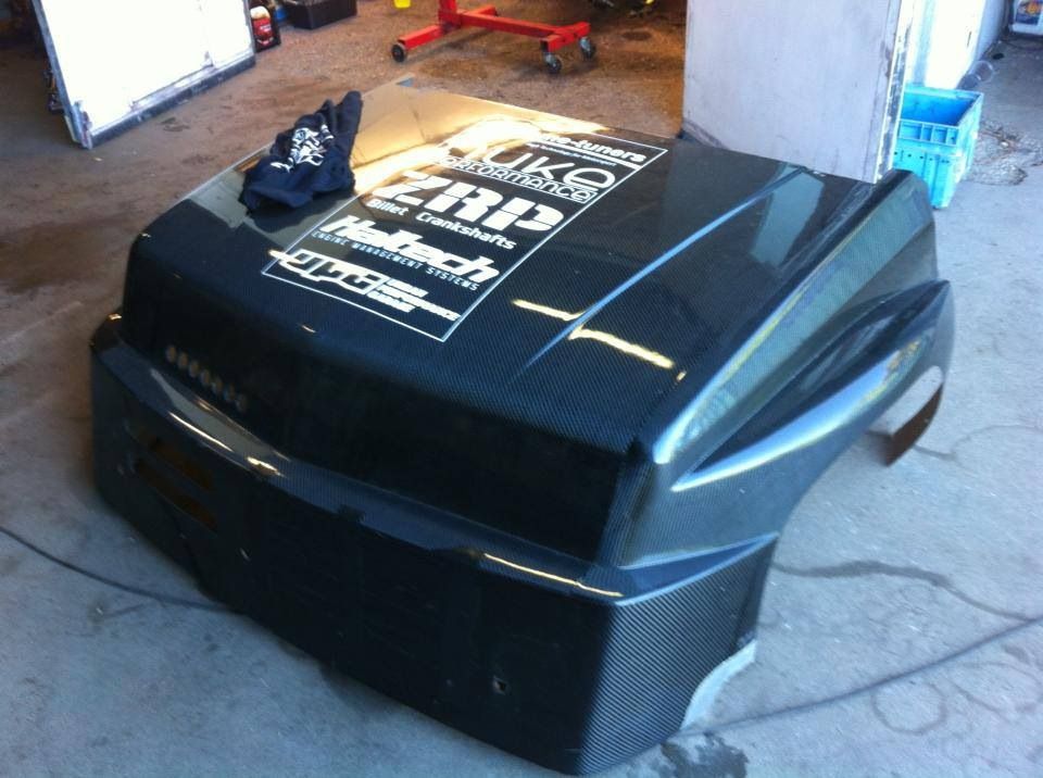

I expect a lot of people have seen the new issue of 'Total Vauxhall' with the Corsa A drag car from Bulgaria on the cover?
For those that haven't, there's some photos and details here;
http://upg.bg/en/projects/upg-carbon-corsa
It's a very interesting machine, with lots of clever detail.
Naturally with my pursuit of all things lightweight, I was taken with their one-piece carbon fibre front end, as well as the carbon doors and tailgate.
So I've been chatting with the guys in Bulgaria, and they've given me some prices and weights for these bits. The weights are impressive to say the least, but the prices are literally eye-watering......
Definitely something to think about for future developments though, as even on my car it could save me well over 10kg. Mind you, I could probably build up another bodyshell with lightweight T45 rollcage for much the same money!

The front end was extremely light, on several occasions it was nearly blown over outside our workshop lol
The door hinge was broken on arrival and I believe there is normally a better way to secure the door than using tape but that was the fastest solution at the time, either way it is only an outer skin and weighed less than the polycarbonate window

I was aware that the doors are just a skin, and I don't think they would be much use to me, unless a more satisfactory method of fixing them can be devised. They're quoting £600 and 600g for one door skin.
As for the front end, I will get one of those if I can ever get some money together. It would be perfect for my car.
Total weight for that is 5kg, which is nice, but the price is £2150. Ouch.

to be fair i dont think those prices are that out of the way, its a lot of work and the materials arent cheap, the savings are huge too. Not saying its a cheap option but for those gains its reasonable bhp/tonne savings.
You're absolutely right Ben.
For the moment, the bigger gains will come from the engine I'm having built, and the carbon fibre is for a later date.

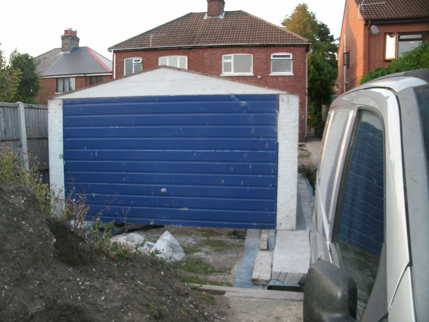

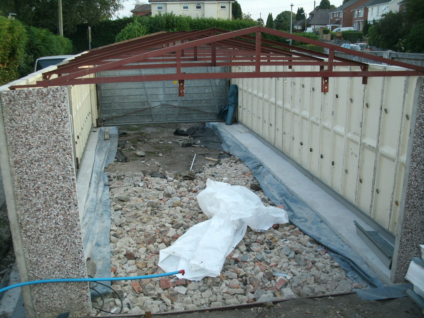

The new garage for the Nova is now erected.
By tomorrow the front door should be fitted, which will just (!!) leave the roof, the rear door and some of the floor to be done to complete the structural work. So not much then.....
Oh, and then the electrics, lots of sealing up and tidying, and somehow disposing of the huge mound of soil that I excavated in the first place.

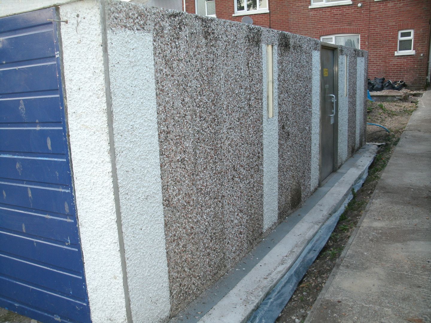

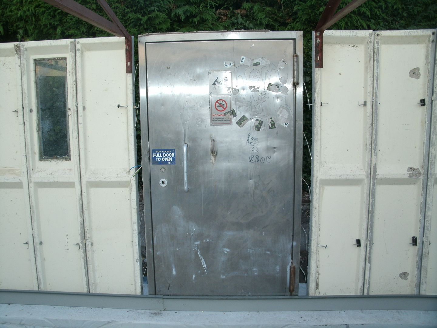

Very much work in progress, but this is where my garage build stands currently;
http://i285.photobucket.com/albums/l...ps81bfc0ac.jpg
http://i285.photobucket.com/albums/l...ps70069d5a.jpg
http://i285.photobucket.com/albums/l...psbff6930e.jpg
http://i285.photobucket.com/albums/l...ps1912da23.jpg
http://i285.photobucket.com/albums/l...ps5a6efae2.jpg
http://i285.photobucket.com/albums/l...ps8792ec2d.jpg
http://i285.photobucket.com/albums/l...psbc59aed1.jpg
http://i285.photobucket.com/albums/l...ps8b309701.jpg
http://i285.photobucket.com/albums/l...ps55d7bf4d.jpg
Not very pretty at the moment, but it's a good size and I have lots of plans to make it better when funds allow. Total cost so far (excluding the basework) is well under £500, so I can't complain.
Looking good Colin, you need a gas chamber sticker on that door lol
