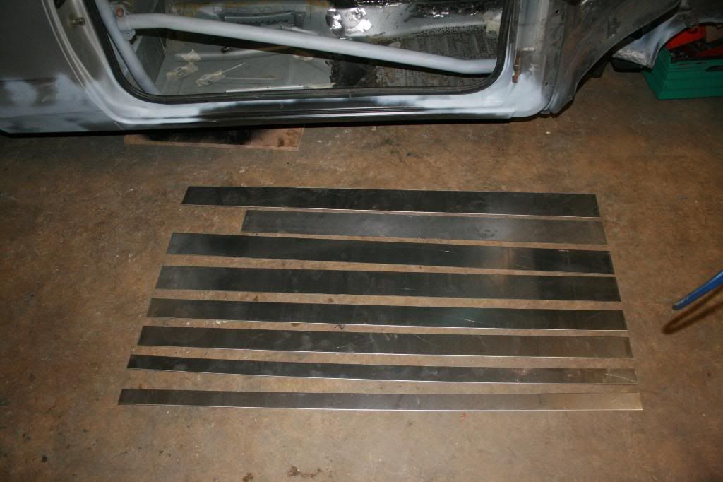

Right i know i have been teasing you all for a while now but, i have got to the point now were i can reveal what the strips of 2mm steel are for...i'm not sure how may people have tried this before but i haven't seen it done? So i thought i would give it a go and its turned out well!
So here goes it all started like this (and yes Olly and i did discuss the idea but i'm not letting him take all the credit :p)

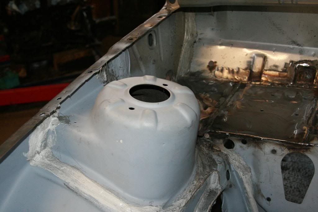

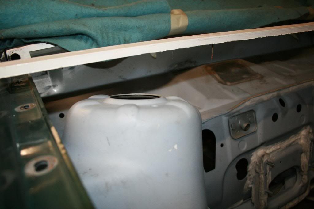

Two front turrets
http://i248.photobucket.com/albums/g...urrets1193.jpg
http://i248.photobucket.com/albums/g...urrets1192.jpg

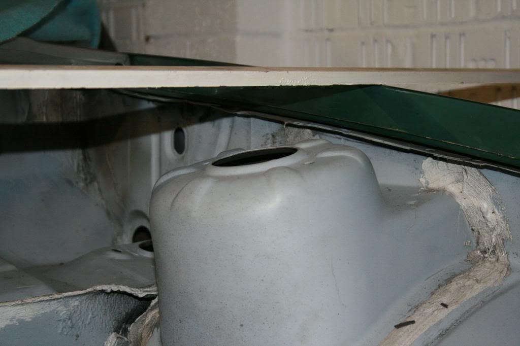

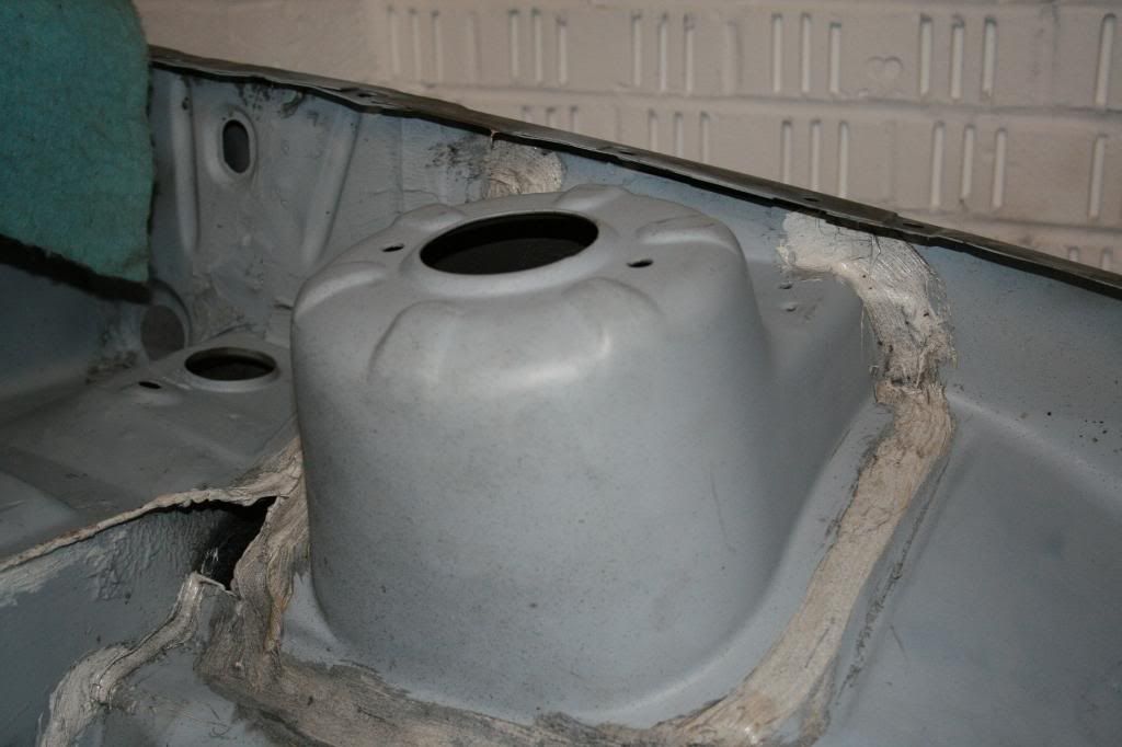

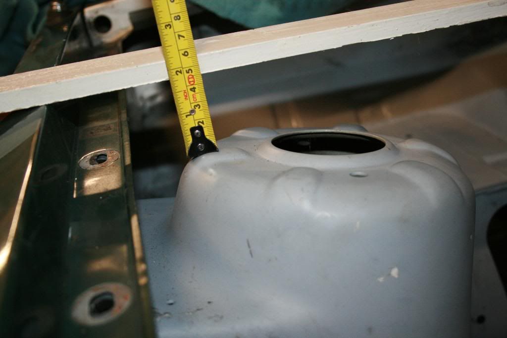

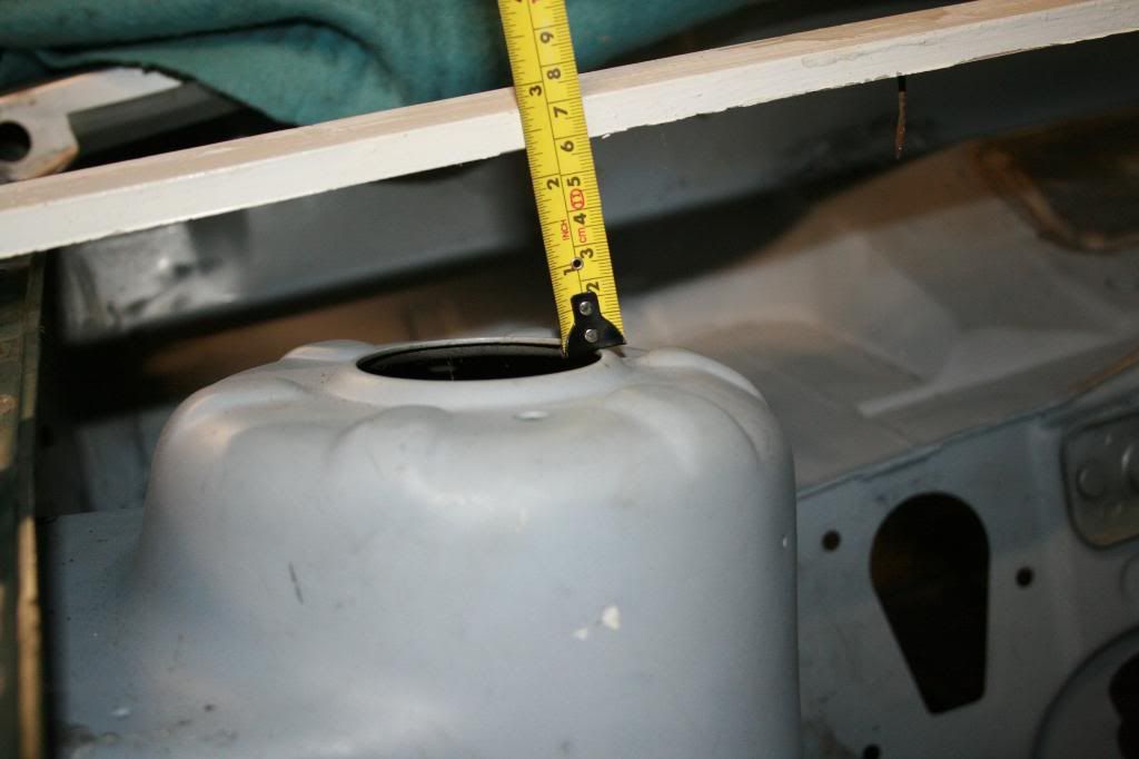

A straight edge and a measuring stick - note i have temporarily fitted some front wings
http://i248.photobucket.com/albums/g...urrets1212.jpg
http://i248.photobucket.com/albums/g...urrets1213.jpg
http://i248.photobucket.com/albums/g...urrets1215.jpg
http://i248.photobucket.com/albums/g...urrets1214.jpg

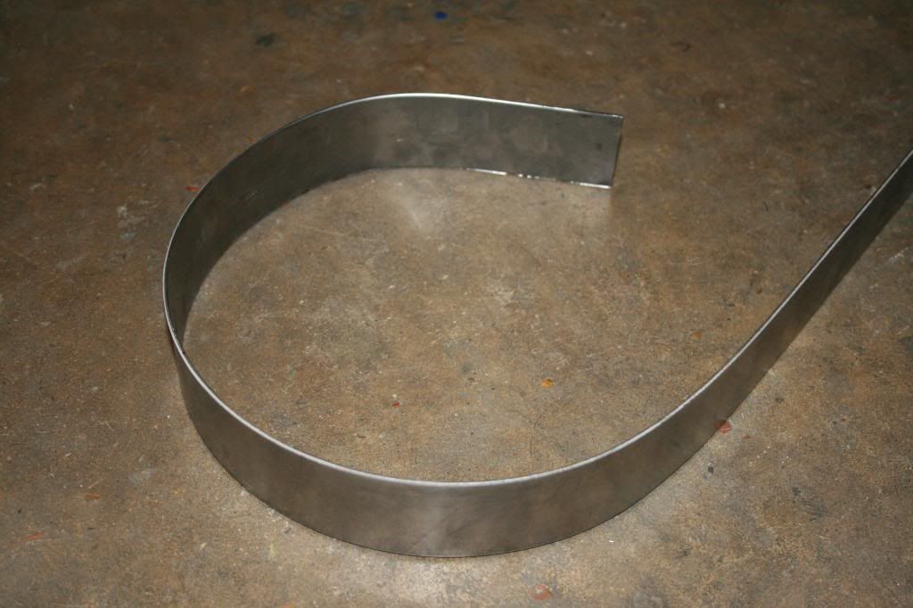

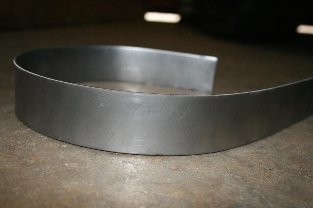

And some strips of metal
http://i248.photobucket.com/albums/g...urrets1207.jpg
....Any one got it yet???

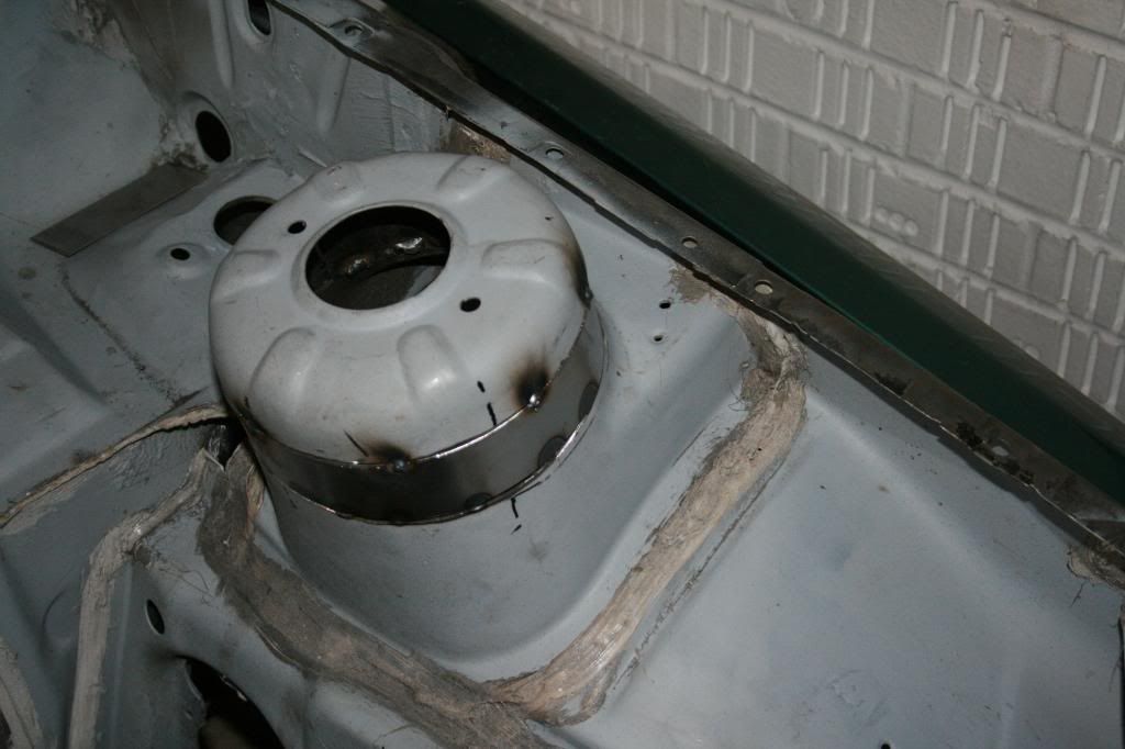

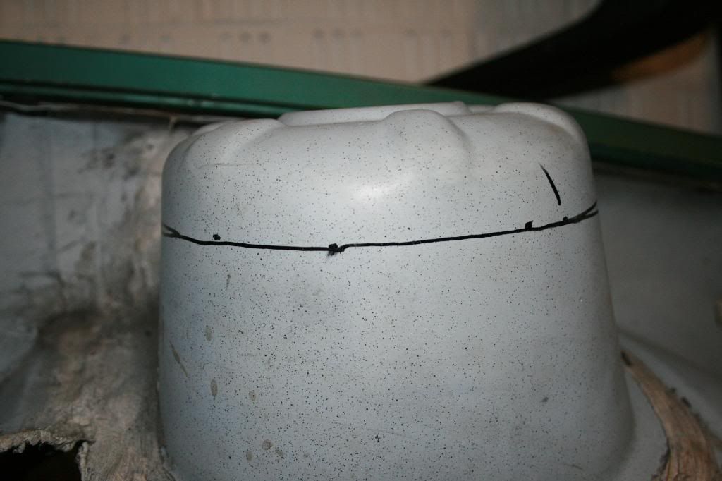

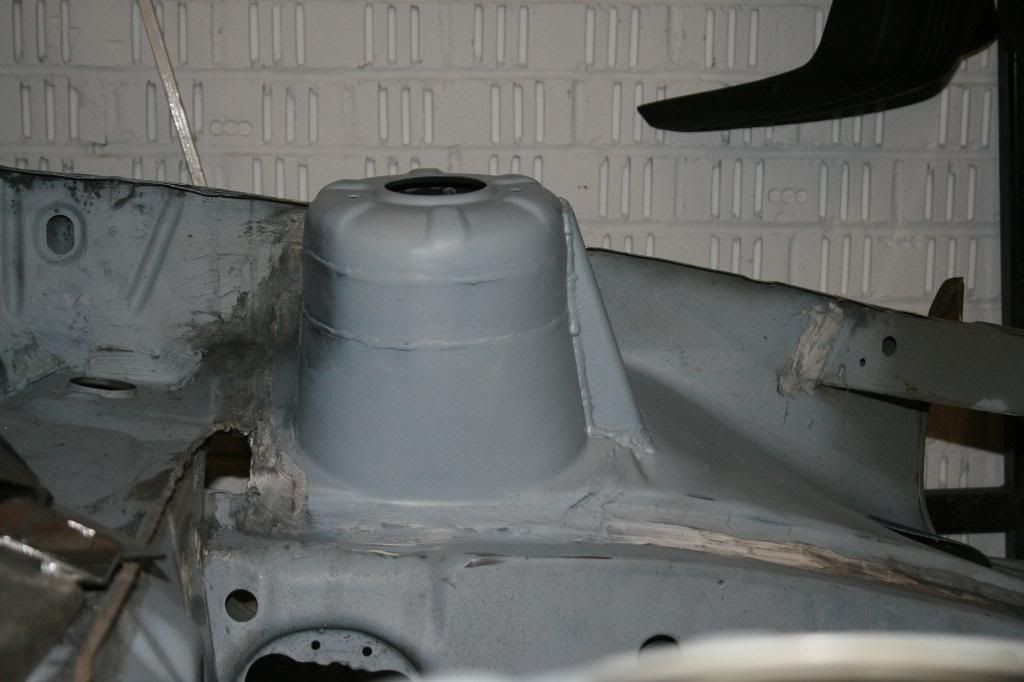

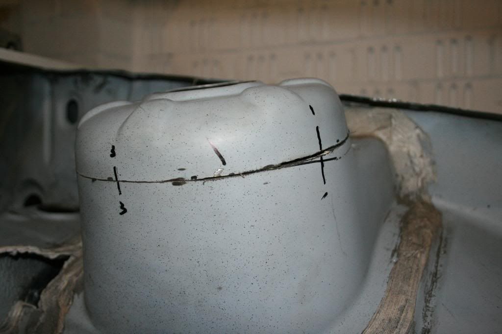

So after some careful measurements and a bit of head scratching i marked out a datum line to work from - 80mm down from the edge of the hole in the top of the strut.
As so
http://i248.photobucket.com/albums/g...urrets1216.jpg
http://i248.photobucket.com/albums/g...urrets1217.jpg

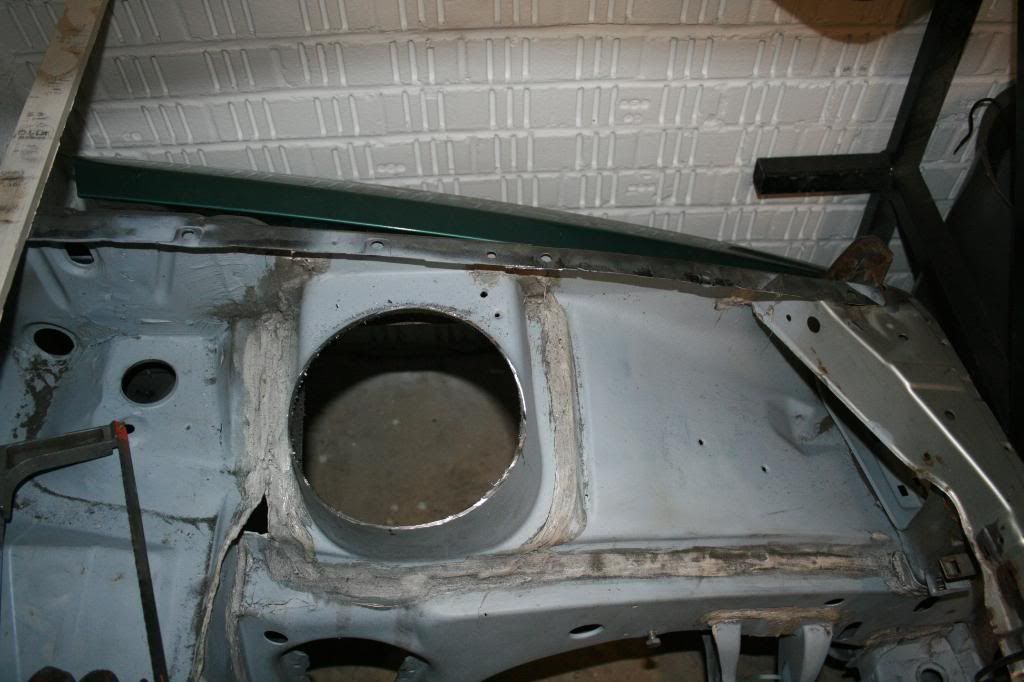

Marked out some more reference points and got the grinder out
http://i248.photobucket.com/albums/g...urrets1219.jpg
Chomp!
http://i248.photobucket.com/albums/g...urrets1220.jpg
http://i248.photobucket.com/albums/g...urrets1221.jpg

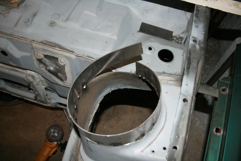

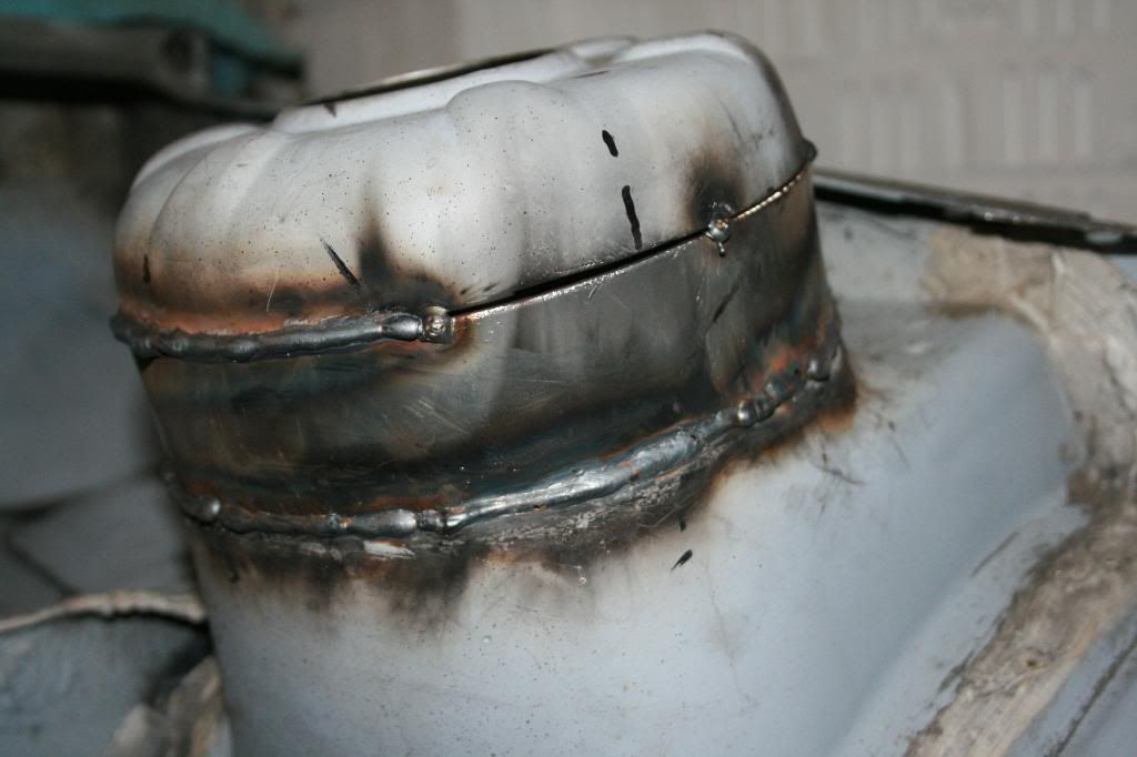

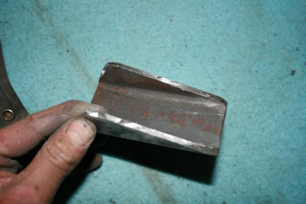

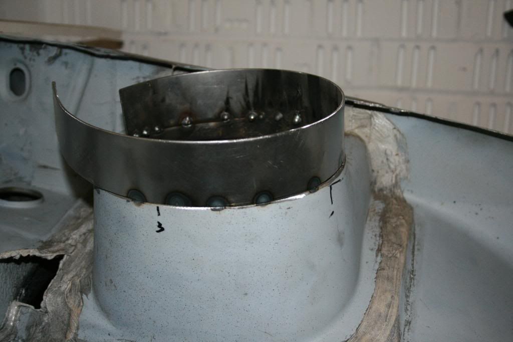

Then to solve the mystery it was time to use one of the strips of steel i went for a comfortable 45mm
I started by profiling it roughly to shape
http://i248.photobucket.com/albums/g...urrets1222.jpg
http://i248.photobucket.com/albums/g...urrets1223.jpg

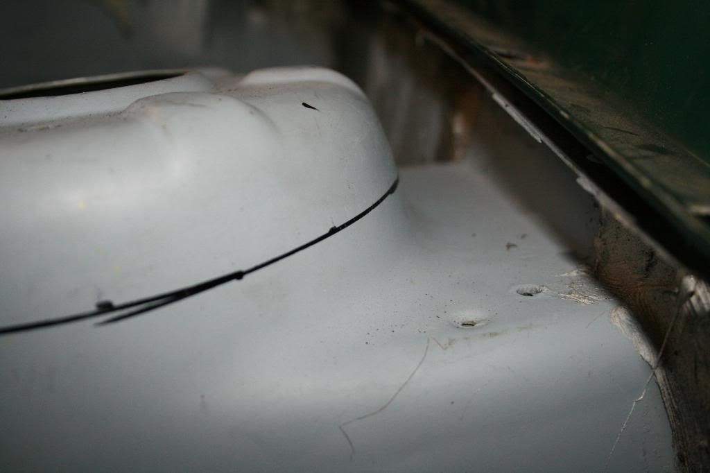

Then began taking it in after i had cleaned up the seams
http://i248.photobucket.com/albums/g...urrets1224.jpg
http://i248.photobucket.com/albums/g...urrets1225.jpg
http://i248.photobucket.com/albums/g...urrets1226.jpg

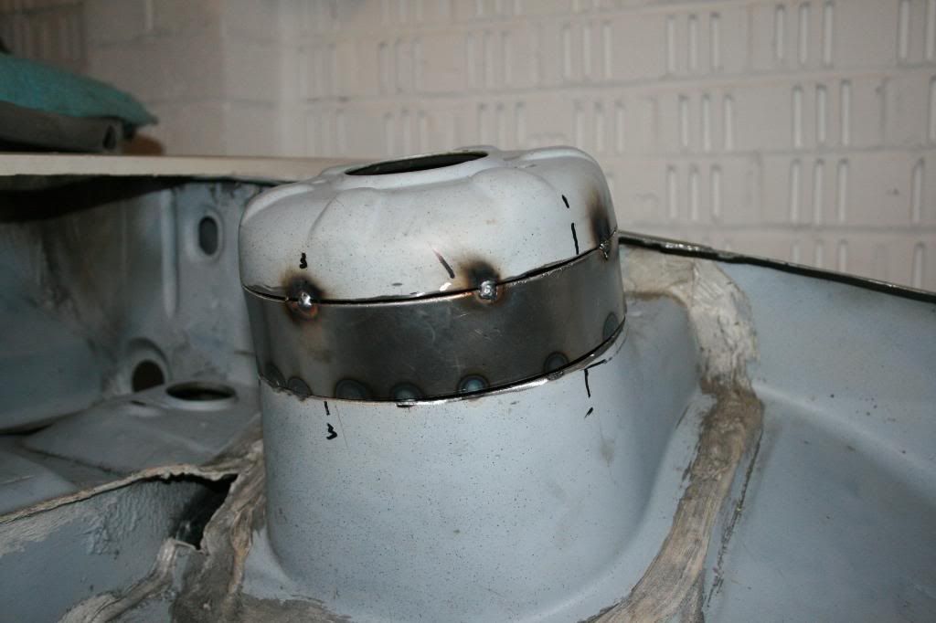

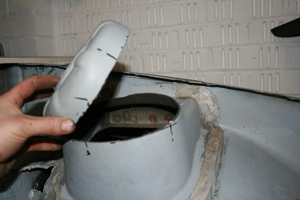

tried the 'lid' on for size and made a few small alterations
http://i248.photobucket.com/albums/g...urrets1227.jpg

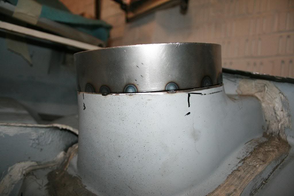

And tacked it on
http://i248.photobucket.com/albums/g...urrets1229.jpg
http://i248.photobucket.com/albums/g...urrets1231.jpg
And started to weld it all in until the welded decided it was hot as funk again
http://i248.photobucket.com/albums/g...urrets1232.jpg

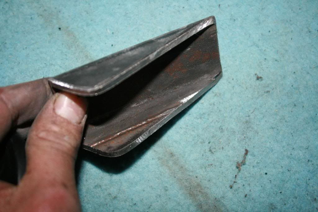

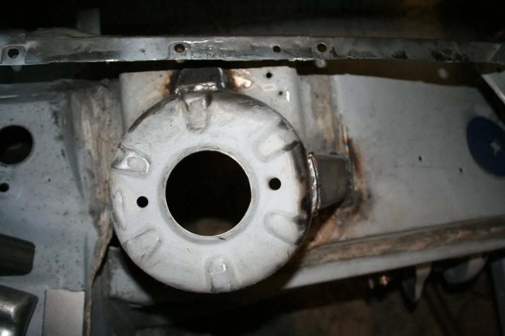

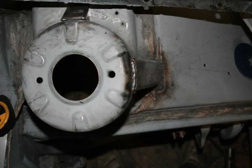

So while i was waiting for the welder to cool i decided to make up some supports for the new extension.

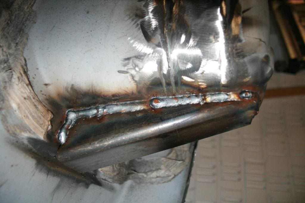

I gave the turret a clean up and removed all the excess weld (weight) once i had finished the welding that is.
Here they are....
http://i248.photobucket.com/albums/g...urrets1234.jpg
http://i248.photobucket.com/albums/g...urrets1237.jpg
http://i248.photobucket.com/albums/g...urrets1235.jpg

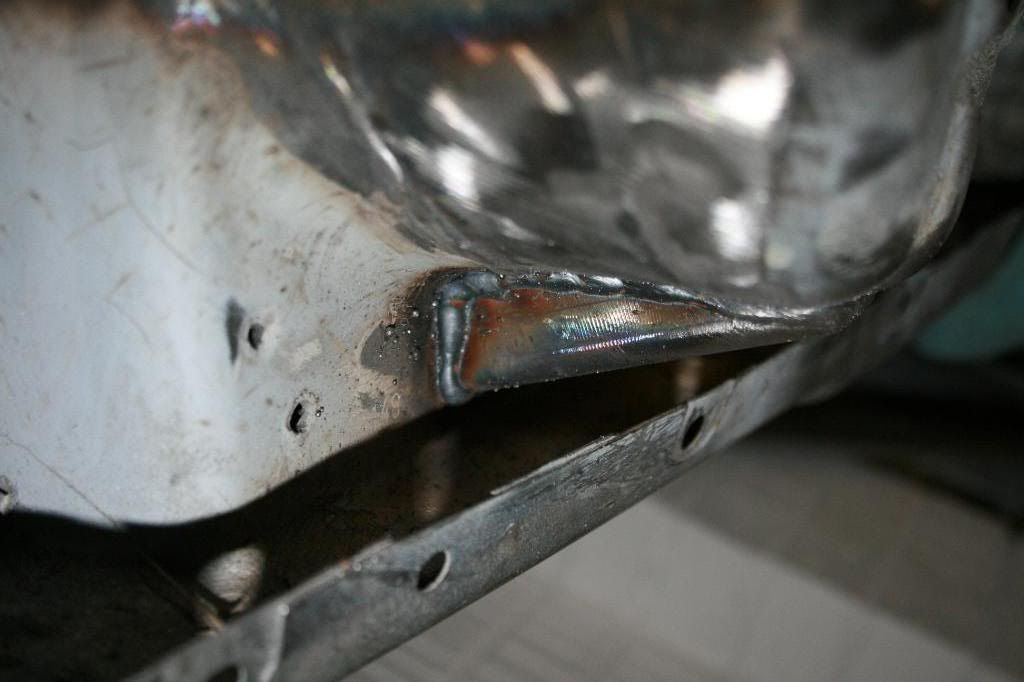

And a smaller one on the out side of the turret
http://i248.photobucket.com/albums/g...urrets1239.jpg
http://i248.photobucket.com/albums/g...urrets1240.jpg
http://i248.photobucket.com/albums/g...urrets1241.jpg

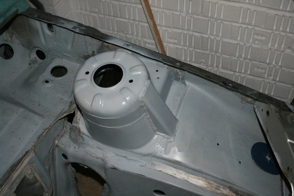

Its going in there
http://i248.photobucket.com/albums/g...urrets1242.jpg

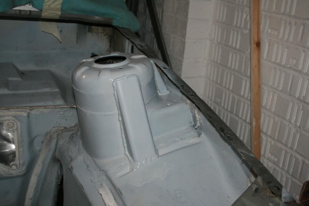

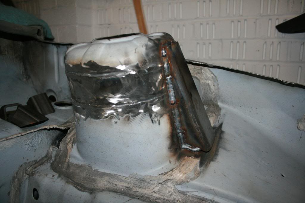

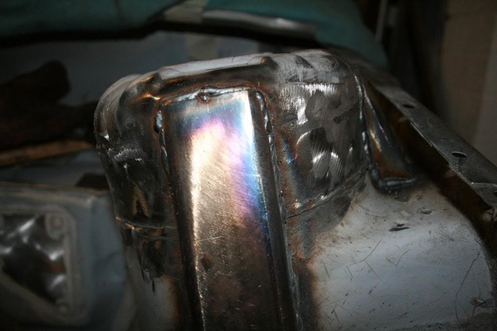

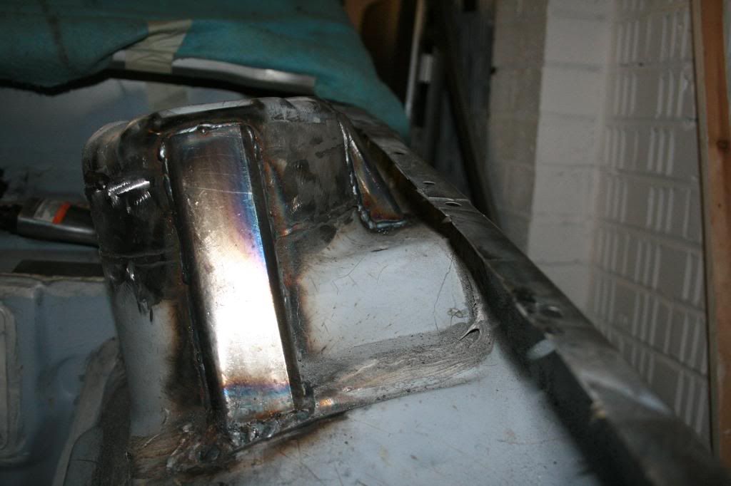

All welded in
http://i248.photobucket.com/albums/g...urrets1243.jpg
http://i248.photobucket.com/albums/g...urrets1244.jpg
http://i248.photobucket.com/albums/g...urrets1246.jpg
http://i248.photobucket.com/albums/g...urrets1245.jpg

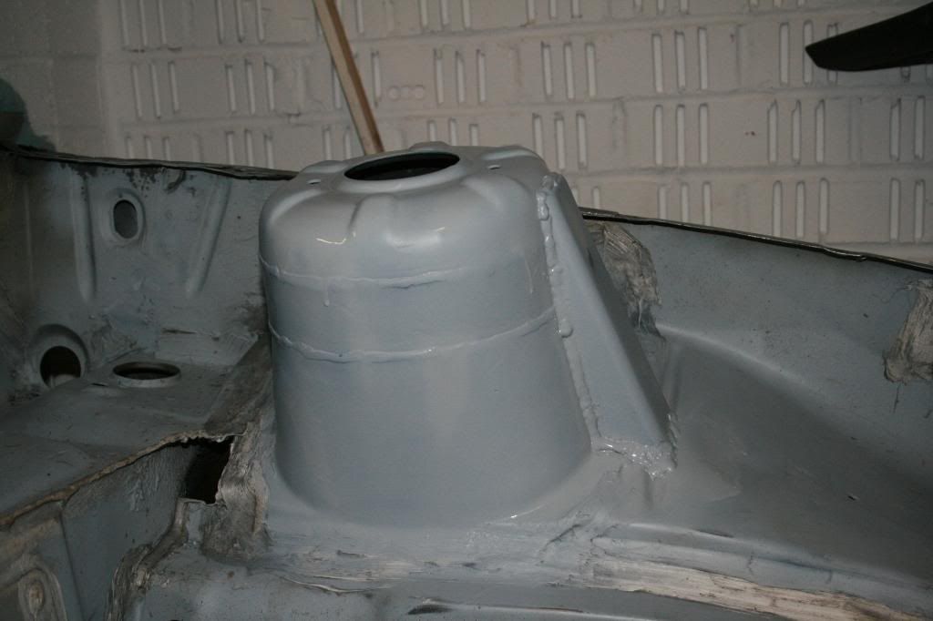

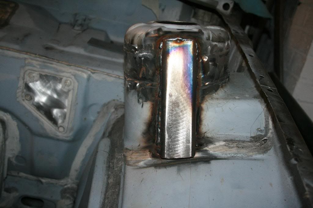

Gave it a good clean up and a prime for tonight
http://i248.photobucket.com/albums/g...urrets1247.jpg
http://i248.photobucket.com/albums/g...urrets1248.jpg
http://i248.photobucket.com/albums/g...urrets1249.jpg
http://i248.photobucket.com/albums/g...urrets1250.jpg
http://i248.photobucket.com/albums/g...urrets1251.jpg
I think its come out well?
The back edge (bulk head side) in the pic below will have some sort of tag in device for the front legs of the cage so i haven't touched that yet
http://i248.photobucket.com/albums/g...urrets1252.jpg
What y'all think worth the wait???
