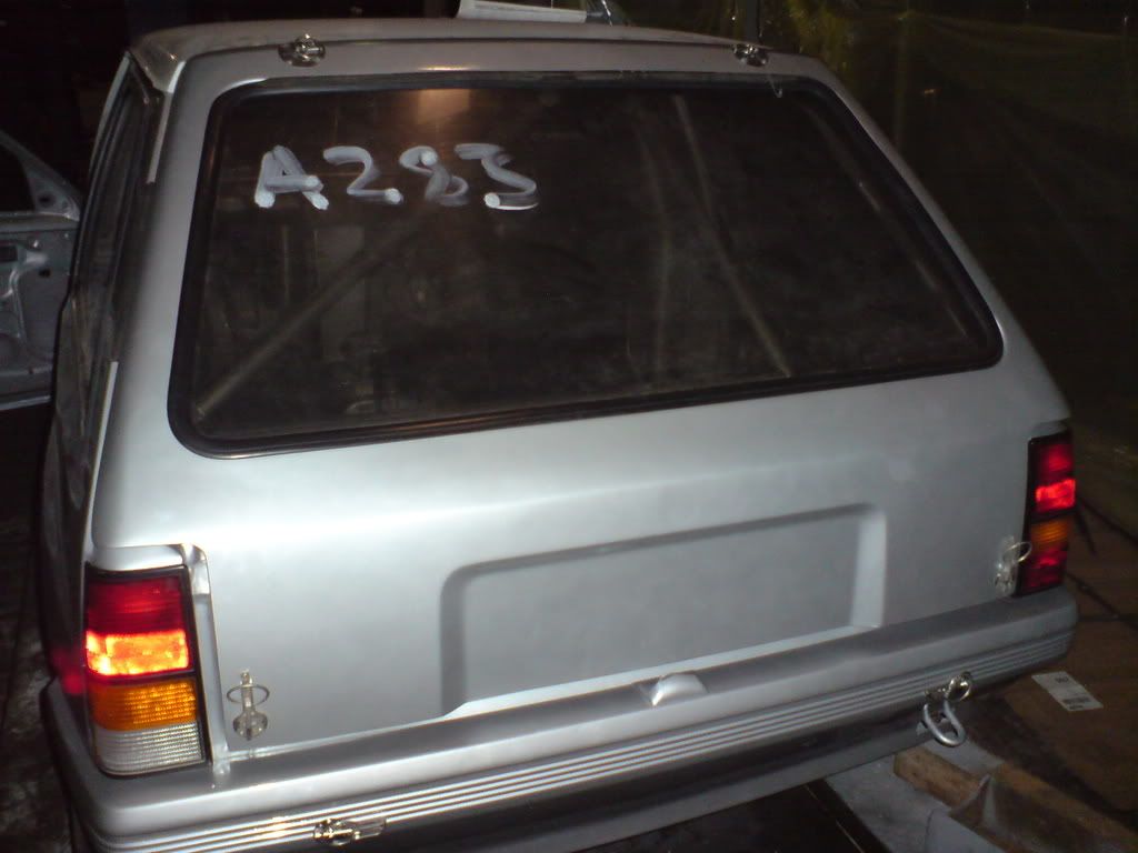

Tail gate offered up with top securing points in place
http://i205.photobucket.com/albums/b...va/nova005.jpg

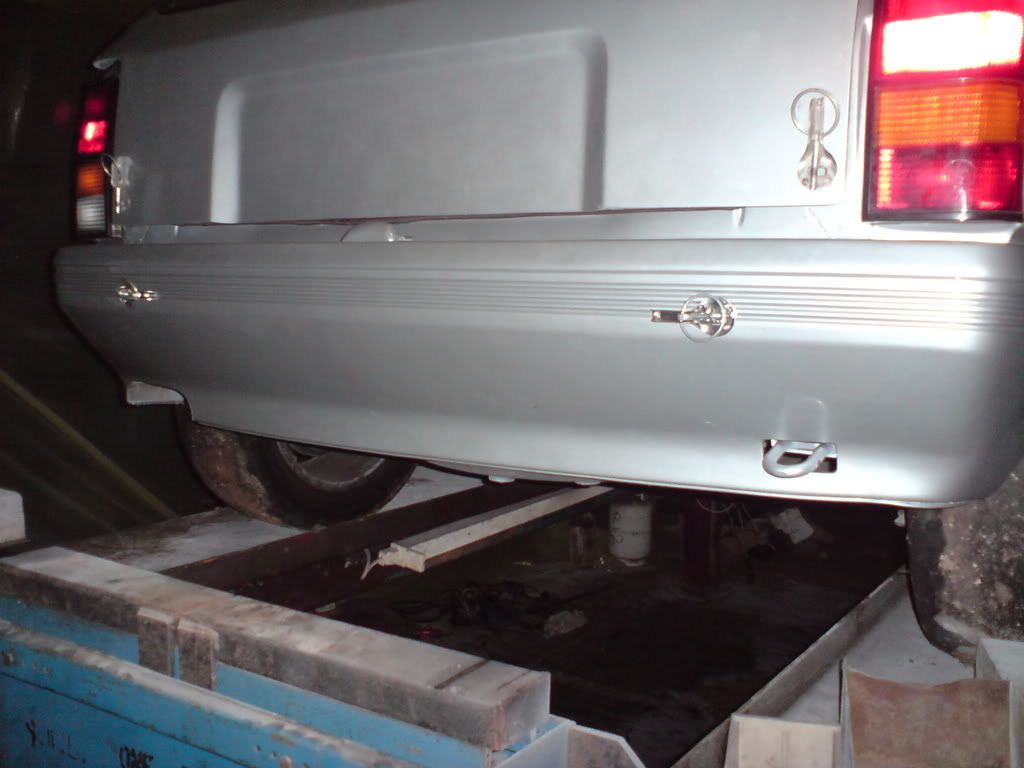

Rear bumper going on
http://i205.photobucket.com/albums/b...va/nova006.jpg

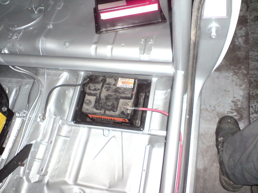

Battery going in
http://i205.photobucket.com/albums/b...va/nova004.jpg

and finally - I turn my back for 5 minutes and these 2 monkeys start slacking off:roll: lol
http://i205.photobucket.com/albums/b...va/nova001.jpg
Mark in No Legs shocker :eek: :eek: :eek:
so whose who in that photo? having not met either of you?
cracking progress - love 'the building up' of a car, tis awesome seeing the pics!
loving all your photos... where did you get your fibreglass tailgate from?

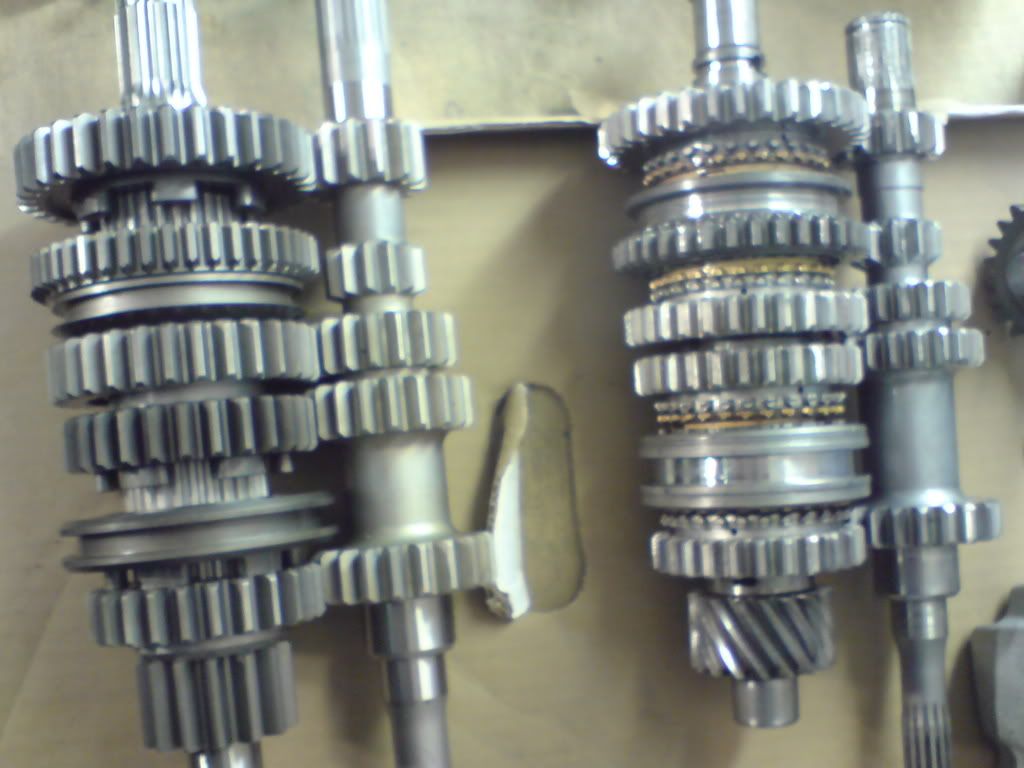

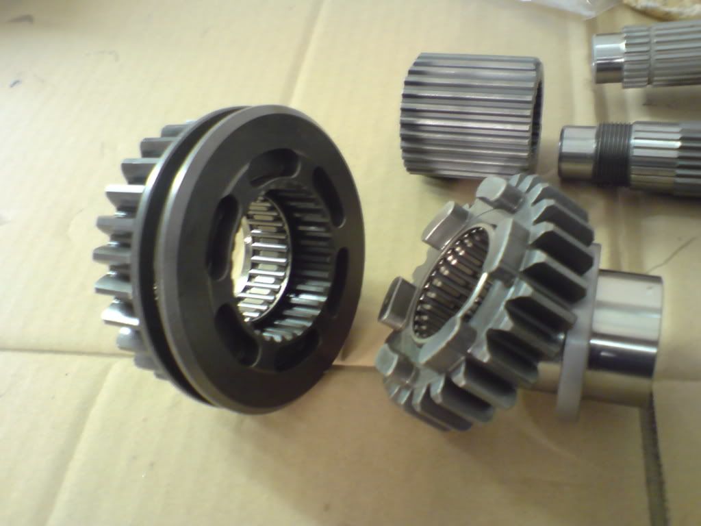

Been having a go sorting out my dog box
The cluster on the left is a quaife 5SCCR one - the other is a std cluster. Note the straight cut teeth on the SCCR but otherwise the clusters are identical using std synchro packs
http://i205.photobucket.com/albums/b...ostdone007.jpg
The dog cluster- note wide larger straight cut gears and no synchro packs when compared to the 5SCCR
http://i205.photobucket.com/albums/b...ostdone014.jpg

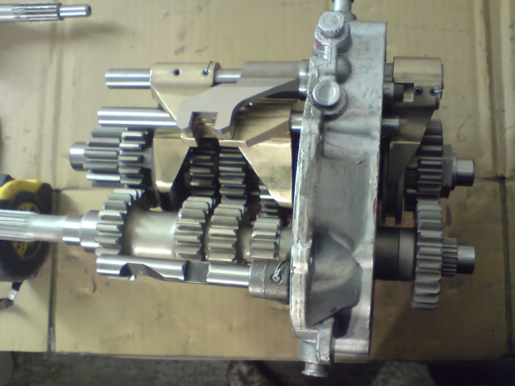

http://i205.photobucket.com/albums/b...ostdone010.jpg
A little more detail
Dog engagement arrangement
http://i205.photobucket.com/albums/b...ostdone009.jpg

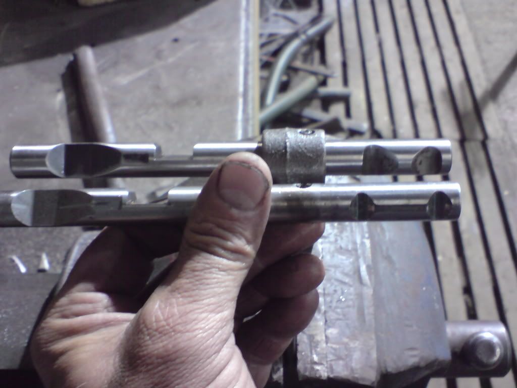

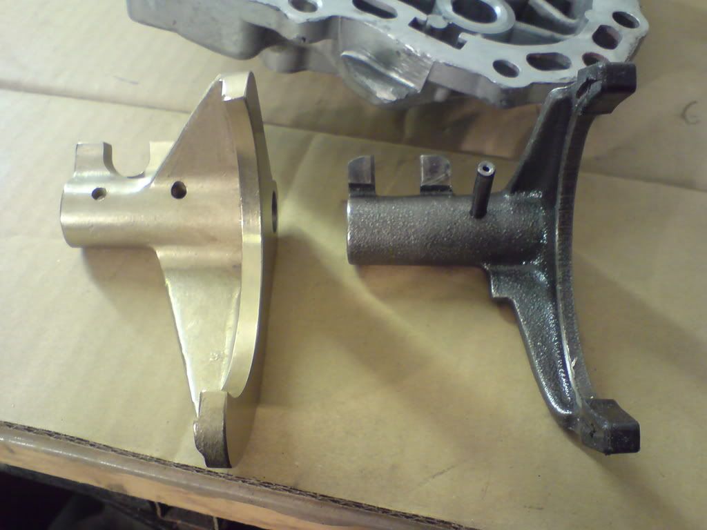

Uprated bronze selector forks compared to std ones
http://i205.photobucket.com/albums/b...ostdone011.jpg
Fitting it is a complete cluster strip down. The kits comes with a modified end plate which contains bearing for the shafts to locate into and new selector slide bars which have different holes drilled for the new selector forks and also the travel of the components is reduced by having the indents for the spring located locator nibs slightly closer together thus
http://i205.photobucket.com/albums/b...ostdone012.jpg
