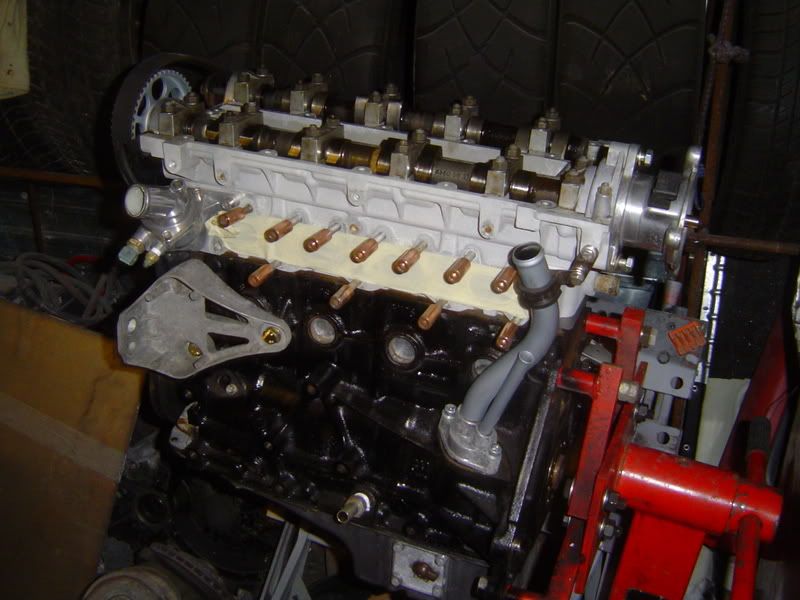

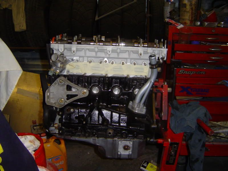

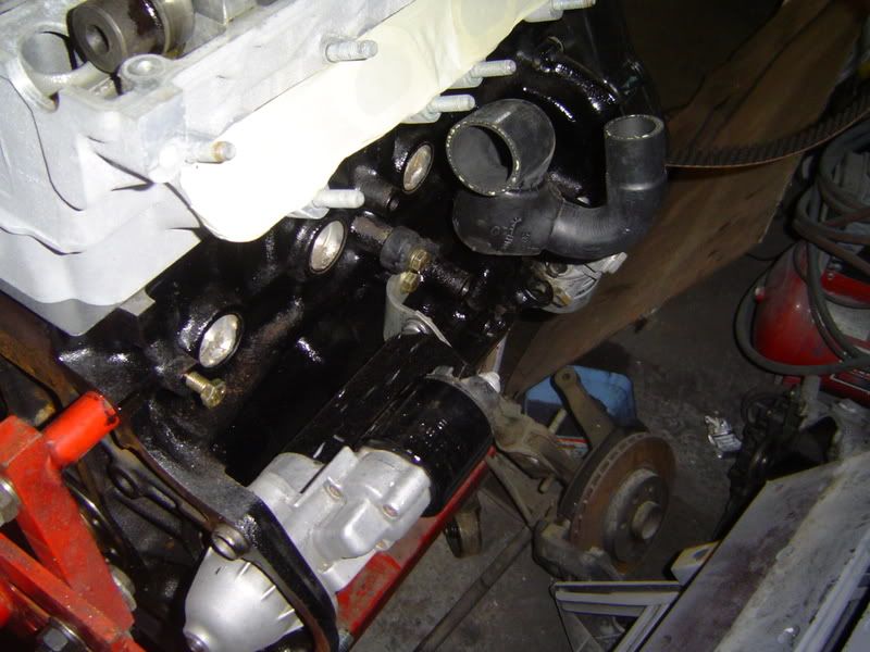

Got the head bolted back on and moulded sump gasket/wantage plate.
http://img.photobucket.com/albums/v1...5.jpg~original
Gave the starter a mint up, although its fairly new. New water hose.
http://img.photobucket.com/albums/v1...6.jpg~original

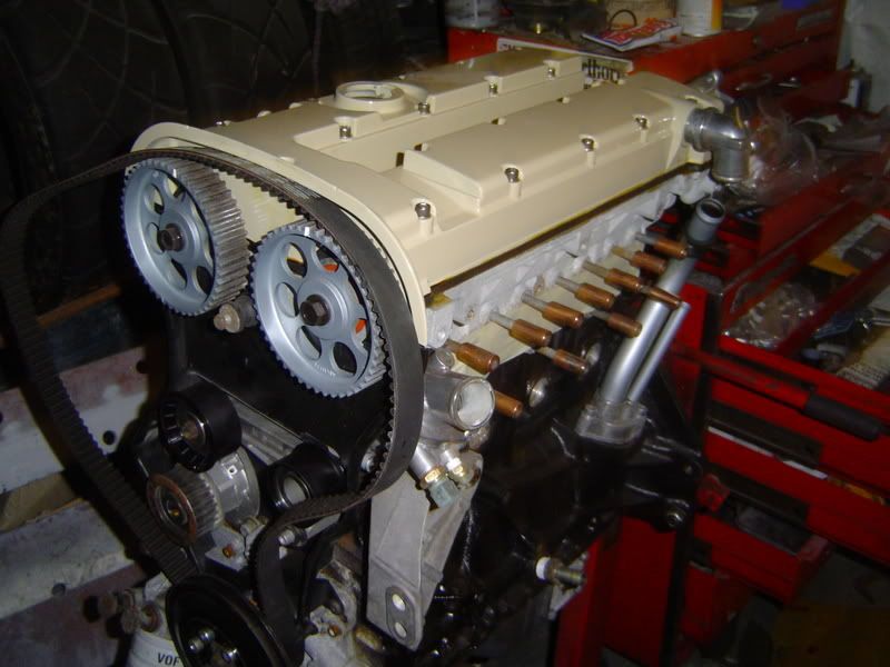

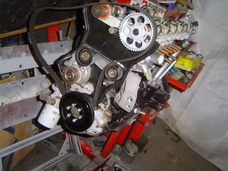

Cams in with an XE inlet fitted.
http://img.photobucket.com/albums/v1...7.jpg~original

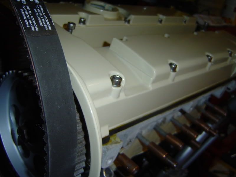

I’ve re-drilled the inlet pulley on the mill to retard it. New timing mark also scribed in
http://img.photobucket.com/albums/v1...8.jpg~original

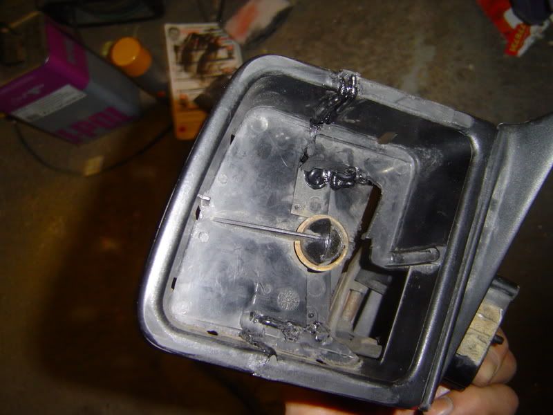

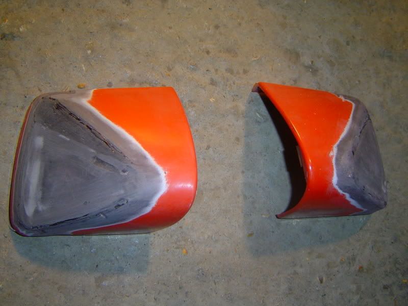

Have been thinking about what mirrors to fit. But thought I’d give the stubby mission a go and see how that went. Manage to get the use of a plastic welder which made the job a lot easier!
Covers cut and welded up
Then the main bodies... Shortened by 50mm
http://img.photobucket.com/albums/v1...9.jpg~original
Nearly ready for some paint. Just a bit more sanding required.

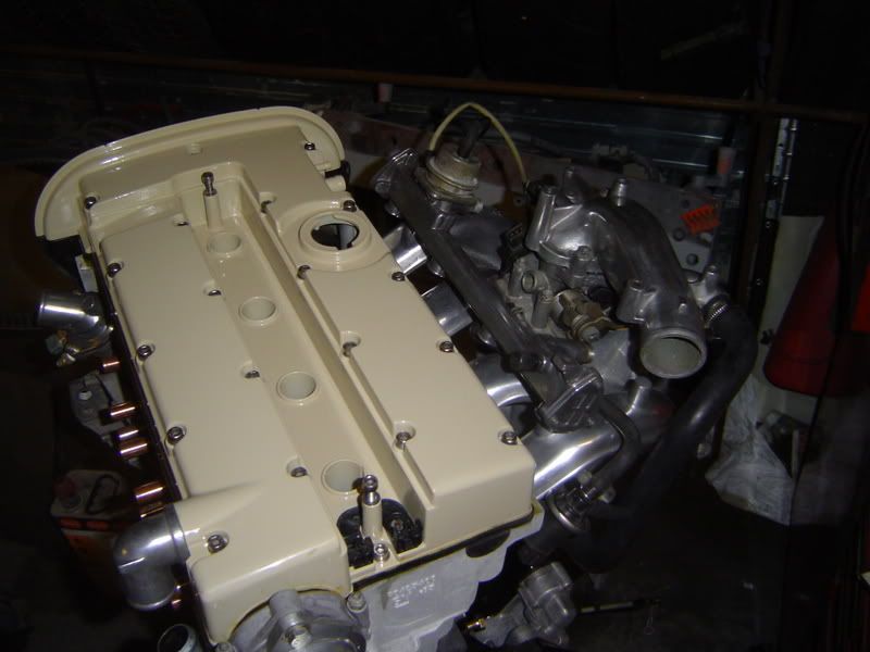

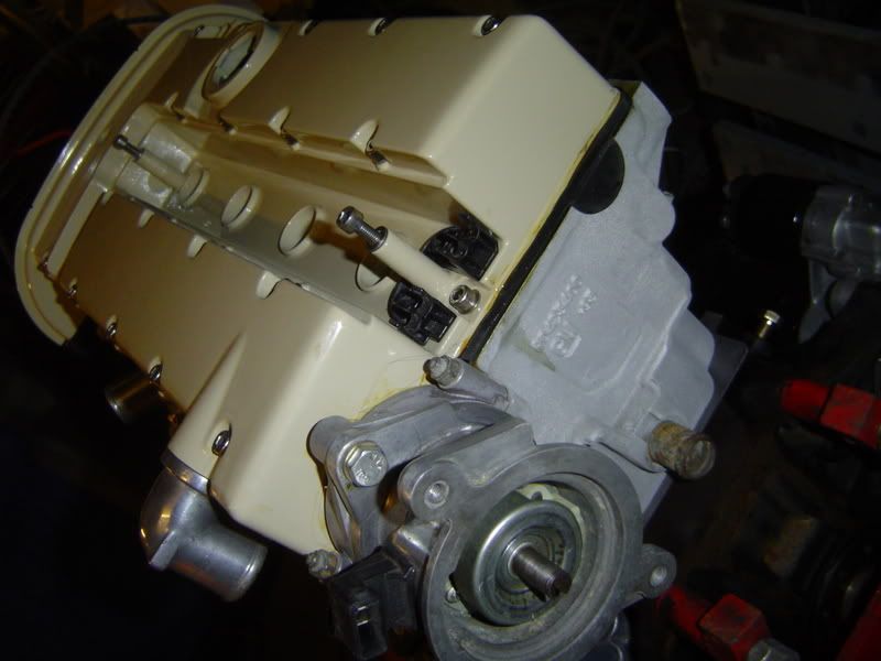

Back on to the engine, Cam cover on. Gave it a coat of weld seal just to make sure there isn?t any leaks! A few bits to clean off?

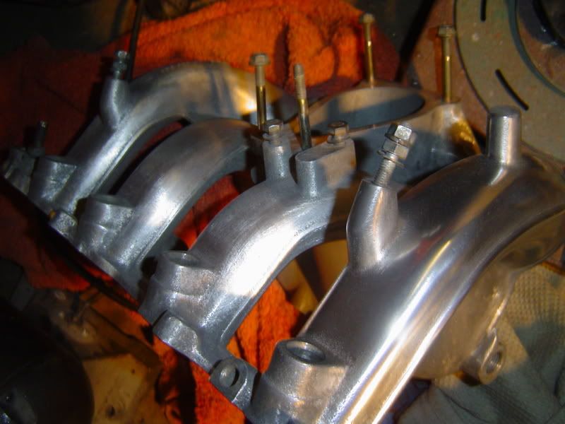

Inlet mid polish. Didn?t go too mad on, just a spruce up.
http://img.photobucket.com/albums/v1...2.jpg~original
Inlet all fitted up
http://img.photobucket.com/albums/v1...3.jpg~original
