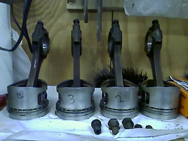

Done a bit to the engine...
After stripping what turns out to be a VERY mint engine I thought I would give it a freshen up. Got a feeling it might have been a recon engine.
Acid cleaned the cylinder head
http://img.photobucket.com/albums/v3.../IMAGE_097.jpg
Before regrinding the valves in and rebuilding it with new hydraulic lifters, valve stem seals & Kent AST2 camshaft kit
http://img.photobucket.com/albums/v3.../IMAGE_101.jpg
Painted the block gloss black & honed the bores
http://img.photobucket.com/albums/v3.../IMAGE_098.jpg
And fitted new piston rings ready for the rebuild
http://img.photobucket.com/albums/v3.../IMAGE_100.jpg

Looking good Rich. Are you going to leave the cylinder head / cam housing in bear alluminium? I tried a Alluminium VHT paint on mine, it looks great on application, however I can't see it being that durable, that matt finish doesn't like oil/grease/dirt etc. I may need to reconsider the finish.
Are you renewing the big-end, main shells too?
Dec
Yeah, I am leaving it bare aluminium & hoping it does not corrode in a hurry.
This engine will only be in for a year or so until I build a better tuned engine with the spare I have.
I am not too keen on painted engines apart from block engine enamel as if it start to flake or peel off it looks horrendous.
I have new genuine main shells & big end bearings which will be going on.
The engine appears to be a recon/replacement unit as it was mint when it was stripped. All the items we have removed to replace look new and the water galleries are clean & rust free.
I just thought it may as well have a freshen up while it was stripped.
I have everything new to go on once built aswell inc, dizzy, breather, water & oil pumps, studs & nuts, etc. I even found a brand new Irmscher manifold I forgot I had in the loft:roll:
