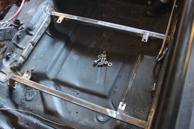

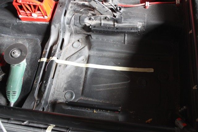

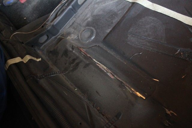

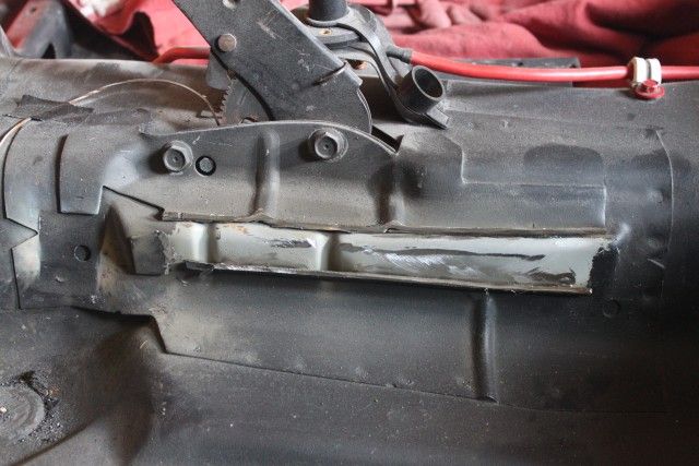

Next to do:
lower the drivers seat
First thing, remove the seat
http://i260.photobucket.com/albums/i...pse364f67a.jpg

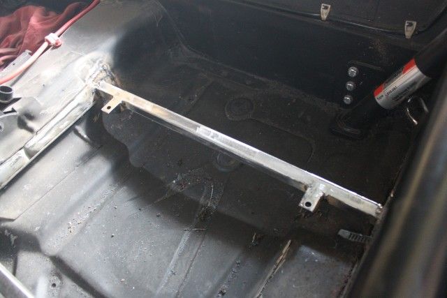

original seat mountings removed with grinder. little more weight saving lol
http://i260.photobucket.com/albums/i...psfeb3ce03.jpg
http://i260.photobucket.com/albums/i...psa6a1c6bf.jpg

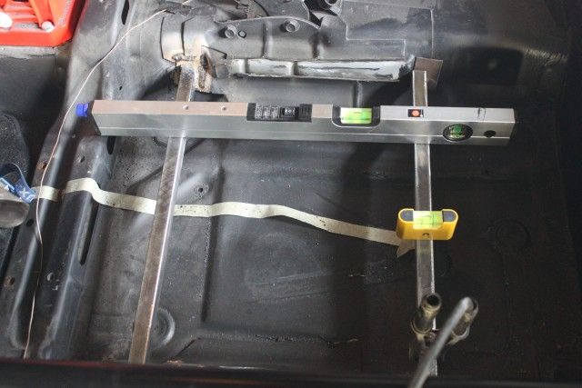

To get the seat fixed i used two steel square tubes. At both ends i welded plates which then can be welded to the chassis.
To adjust the whole seat fixing assembly i used two bubble levels
http://i260.photobucket.com/albums/i...ps524a3b17.jpg
Welded and added fixing points
http://i260.photobucket.com/albums/i...ps3c80e9d3.jpg
the seat now can be fixed 2-3cm more to the middle of the car.

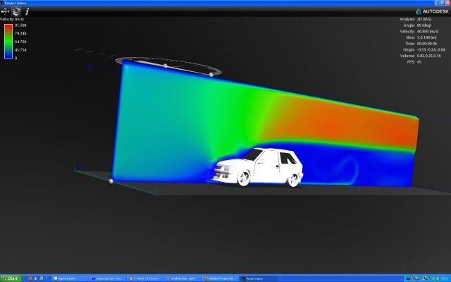

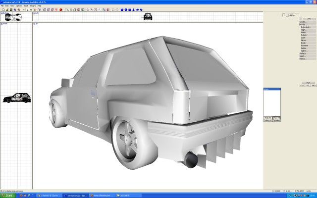

I currently also enjoy the benefits of modern technology in order to optimize my vehicle Aerodynamicly :)
A 3D model of the Corsa which i made some years ago now also shows a practical use.
Thus, for example, different rear diffuser designs can be tested easily in a virtual wind tunnel.
http://i260.photobucket.com/albums/i...psf8a6a1d4.jpg
The program used for this purpose is called "Project Falcon" and is a freely available tool from Autodesk. This can also import self created 3D models and test them at different speeds and wind directions, so i dont have to ring up our local Formula 1 team to use their wind tunnel lol
Here nice to see how the diffuser allows the air to flow at the back of the car.

Maybe there's a new developed diffuser in the near future!

The Nova is not the best choice for aerodynamic features, but maybe you can using low-speed profiles for better grip in corners. Check an older and/or trainer sailplane wing profile!
yes i know its not the best... the virtual wind tunnel proves that lol so i'm going to try to improve the car as much as possible with some aerodynamic tweaks. Would be nice to gain a little more grip by using a flat floor and a well designed diffuser. At least it will be better than a rear bumper that acts like a parachute ;)

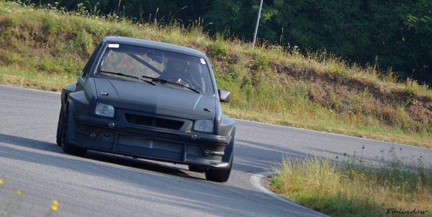

Nice picture of last trackday provided by facebook :d
http://i260.photobucket.com/albums/i...ps7c77c8eb.jpg
