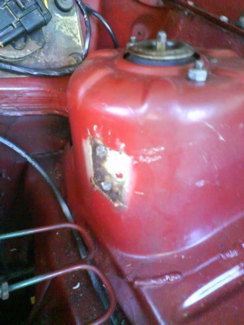

Went here, glad I removed it as it was rusting behind the bracket:
http://i71.photobucket.com/albums/i1...a/DSC01176.jpg
Grindered, wire wheeled back shiny, etch primer, high build primer and a few coats of colour:
http://i71.photobucket.com/albums/i1...a/DSC01179.jpg

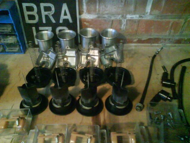

While the carbs were off I thought it would be silly not to give them a clean. I think the jets need to go up a size too but random photos of bits first:
http://i71.photobucket.com/albums/i1...a/DSC01182.jpg
http://i71.photobucket.com/albums/i1...a/DSC01181.jpg

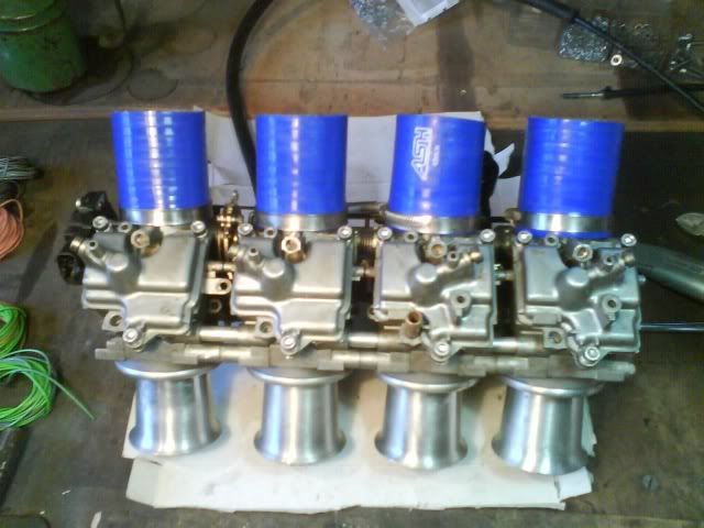

After having to wait for the postie the carbs are back together - new fuel resistant hose, carb bowl, trumpet and cap bolts all replaced with stainless cap heads and a good clean:
http://i71.photobucket.com/albums/i1...a/DSC01186.jpg
http://i71.photobucket.com/albums/i1...a/DSC01188.jpg

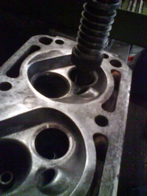

Bit of progress on the head rebuild, had new guides so had to ream them:
http://i71.photobucket.com/albums/i1...a/DSC01233.jpg
http://i71.photobucket.com/albums/i1...a/DSC01234.jpg
And cut the seats (once again thanks to tom for the tooling and tutorials!):

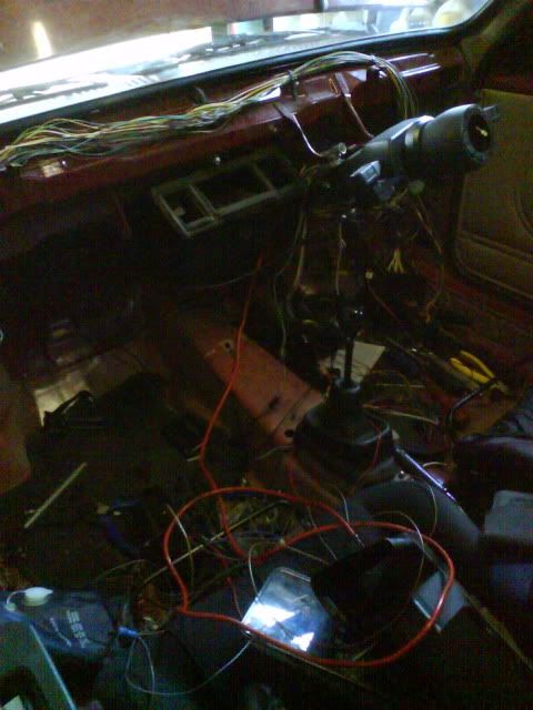

Cheers dude, although I have to stop myself now I think - what started as simply rewiring my megajolt has turned into a full, dash out, strip down and rewire/hide wiring mission.....Quote:
Originally Posted by Connor

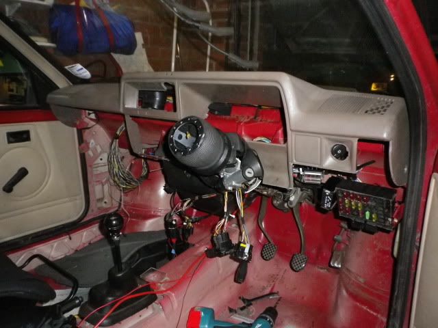

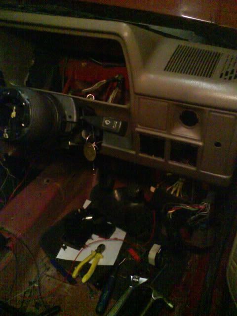

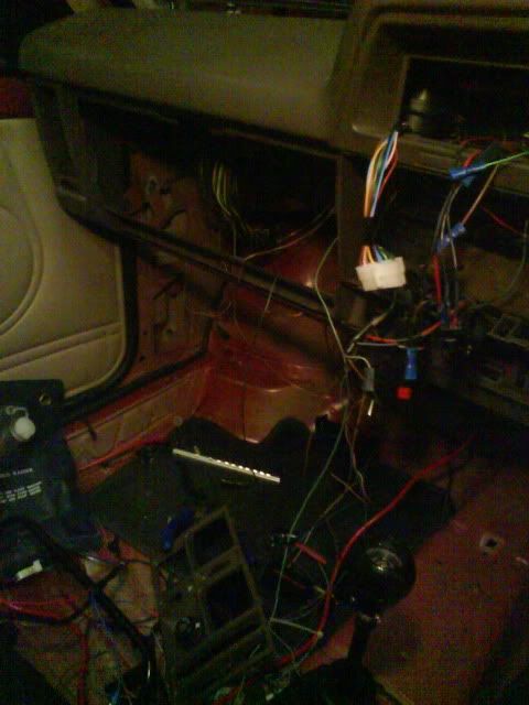

Really crap photos but some of the state of the front end and inside (dash is out but in place):
http://i71.photobucket.com/albums/i1...a/DSC01247.jpg
http://i71.photobucket.com/albums/i1...a/DSC01246.jpg
http://i71.photobucket.com/albums/i1...a/DSC01244.jpg
http://i71.photobucket.com/albums/i1...a/DSC01243.jpg
Nice work, neat wiring rocks! Get a better camera though :(

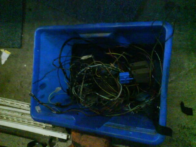

And my bin box so far:
http://i71.photobucket.com/albums/i1...a/DSC01252.jpg

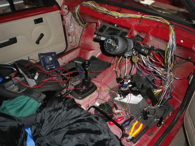

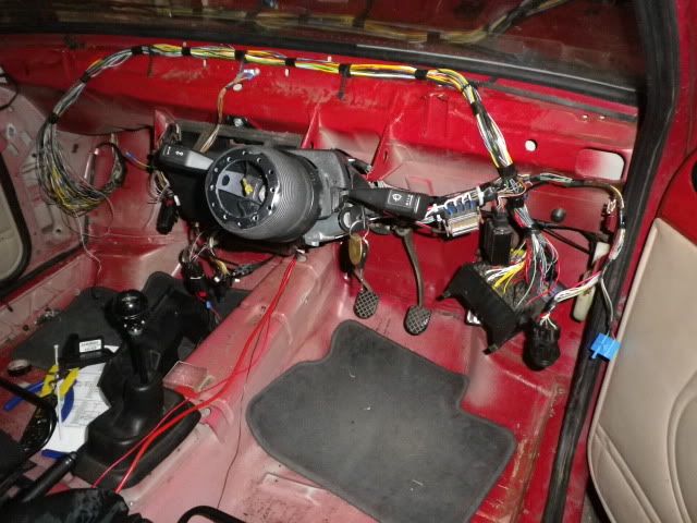

Spent an hour on the wiring last night, starting to put things back - before:
http://i71.photobucket.com/albums/i1...a/IMGP0013.jpg
After:
http://i71.photobucket.com/albums/i1...a/IMGP0030.jpg
For anyone that is interested I've removed the radio, surplus (ie options I didn't have) and now not needed (rear wash/wipe, switch lighting etc) wiring.
Also put in my fusebox for the fuel pump and mj, earths for mj, tps and edis. Finally ran my ignition battery cable, fuel pump live and washer pump down the centre of the car - need to add to this the extended cable for the alternator/starter.

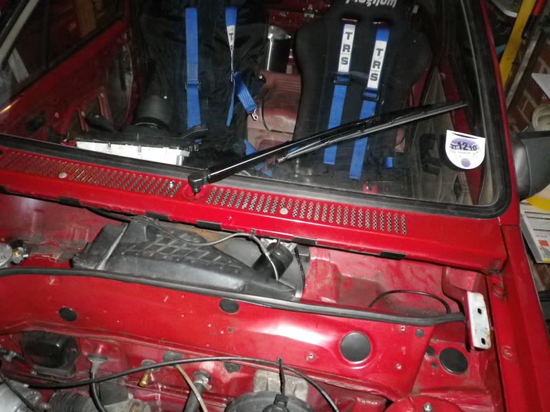

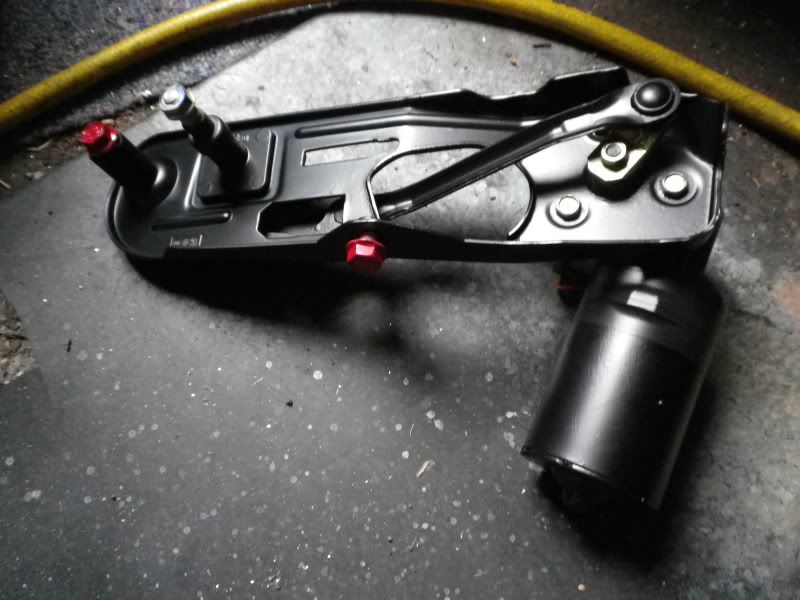

After a mooch round looms (local scrappy) with lionel on the wkend I picked up a zx wiper mechanism to fit - mistakenly thinking that it would save some weight (it doesn't btw, so don't bother if thats your thing) - but essentially all it does is tidy up the bay a bit more and lose the motor from the firewall.
Anyway, cleaned up mechanism:
http://i71.photobucket.com/albums/i1...a/IMGP0067.jpg
Mounted:
http://i71.photobucket.com/albums/i1...a/IMGP0073.jpg
I found that just the one bolt through the scuttle gutter let the wiper flex a lot, so I also put one through the top of the scuttle with a spacer. Both the tabs on the wiper mech needed bending to allow the spindle to sit at a decent angle to the screen.
I tested it with the nova wiper arm but will be using the zx one as it sweeps better, just need to trim the length down a bit and rebend the tab on the end.

Now with video! The sweep isnt as good as the original but its good enough if biased to the drivers side a bit. I just need to shorten the wiper arm:
http://i71.photobucket.com/albums/i1...h_IMGP0078.jpg

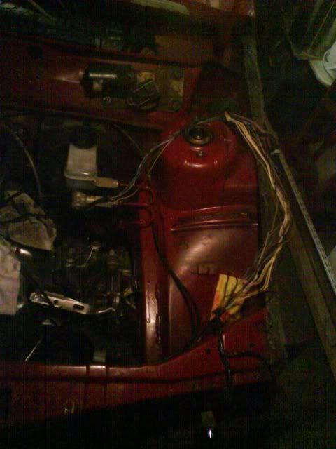

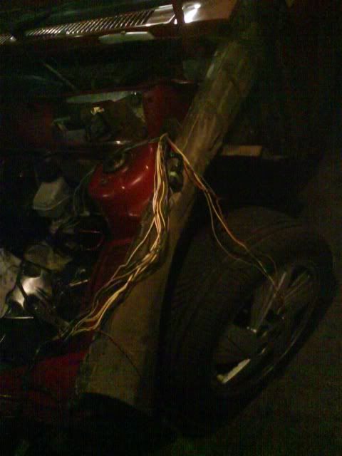

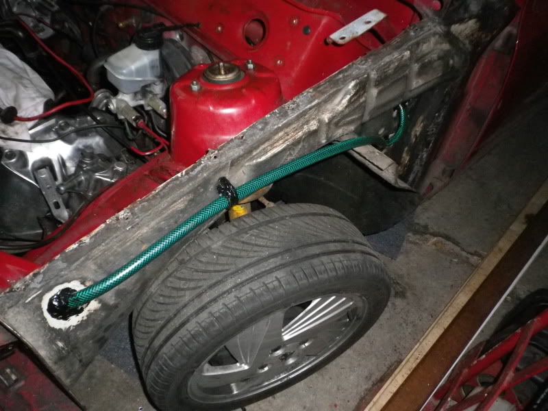

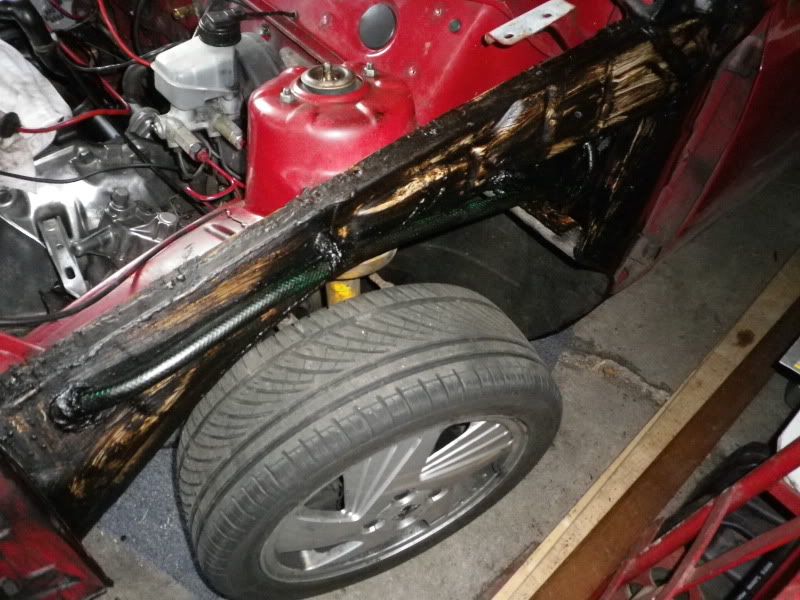

Also finished off putting the front end wiring out through the wing - it looks a bit pikey but i'm fairly sure the wiring wont get damp!
http://i71.photobucket.com/albums/i1...a/IMGP0070.jpg

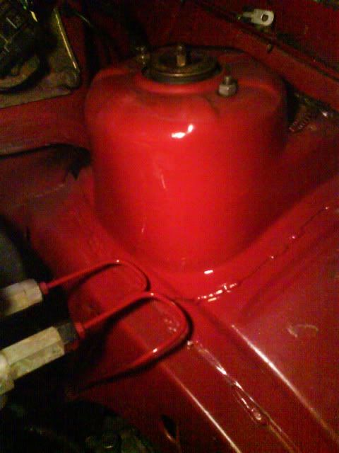

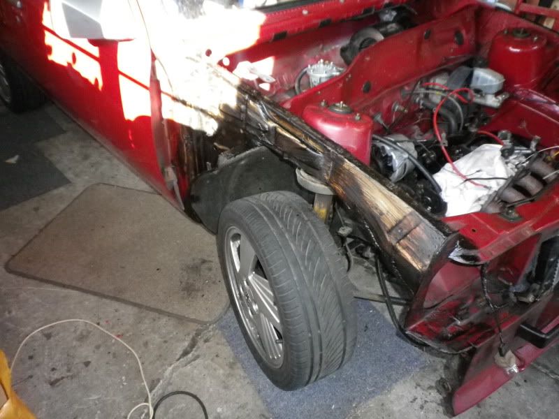

Tested my front end wiring and it all works so it can go back together - I thought being as it's in bits a rub down and frsh coat of waxoyl wont hurt as it seems to have done a pretty good job over the last 3yrs:
http://i71.photobucket.com/albums/i1...a/IMGP0089.jpg
http://i71.photobucket.com/albums/i1...a/IMGP0088.jpg
