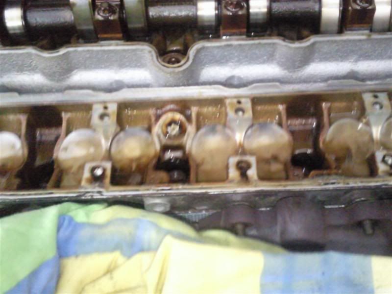

Quick update on the Astra.
Apologies for the toss pics, cam phone....
http://img.photobucket.com/albums/v8...o191Medium.jpg
Not a sight i was hoping to see after owning it for 3days lol
http://img.photobucket.com/albums/v8...o194Medium.jpg
Nice water, i mean oil

Did you know it had gone when you bought it? :(
It hadnt gone mate tbh. My dad followed me home when i bought it, no smoke etc at all. Coolant level was fine.... Three days later you cant see the back of the car due to the smoke from the exhaust and its done 2L of coolant in 7miles.....
Previous owner said it had sat for a while, so i guess it just let go when i gave it a bit down the A50! lol lol
Heavy right foot lol
I think thats what did it tbh.
Sitting a while in the old owners hand.
I buy it, see what it goes like... Next day headgasket says NO lol lol
Hopefully it will be sorted and running again tomorrow :cool:
at least you know its done now and have inspected the piston/bore first hand
Yup.
It should be spot on now.
As the cambelt kit/waterpump is brand new too(well a few month old)
You can tell its done fook all miles recently by the condition of the waterpump/cambelt pullys etc

You dont mess about do you Adam, good going and i hope thats the end of the engine bother for you, lucky you can get your sleeves rolled up and do the gasket yourself rather than have to get some garage to do it for you.
Had to laugh about saying you couldnt see the back of the car do to the crap from the exhaust i bet it seemed normal at first till you realised 'hang on i dont drive a weasel anymore' lol

Its all done now, all back together, sat nervously in the drivers seat with the key in my hand (did i tighten that cambelt tensioner? lol lol)
Turned key, fired up first go, fcuking get in :cool:
No tapping, no smoke, no leaks. Good job i changed the oil/filter because when i drained it the oil was white :eek::eek:
Just done 35mile and coolant level has not moved in the tank. The rough idle has also gone, runs smooth as fook again and it seems to pull better too (not suprising seeing as now all 4cyls are burning petrol/air and not petrol/air/water lol.

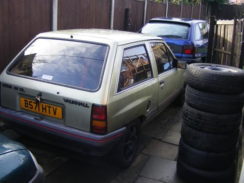

Just to prove ive still got the nova, i touched it today lol
First job was drying the car out, the inside was pretty much soaked in damp.
Anyway,
Bought a set of rear polycarbs off Lionel, so started fitting them today with the weather being scorching at 5.5c.
Yep the novas still there
http://img.photobucket.com/albums/v8...Picture001.jpg

I then set about fitting the sides but when attempting to remove the window, the force needed was starting to bend the window surrounds(theyve been in for 25year so its not suprising they are in there well....)
Tempted to leave the sides tbh, dont want to risk knackering the chrome window surrounds lol

Also got the battery and ecu refitted and turned the key, fired up first go :d
Was a bit tappy at first, but it aint been turned over for about 2 and a half months, so that didnt suprise me....
Will probably have a better go at the rear sides sometime this week, although the weight difference between glass and polycarb wasnt huge tbh.....
Looking forward to Oulton Park now!! Just need two new rear tyres, and i could do with some shorter rear coilover springs, the rear sits was too high for my liking.
That is all for now.
Get the sides in you slacker!
