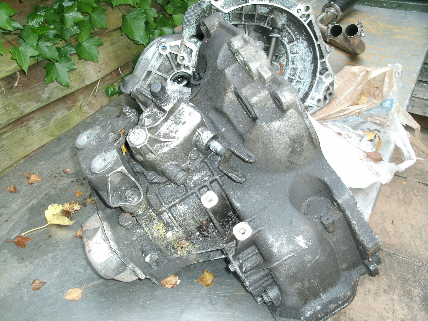

I have been playing about with the gearbox today.
I've decided to convert it to use the Vectra hydraulic clutch release bearing.
I know Lee303 did this on his Nova........anyone got a list of the parts I need to fit onto an F15 garbox please?
Is it just a question of getting an F18 with hydraulic clutch and robbing all the bits from that? If so, anyone got one of those they want to sell?
Nice to see you back on here Colin, 2014 will be your year ;)
If you can get under a Vectra down the breakers you can liberate the plumbing easily and the ally bleed piece that goes on the top of the gearbox casing, then the part number for a new slave cylinder is CSC007 for QH equiv: MSC007
You may want to look into whatever self adjusting mechanism this system has if it's on the gearbox end... each of the X18XE1's I've taken apart so far (both from Vectras which would obviously have the setup you mention) have had serious thrust wear issues. One to the point of munching about 1.5mm out the crank which isn't easy to do with a soft metal bearing! The only thing I can put this down to, since there are no other forces acting on the crank assembly and the clutch is obviously OE spec, is the hydraulic cylinder stroking beyond what's needed to disengage the clutch and forcing the crankshaft assembly against the thrust bearings. Although I would have thought this would make a godawful noise as clutch spring hits clutch plate, so it may well be an oiling issue to the thrust bearings themselves, but thought I'd mention it so you can make sure all is well with your setup.
I'm not sure if this is a common problem as it's generally not picked up on in your average family runaround, the engine would just get 'noisy' or lose comp due to thrust wear in the bores and it's sent to the scrapyard with no further investigation. However I have a 2 out of 2 stripping them down so I figure it can't just be coincidence.
hi colin, yeah its that simple, but you need to make sure the slave has the correct sized seal for the input shaft, as some of them are larger diameter, dont have the part numbers sorry, can find out though
the other option is to fit the external actuation version as fitted to some corsas and chevrolettes as this means you dont have to split the box if you have issues with the hydraulic side as it just actuates the normal release bearing with an external slave cylinder, and also you can get round nose release bearings more readily if you're running a 7.25'' clutch

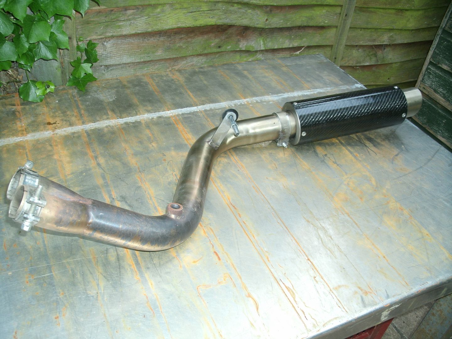

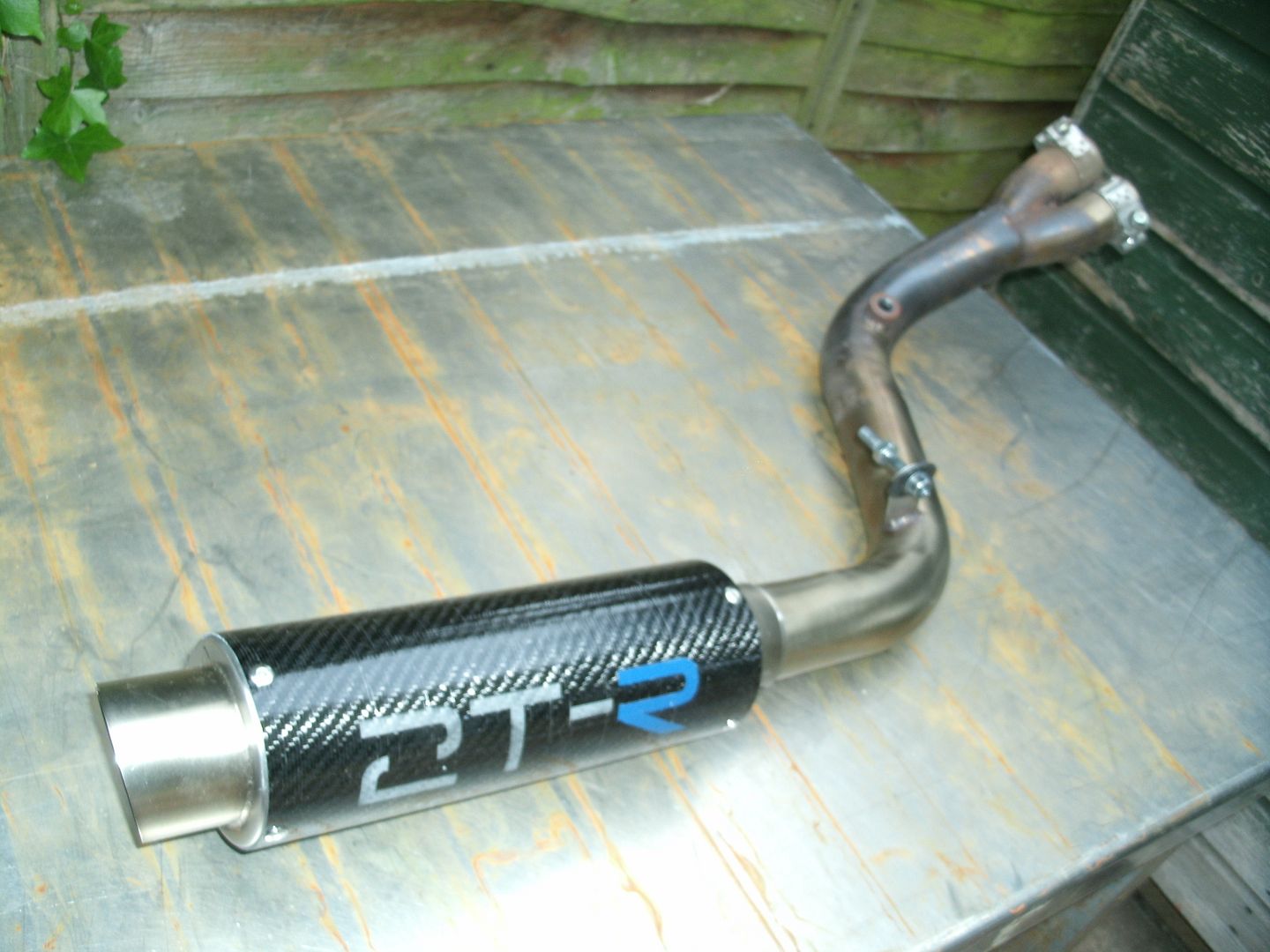

It's always been my intention to reduce weight with the use of a lighter exhaust system. At one stage this was going to be with the use of aluminium tube, but the company who were going to make that for me went out of business. So I may try and utilise this titanium and carbon fibre motorcycle system, which is very lightweight;
http://i285.photobucket.com/albums/l...psf6a4d950.jpg
http://i285.photobucket.com/albums/l...ps2be5d714.jpg
Photobucket seems to be largely impossible to use now, so I will have to find a new photo host.

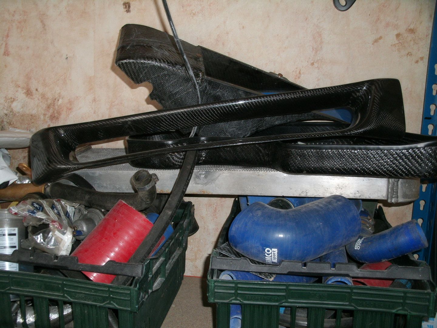

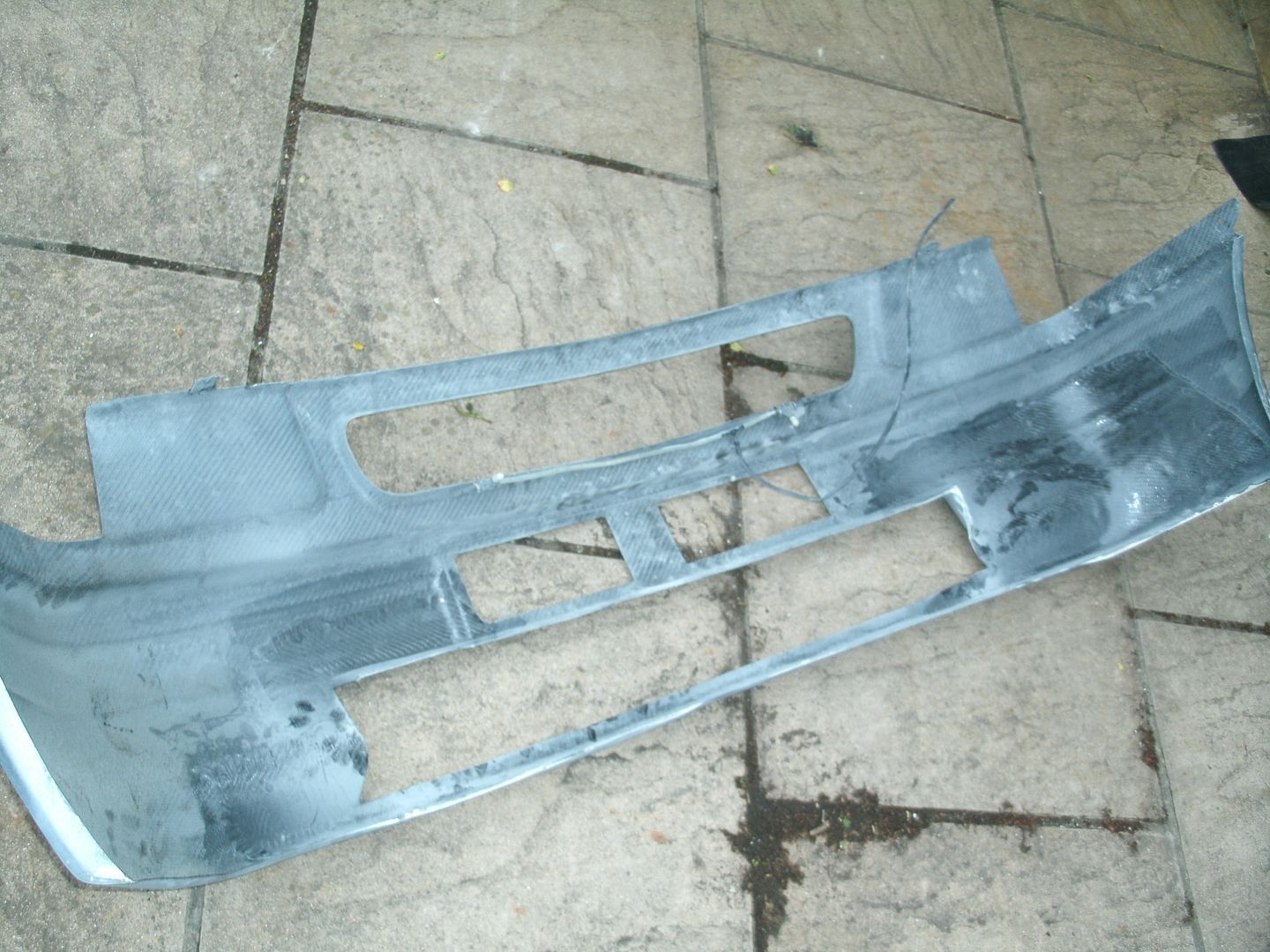

Repairs to the carbon fibre bumper and front wings which were heavily damaged in my accident

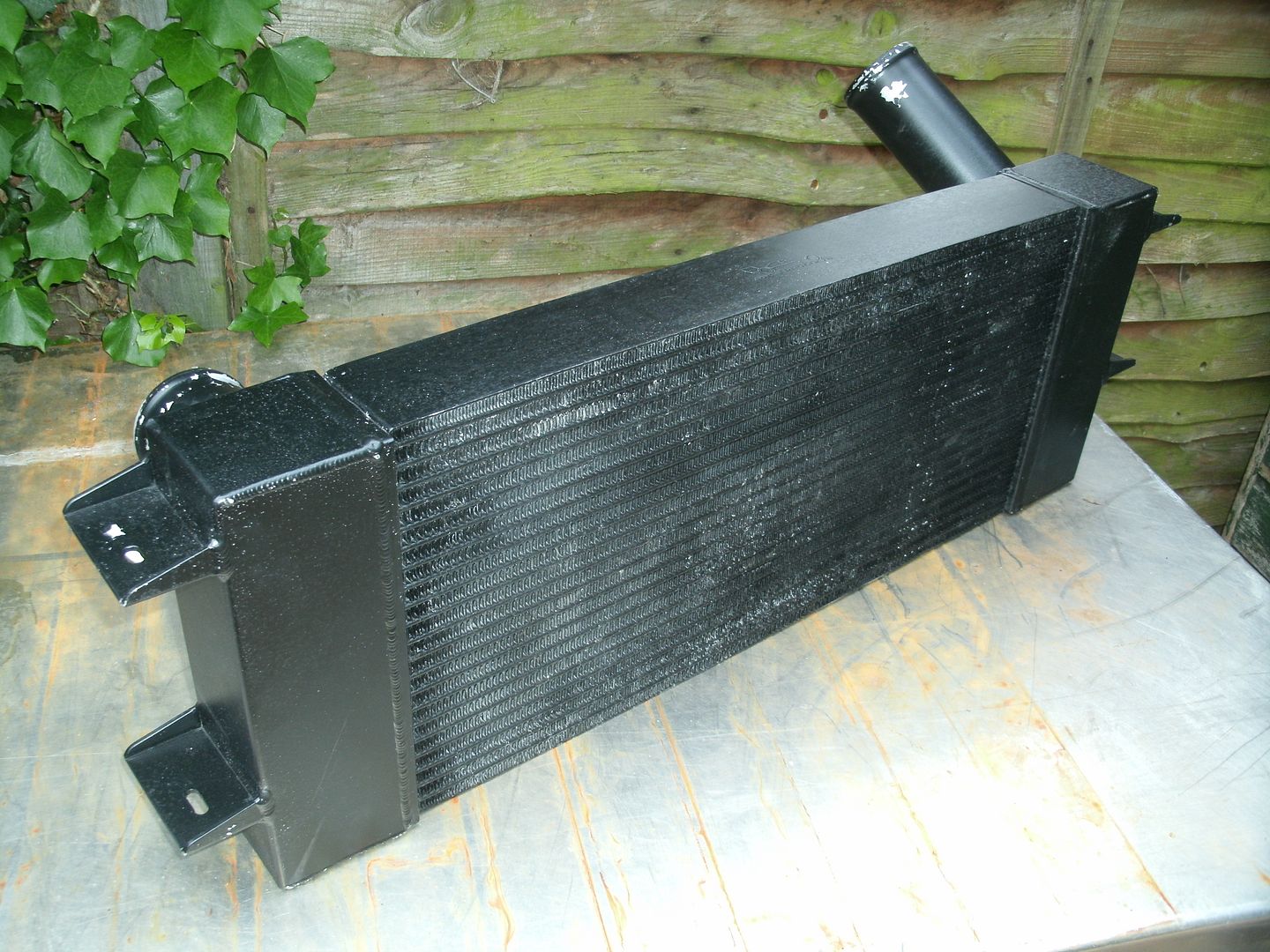

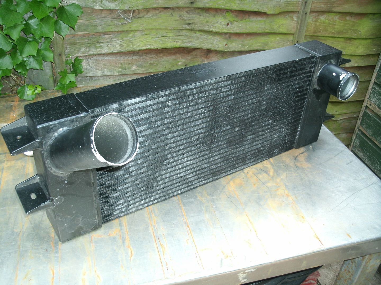

New Pace Products alloy intercooler

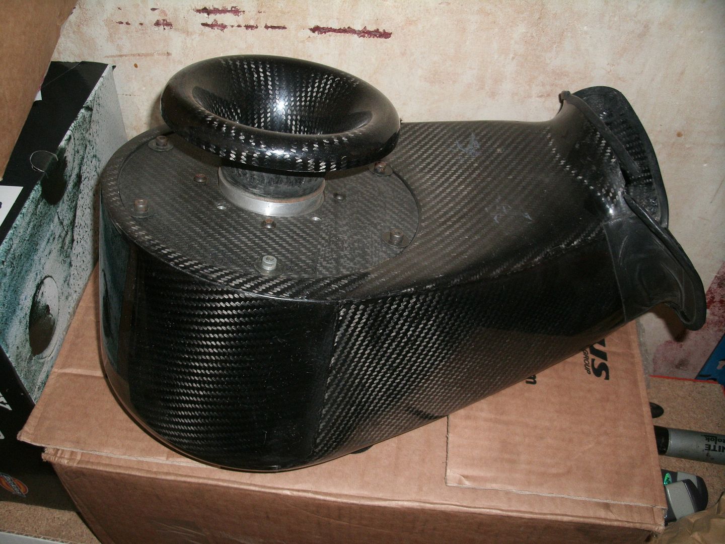

Carbon fibre air filter housing
Development of a carbon fibre front splitter

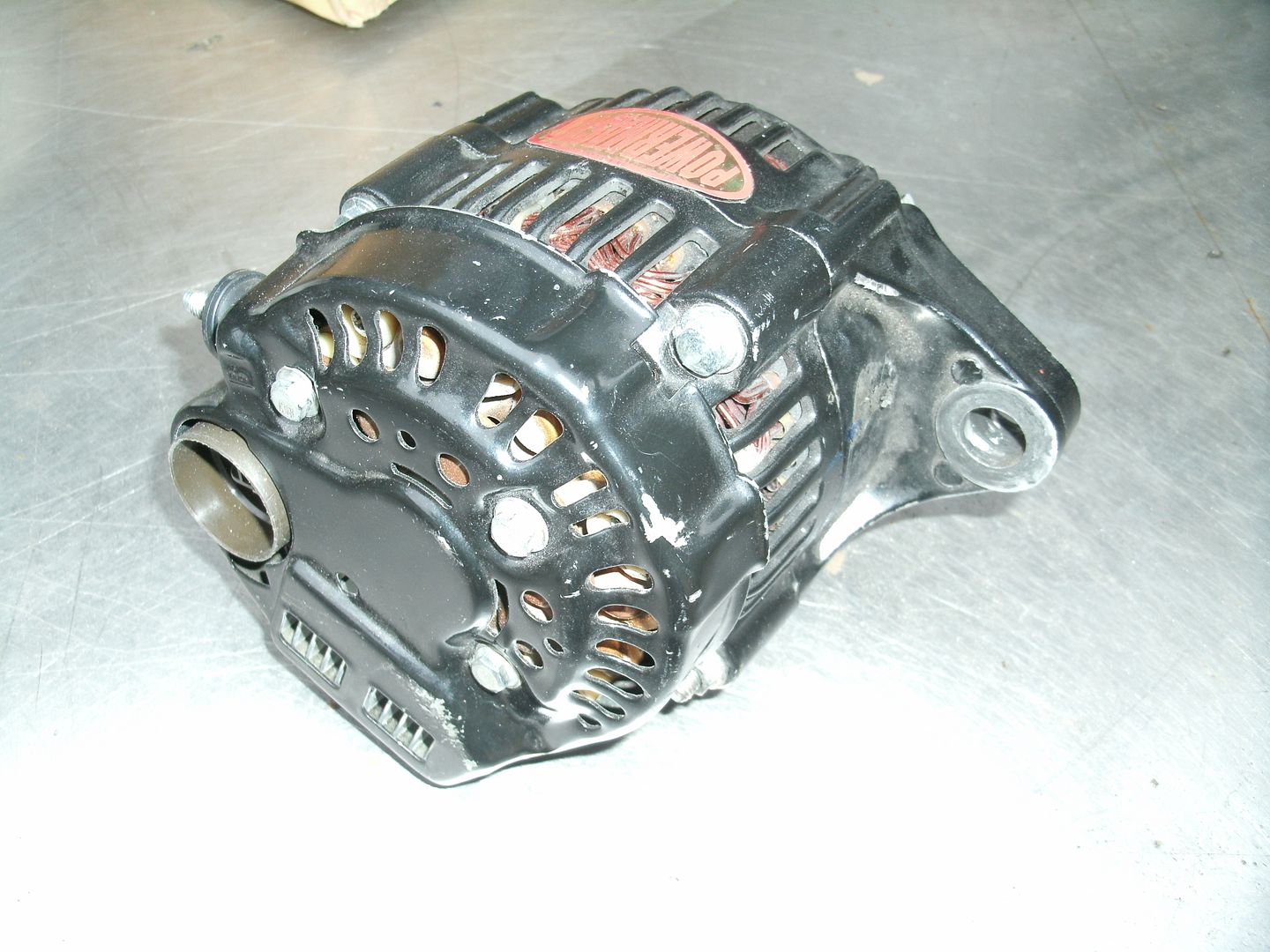

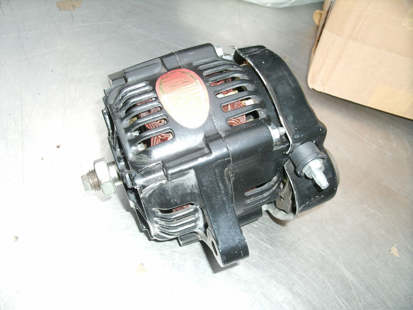

New lightweight alternator

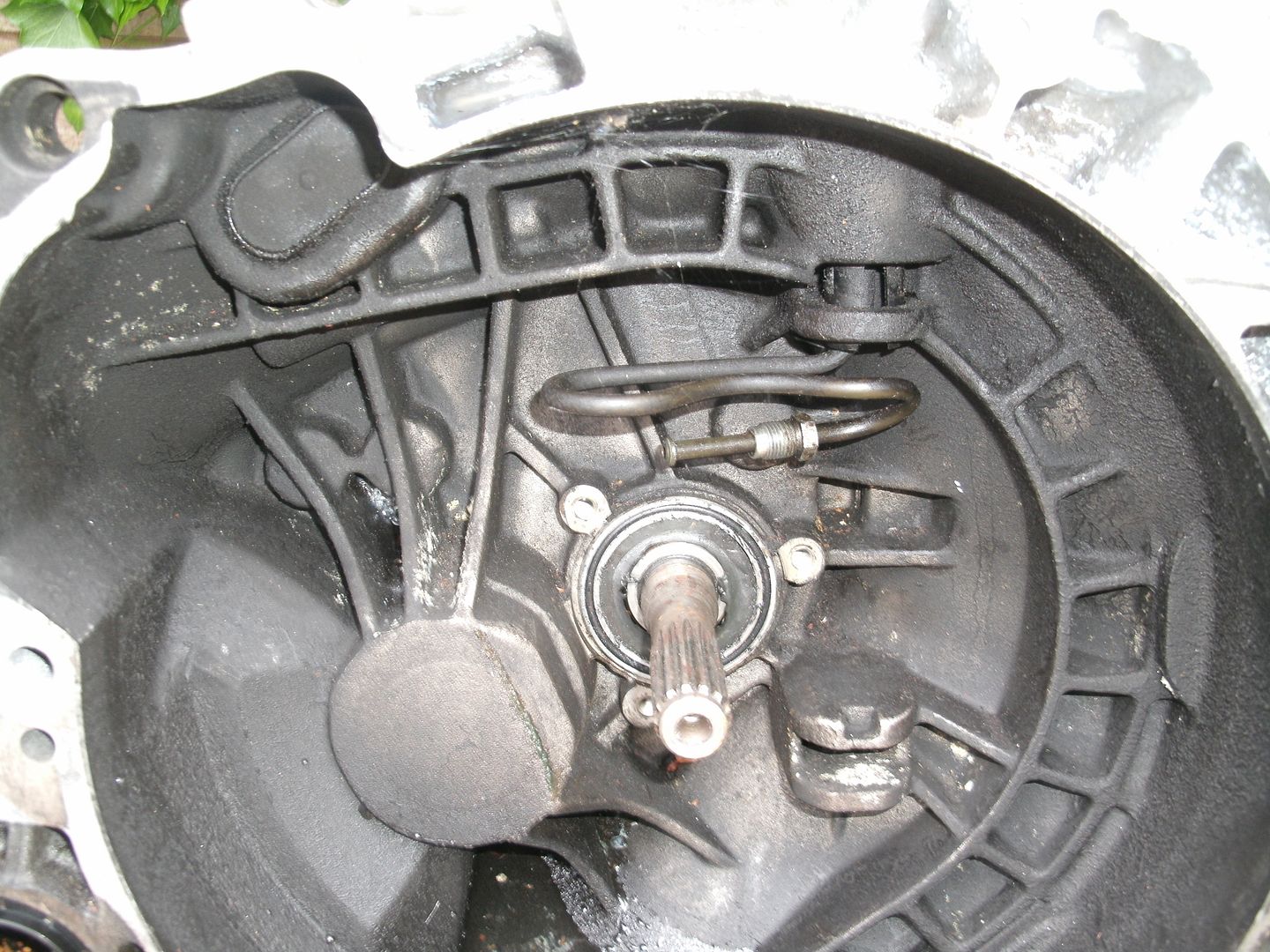

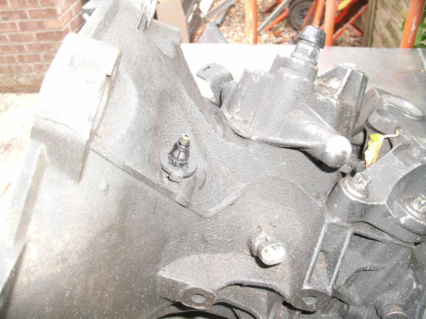

Modifying the gearbox to use a hydraulic clutch release bearing (thanks to Lee303 for his help on this one)

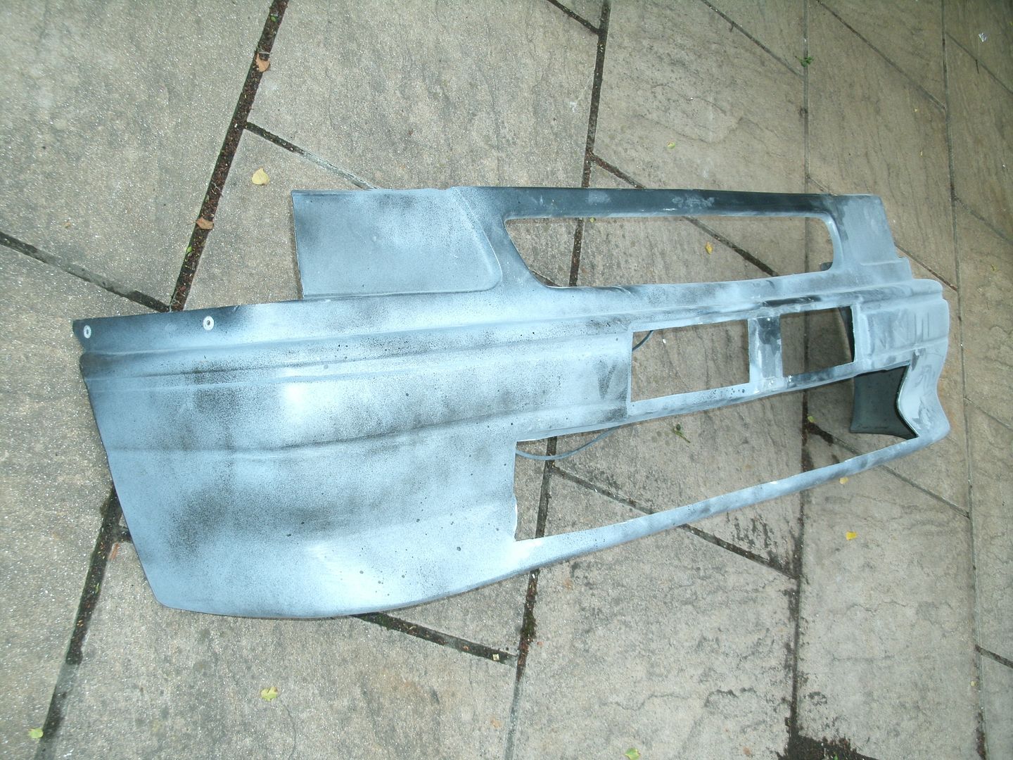

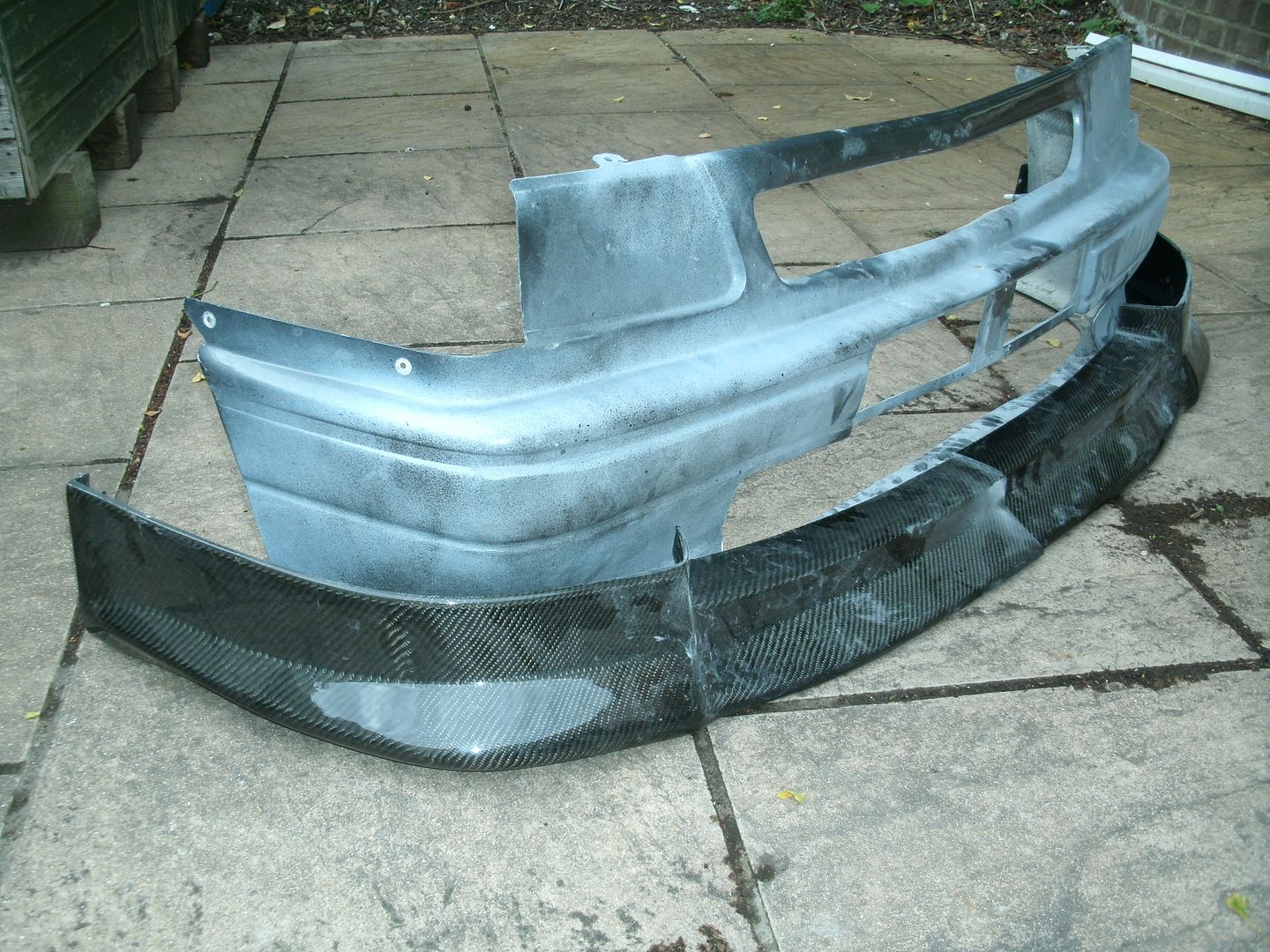

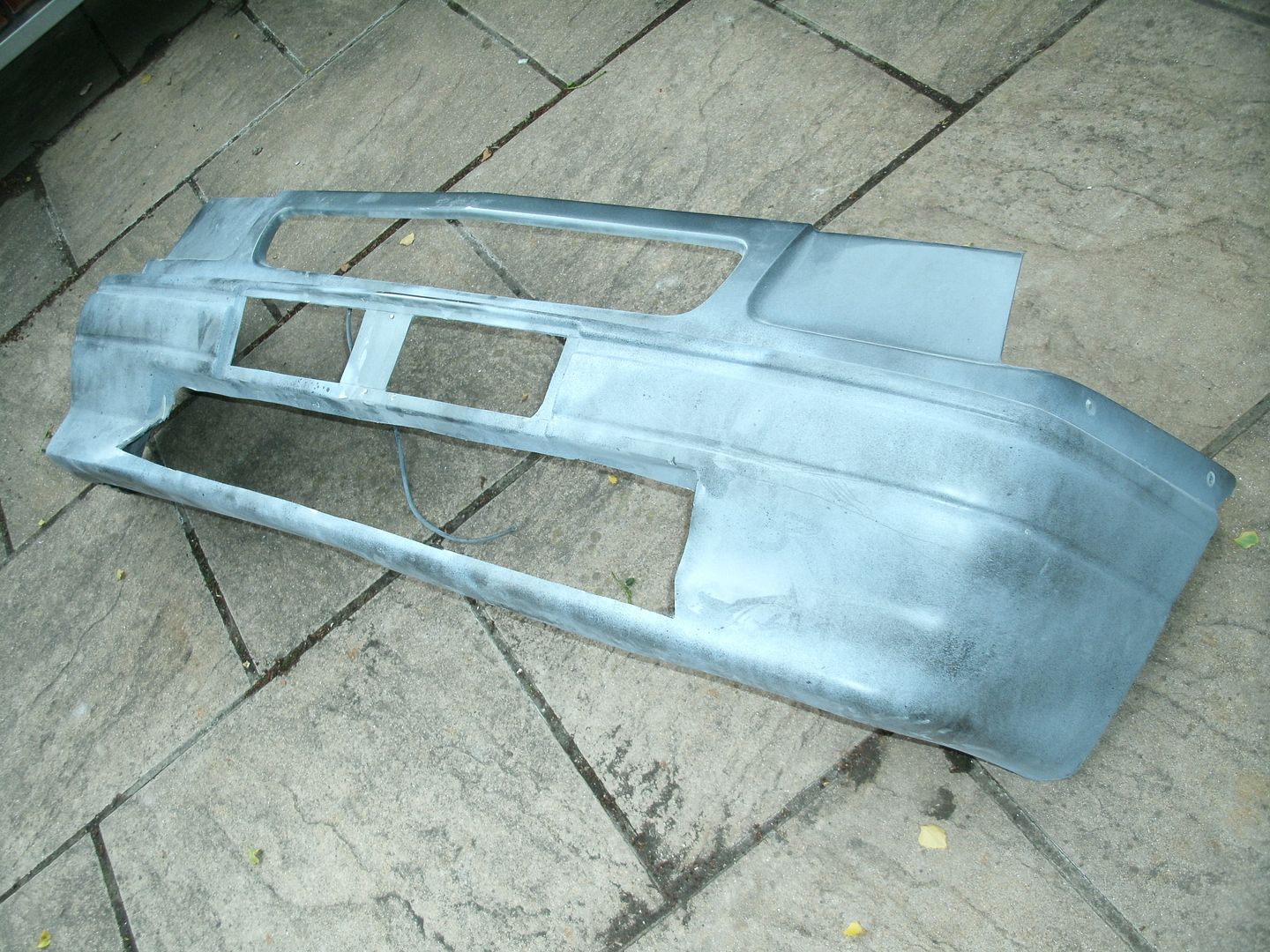

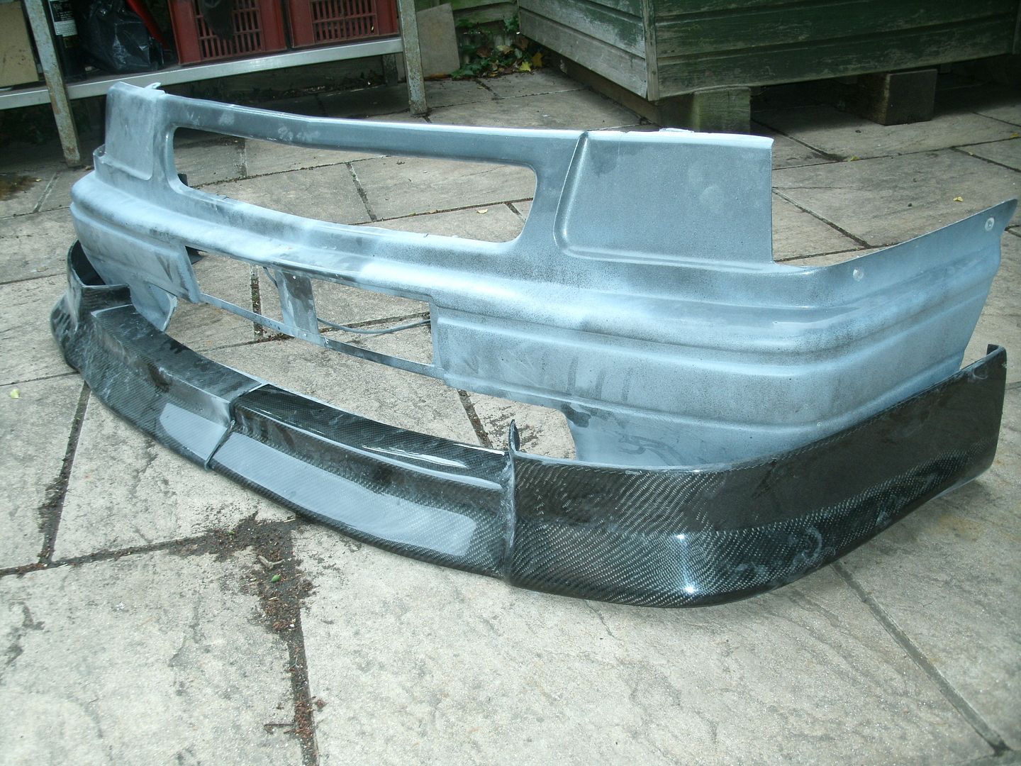

front lower air dam looks great, be nice to see it going back together!:thumb:
It's from an Integra Type R, I've cut and shut it a little, and it's not too bad a fit. Needs a bit more fettling to improve things now.

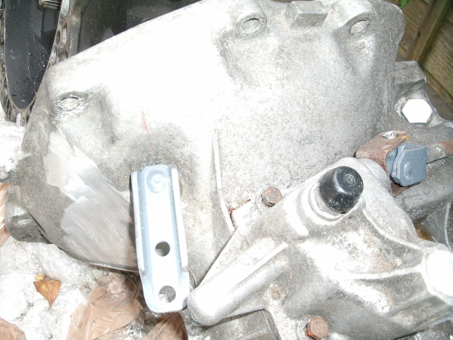

I bought a Corsa C gearbox from EBAY for £2.22 (!), and that's got me the clutch release bearing and the pipework to connect it all up. I'm using a 5.5" Superclutch (single plate), so I will need to modify the bearing assembly to accept the round-face type of bearing, rather than the flat-face which the OE clutch uses.
I haven't weighed all the bits yet, but it should be a bit lighter than the old steel clutch arm set-up.

crickey, some pretty serious gear. So have you pinched parts off a hydraulic f17 from the corsa C cheap ebay win?
Not sure if it's an F17 to be honest, it doesn't seem to be marked up with an 'F' code like the old Nova/Corsa 'boxes. But it's a small-block 'box so I can use everything in my F15 casing, so far as I can tell.

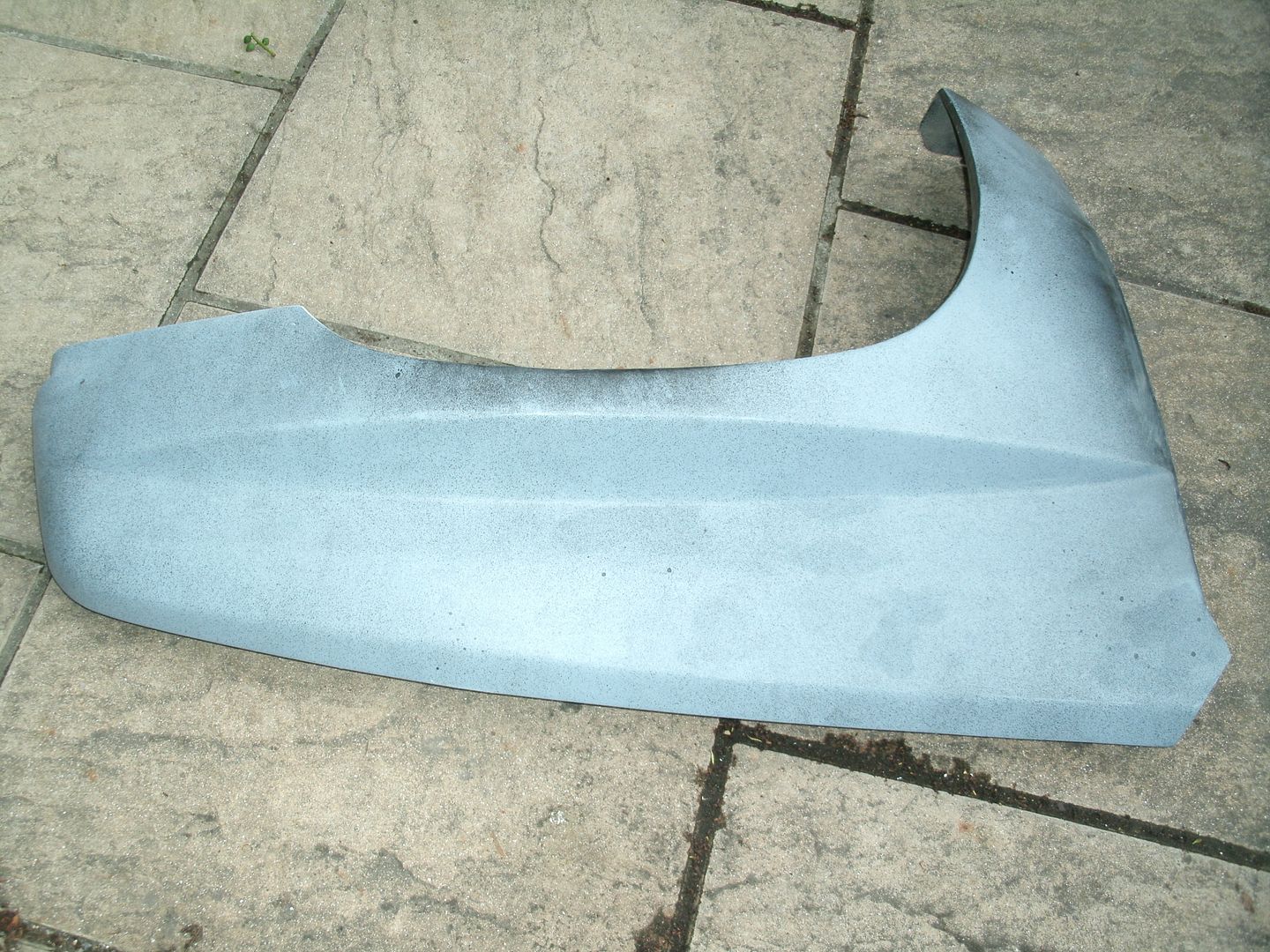

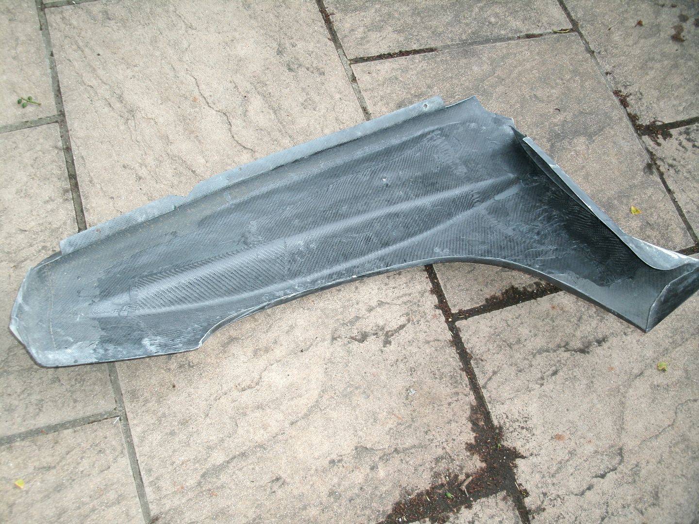

Tonight I picked up some damaged front wings from a Clio 197 Sport, I want to get the vents from the wings grafted into my wide front arches - photos to follow to explain my thinking!

I don't think I have the bodywork skills to attempt the job, but I'm sure I can find someone who can.
Unfortunately the drivers side wing I got from the Clio is beyond saving, so I need to find another one of those. God knows how much they would be from Renault, just the black plastic mesh piece which goes into them is over £70 each!
those are the ones, be interesting to see the way you do it, are you thinking flat to nova wings or similar to clio and bring that area of nova wing out abit ? if that makes sense
My Nova already has wide arch wings, and looking at them side by side with the Clio ones, the profile seems to be very similar, so I don't think it will be too difficult to achieve.
I've just done some photos so I will (try to) post them up for people's views.
The nearside Clio wing, pictured with the (repaired) carbon fibre wide-arch wing from my Nova;

I can't see why the vent and surround couldn't be tranplanted into the Nova wing?
