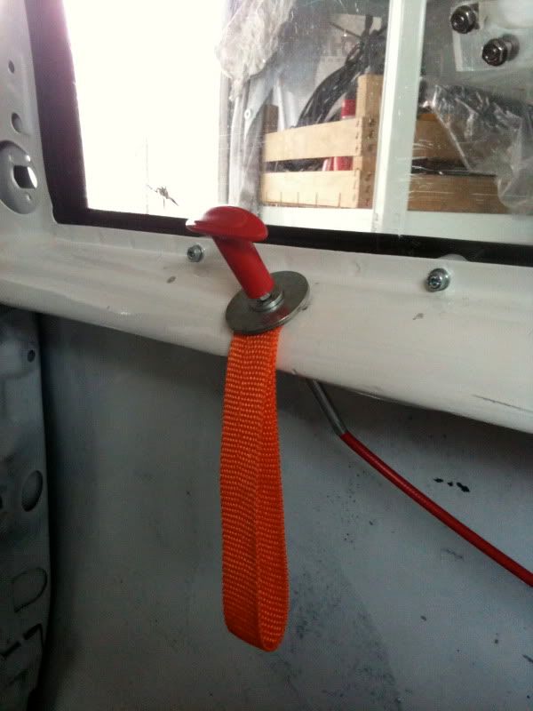

Door handles fitted. Used a T-pull cable and some rachet strap
http://img.photobucket.com/albums/v3...a/IMG_0226.jpg
http://img.photobucket.com/albums/v3...a/IMG_0227.jpg

Good idea with the pull cord handles, good to see you're still at it. :)
