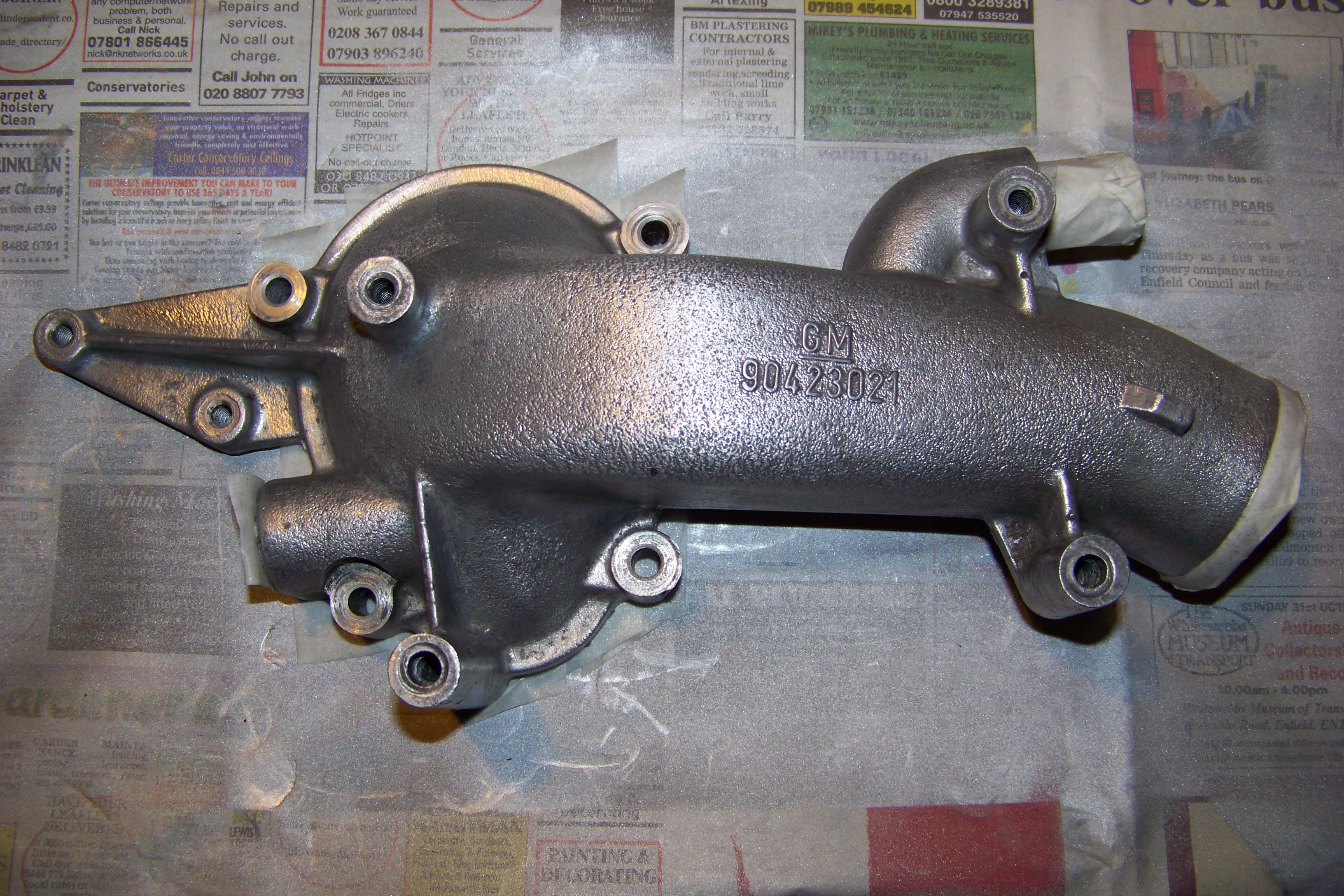

Just before painting
https://images2.imgbox.com/25/cc/F1dPGAit_o.jpg

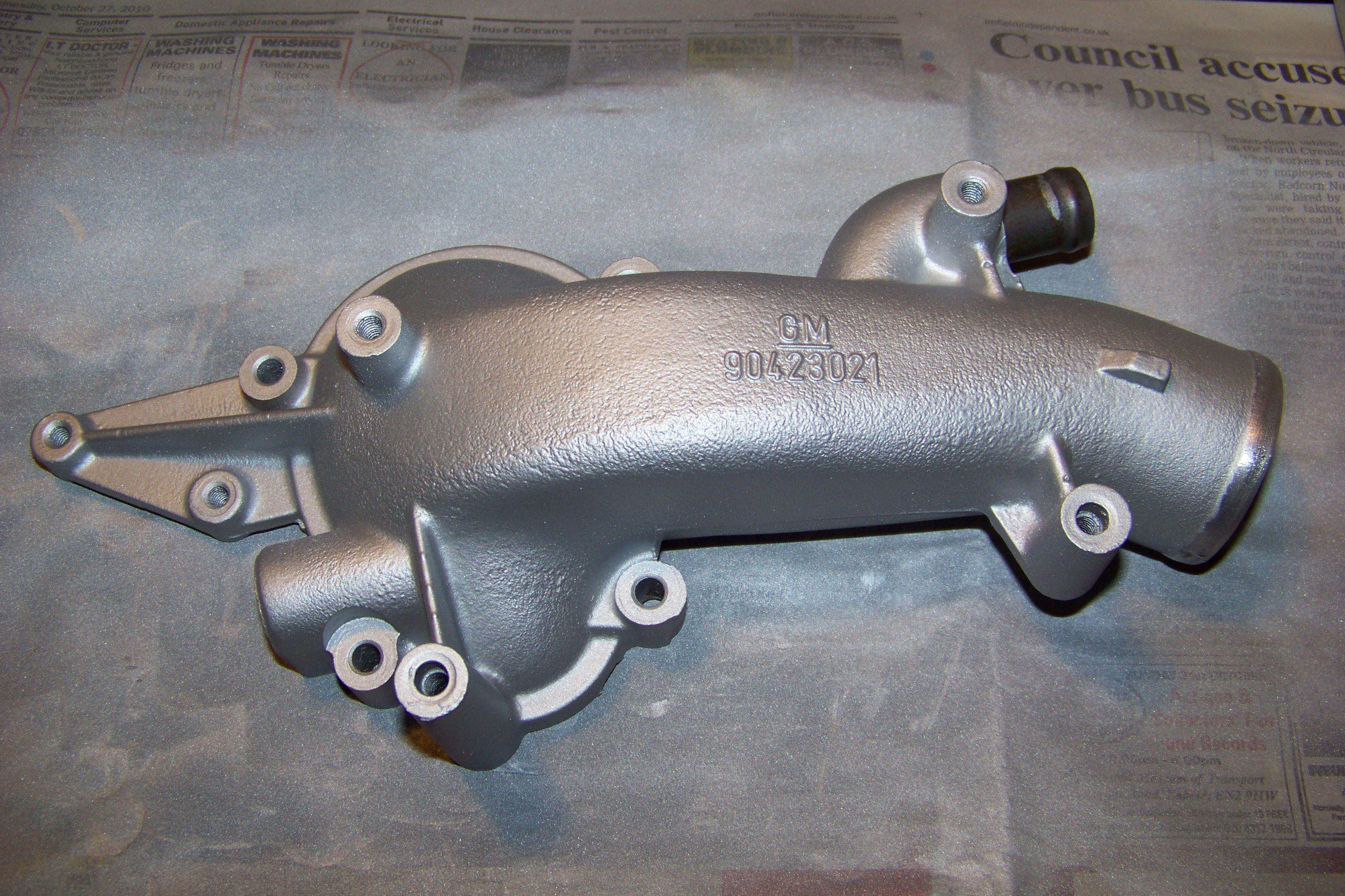

Gave it a few coats of VHT paint, let it dry and it came out like this
https://images2.imgbox.com/d7/66/Q09EI1pc_o.jpg

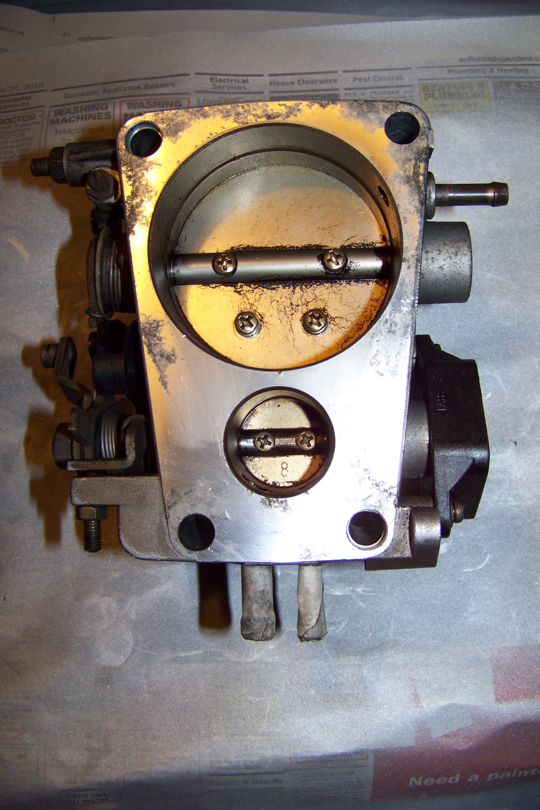

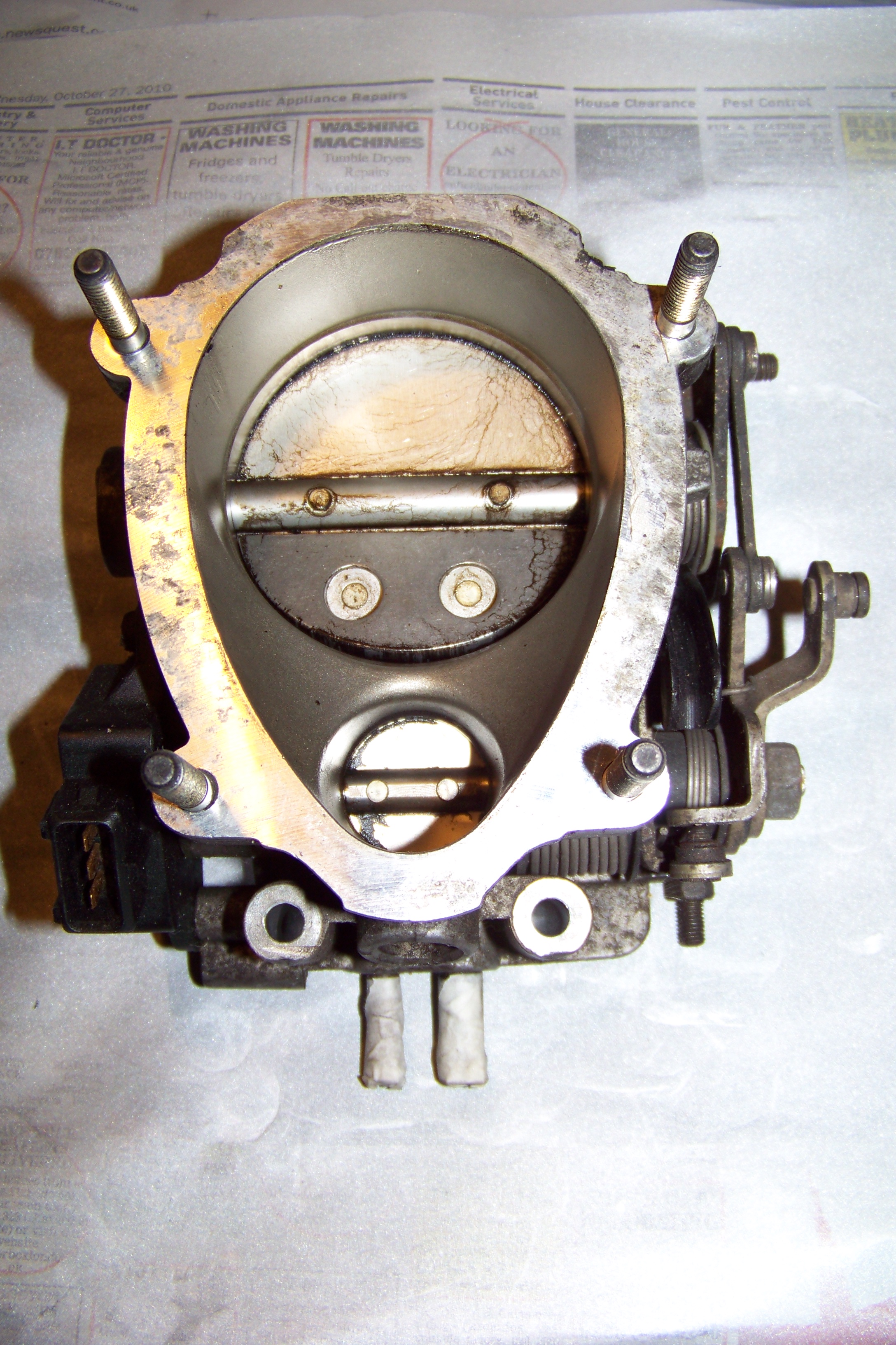

Happy with the way it looked I put it aside to clean the throttle body, which started off like this:
TBH I was expecting it to be filthy like how my bro's XEV throttle body gets but this one was rather minor.
https://images2.imgbox.com/a1/51/IhmqVe31_o.jpg
https://images2.imgbox.com/4f/2d/H7KoIaV4_o.jpg

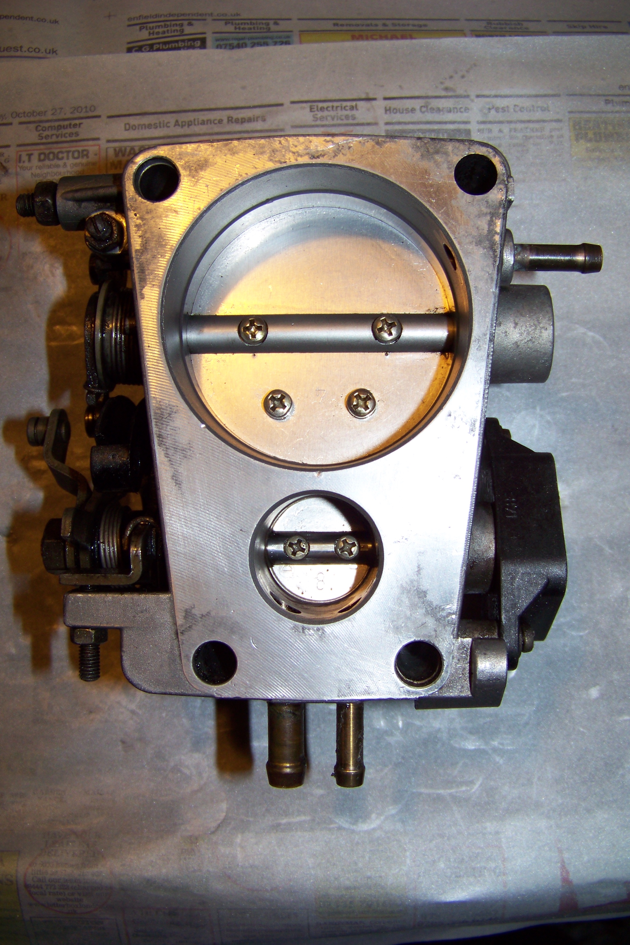

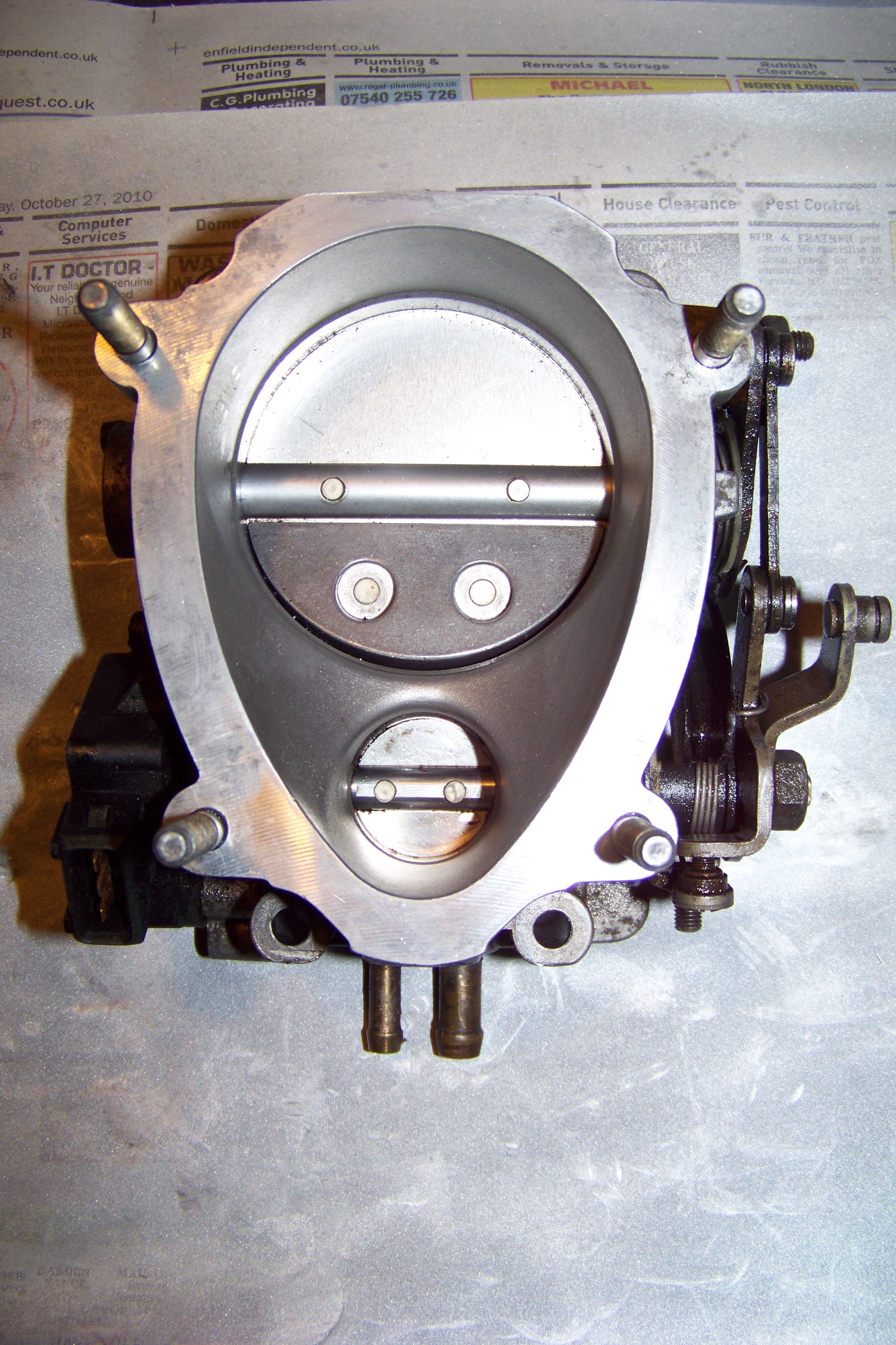

After some carb cleaner, wd40 and a wipe this is how it looked
https://images2.imgbox.com/d7/88/47hkKkaT_o.jpg
https://images2.imgbox.com/e0/83/LnIr9dcc_o.jpg
Gave the external areas a clean too but didn't paint it as it would've not been done properly due to the linkages etc. But still looks clean compared to how it was.

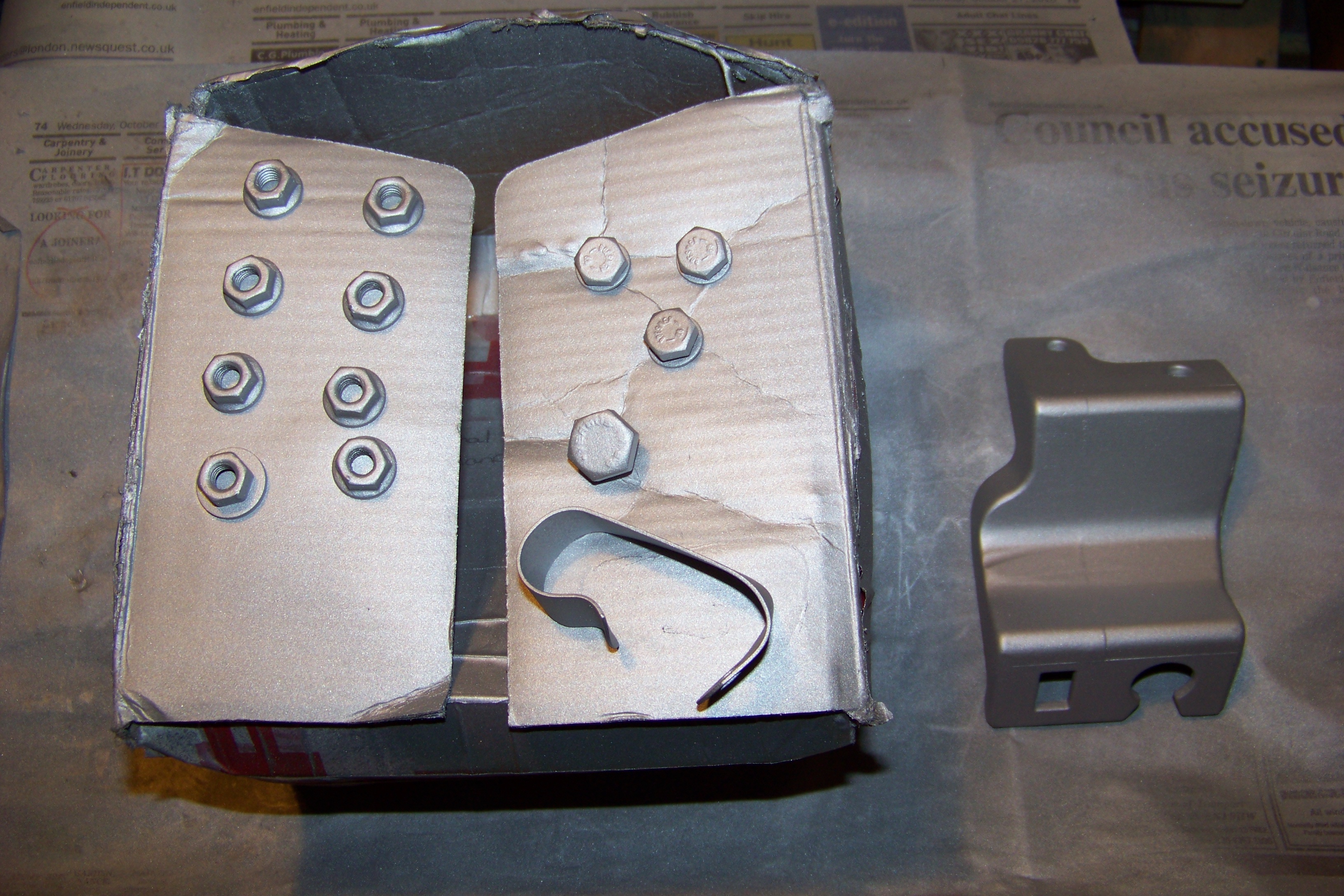

I then moved on to the various bolts and nuts that secure the tophat and throttle body to the inlet and also fuel rail and also the other two brackets.
They started off like this
https://images2.imgbox.com/d2/85/ZrRVfK7C_o.jpg
into this
https://images2.imgbox.com/42/be/AFfbKUS9_o.jpg
lastly to this
https://images2.imgbox.com/e5/49/Gr6FvwwA_o.jpg
