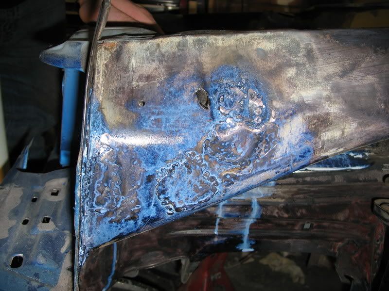

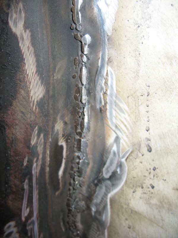

Sat morning the roof was check then had a light skim of stopper over the welds as it was perfect. The the whole roof was high build primered.

More good work Benn its looks like they've done a good job of the roof :)
This is going to look even better when you get the louvres sorted ;)
They? They? Only bit i didn't do was the welding.. (i re skimmed it as it wasn't 100%smooth)

lol I'll rephrase then, you've done bloody well Benn shame you didn't learn to skim and needed a helping hand, they've done a good job of finishng of YOUR good work lolQuote:
lol i didn't need it, Paul just cracked on. Stopping him would have been rude :p
