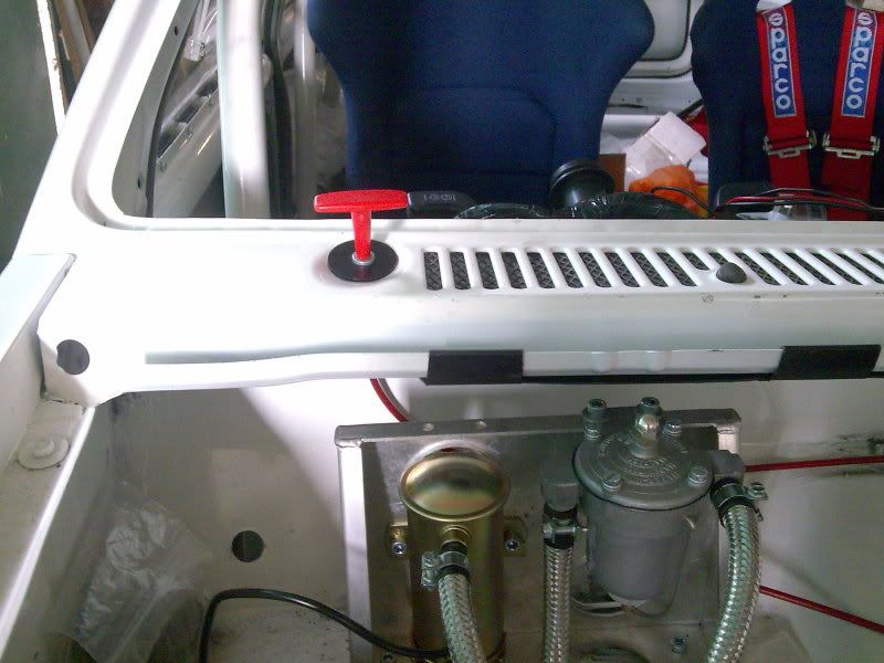

Taken from Facets website :Quote:
Originally Posted by nova ian
We recommend that you mount the fuel pump no more that 12 inches from the fuel supply (gas tank). All our Electronic fuel pumps will push fuel rather than pull fuel. Some pumps only have suction limit of 12 inches, therefore you should mount as close as possible to the tank.
you will struggle mate tbh with the current facet location the pump is metres away from the tank
Ive seen plenty of those pumps mounted in the engine bay without problems.
But yeah they do work best mounted right by the tank

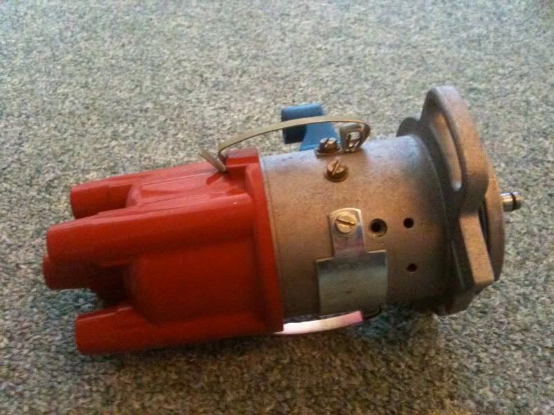

First off I sent my Mk2 Cav Dizzy setup off to H&H and had it Recon'd with the vacuum unit removed and the advance curve modified for the XE engine.
H&H Dizzy
http://img.photobucket.com/albums/v3...a/IMG_0134.jpg

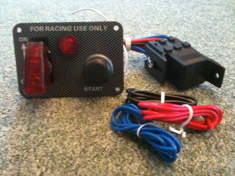

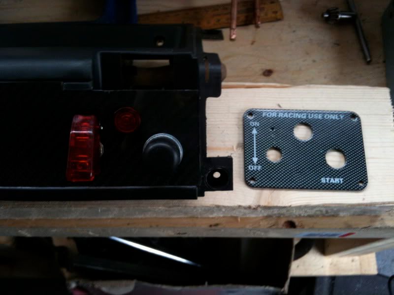

Also made a start on my dash pannels, I got this switch pannel from the autosport show, but wanted to put the switches on my own custom pannel as below.
http://img.photobucket.com/albums/v3...a/IMG_0137.jpg

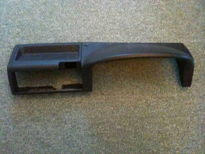

I'm going to use the top sections of a mk2 dash. I've cut out the air vents and clock sections.
http://img.photobucket.com/albums/v3...a/IMG_0139.jpg

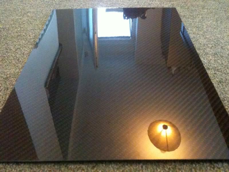

This will then be panneled in with some carbon fibre. Got this from the 'carbon mods' website. (www.carbonmods.co.uk) Top notch service. Arrived the next day!

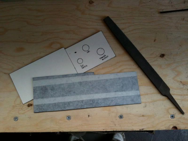

Made up some templates for the dash and transfered onto the carbon, and cut out with a jr hacksaw
http://img.photobucket.com/albums/v3...a/IMG_0184.jpg
Then filed the edges up and made it fit nicely

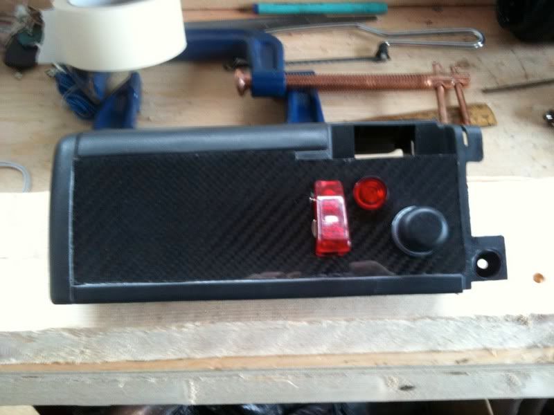

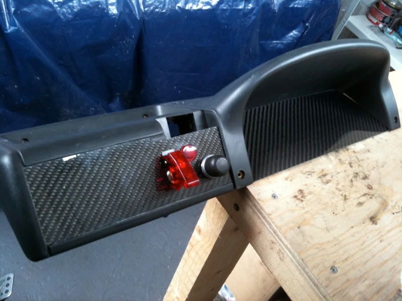

Then fitted the switches from old pannel
http://img.photobucket.com/albums/v3...a/IMG_0190.jpg
http://img.photobucket.com/albums/v3...a/IMG_0188.jpg

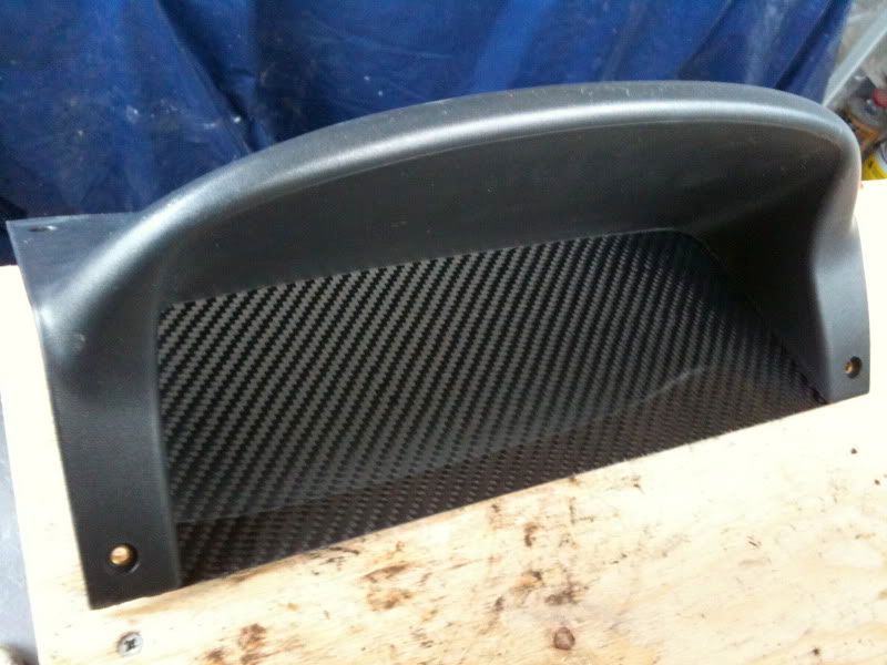

Also modified the dials binnacle to fit some more carbon fibre
http://img.photobucket.com/albums/v3...a/IMG_0182.jpg

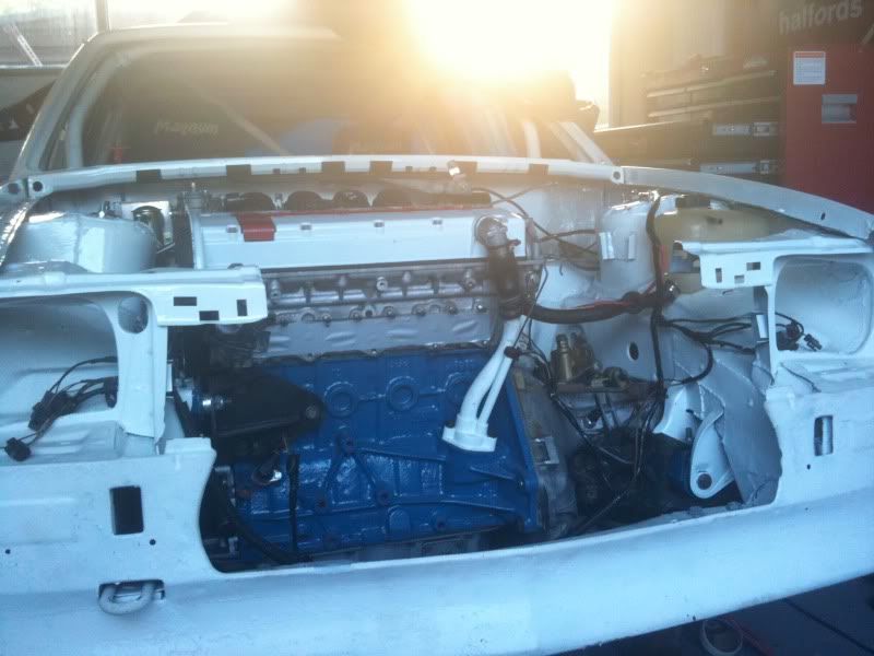

Back to the bias box, got it all built back up and cut some rally mudflap material to cover the hole in the firewall and minimise any water getting in
http://img.photobucket.com/albums/v3...a/IMG_0217.jpg
Also decided to cut out the slam pannel
http://img.photobucket.com/albums/v3...a/IMG_0218.jpg
