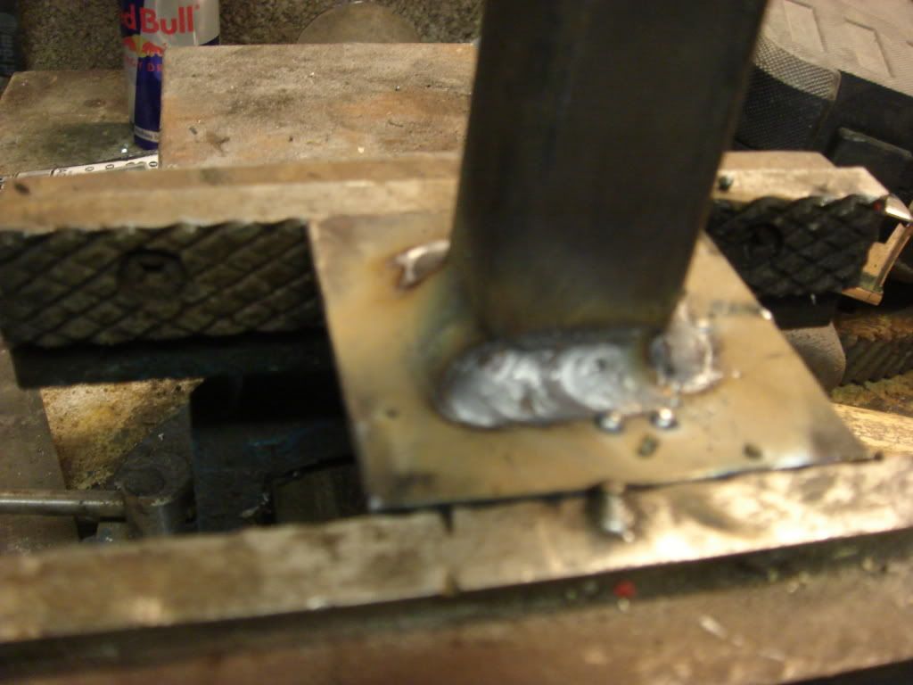

Right pic update time Have started cracking on with the seat rails as the plans is to get the inside finished this week ready for the engine coming back.
Started with some 25mmx25mm square tube

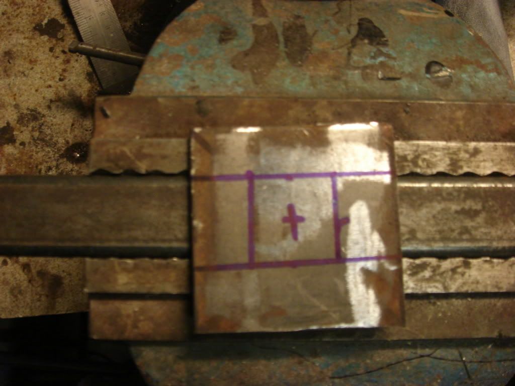

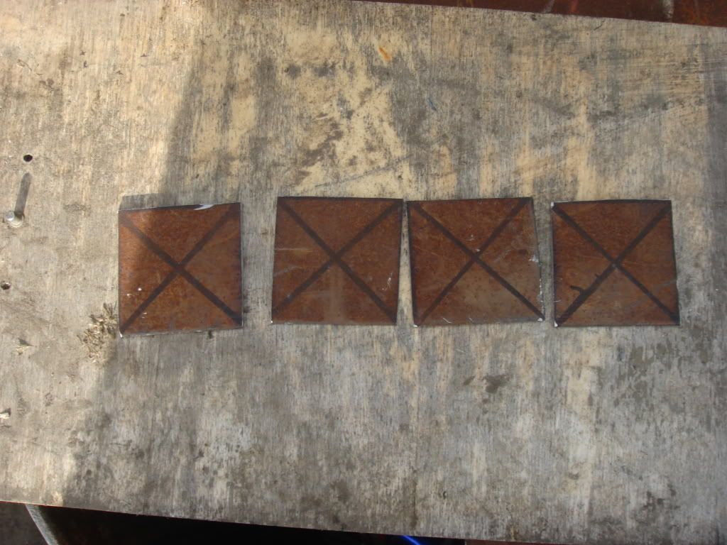

To make the spreader plates to weld to the car used 3mm plate and cut 60mmx60mm squares
http://i761.photobucket.com/albums/x...0/DSC03450.jpg
Cleaned the plate found the centre then centered the bar
http://i761.photobucket.com/albums/x...0/DSC03451.jpg

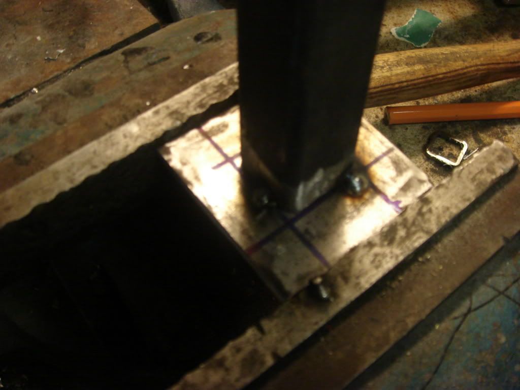

Tacked the plates to make sure they would fit into the car
http://i761.photobucket.com/albums/x...0/DSC03452.jpg

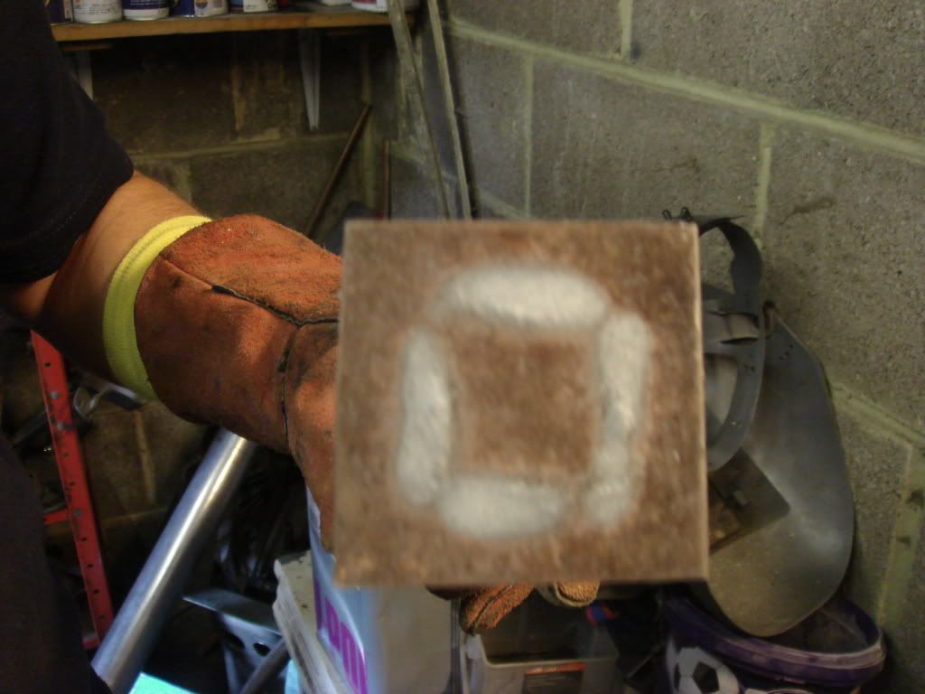

Once made sure it fitted seam welded the plate to the bar
http://i761.photobucket.com/albums/x...0/DSC03454.jpg
Made plenty of penetration
http://i761.photobucket.com/albums/x...0/DSC03457.jpg

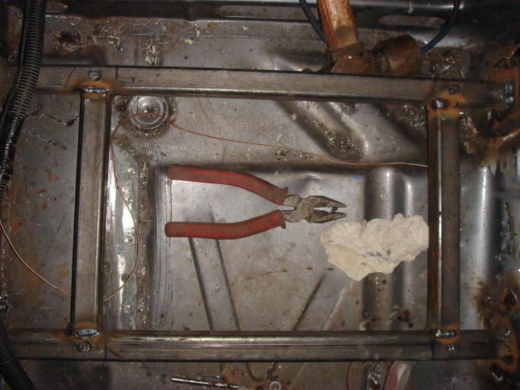

Welded the bars in the car to suit the width of the seat holes I have welded them so they can still be adjusted if required. Also welded to supports to make a h-frame style mounting.
the finished article
http://i761.photobucket.com/albums/x...0/DSC03460.jpg

Cheers pal. But seriously, I'm impressed by your welding, and the fabrication on the chassis leg :thumb:Quote:

Cheers mate im actually impressed by the mig welding aswell up until the last few weeks the weldin has been ok but most has been hidden away but I must have just got past that crap area to ok area of mig welding. Half the time i wanted to stop and get some gas rods as I can do that till the cows come with having to do it as part of my job but the migging is looking good. :thumb:Quote:
