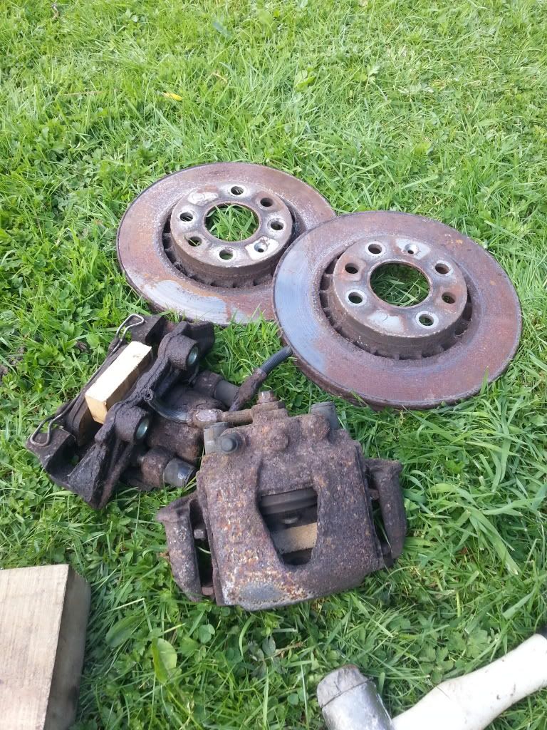

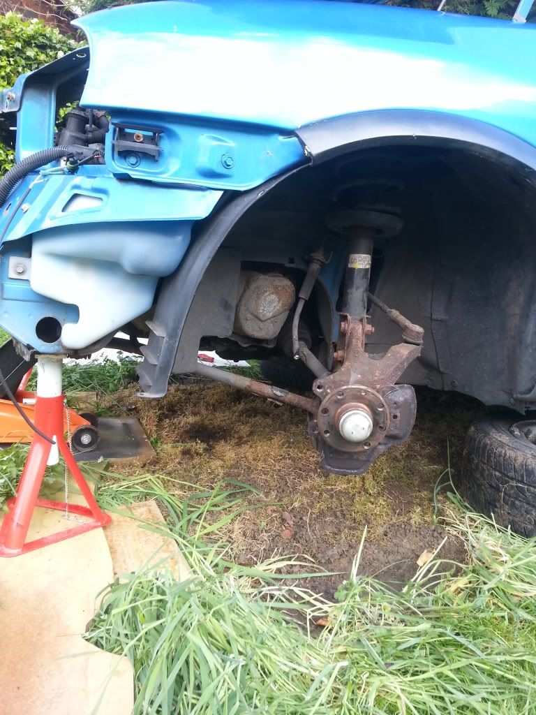

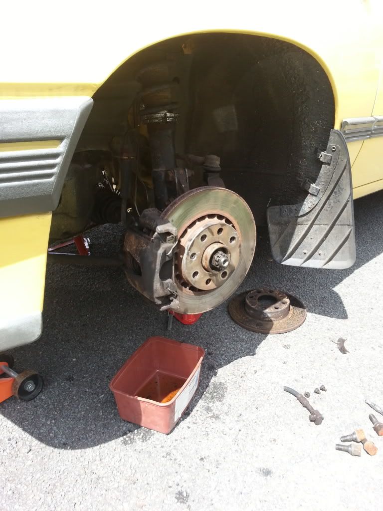

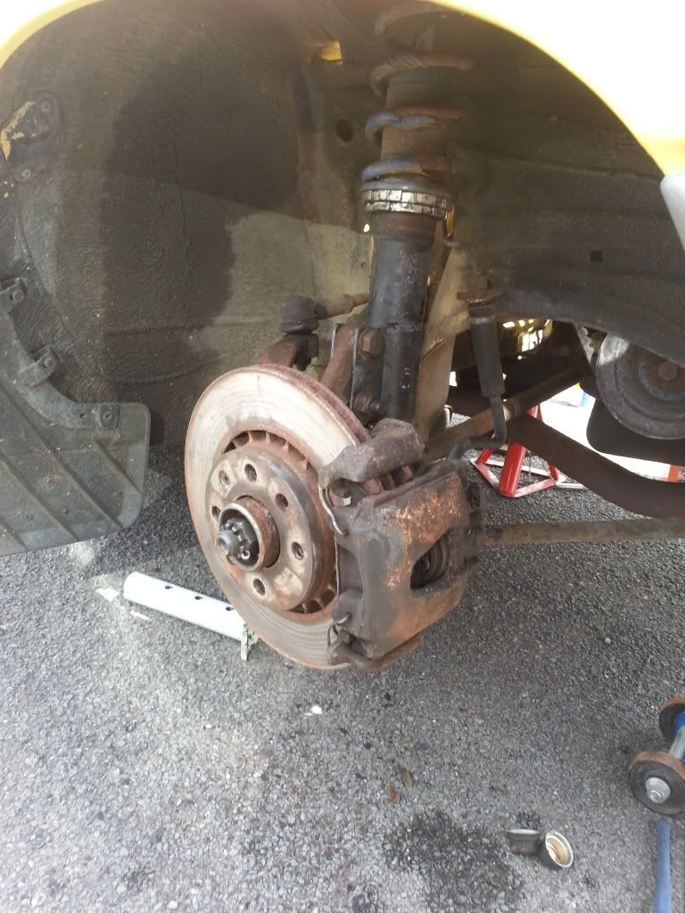

So....... After another failed fuel line, as I only replaced it the other year, got that sorted then I turned my attention to the brakes, as the o/s caliper has been sticking for a while, decided best option was to change to the ate set off the corsa sport I've got for the x16xe.
So switched it all over, seems to be working fine, so if I can ill wash and polish it before popping up to the national on Sunday.

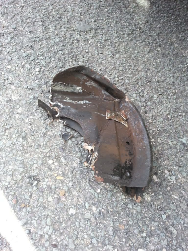

Had to destroy one dust guard as the screws were solid, and I bought and Eezibleed kit, awesome stuff..
http://i1257.photobucket.com/albums/...ps584c4580.jpg
http://i1257.photobucket.com/albums/...ps9a839f26.jpg

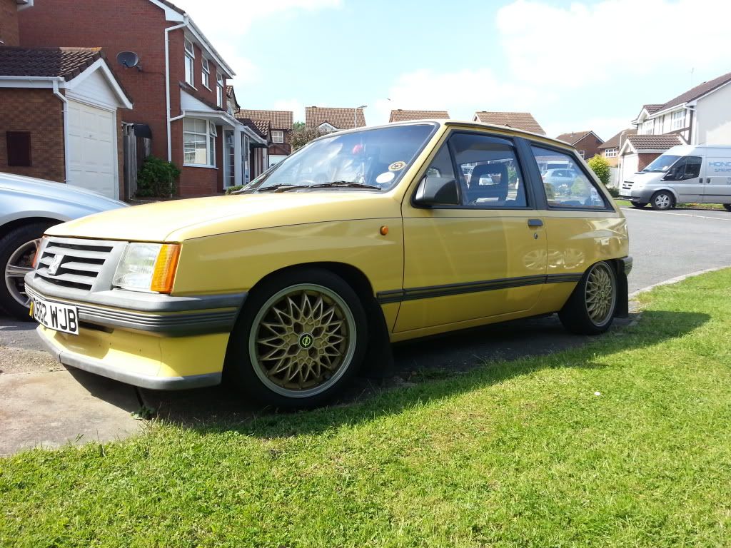

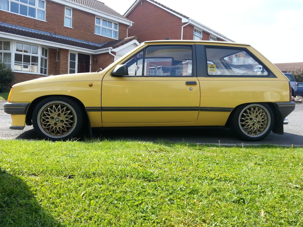

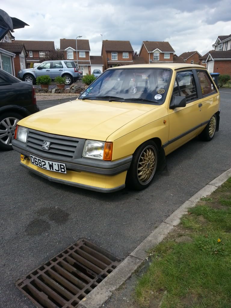

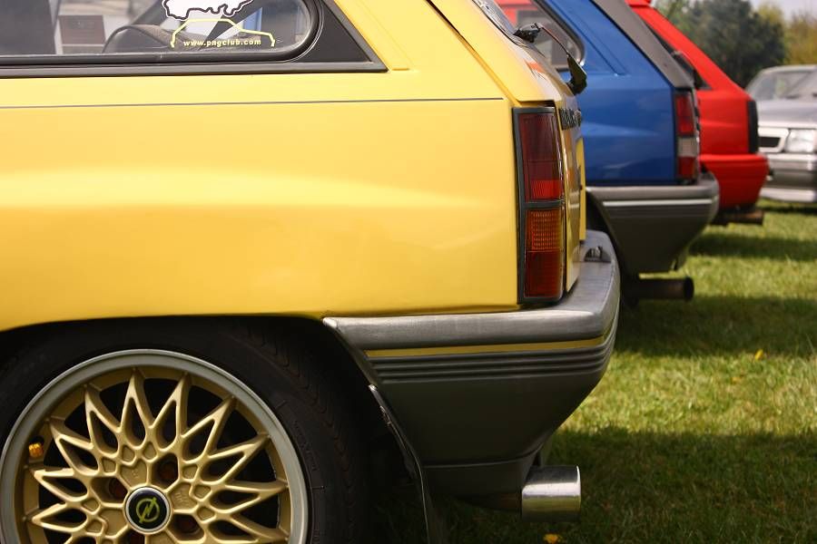

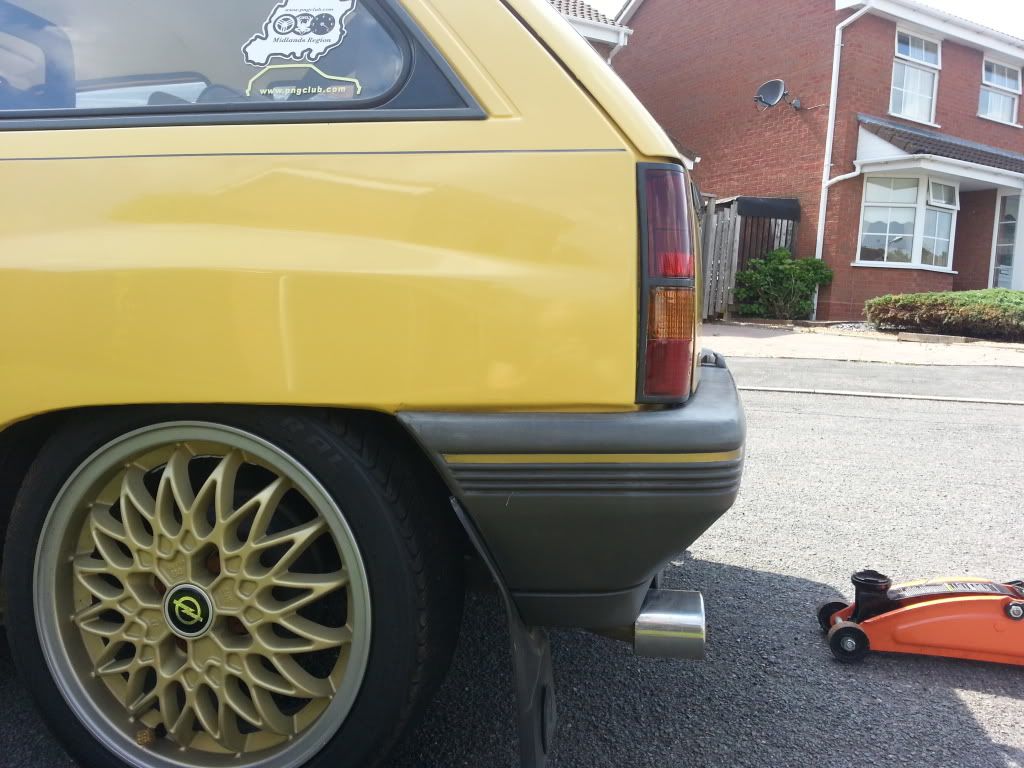

So today I decided to try lower the rear end a bit more, I did it the pikey way, I took a quarter of the bottom of the springs, and flattened the bottom and top with a flap wheel.
So heres a pic from the national..
http://i1257.photobucket.com/albums/...psb25c7408.jpg

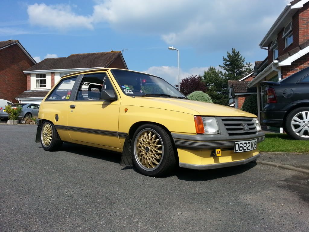

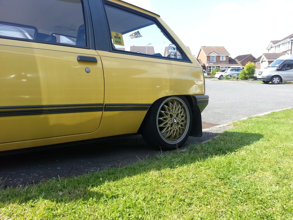

I tried to recreate it to show how much has come down by.
http://i1257.photobucket.com/albums/...psb0d2ba29.jpg
Probably only about 5-10mm max, but it seems to sit better..
http://i1257.photobucket.com/albums/...ps80c2f0a2.jpg
http://i1257.photobucket.com/albums/...ps10f03044.jpg
The one of parked at an angle up the drive lol
http://i1257.photobucket.com/albums/...ps3d068316.jpg
http://i1257.photobucket.com/albums/...psc59d14b2.jpg

Did you go from the standard 1.2 breaks to the corsa ones? If so how much better is the braking? Do you still have to push the pedal as hard? I have the standard setup on mine and the calipers are brand new, the braking power is fine for me I just hate how I have to put effort in to push the pedal. Maybe I am just lazy lol
Looking good. Any pictures of the spring mod?
The lock surrounds could do with a lick of paint to bring them back to up the same gray as the handles. :thumb:
Yep, from standard 1.2 to corsa sport brakes and they are allot better now the pads are re worn in.
Less effort to push the peddle also.

Ps: no sorry no pic of the springs, all I did was cut a quarter of the bottom of the pigtails, and then flattened off both the top and bottoms.
New rear height looks well. Even if it was done the pikey way :p
