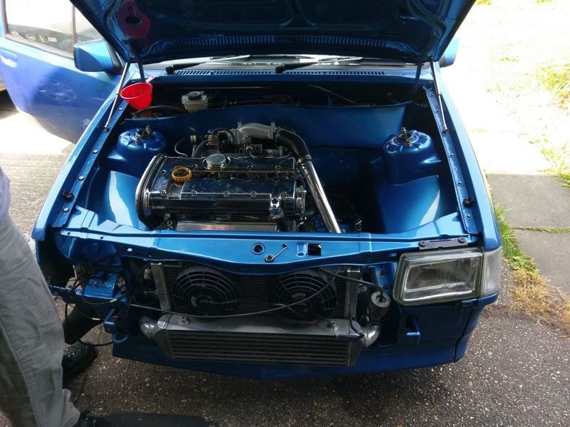

Got the turbo back. Oh it was knackered.
New turbo has hybrided wheels and all that so. Billet too.

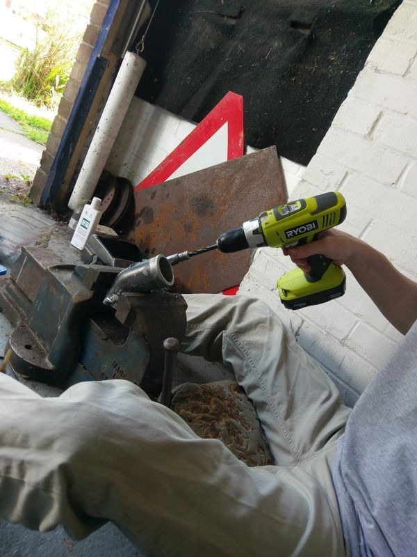

Building the turbo up.
http://img.photobucket.com/albums/v3...psipuoznas.jpg
Breather was tapped and then blocked. To remove that from the system to try and help.

Fitting.
Primed and started, no smoke.

Test drove around the block a few times.... No smoke.
http://img.photobucket.com/albums/v3...pscqogedzf.jpg
Was very happy. Booked back in at track and road.
All started ok.... Till it started smoking from the breather again so had to stop. Its better than it was, but when pushed it just starts to breath hard and smoke.
