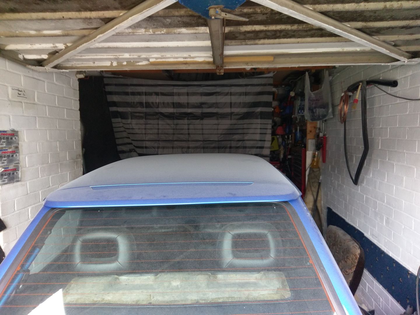

What to protect the car more, then welding and grinding. Saw the plastic sheets you see on Hotrod and bike building shows... They are alot of money.
So a trip to the scummy Range got me... Yes a std shower "curtain" is the same width as a Nova.
http://img.photobucket.com/albums/v3...ps0r74zhhz.jpg
£2.99... Does the job.
http://img.photobucket.com/albums/v3...psq3wzoteg.jpg
Doesn't stop the dust tho....

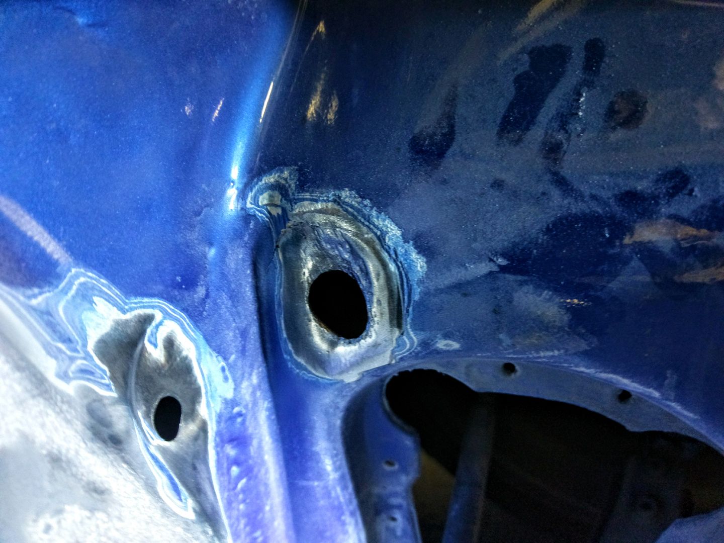

Fiber glass sanded off, gave the holes next to it a gentle tap to recess then in so plates could be welded in. As one of them i can't get to the other side...
http://img.photobucket.com/albums/v3...pslcaonx1l.jpg
Holes welded up.

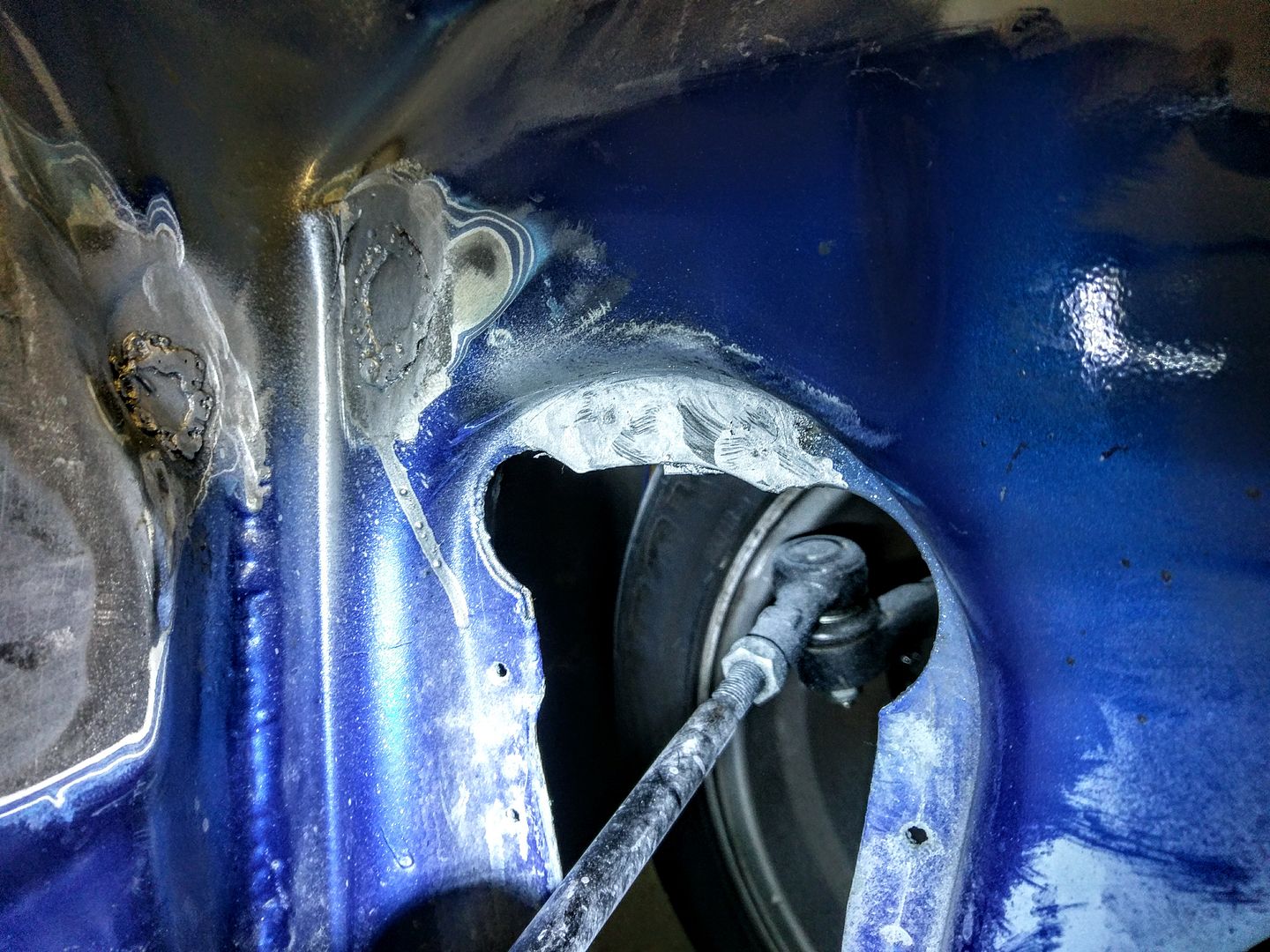

Started welding the small holes in the steering arm hole up.... As they are very untidy.
http://img.photobucket.com/albums/v3...ps1mcqq2df.jpg
Bit of sanding left me.... haha
