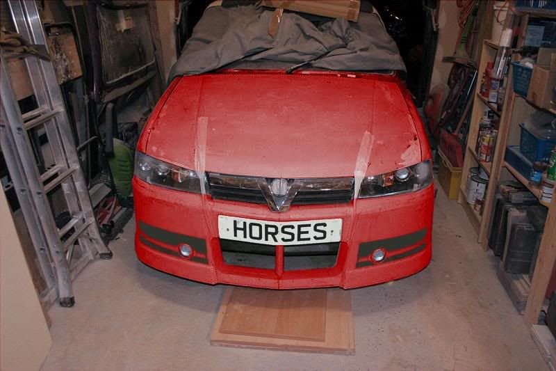

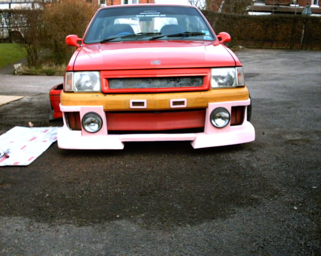

Still very much a WIP ad, it was a quick attempt to start with:
http://img99.imageshack.us/img99/6141/adejj4.jpg

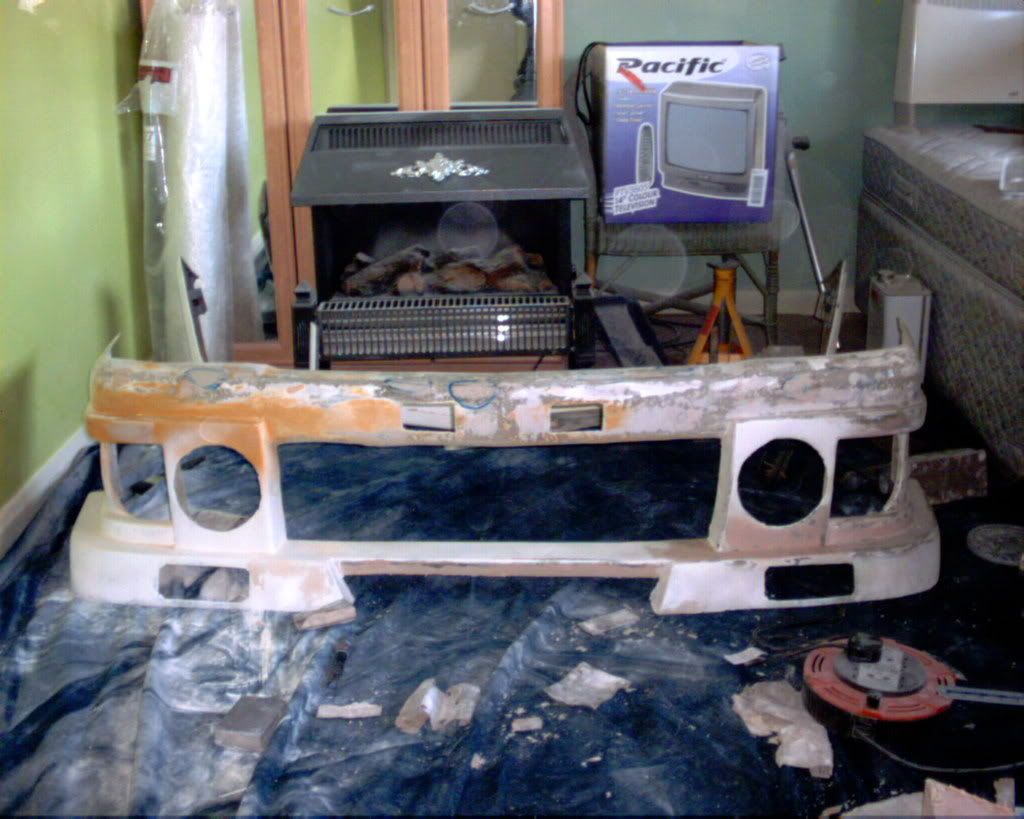

looking good mate, brings back memories of when i made a bumper for a uni project (must be 6 years ago now :eek: lol )
http://i192.photobucket.com/albums/z...Picture127.jpg
http://i192.photobucket.com/albums/z...Picture185.jpg
i know how much work went into making that, you're doing the whole car you nutter lol
Dave I remember seeing a thread on that bumper years ago!
lol
Ash that's pretty cool - the yellow burnt my eyes though! Make it more like more like custard yellow lol
pretty cool though!

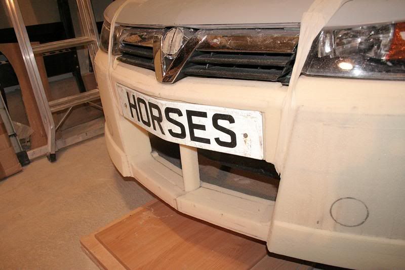

Speaking of which I spent most of the afternoon shaping it.

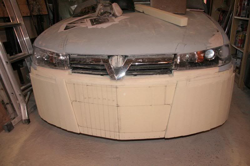

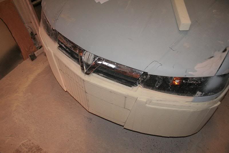

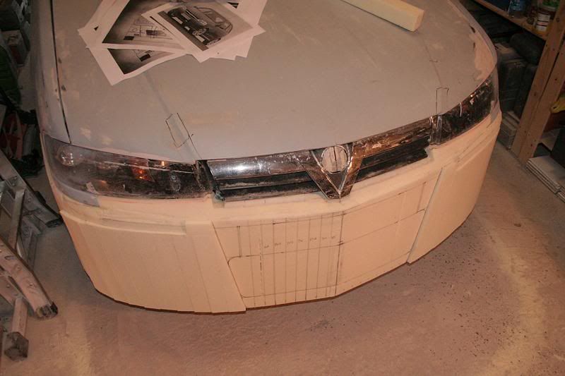

Started by measuring and drawing the design then bonded on a layer of foam to bring the side panels out to the right depth -
http://img.photobucket.com/albums/v1...erhole0001.jpg
http://img.photobucket.com/albums/v1...erhole0003.jpg
http://img.photobucket.com/albums/v1...erhole0002.jpg
I then smoothed these down so the top section blended in with the lines under the lights.

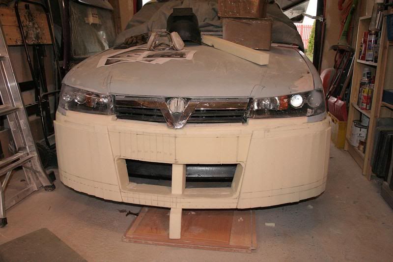

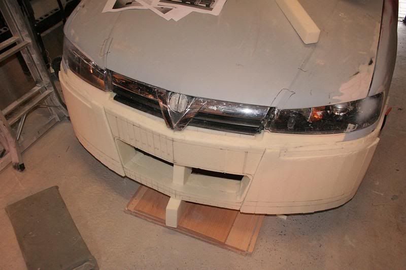

The next step was to cut the lower vent out -
http://img.photobucket.com/albums/v1...erhole0004.jpg
http://img.photobucket.com/albums/v1...erhole0007.jpg
The centre support isnt bonded inplace - just for show. It's now starting to feel like a bumper!
I then fettled, cut, bonded and sanded away until I had something that resembles a cross between an Astra bumper and an Audi!

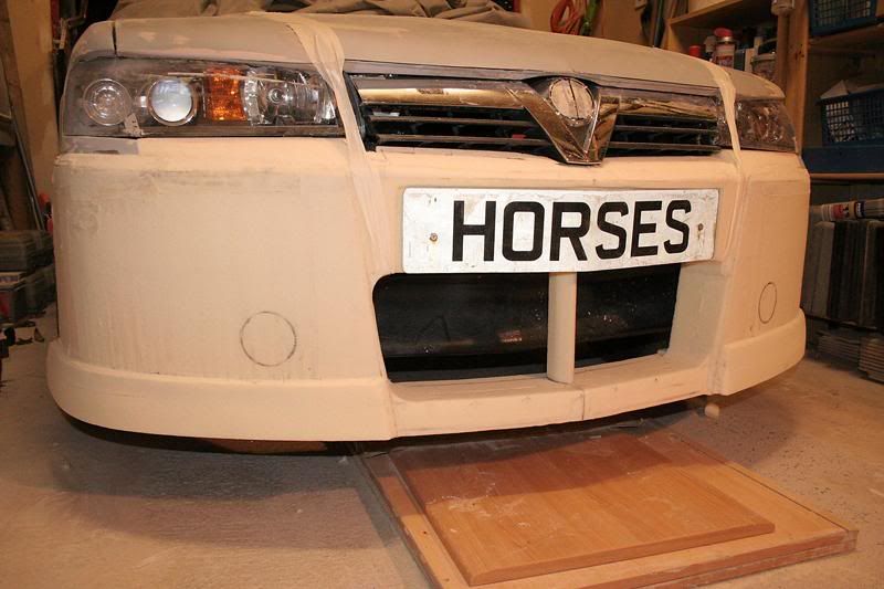

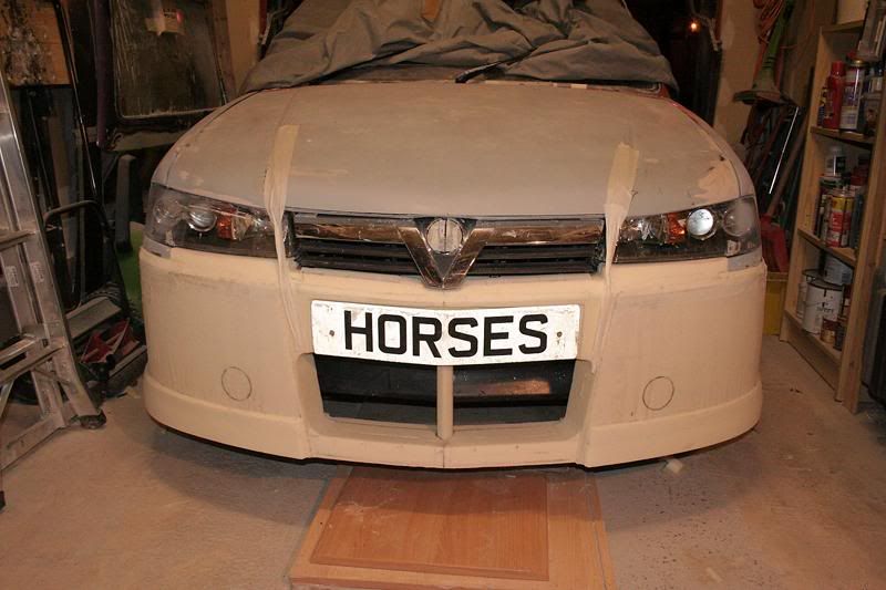

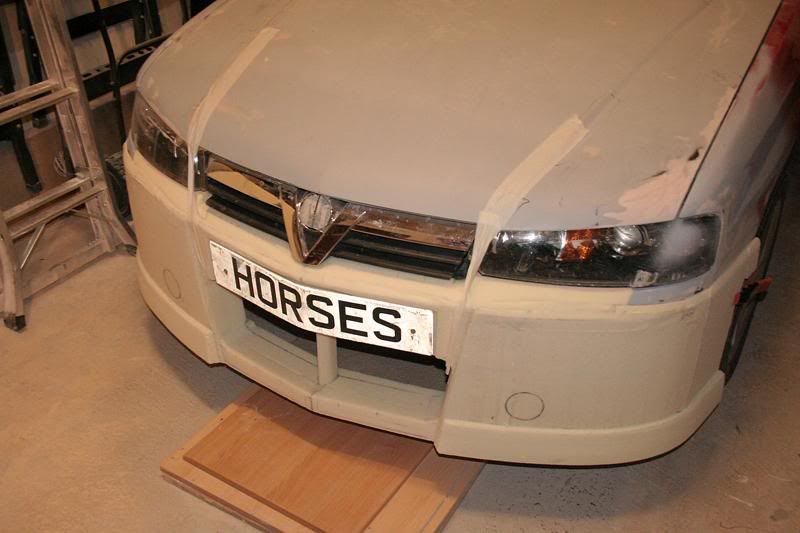

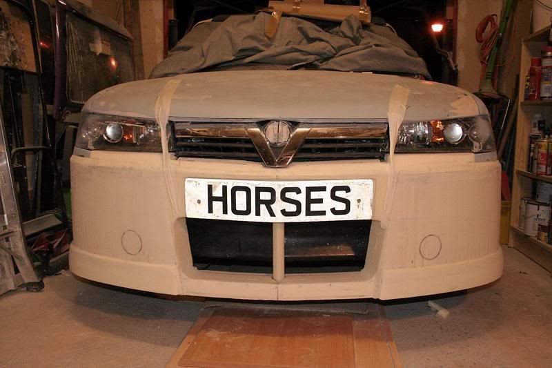

The following pics show the bumper pretty much complete from a frontal perspective. I need to work out the position of the fog lights as well as add some more detail to the bottom (the centre section will be trimmed and rolled so it flows back) -
http://img.photobucket.com/albums/v1...erhole0009.jpg
http://img.photobucket.com/albums/v1...erhole0012.jpg
http://img.photobucket.com/albums/v1...erhole0018.jpg
http://img.photobucket.com/albums/v1...erhole0019.jpg
http://img.photobucket.com/albums/v1...erhole0014.jpg
http://img.photobucket.com/albums/v1...erhole0020.jpg
http://img.photobucket.com/albums/v1...erhole0027.jpg
http://img.photobucket.com/albums/v1...erhole0023.jpg

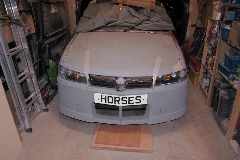

Heres one with the foam photoshopped in primer grey-
http://img.photobucket.com/albums/v1...hole0008pr.jpg
The only bit to add to the front is the 2 lower slats that sit on the corners of the lower vent mouth (there will be reflectors in these).
the sides still need finishing off too.
However I cant help thinking there's something missing. the sides seem too flat/dominant. I'll need to look at some kind of surround for the fogs...
