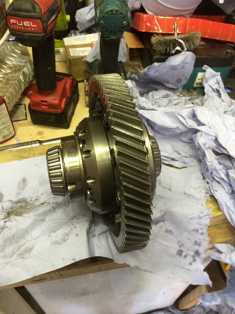

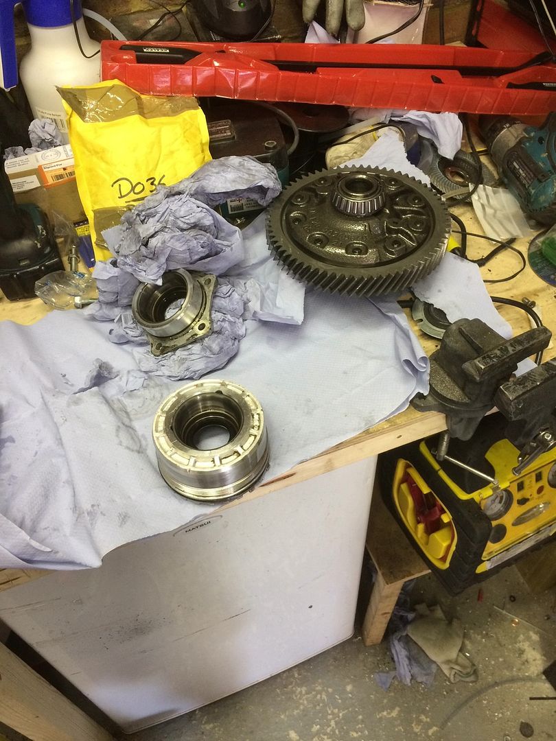

Little pressie from Quaife.
http://i27.photobucket.com/albums/c1...1724D34D_4.jpg
http://i27.photobucket.com/albums/c1...AD112AB5_3.jpg
http://i27.photobucket.com/albums/c1...F5BA4A10_1.jpg

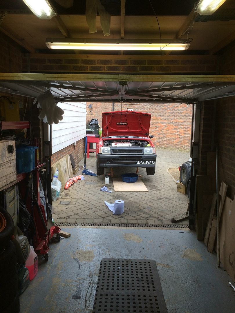

Only took about an hour to fit, put it in without the crown wheel first to set the bearings (on Iain's advice) then bolted it all up and filled it with oil and test drove, bish bash bosh, different car!!! Able to power on mid corner now, completely different driving style but one I'm very happy to get used to!!!

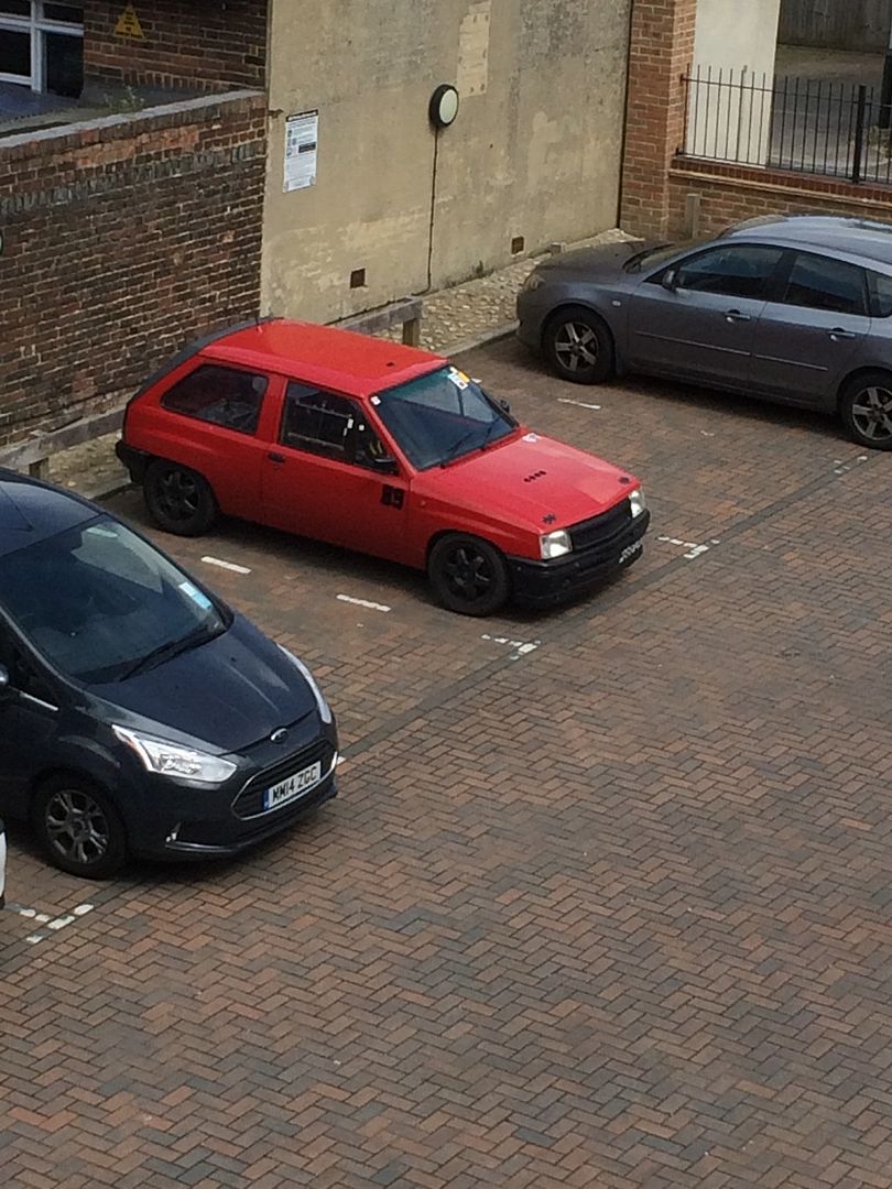

Took the car to see my old man
http://i27.photobucket.com/albums/c1...7DD1AE25DA.jpg
Love seeing it parked up!!
