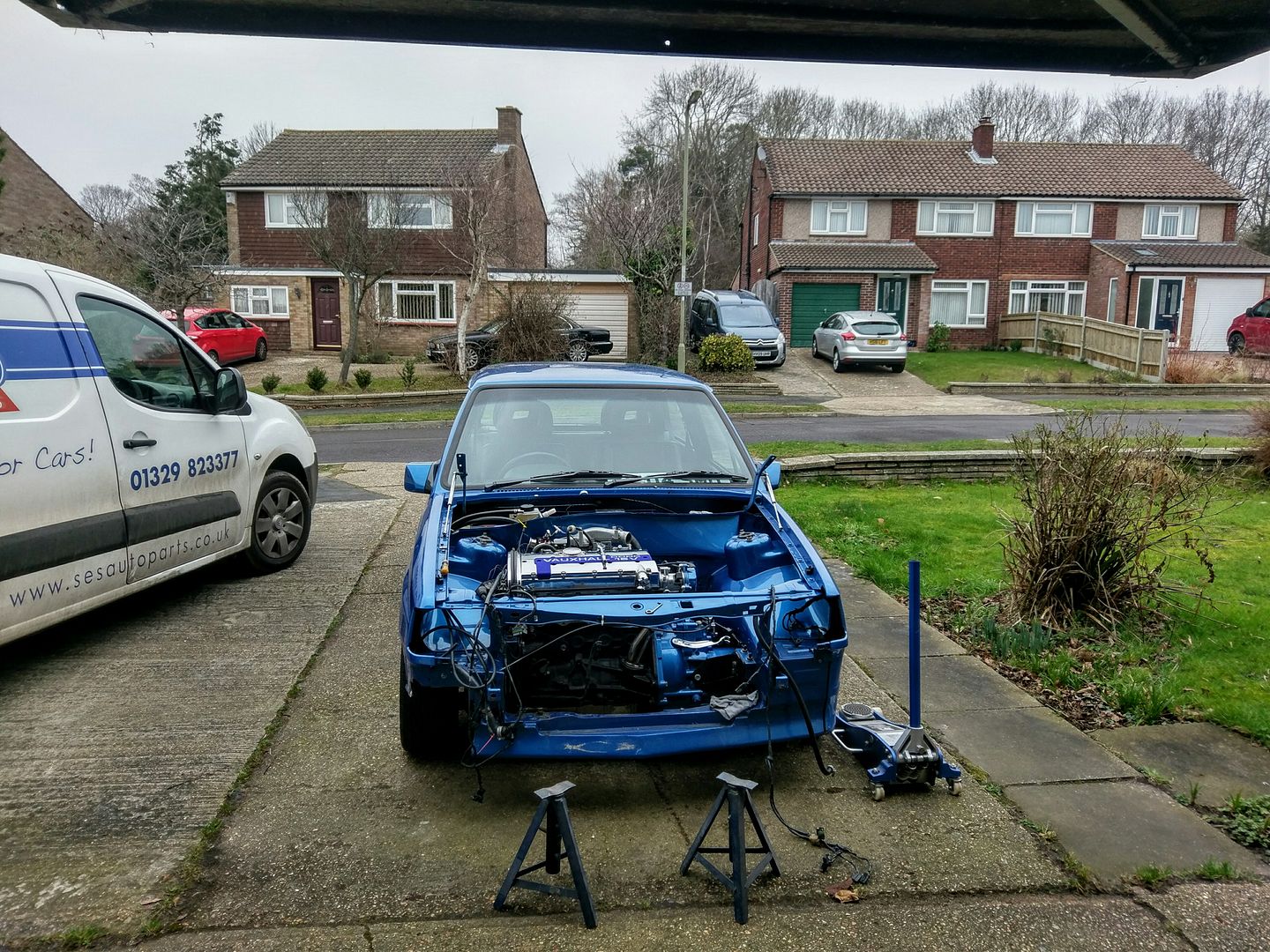

Sadly the pic doesn't catch the snow... Here's where i started. Pass shaft out, starter wiring off, loosen mounts and then attach the hoist.
Angle box end right down. Lift out the top.
I'll admit, it's not as easy by your self. But totally do able. As always something was still connected.. Dan spotted the oil lines where still on..lol
