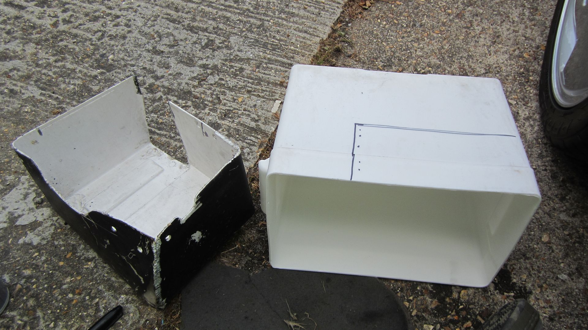

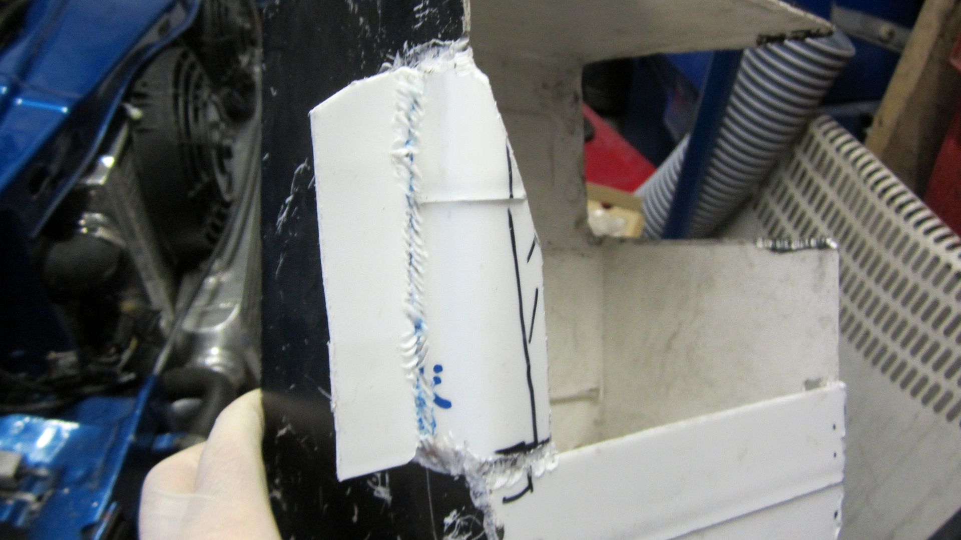

Out with the plastic welding gear. I'm using another box i bought for parts.
http://img.photobucket.com/albums/v3...psrvcxrk5y.jpg
Built the side up as i think that is where most of the water was getting in. Out and wrapping it around the front more too.

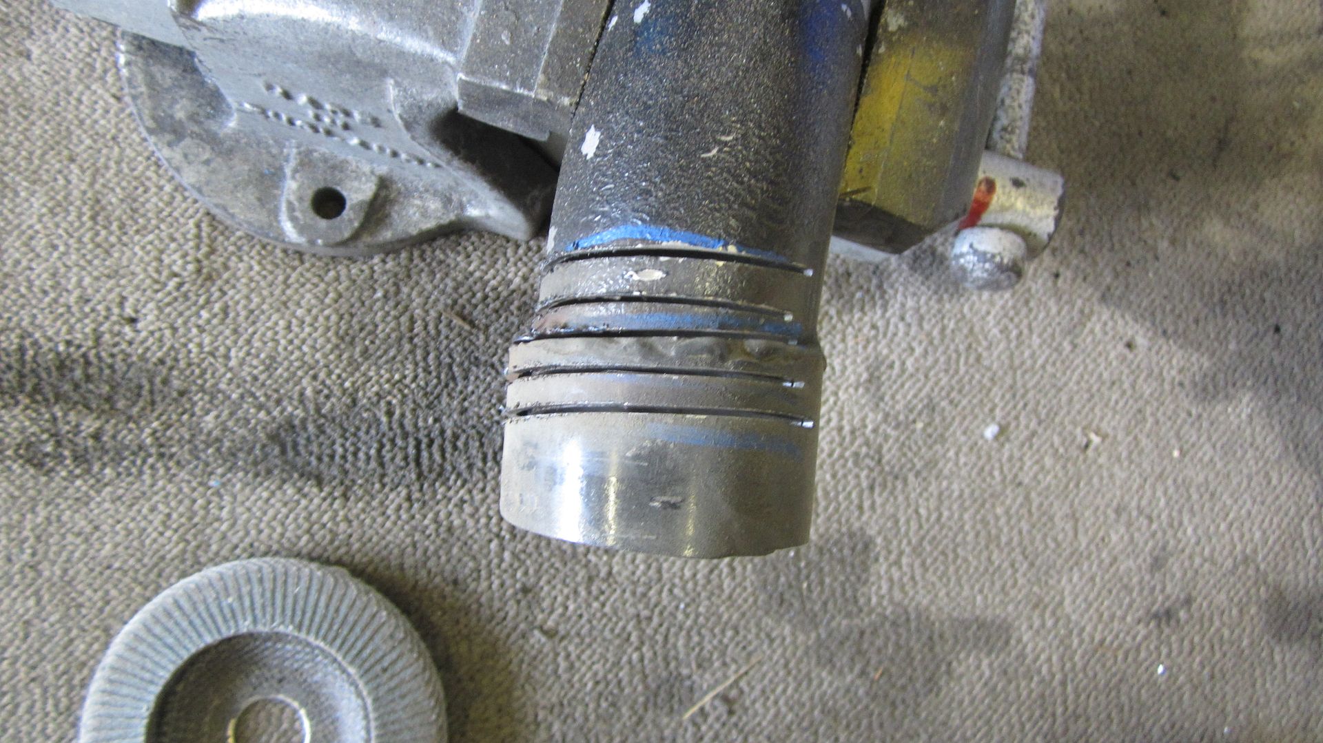

THen i looked at where the afm/filter sat. Wanted to move that around a bit. So box off, pipe work out.
Cut a few lines in to open up and then rewelded.
http://img.photobucket.com/albums/v3...pstnouozlb.jpg
This aloud me to pull it around a bit more so it was pointing down and in more. No after welding pics as it wasnt a tidy job :(

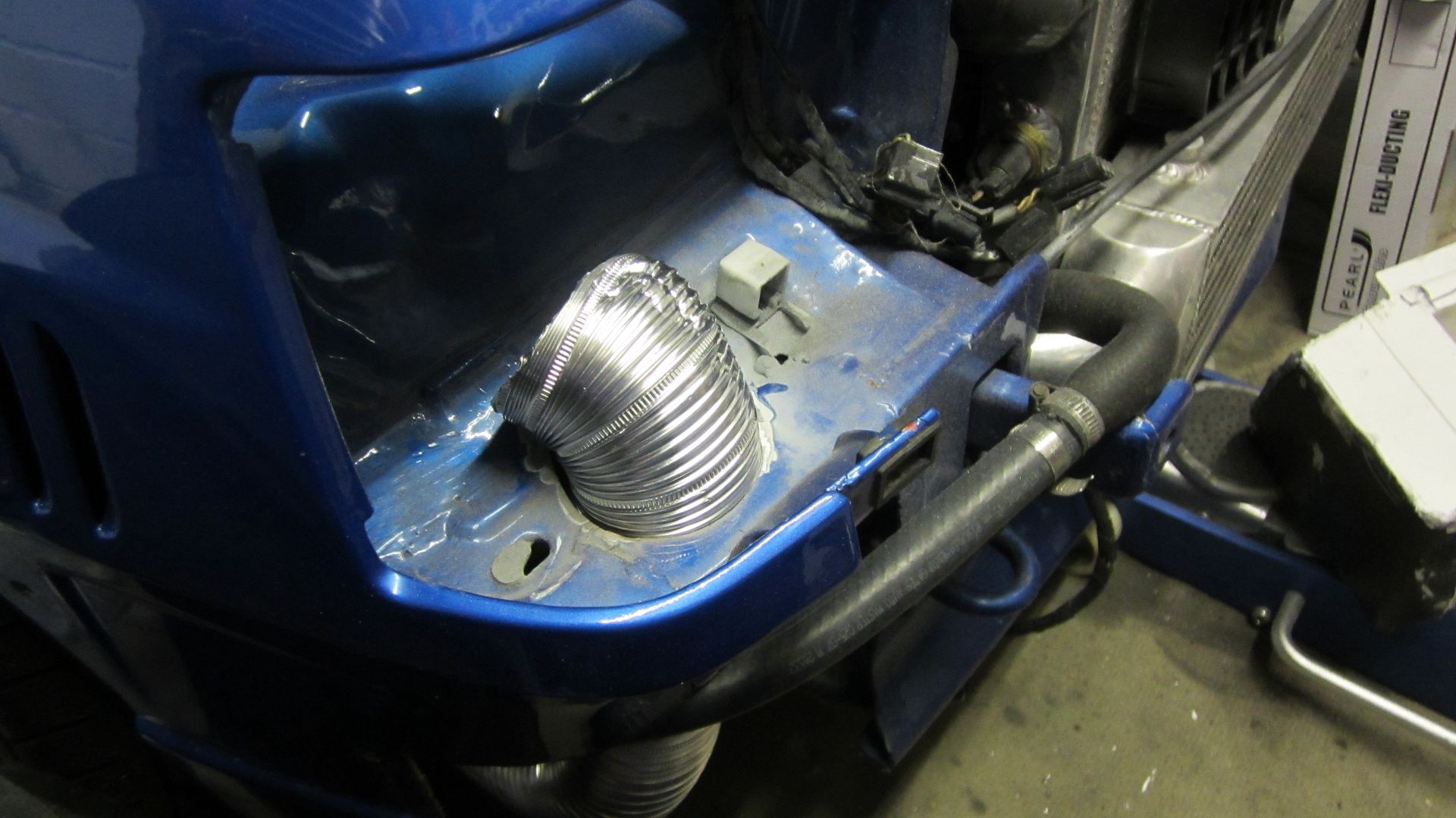

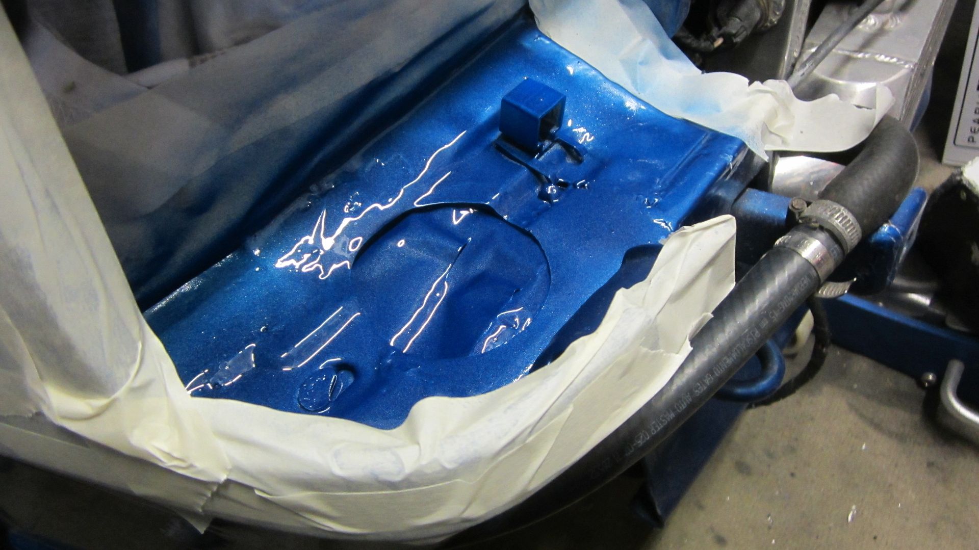

Next up i wanted to duct air in, from under the headlight, as it will be dry there ineven in heavy rain.
Bought my self a nice big chassis punch tool to get a nice shape. Hole and repaint.
http://img.photobucket.com/albums/v3...psjzibngf4.jpg
Ducting in, not happy with it tho, is untidy.
http://img.photobucket.com/albums/v3...ps2joymita.jpg
Sit nicely under the headlight, but want to tidy it up.
http://img.photobucket.com/albums/v3...pstu82rrju.jpg

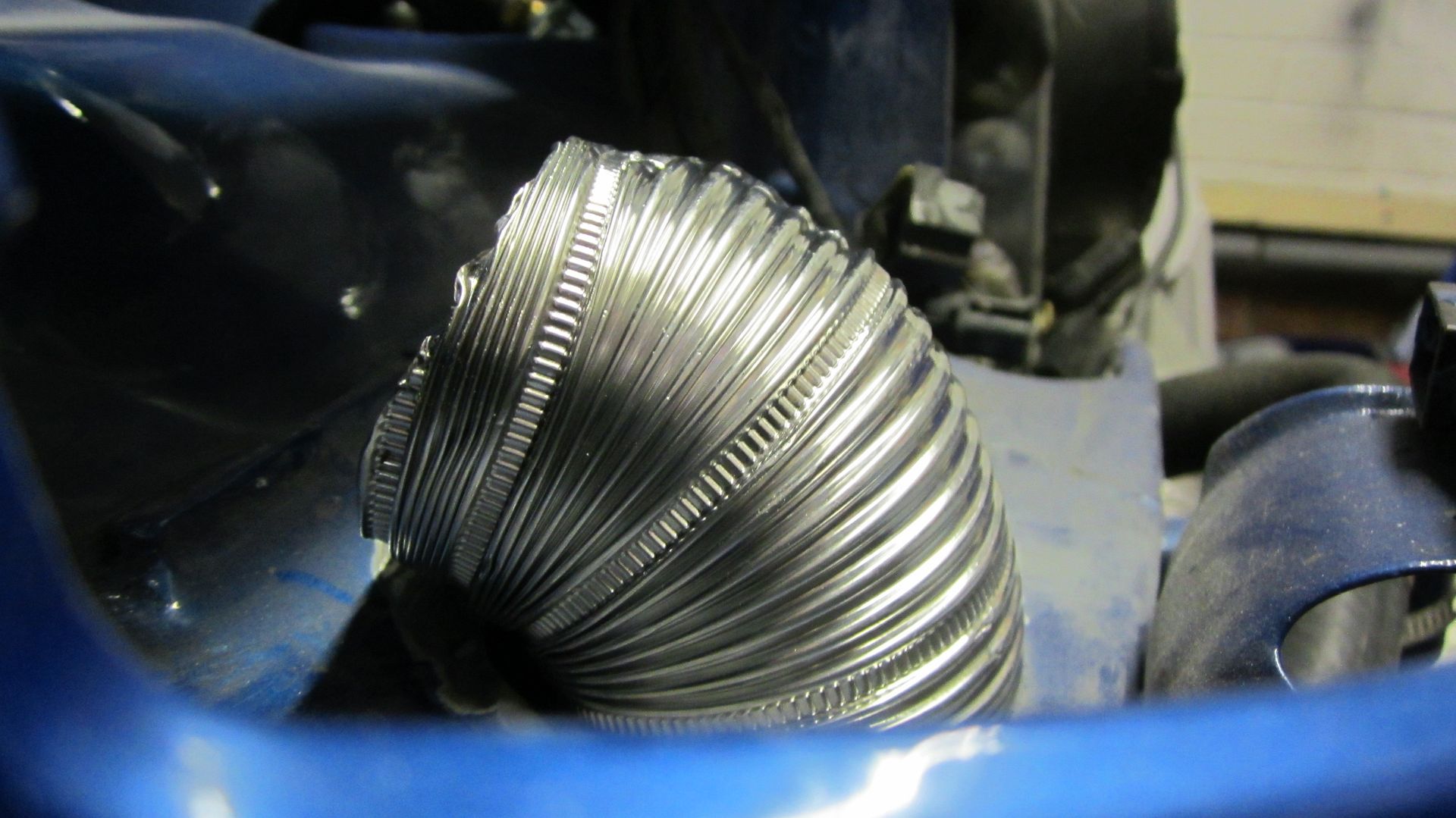

Ran it in to the box and behind the AFM, fluting up to the filter. You can just see it.

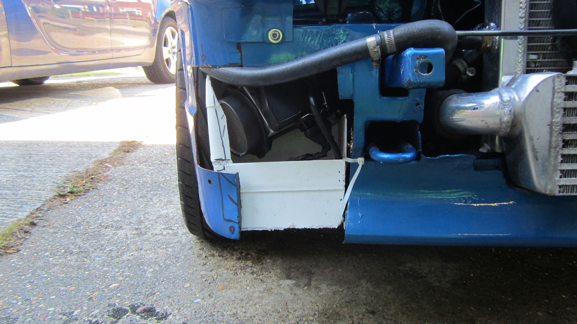

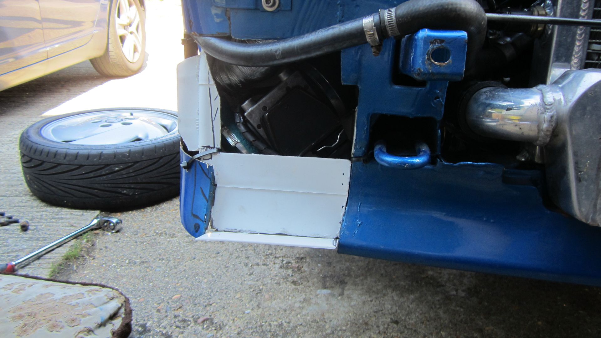

Added a bit on the bottom pointing in to the bumper, as there was a gap at the front. Where i could see water getting in easily...
http://img.photobucket.com/albums/v3...psrcnqjzwz.jpg

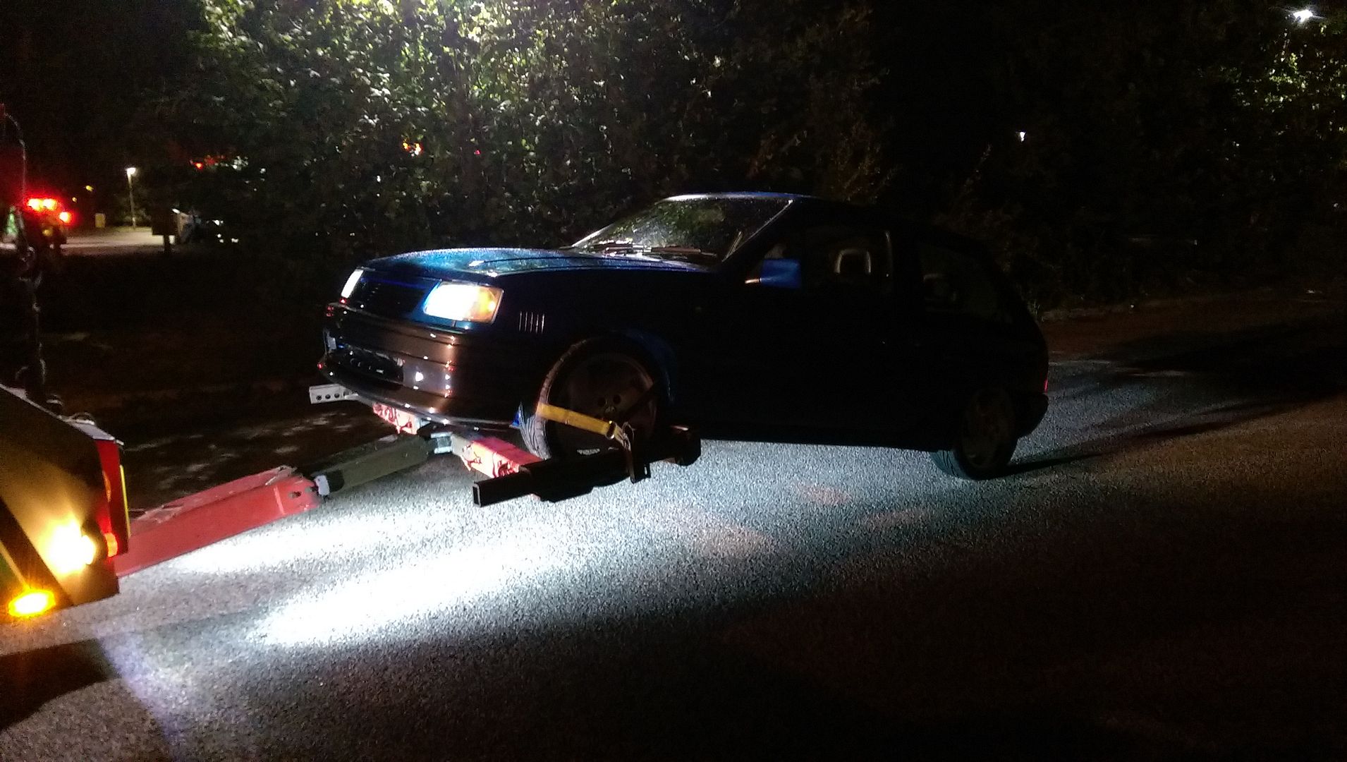

Fast fordward to the sat, all ready to drive up to Retro Rides.
Fast forward 35miles, having a bit of a play around with a Astra VXR. I pass him and pull back in, see him flash me.. Then notice the smoke. Look down, oil on! Quickly switch off and dip the clutch.. Cost as long as i can, as i know there is a juc coming up.. Didn't make it. Stopped just before it.. No brakes on the pass side. F**king car.
Get out, to find oil all up the side to the windows.. all the way down the side, all over the whole boot. Pass wheel is covered. Rear wheel face is coated too... Look in my front arch to see....

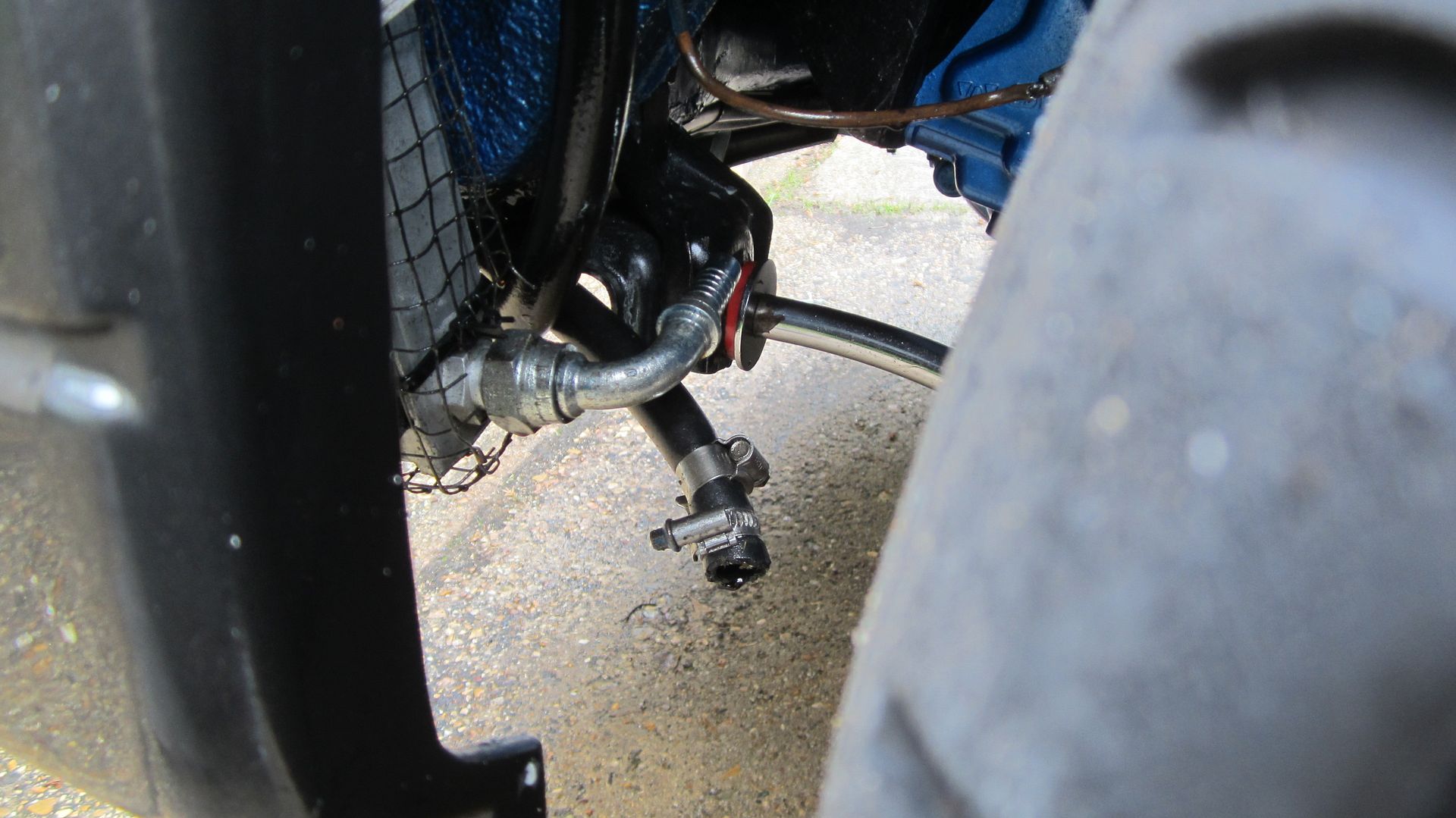

Dropped the cooler off, am gonna see about getting new lines make with prober ends. But lil worried why it blew off in the first place...
Swaged ends are definitely a good idea having seen that. Mine were done at Protec but weren't that expensive. What oil pressure do you run?
Standard Zlet pump pressure. I haven't tested it was a number gauge, which i want too now. On the Nova gauge it sits just underfull when cold. When warm it sits at 3/4 mark.
I've ordered a psi/bar gauge so i can test it, as i don't want it to blow from some where else if i fix the lines.
Gonna get prob ends on the lines that wont come apart. THe 2 jubliblee clips that where on the fitting where both very very tight. I couldnt push it back on when i remove it.
